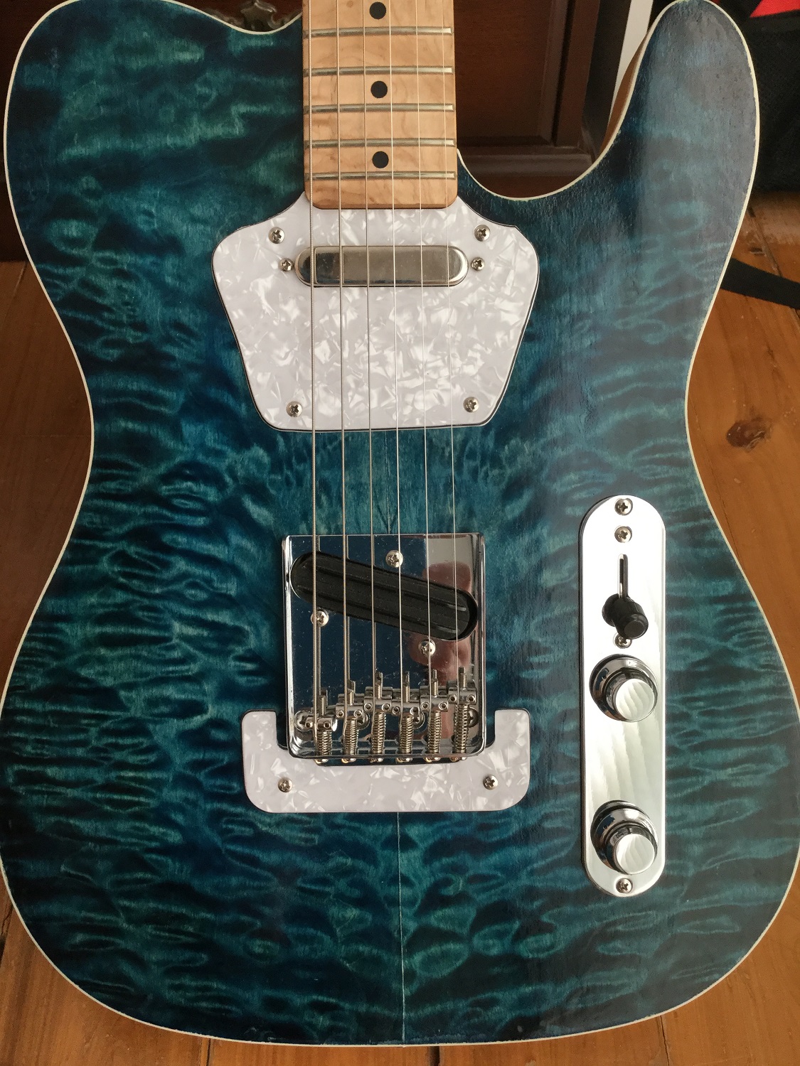

    So as you can see on my first veneer top, these damn glue lines popped out when I applied the stain. Bugger.
    I have plans to do an LP with a flame top and DON'T want this to happen again.
    Any tips and tricks to stop this happened again without sanding through the veneer or scratching the hell out of the top?
    Any contributions are greatly appreciated.
