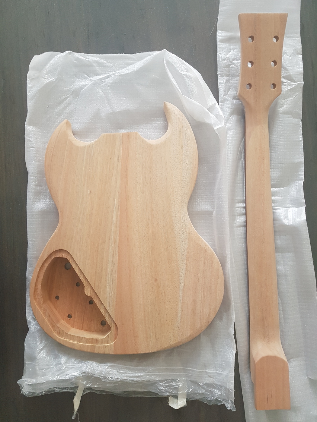

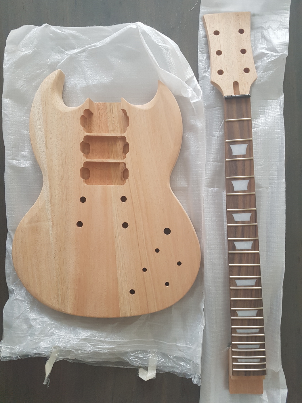

    So, it'a time to start planning the next build for me!
    I ordered through Adam a custom kit, an SG with 3 pickups, with mahogany body and neck...
    I received it some time ago, but was busy with other builds.
    Here are the pics:
    and
