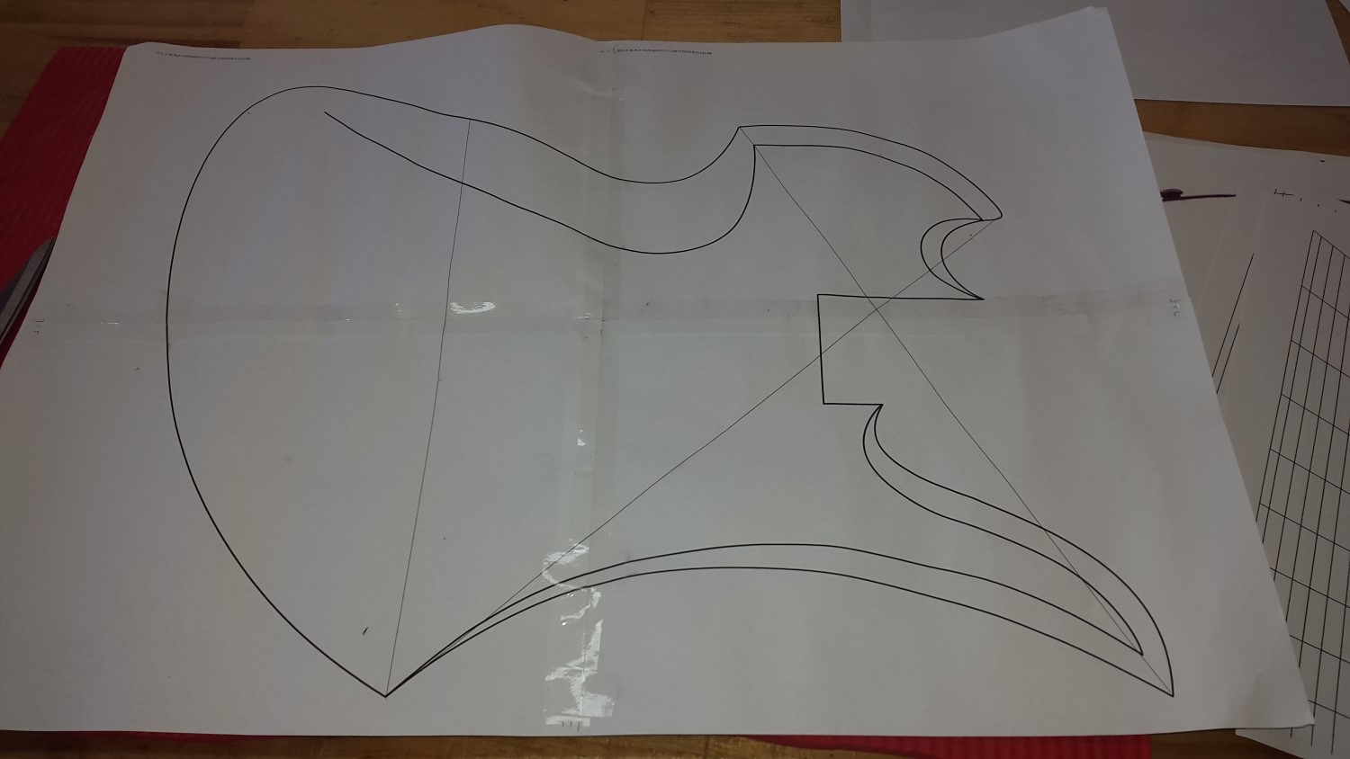

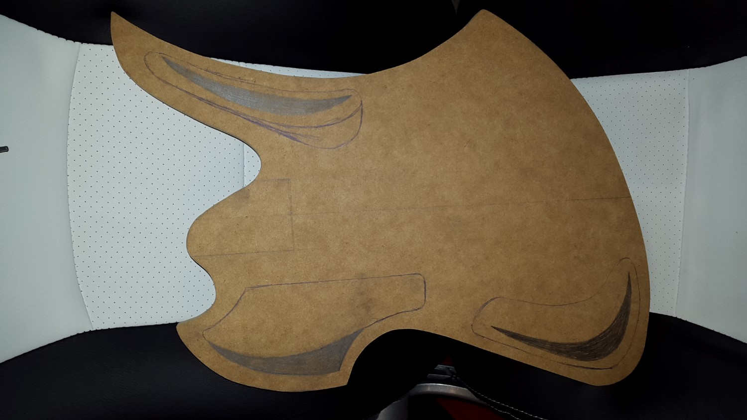

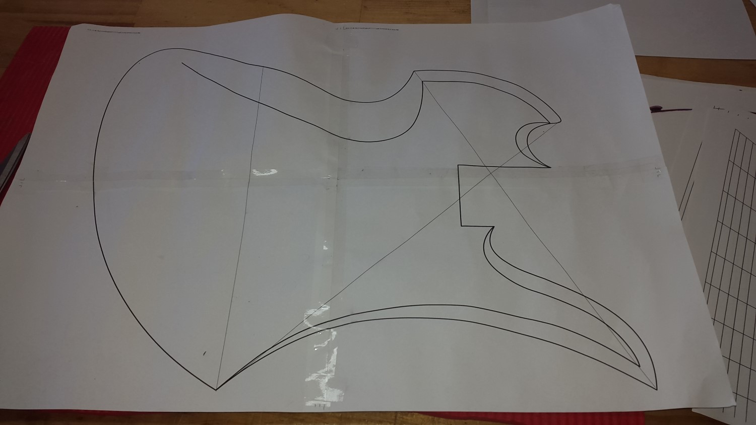

    Before I started, I got myself an outline of the body to use, this one's slightly larger on all sides than a standard 6-string 'Bird, but it accomodates my planned neck size correctly, and since I'm going to be chambering the body I'm not worried about the extra bit of weight.
Name:	20160401_104354 (Custom).jpg

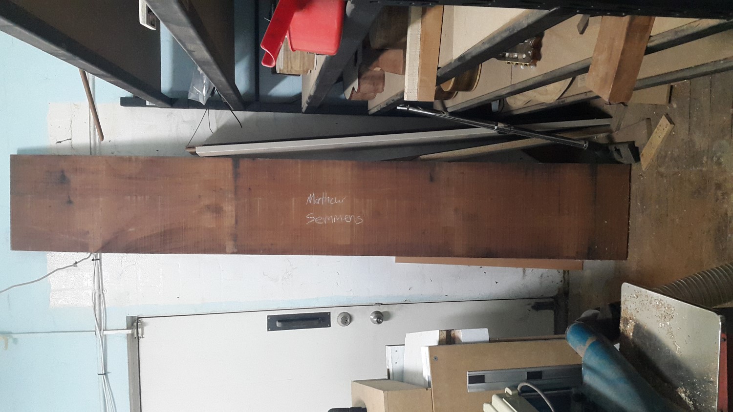

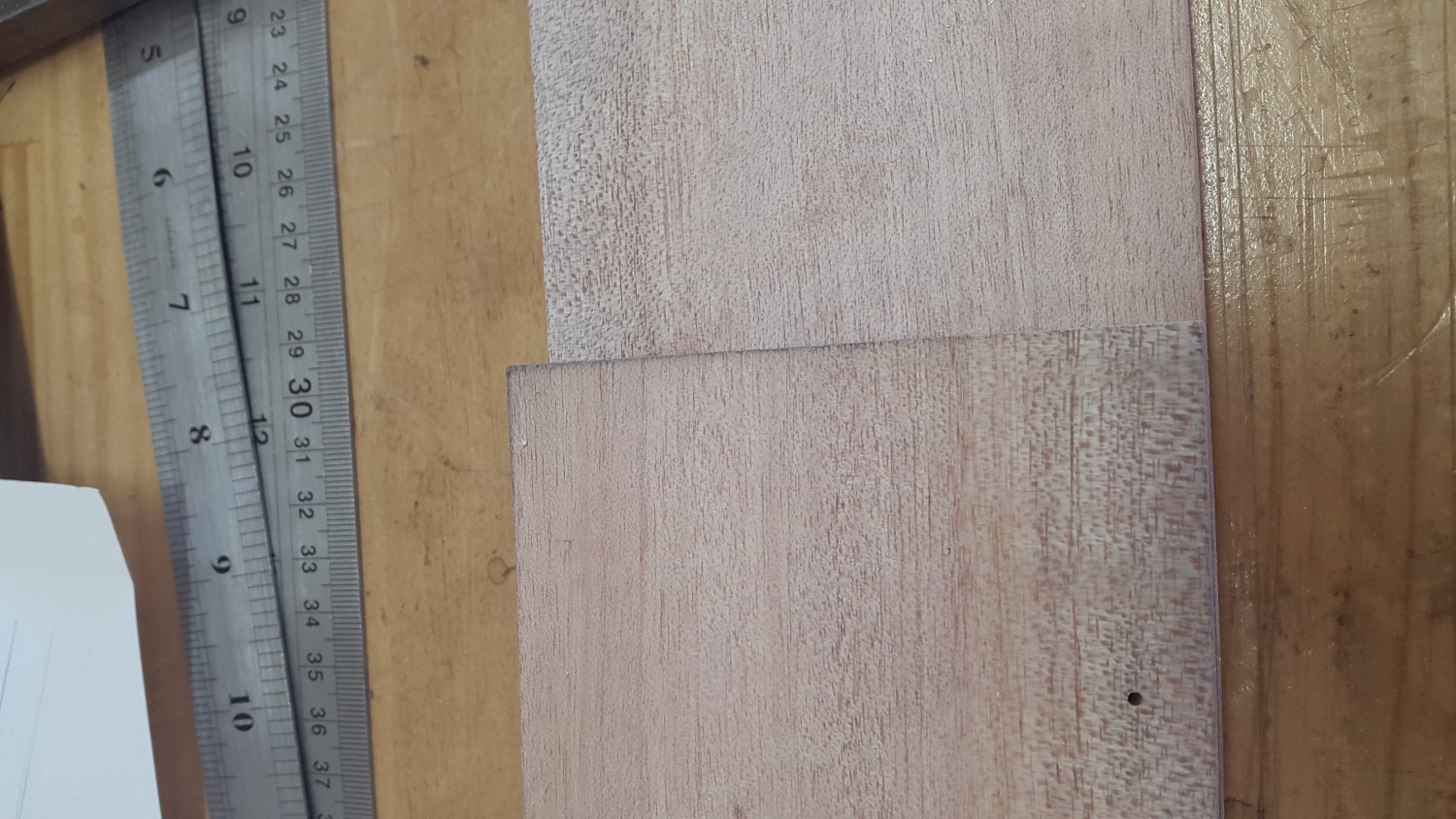

    Another fun part, the body will be a one piece mahogany body. Now the piece I'm using isn't off this slab, but I suspect they used to be similar sizes, and I thought you might all appreciate seeing how FREAKING HUGE this slab is. Because I was blown the frig away.
Name:	20160401_130634 (Custom).jpg

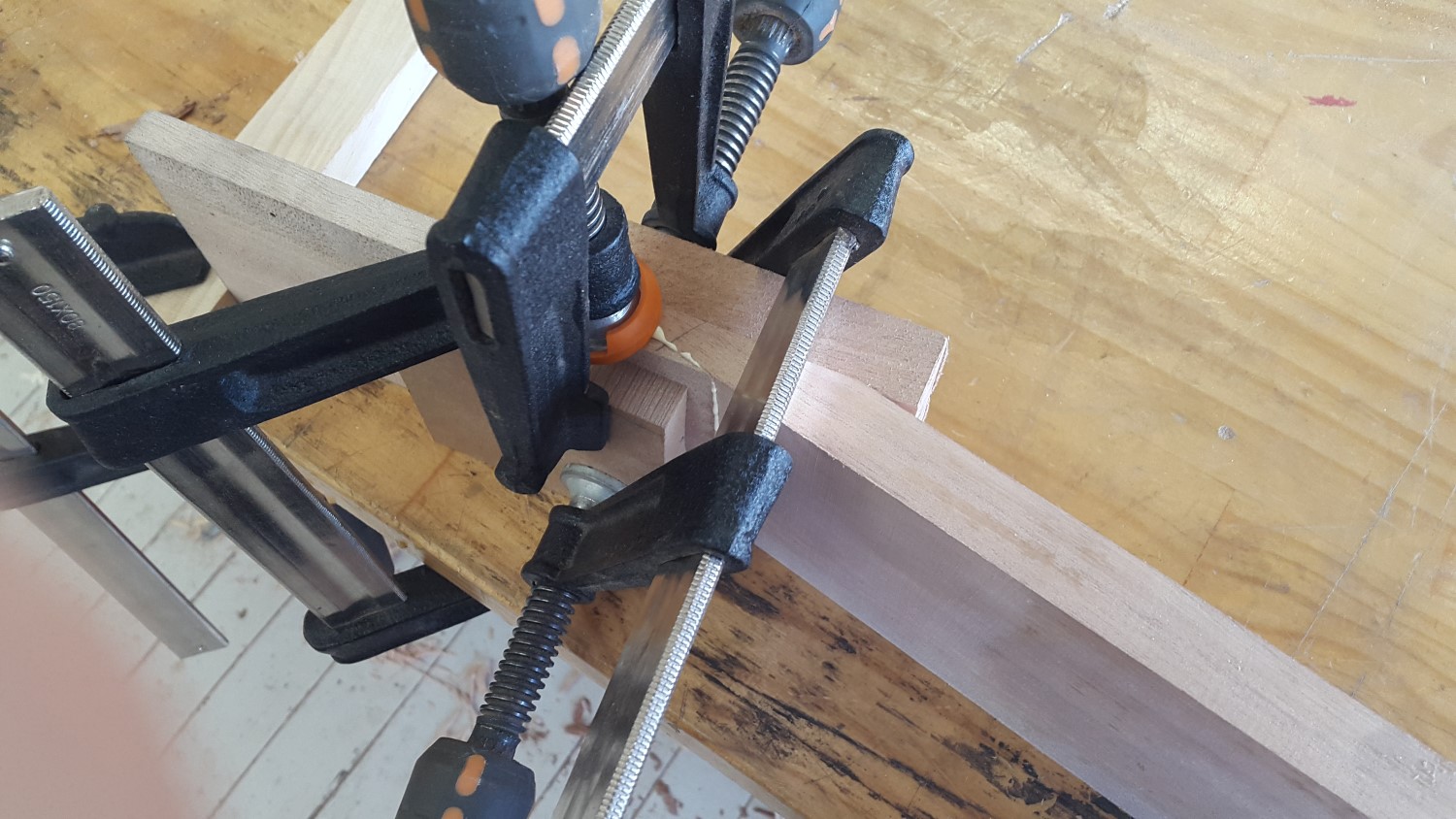

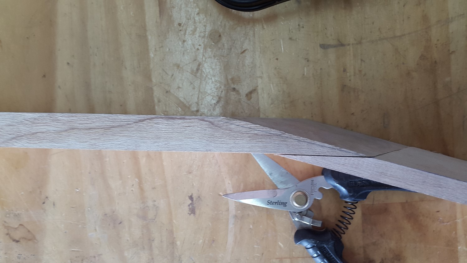

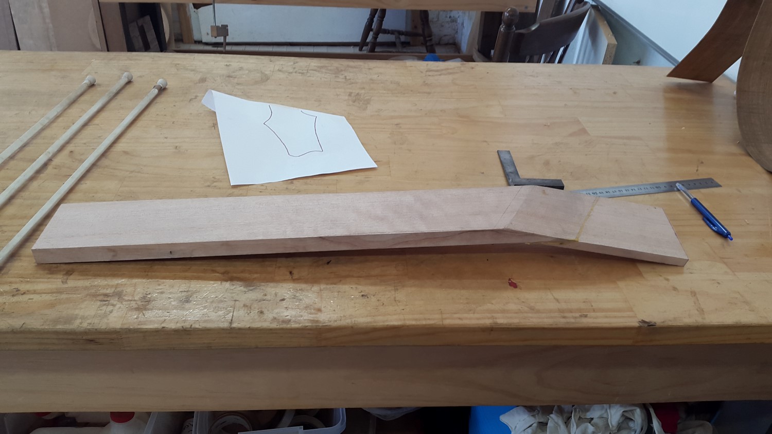

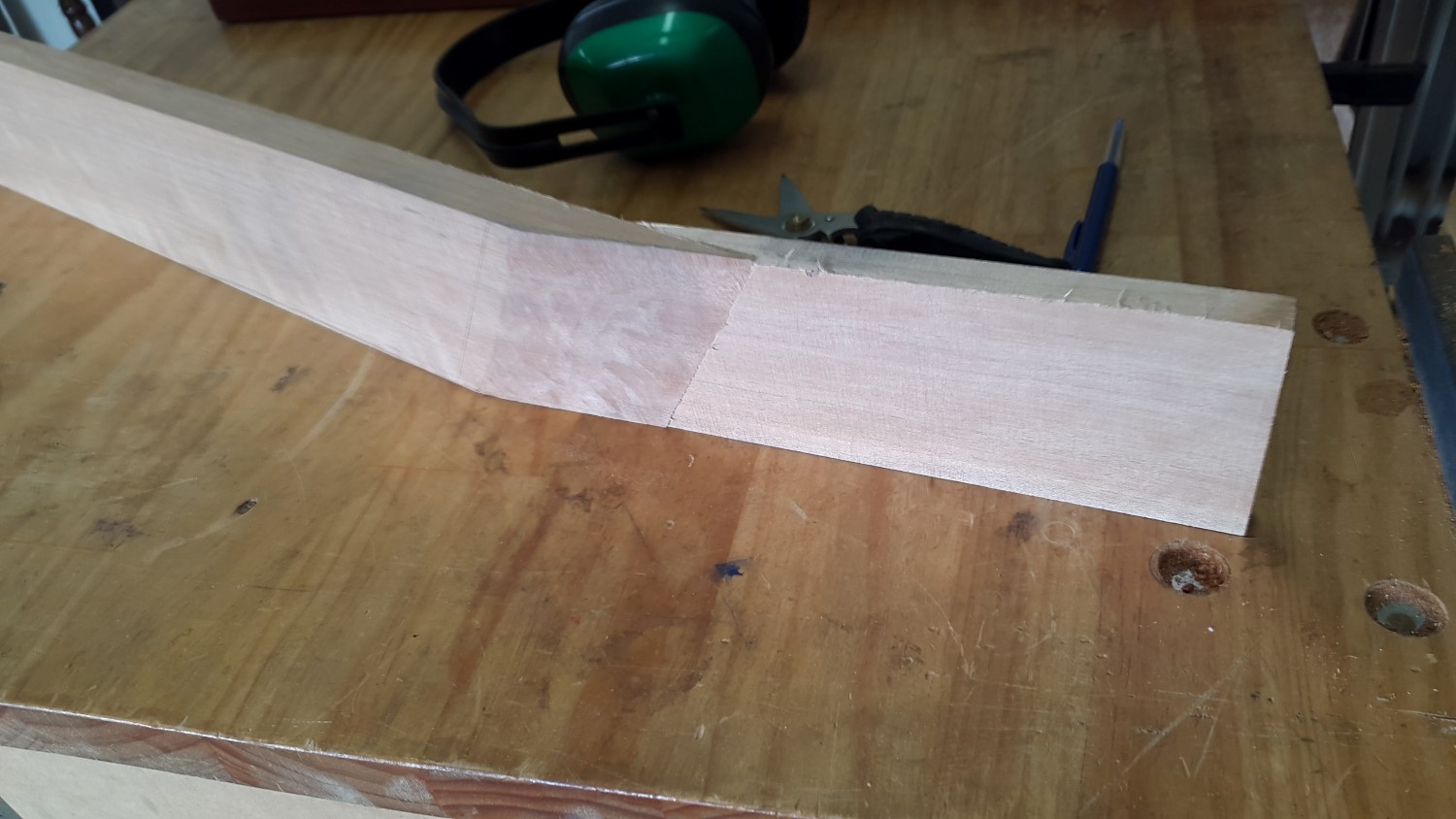

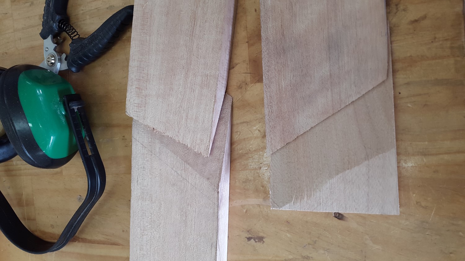

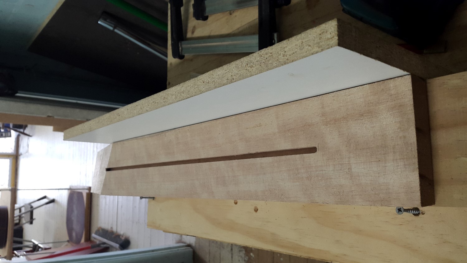

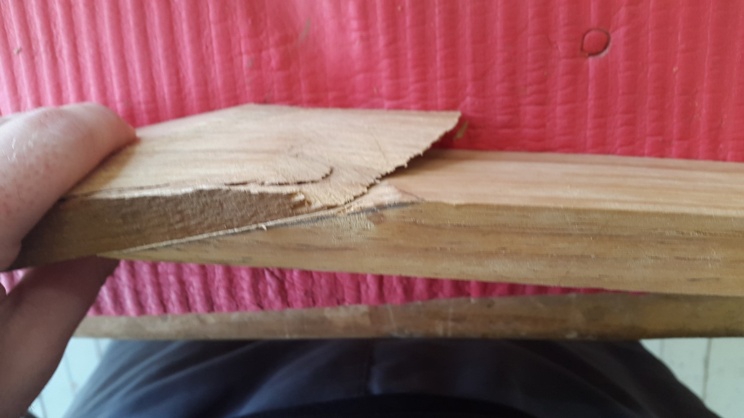

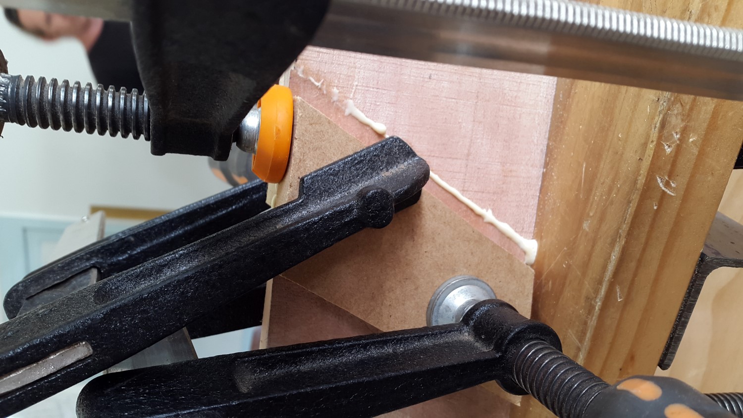

    So in terms of actual physical progress today, we did up the scarf join for the headstock. I had my pick of a few pieces of QLD Maple to use (also, one piece neck too) and opted for the one I did because it had a nice shift in colours and grain across the piece. The second picture is the best I have showing this, it captures the grain difference, but doesn't capture the colour difference well still.
    So this was all a fairly simple process today. Level the slab off to make sure it's all even, cut off part of the slab at an angle, plane and sand it all down to make sure it all goes together neatly, glue it back up.

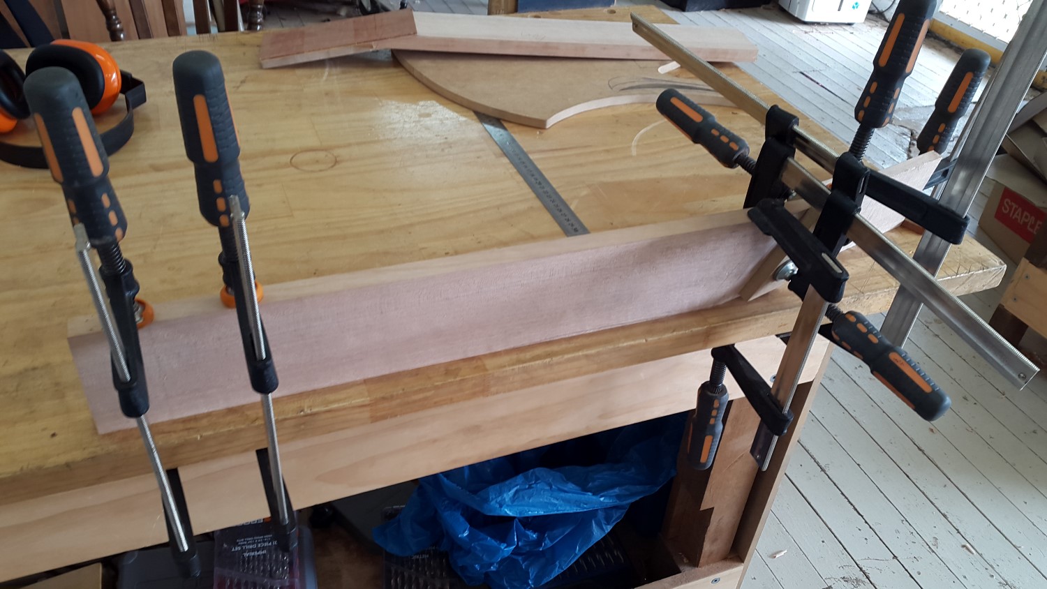

    And all clamped and glued.

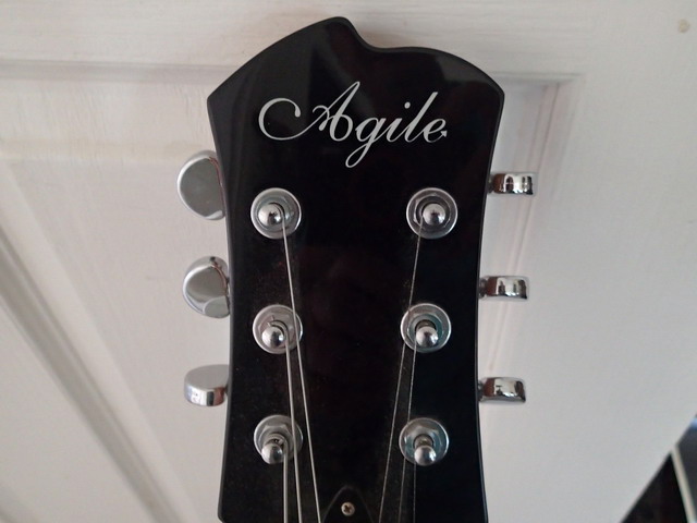

    Thats almost identical to the headstock I designed for my build, but only 6 holes. I THOUGHT I'd come up with a unique design, an amalgam of Maton, PRS and Ovation, but there ya go...

    I was going to use my Junior 2300 with som subtle changes as a Template for my next build, thought i was being original haha

    Haha, well there is only so much you can do with a headstock if you want to keep it fairly traditional. There's so many companies that make slight variations you'll usually end up with something very similar to someone else, even if you don't intend it. At least you can claim you made yours on your own rather than blatantly taking it though

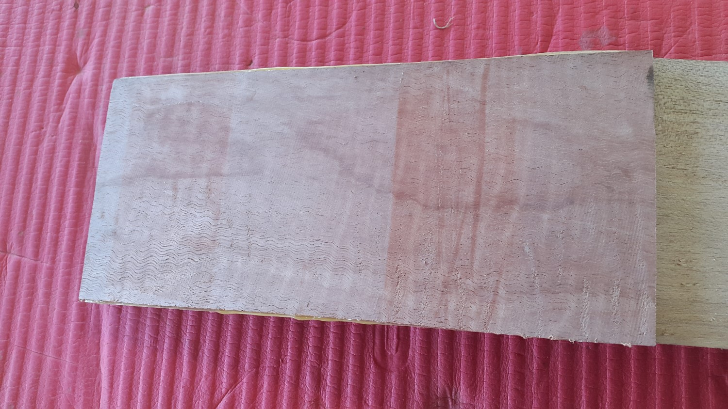

    I also got confirmation this afternoon that I will be getting Figured Jarrah for the top. Don't have any pictures today, but that will be one of the first things I look at next Friday!
