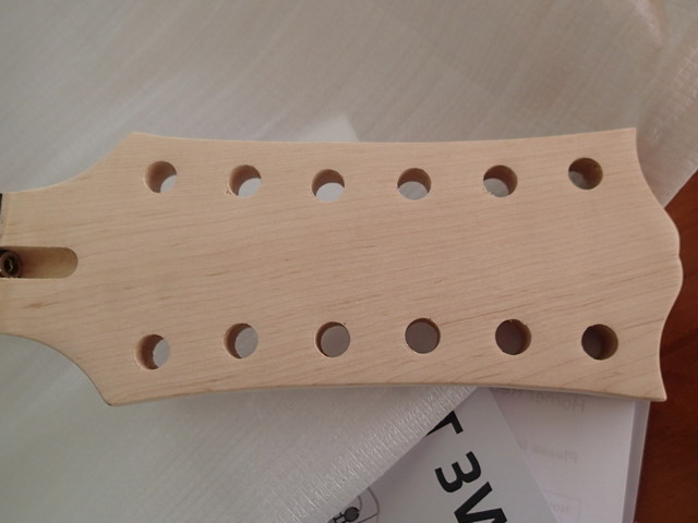

    Headstock already shaped, i was hoping it wasnt, because i had another idea in mind, oh well saves some sawing.

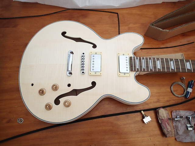

    Bit of a mock up

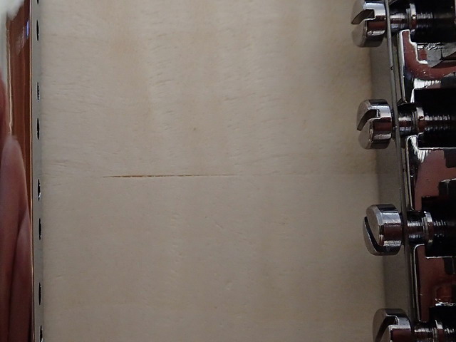

    One of 2 small cracks in the join of the cap, will make up a slurry of filler and that will fix that

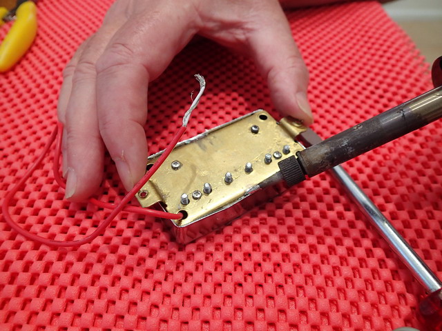

    Dissecting a pickup
    Remove the solder

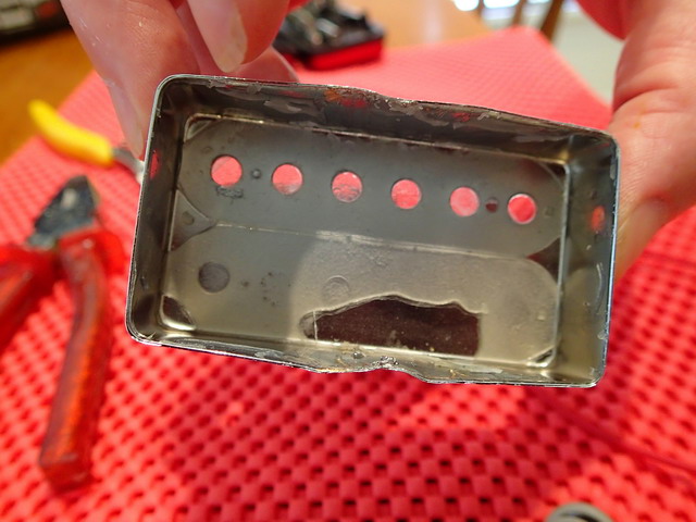

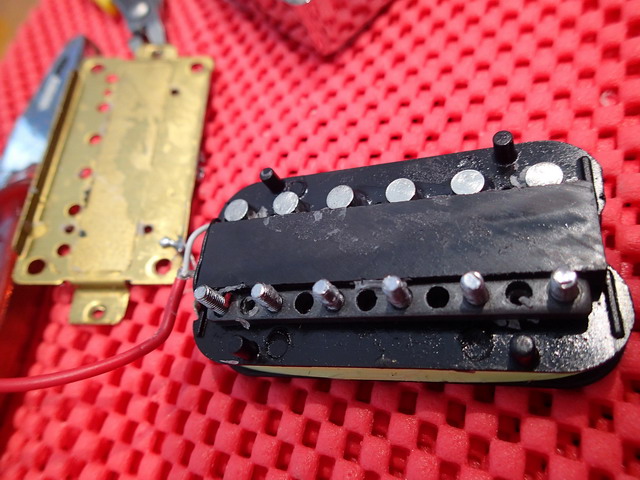

    Take the cover off and? hey someone poured some paraffin in there, not exactly wax potting, but it dispels any myth that they are
    Bobbins are only half full and sealed off with tape, the base plate has copped the ye old paraffin trick as well.

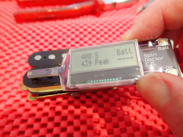

    Gauss, magnet strength is poor for a ceramic, South facing, North facing is half that reading again.

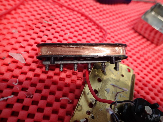

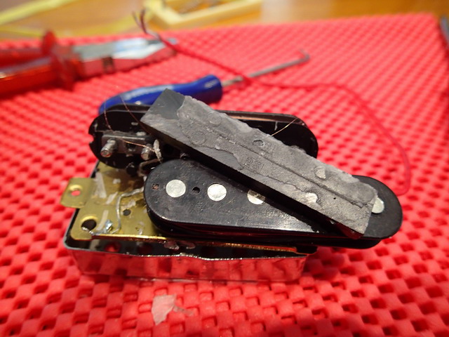

    Getting into the guts of it, no shim, just some raised type of pole pieces moulded to the bobbins

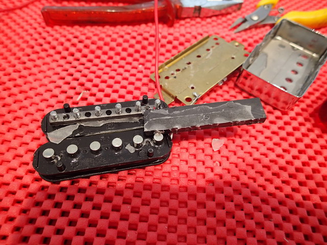

    Bobbins held together by the magnet with you guessed it, paraffin wax.
    Bobbin half full, the sticky from the tape is all over the 42 AWG poly wire, the spacer bar is at an angle, might have been a Friday assembly.

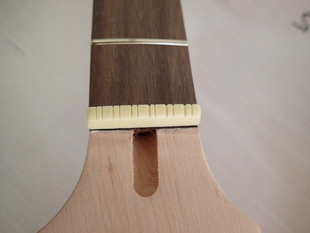

    I am surprised how well this plastic nut is made, its tempting to retain it. I have woolly mammoth tusk here and cow bone, i think i might make me a bone nut, the wooly mammoth can wait for the Ancient Kauri bodies i am yet to do.
    The thing with a nut is, once you fret the guitar, the nut is out of the equation, but a well made nut also means less chance of cracking and breaking it.
