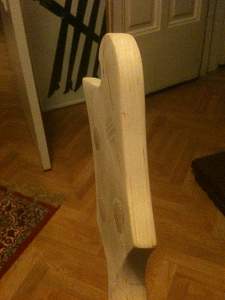

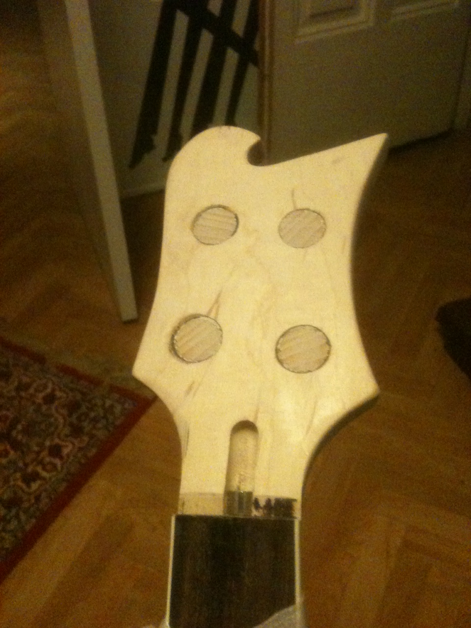

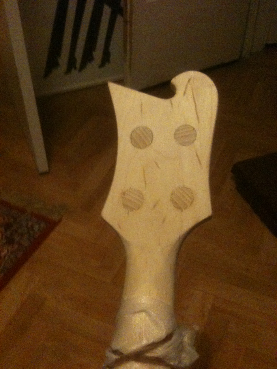

    Holes refilled and sanded level. Takes a little reshaping due holes measure around 17.50 mm and the strip wood stick measure 18mm, but the end results was very good.
    At the moment, i have cutted one headstock side with a japanese saw with excellent results either. Will post pics next week.
    Wokka youre right, ive been thinking about this meanwhile the research for the veneers, and yes, i'll have to put on something more more thinner. I found 0.6mm veneers that would make the job.

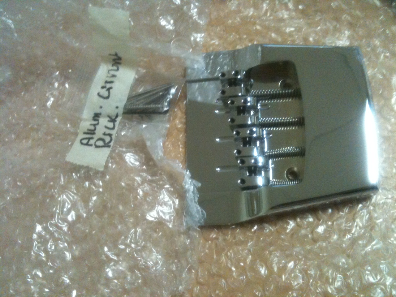

    Speaking the devil, hipshot its on da haaus!! almost 25 days waiting for arrive...Damn customs!!!

    Looks terrific...cant wait...

    What's the reason for dowelling the tuner holes?
    New Bridge looks good
