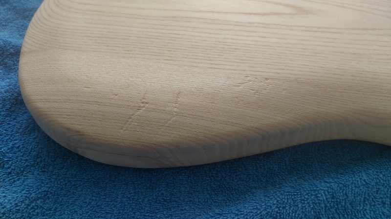

    There are a few dents in the wood that I've got to fix:
    I read that these can be fixed by covering the dents with some water, putting a paper towel on top and using a hot iron till the water was all evaporated.

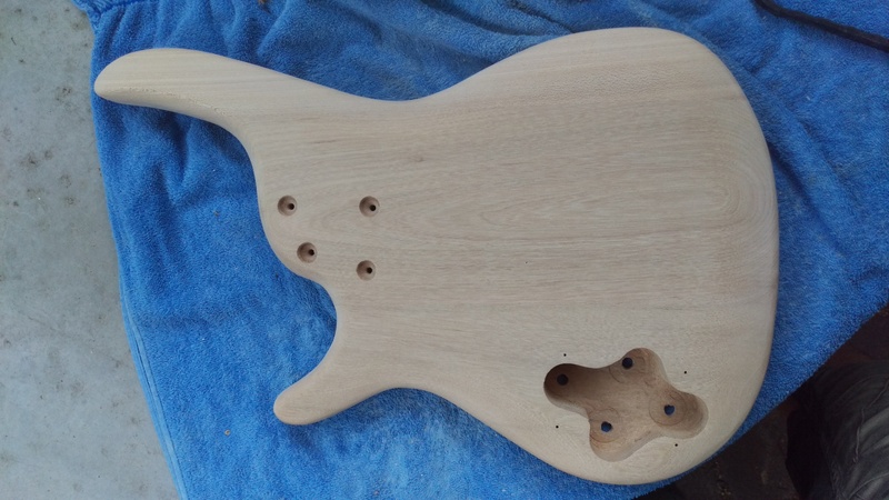

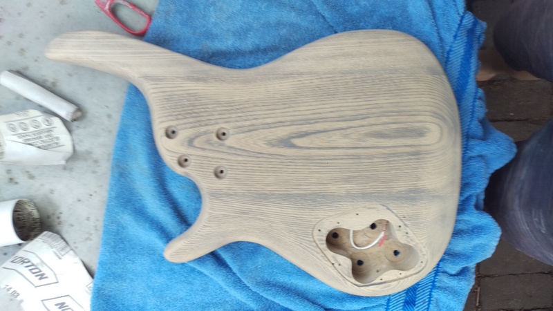

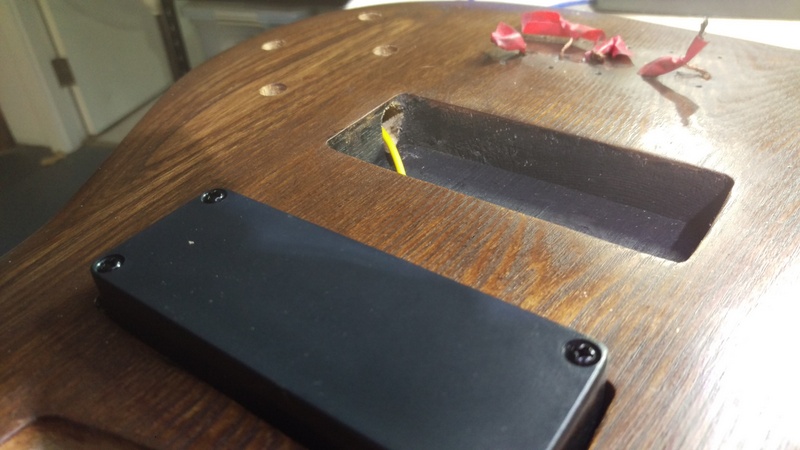

    The control cavity isn't deep enough and the pots don't come out enough:

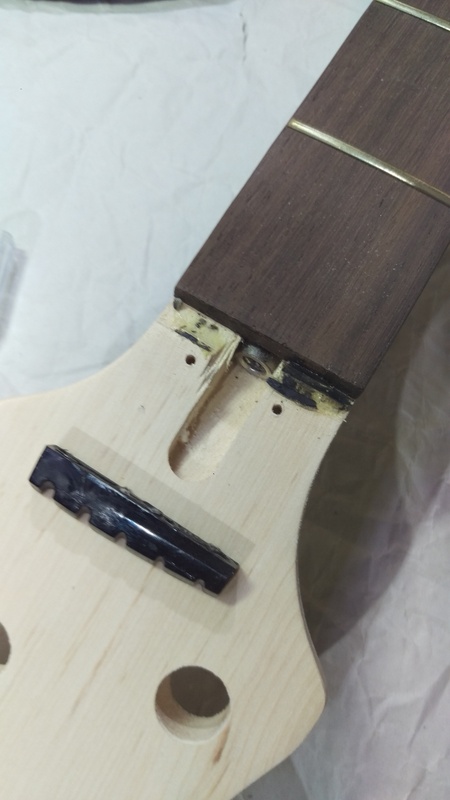

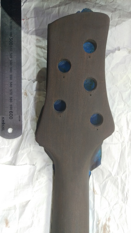

    The kit came pre-drilled for headstock and bridge and they must have had their template wrong for the headstock... The side with 3x is okay, but the one with 2x looks very weird. I'll have to fill this one (with a toothpick maybe?) and re-drill:

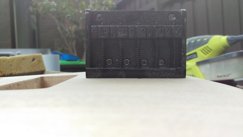

    And finally the part where the bridge is going is really not flat, so I'll have to level that down:

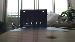

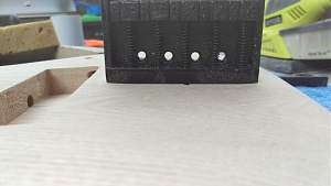

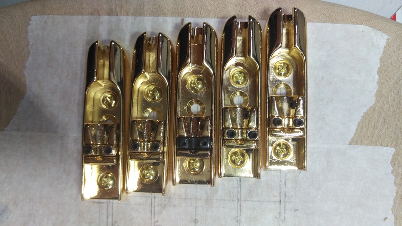

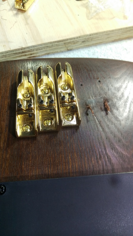

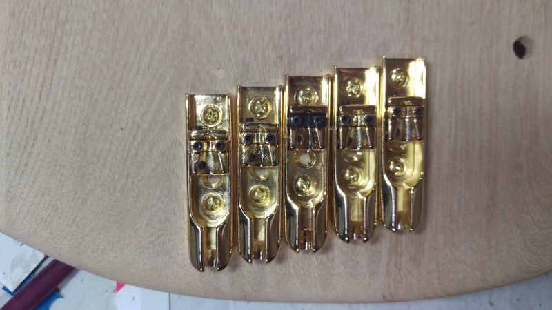

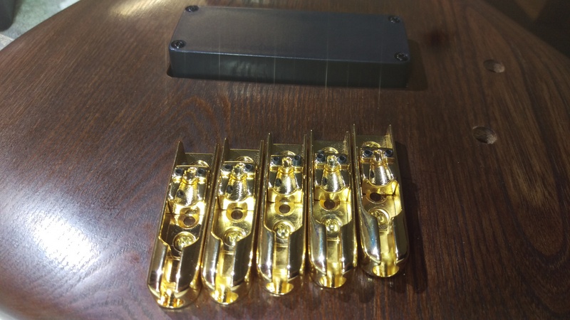

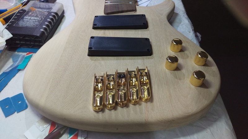

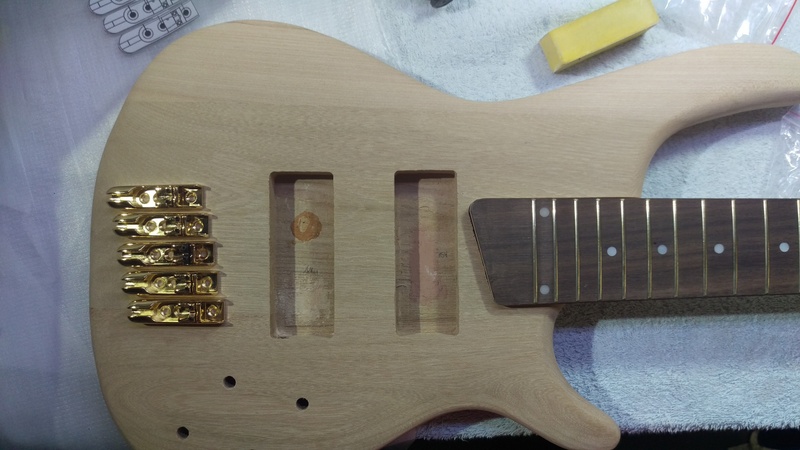

    For the new bridge, I wanted to get individual bridges like the Ibanez SR premium or prestige.
    But I didn't want to go all in and pay $80 per unit, so I found cheaper units on eBay:
    They're going to be a bitch to intonate I reckon, I'm hoping I'll do it once and then shouldn't have to worry about it again since bass players never change their strings I heard... :-)

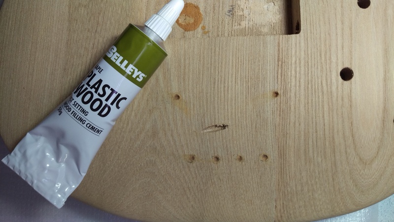

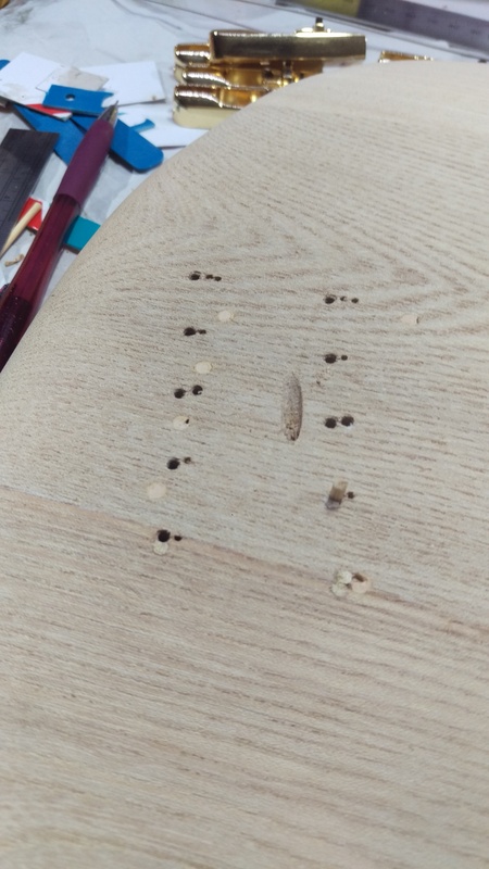

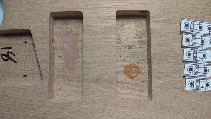

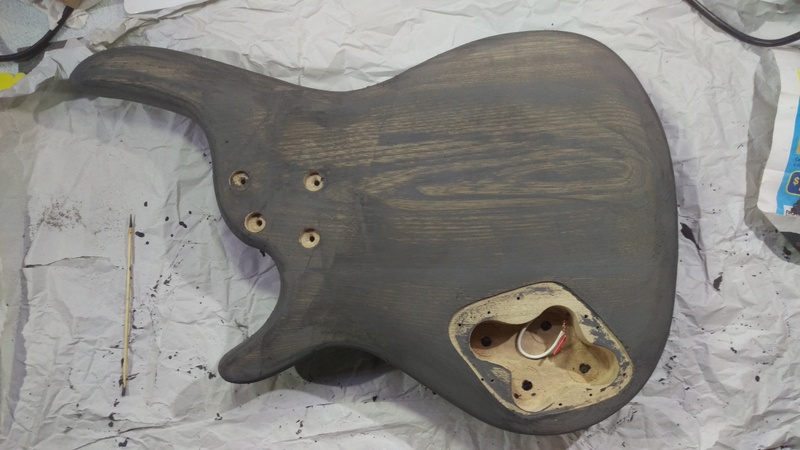

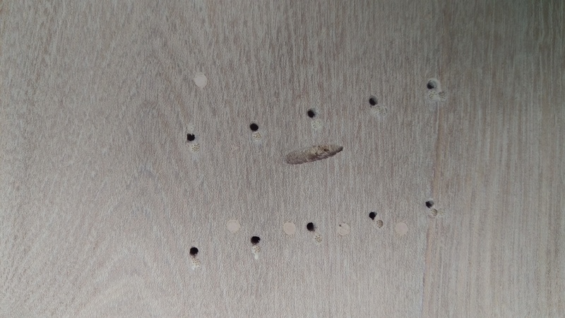

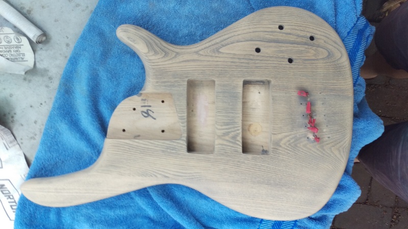

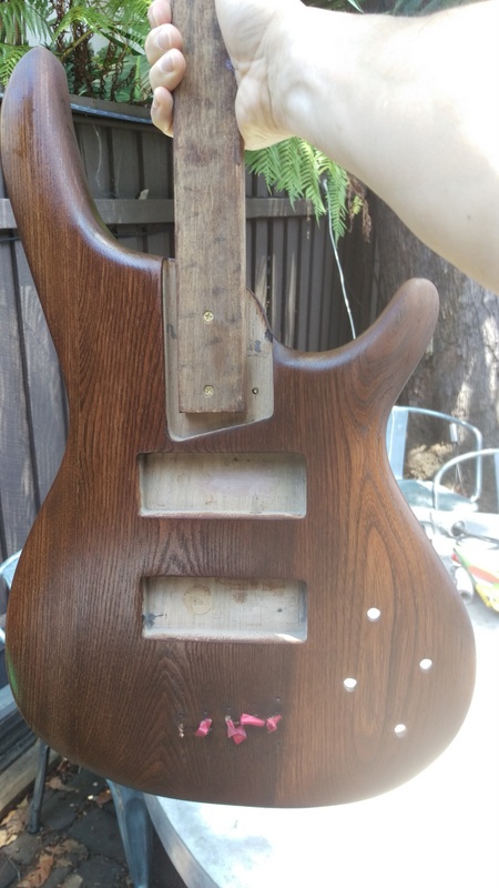

    So anyway, first job was to fill in the holes that had been pre-drilled for the bridge that came with the kit. I tried a few different options: timbermate Ash on the left, timbermate hardwood top right, and plastic wood bottom right.
    I'm thinking the plastic wood should be stronger if I need to drill next to the filled hole, but the colour just won't work.
    So I started by filling the bottom of the holes with the plastic wood:
    And I then filled the top with the hardwood timbermate which had the best colour match:
    One of these holes is going to show as I don't want to line up the 5x bridges, so I'll have to come up with something to hide it...
    I'm going for a dark walnut Dingotone finish and I'm wondering if I couldn't darken the part where the bridges are. Maybe I could darken the middle of the guitar and link the bridges to the neck... we'll see

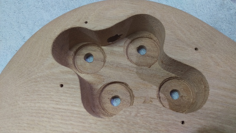

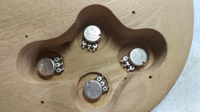

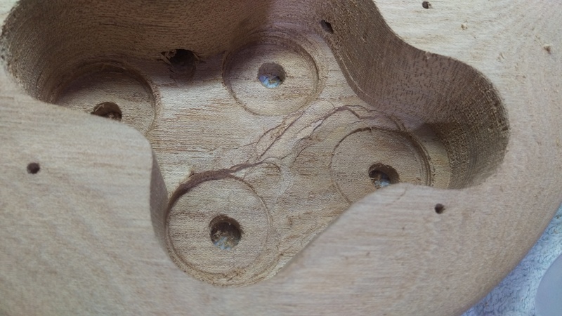

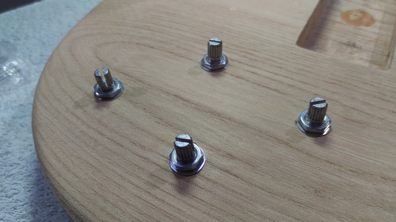

    Then I worked on getting the pots deeper in the cavity so I can screw the bolt on the other side.
    I started by drilling each pot with a boring bit:
    It worked:

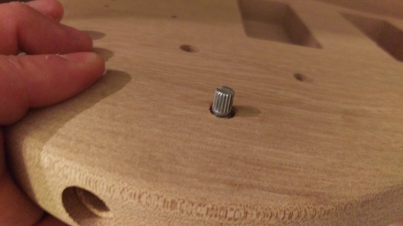

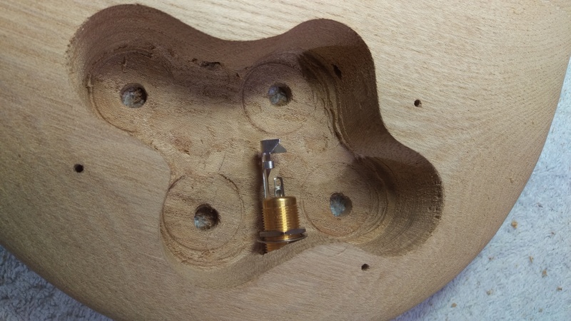

    But now the jack needed more depth too to be able to screw it into place:
    Mentor FredA's Avatar
    Sep 2015
    Surry Hills, NSW
    500
    So I ended up routing the whole cavity bottom flat with the dremmel and a routing bit. I had to do this without guide as the routing base wasn't allowing the bit to go deep enough in the cavity. Not the best looking job, but it does the trick.
    Half way:
    And finished, now the jack is happy:

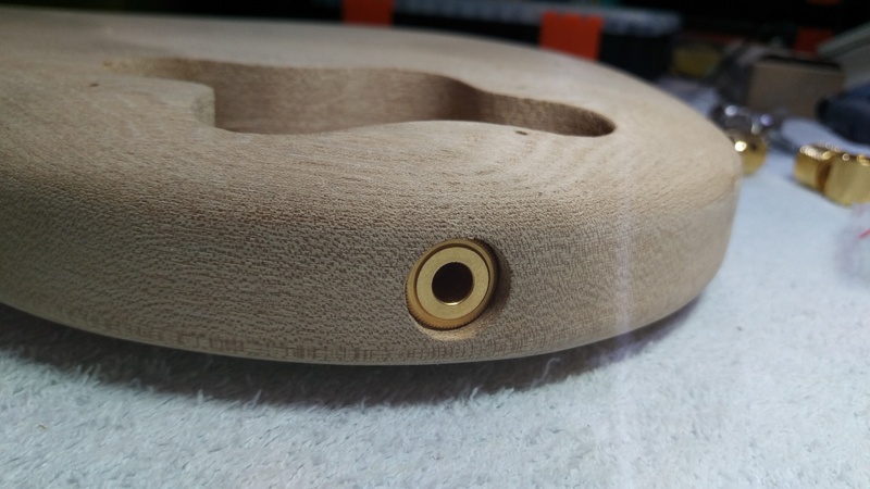

    On the outside the new gold jack sits nicely in the hole, but I think I'm going to sand the sides as they look too 'sharp':

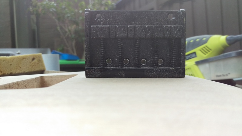

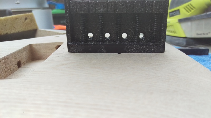

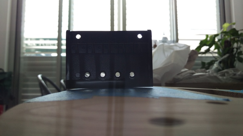

    With that done, I got the palm sander out with 80grit paper and I flattened the part for the bridge. It now looks flat and the bridge doesn't rock. Photos with the old bridge used as a test:

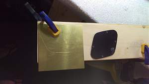

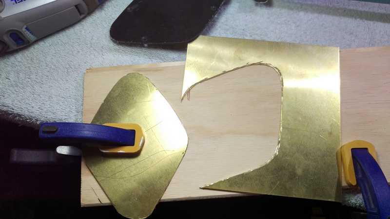

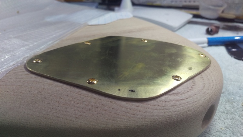

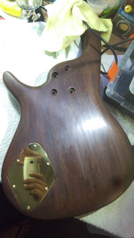

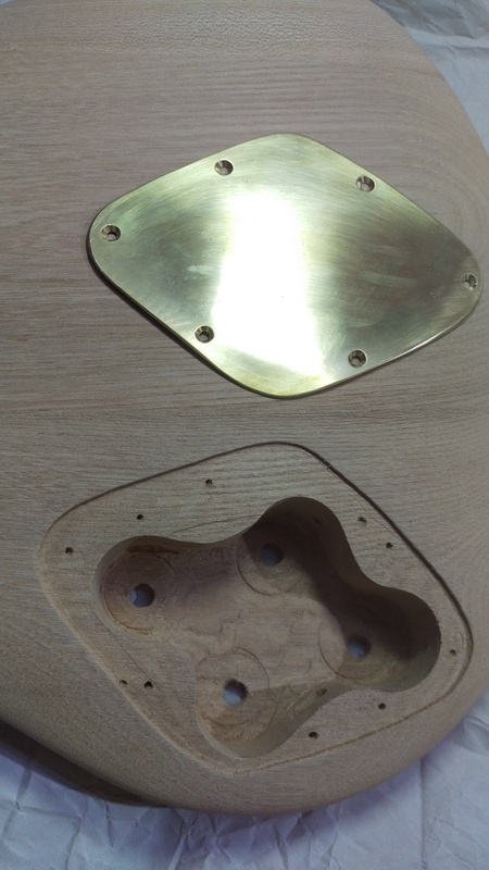

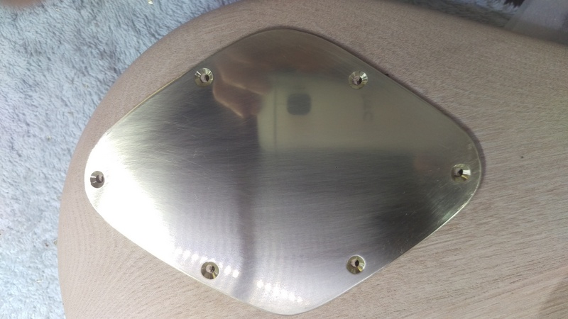

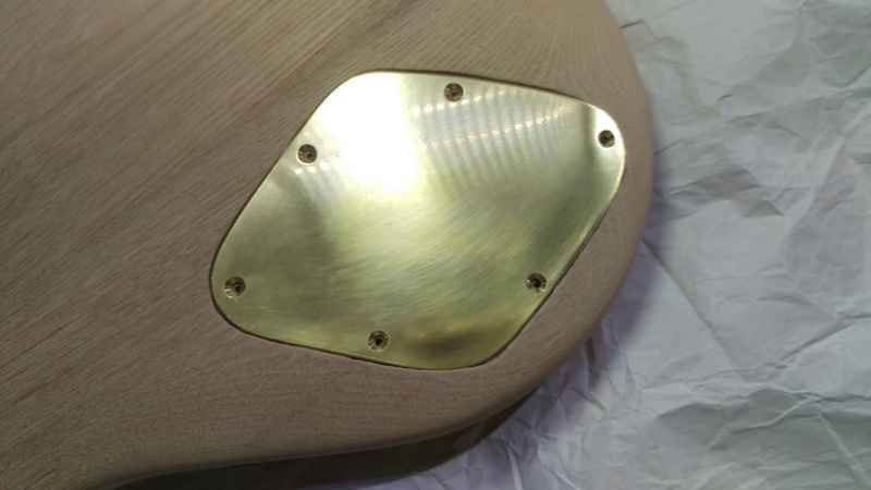

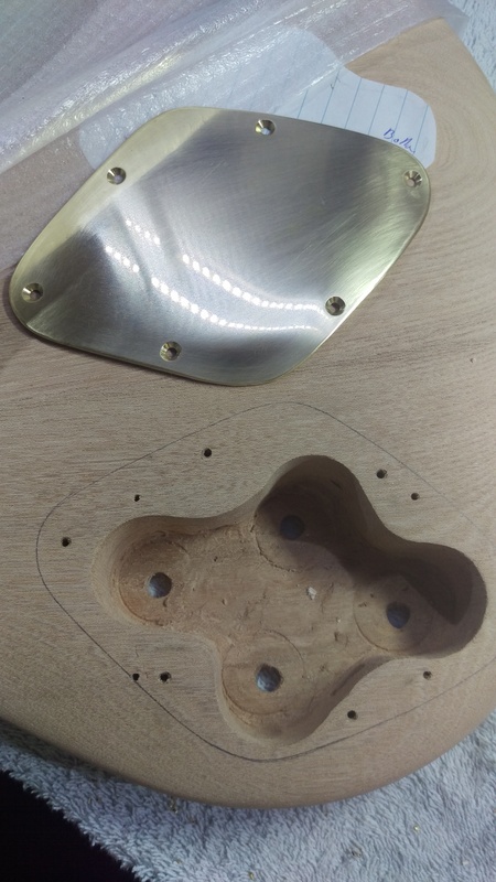

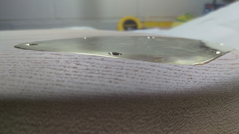

    Firstly, as I said in my last prost I was pretty unhappy with the crappy plastic cover panel that came with the kit. The holes were not in the right spots and I was never going to be able to mount this flash due to the curvature of the body.
    So I thought I'd make another one, and not a plastic one as I'd like this bass to be 'natural' as much as possible, so no plastic, acrylic, etc.
    I found online a sheet of brass, 1.6mm thick and I thought that would be perfect to make a 'gold' cover panel.
    So I started by marking the shape of the cover panel, using the plastic one:
    Then I cut it with the dremel... was pretty long as the disc on the dremel is tiny and brass is not that soft:

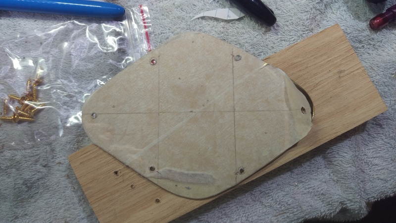

    Next I marked where I wanted the holes to be. I went with 6x instead of 4x to ensure I could have a good fit:

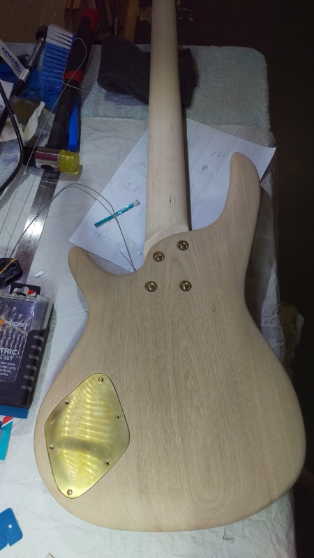

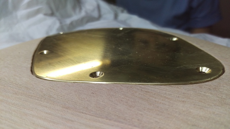

    I drilled these and countersunk the screw heads and I then bent the cover plate by hand to match the shape of the body. That was pretty hard too and it took me about 1.5h...
    And finally I did a first quick polish:
    Was hard work but it looks amazing!
    And on the plus side I shouldn't have to shield this one too much!! :-)
