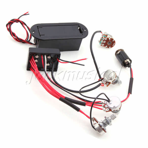

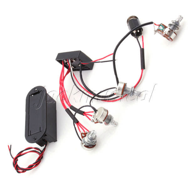

    This is the cheap chinese kit if it helps in some way.
    " 1 Volume + 3 Tone pots with balance volume
    Balance volume for pickup
    Volume:Master
    Bass:+/-12dB at 85Hz
    Treble:+/-12dB at 7KHz
    Package included:
    1 x 2 Band Active EQ Preamp Circuit for Bass Pickup "
