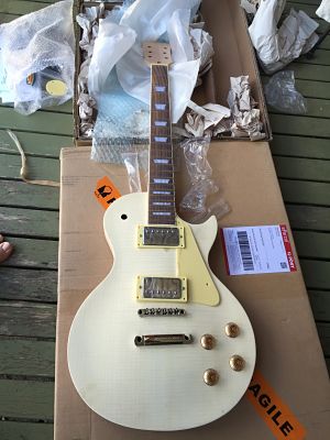

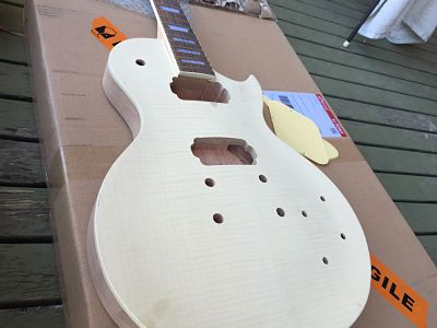

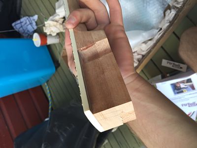

    So i recieved my kit today and i am in love with the flame maple top on it, a few glu spot, nothing out of the norm. i did happen to notice that the maple top on it was thin around the edges and worn all the way through in some spots, very minute and im not too worried about it to be honest.

    Naturally the first thing i did was make a mock build to check everything was there.

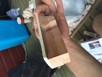

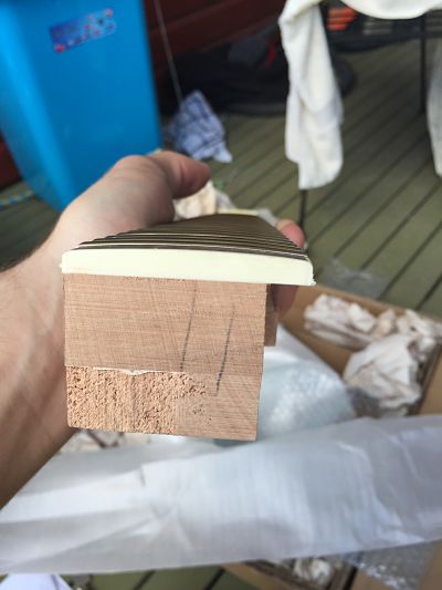

    While pulling it apart again i did notice this
    does anyone know if the neck is suppose to be cut out on the side like this, if so why? does it do anything specific?
    For some things, some times, it's the same time all over the world, and I think we know what time that is...
    kit looks great Kurt,
    yes the neck heel is supposed to be offset like that, the overhanging fingerboard rests on the body.
    I assume the reason for this is a narrower part of the body cutout for the neck pocket should have more strength in the join when its glued
    Hey Kurt, the overhang is normal and correct.
    The semi circular cut out is on all of the neck tangs, I have questioned their meaning myself, and no real answers.
    I imagine it is simply a part of the manufacturing process.
    Moderator dingobass's Avatar
    4,491
    Its a Grubson thing... No reason other than compensating for the lower cut away..
