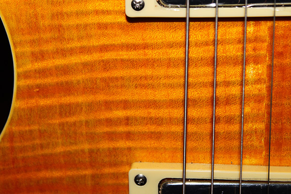

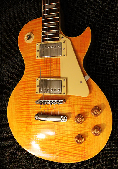

    So the unit in question is at:
    Build diary
    http://www.buildyourownguitar.com.au...ead.php?t=3847
    Skip to page 11 and onwards.
    It was one coat of Dingotone Coolangatta Gold colour, two intensifier and three coats of finishing coat. Then a number of very thin, hand rubbed tru-oil coats until I had the satin finish I wanted.
Name:	Body Finish 01.jpg
    I hope this helps
    Rabz
