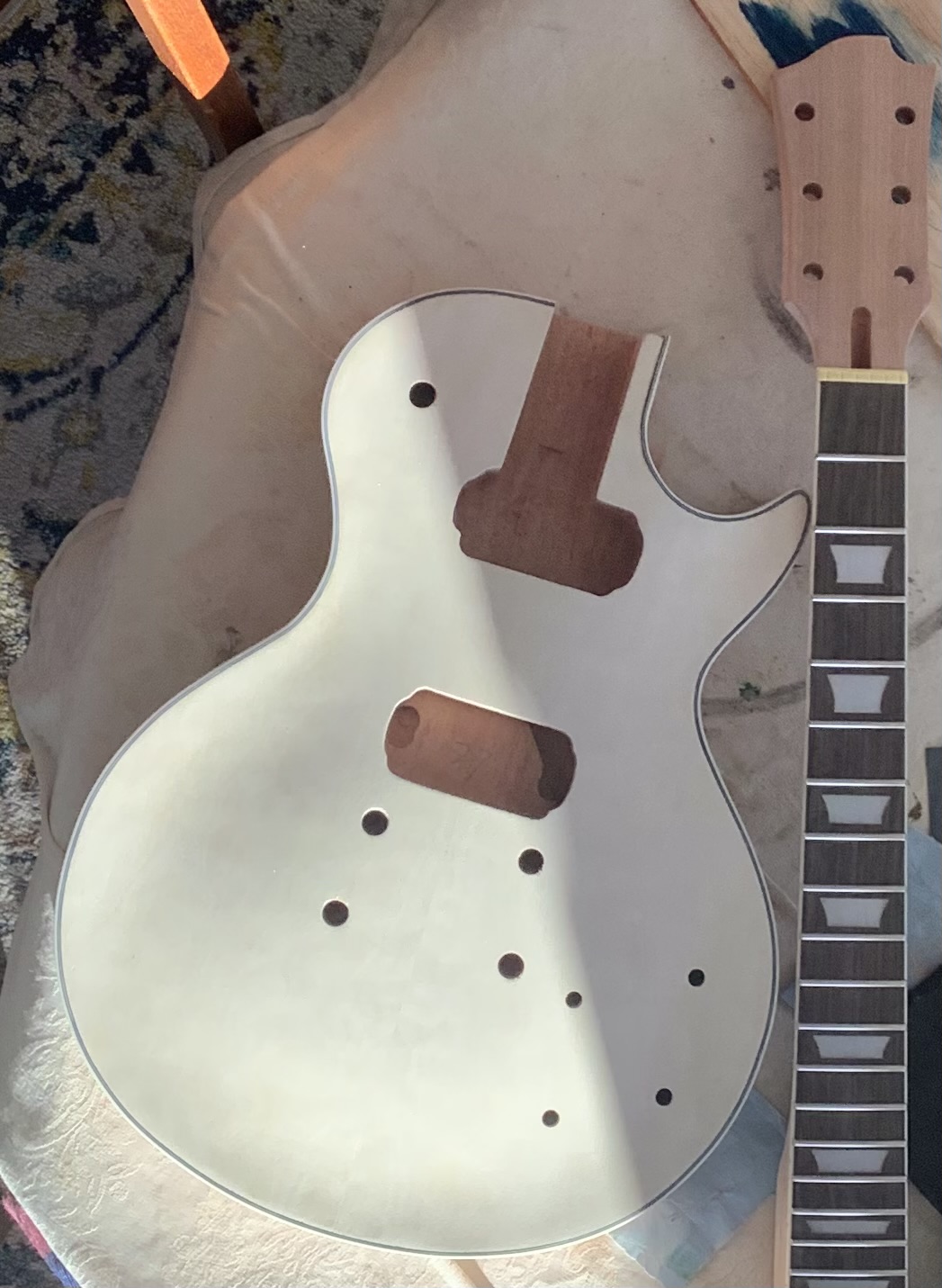

    There’s always another guitar calling for attention so here is my (last) hahaha build. I’m thinking light blue on the top of the body to show up the quilted maple, neck and headstock will evolve after I see what the top looks like. I have had access to ekamant sandpaper but now I cannot find it anywhere, it’s really good paper but where is it, any ideas?
