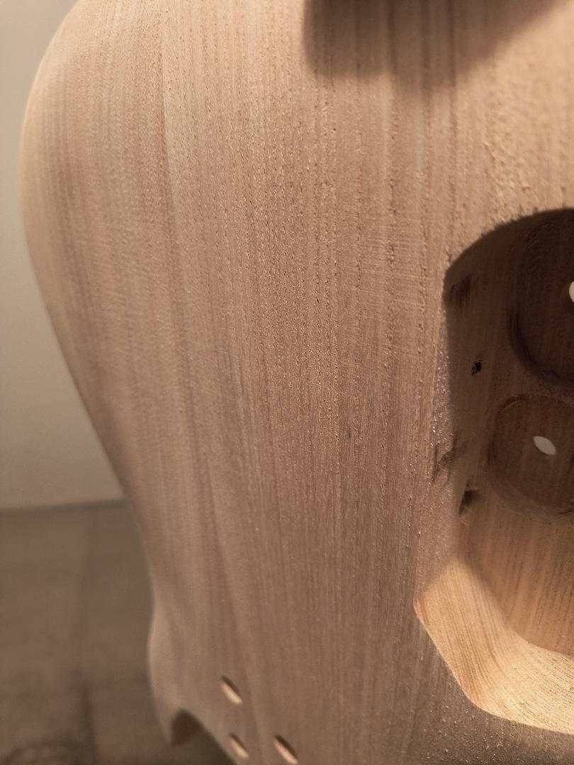

    Was unsure of what level of sanding the body came with out of the box. Started with 80 grit, then 120. I later learned that the body does come pre-sanded to about 120 grit, and that there might already be a coating of wood conditioner. There were some machine marks running across the grain on the front and back, in basically the same location on each side (as can be seen in photo).

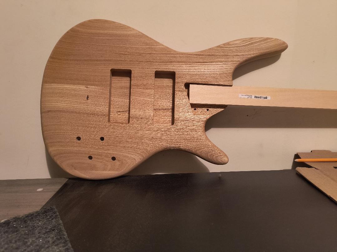

    Repeated sanding (using the #2 pencil trick) only made a small difference each time. After about 6 six passes, including with 240 grit, I decided to stop and move on to putting on a coat of SamaN water-based sanding sealer using a sponge brush. Once it dried, I sanded it down lightly with 240 grit paper.

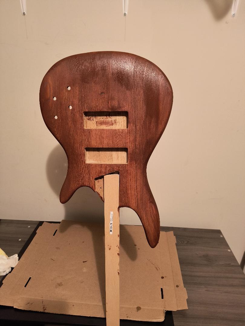

    Next, I did a bad job of applying a coat (or more) of stain. I’m not sure if I should have diluted it a little first, as it seemed to go on kind of thick, but I believe the real problem was my lack of experience in applying stain. As seen in the photos, it was way too thick. Either it was due to my lack of experience, or the wood was super thirsty, causing it to dry very quickly (or both). I tried wiping off the excess with a clean cloth, but was a little too late as it got thick and tacky in less than a minute. Lesson learned: have a cloth ready to wipe the excess stain off within about 10 to 20 seconds, and don’t do a large area all at once.

    Luckily, a lot of sanding got the the stain back to a decent looking level, eventually with little visible blotchiness. The top edges between the “horns” and the neck pocket were the hardest to get to a decent level. I went from 80 grit up to 240 grit, and even tried 400 grit to see how well it worked. I then saw a video where it was advised to not go more than about 120 grit between stainings, so I went back and tried to rough it up a bit with a quick sanding using 80 and then 120 grit.

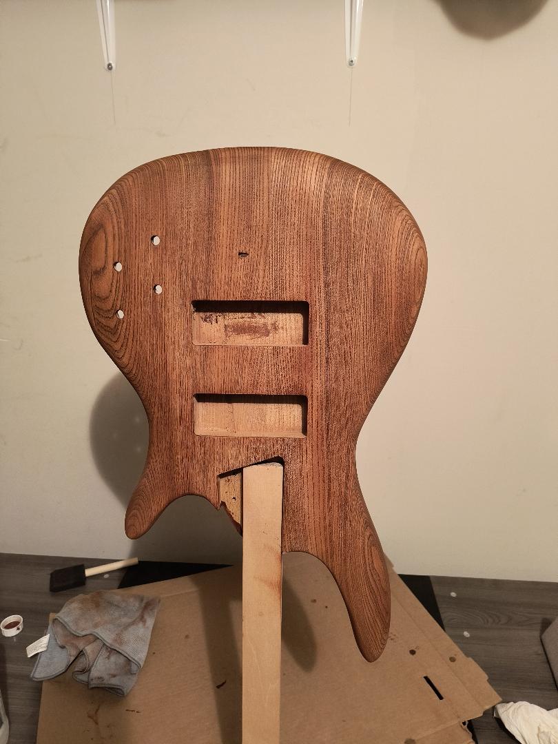

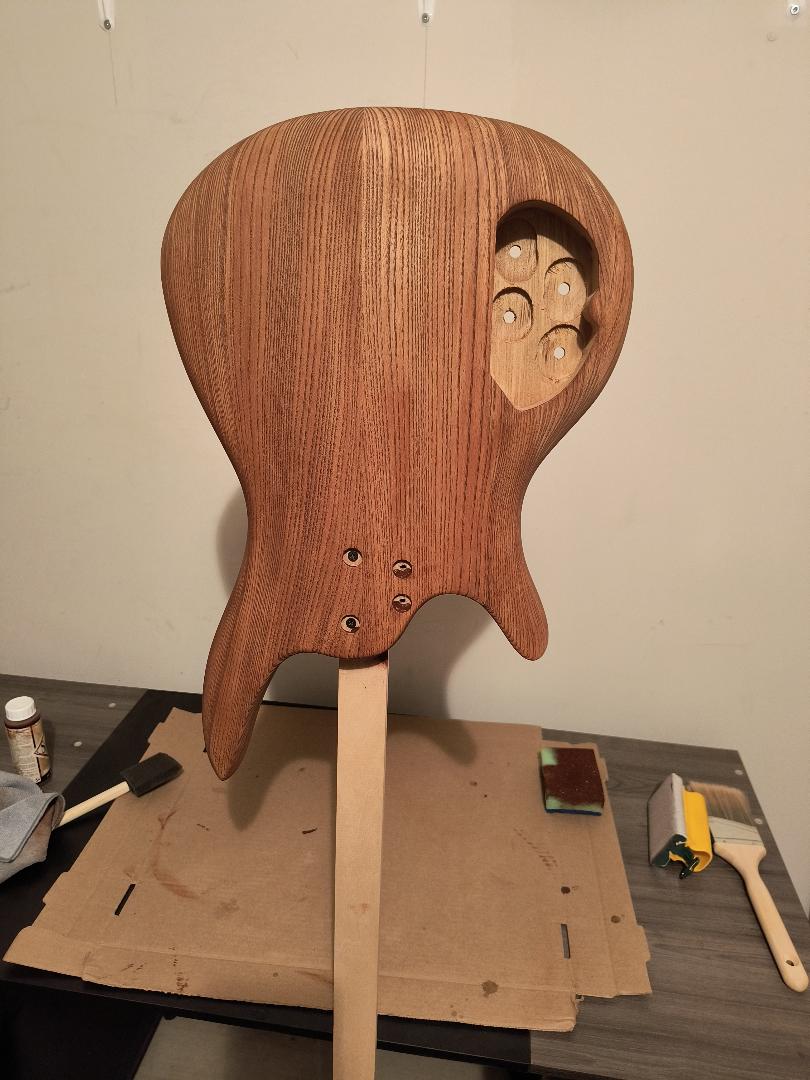

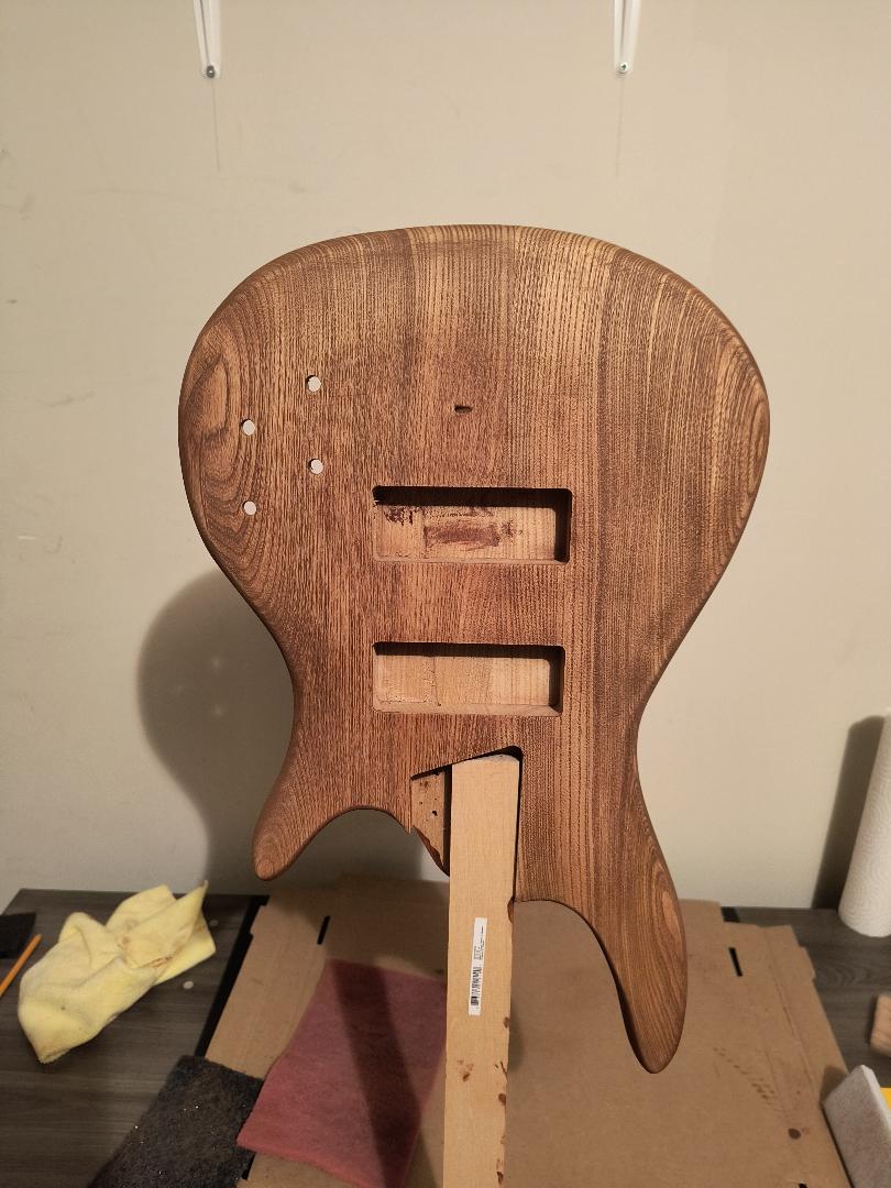

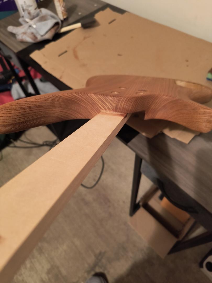

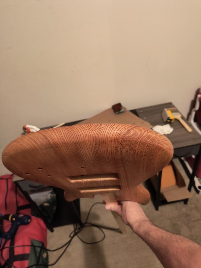

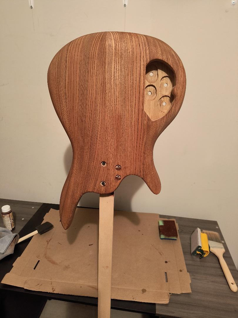

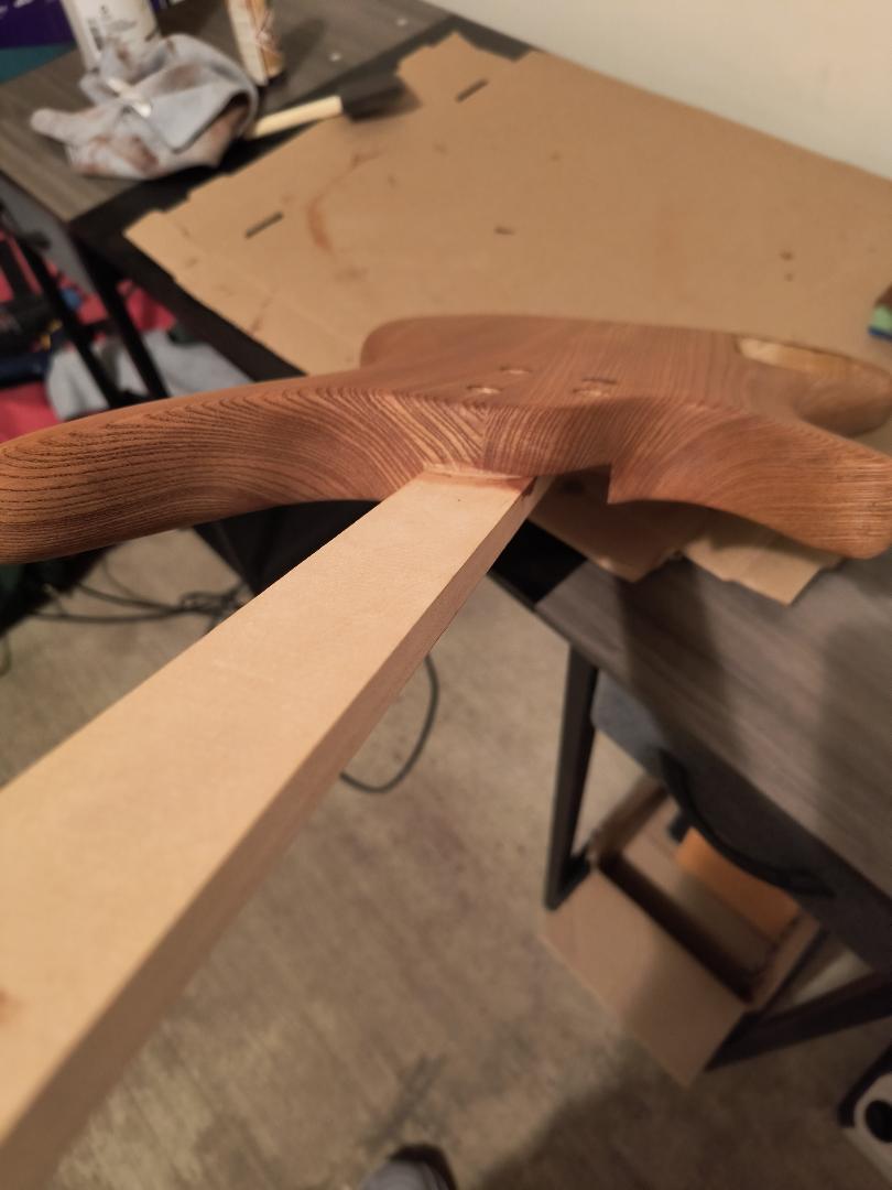

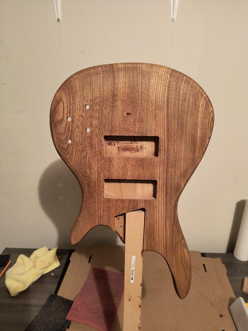

    Second staining went pretty well. There were still some spots that wanted to stay thick and not wipe off, so I used very judicious swipes with a damp cloth to coax it to a level that matched the surrounding level of stain. It’s at about the level of darkness that I want, but I saw or read that subsequent coats of grain filler and sanding sealer will probably lighten it up a bit, so I will put on one more quick coat of stain. The front looks pretty good, and I plan to make it the same as the rest of the body, just in case I have to scrap the decal idea for the front. The machine marks I tried sanding out came out pretty well, very hard to see, but I had not noticed the machine marks running along the bottom curve-edge. Not super noticeable to the naked eye, and will be covered by the decal unless that doesn’t work out.

    2,853
    Quote Originally Posted by Pat Rodgers View Post
    Hey, fender3x, I'm not too great with stain either, by my initial results.
    Well... I'd be pretty good with the outcome your're getting!
    Water based top coats don't tend to change the color much, so I don't think it will darken it much. If it were me I would put a couple of coats of dewaxed platina shellac between all of the water based products. Platina doesn't add much color, and it will help with pulling. Brushing tends to pull a bit more than spraying, so I end up using the shellac a lot. What will you be using for top-coat? I have just switched to using BriteTone from Crystalac. Prior to that I used General Finishes High Performance--which I definitely do NOT recommend.
