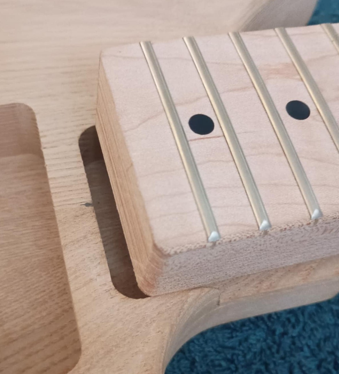

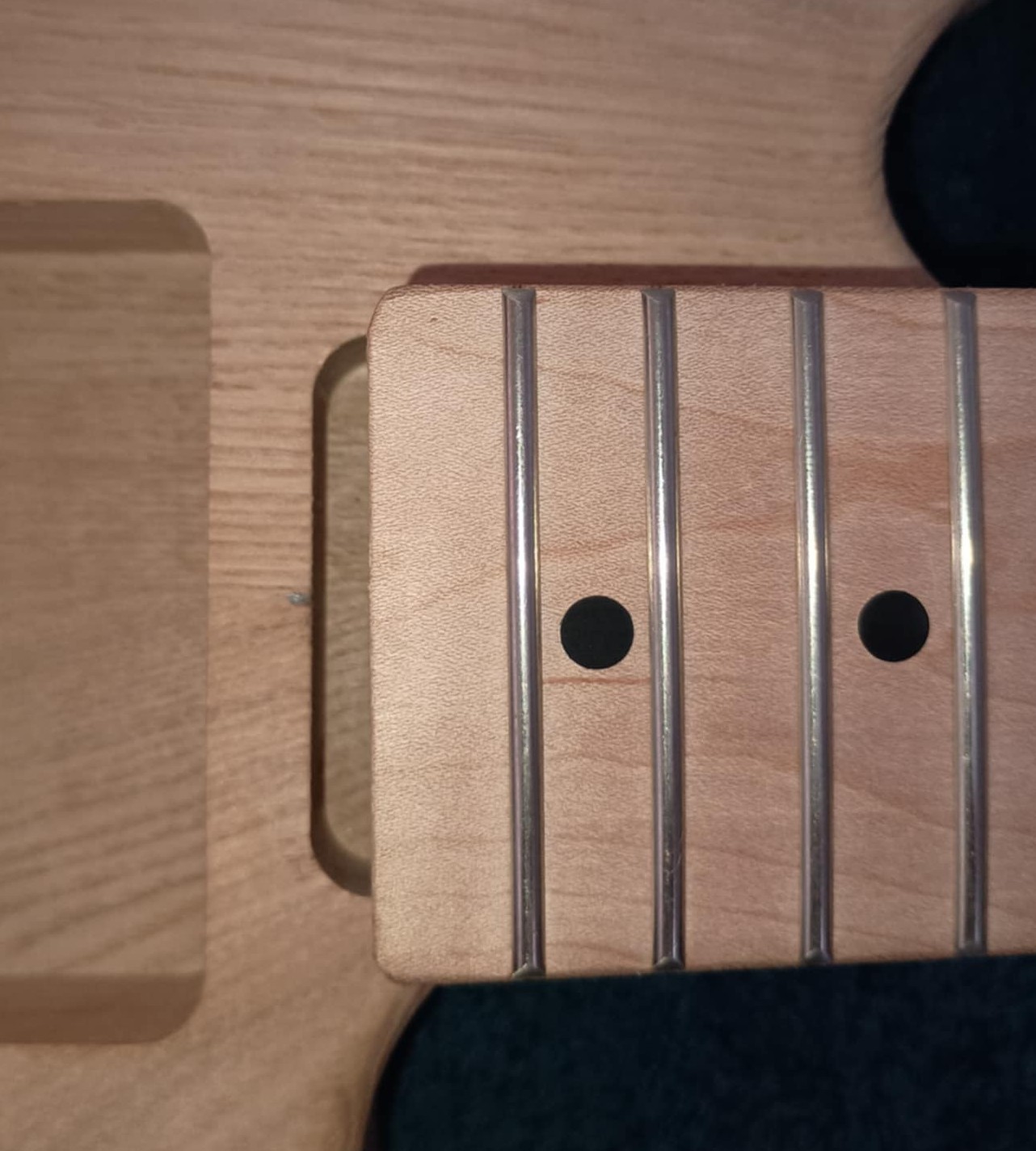

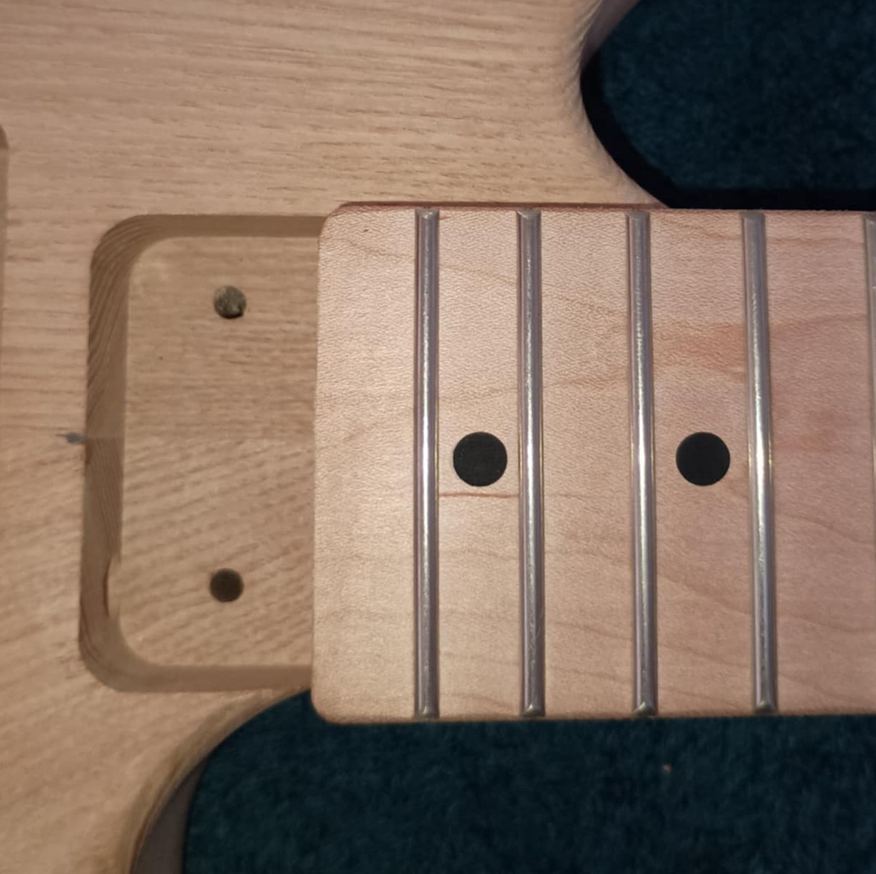

    Hi crew, Ive got a mismatched body & neck that has me stumped.
    Ive got a difference of 2mm that needs shaving off either the neck or pocket which scares me in itself but my biggest concern then is getting a snug fit around the corners of the heel.
    Have I got a strat neck here instead of a tele?
    Can a strat neck go onto a tele(master) & not cause saddle height problems down the track?
    Can I simply cobble it together & hope the pick guard hides any horrors?

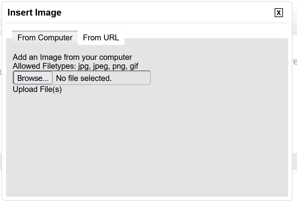

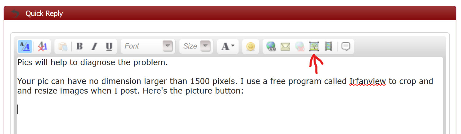

    Pics will help to diagnose the problem.
    Your pic can have no dimension larger than 1500 pixels. I use a free program called Irfanview to crop and and resize images when I post. Here's the picture button:

    It will open a window that looks like this:

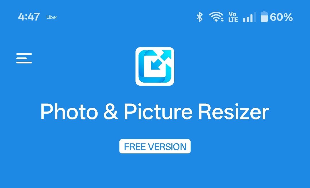

    On my android I use this, BTW Click image for larger version.

    Looks like I've got this attachment thing sussed..
ID:	45573   Click image for larger version.

    2,034
    It is a PBG tele neck. So that is good! The neck is tapered so it can only be pushed down (perpendicular to the body) into the recess. It does look like the curved ends of the neck heel will need to be sanded to match the curvature of the recess (which is quite common). Hopefully, that is all that is required.
