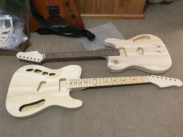

    From this angle - it looks like that headstock is angled - wish I could find one!

    "From this angle - it looks like that headstock is angled - wish I could find one!"
    They are both flat headstocks, both Pitbull Tele!

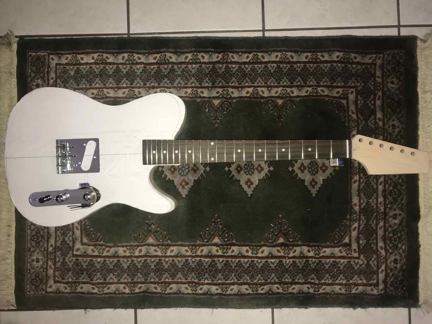

    This is it so far (the lower horn will get shaved a just a little more (you might see the pencil mark)

    I've decided to keep the original neck socket position (just shaped for a "strat" neck) it turns out I'll only need to move the bridge/pickup positions about 7 mm forward.
    2,993
    That sounds about right to me. The difference between your neck and a standard scale F neck should be about 19mm. Half of that is the nut closer to the body, so the bridge would only need to be ~9.5mm closer to the neck pocket with a standard rout. A difference of 2.5mm should be well within the saddle travel of a Tele bridge.
    One piece of advice that I have gained through hard experience: Don't do the final placement of the bridge until you have (a) routed the neck pocket, and (b) dry fitted the neck. You want to make sure that the strings line up properly along the neck and over the pickup. And you will want the saddle for the high E string to be 24.75" from the nut. Of the two measures I generally find getting the strings lined up over the fingerboard and pickup to be the more challenging of the two. There's usually enough adjustment to move the saddle forward or back a little, but there's no easy way to adjust the bridge laterally once you've drilled.
