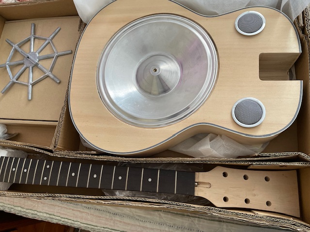

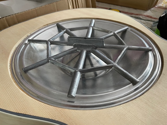

    Looks good in the box:
    5 ply basswood body looks nice. Triple binding on top and single binding on back.
    The back is arched.

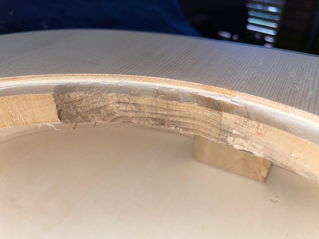

    The cone ledge looks like paulownia pine - the corners need a bit of sanding. And a few glue drops will need to be cleaned/trimmed off.

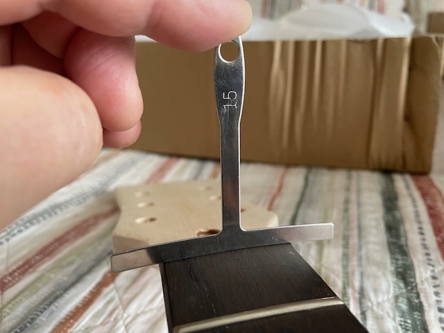

    Looks like the neck curvature is 15".
    Scale length - back of nut to 12 fret is 322 mm, so the scale length will be about 648 mm.
    Mock build to follow.

    Interesting that the radius is 15". Usually all kits have been 12". I would hate to have to get another sanding block ;-)

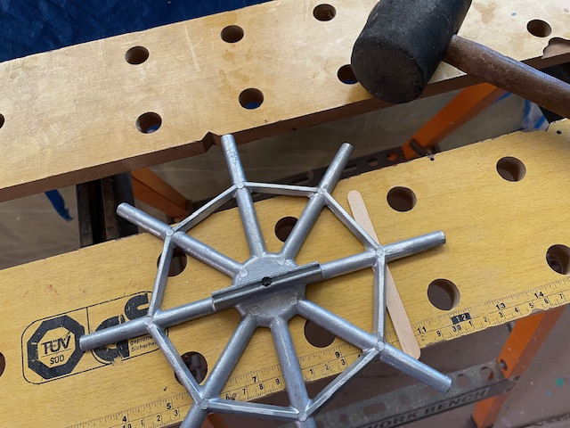

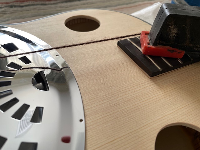

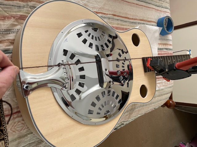

    I have sanded around the cone ledge wood, and used a razor blade the remove the excess glue spots around the rim. The cone now sits flat on the ledge. The spider had one leg sitting a bit higher than the others, so I used the Stewmac technique of raising the inner part of the leg on a shim and gently tapping with a rubber hammer. Worked well.
    Then did a bit of a mock build to test for string alignment and height.

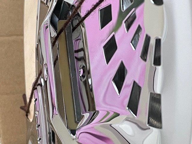

    The string alignment seems good and easy to adjust by moving the cone/spider/bridge combo around the ledge and/or moving the tail screw. (This is also how string length is changed)
    String height seems a bit uncertain as the strings will compress the spider and cone. I assume this can only be done correctly at the end of the build! At least the height of the bridge can be adjusted by sanding the base of the saddle or adding a shim. The saddle also needs to be cut at the middle so as to gain access to the screw/bolt holding the spider to the cone.

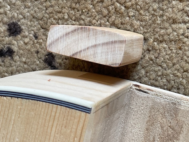

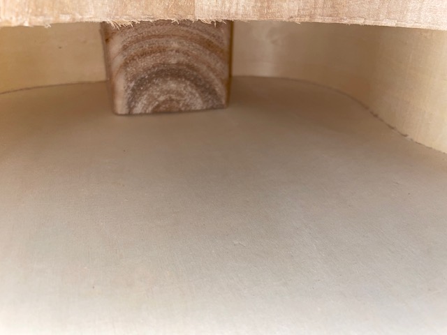

    One thing that did concern me was the fact that there is no block on the top shoulder to anchor the strap button. So, I made a pine block, shaped to the outside curve of the body, and glued that into place.
