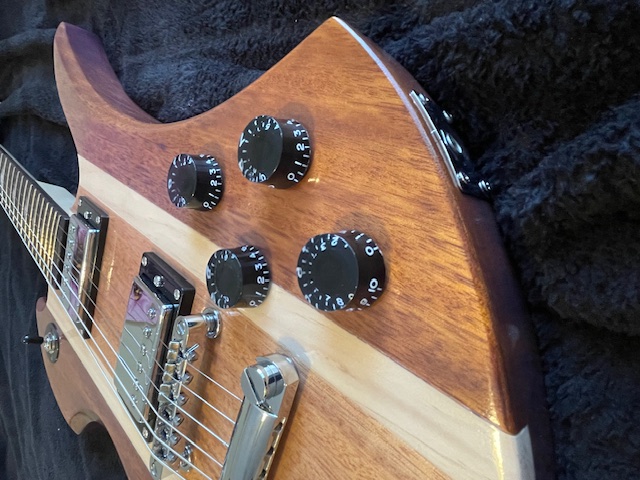

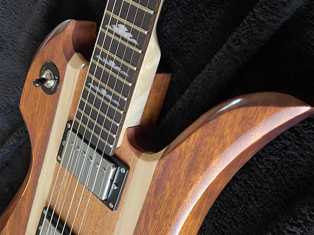

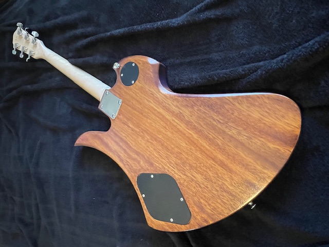

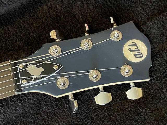

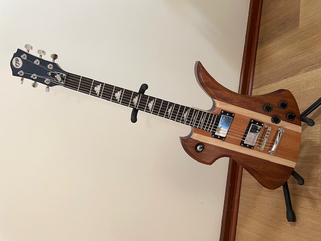

    Mahogany Body with pine inlays. The wings are stained with Feast Watson Old Baltic. Finished with 2 brushed on coats of wipe-on poly, then sprayed on coats of Cabot's water-based gloss polyurethane. The headstock is painted with MTN 94 black, and final coats of Cabot's poly. The logo is a pearloid disk with a Cricut vinyl sticker. Truss rod cover is made from 3-ply pickguard material with Cricut vinyl sticker of the MB.

    It really looks like one of these totally out of reach Mockingbirds that I used to only see in Guitar Player Magazine in my High School's library in the 1970s.
    Hope you'll put up some pics in the Headstock gallery!
