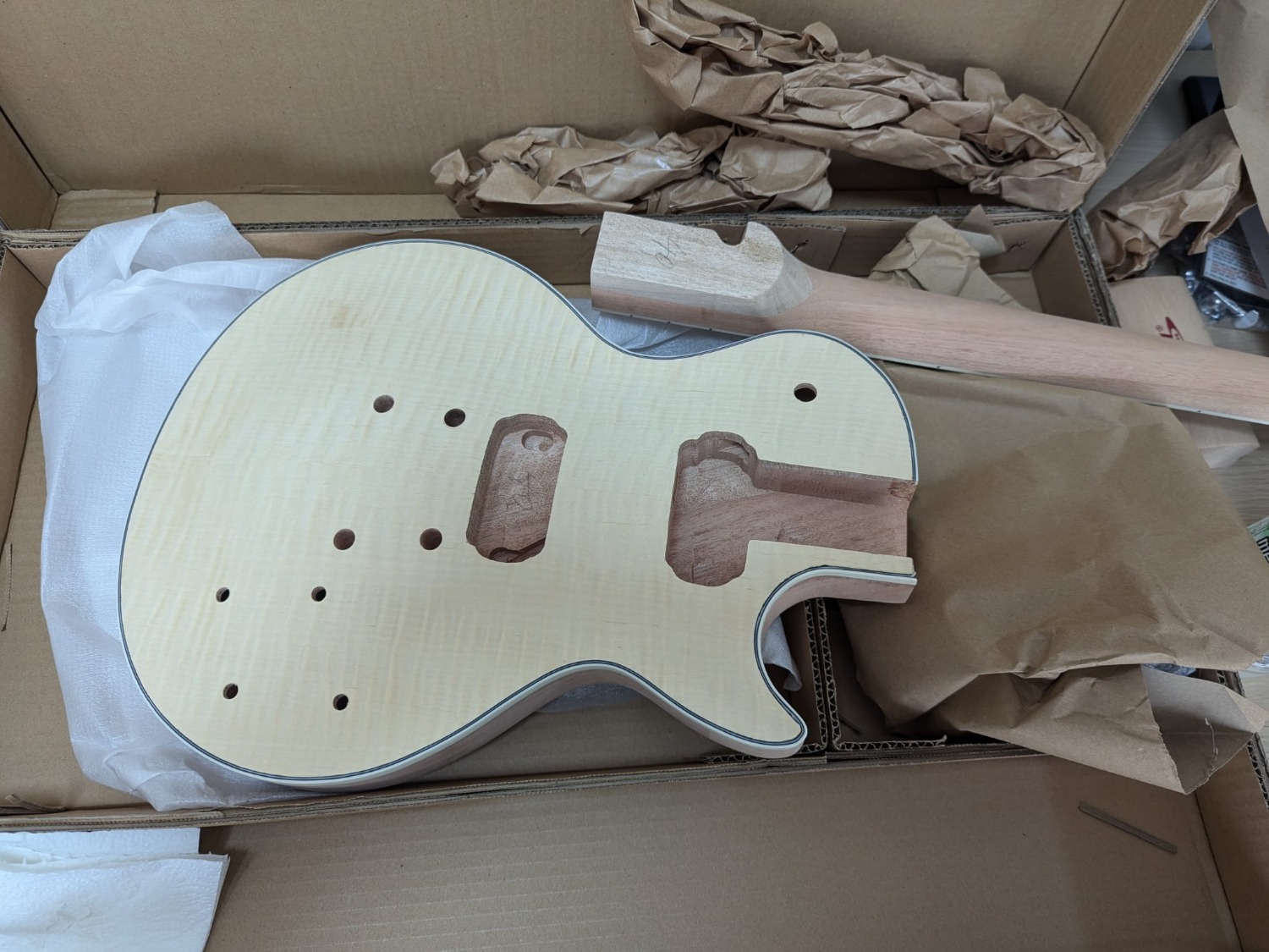

    Just ordered the kit for my first build ever.
    It's one of the discontinued kits, a single cutaway guitar with mahogany neck and body, plus a flame maple veneer.
    I have some initial finishing ideas in mind based on what I have read here, but would love your input. Please tell me if I'm doing something dumb. I am a big fan of the dyed/stained see-through look in general. On the other hand, I already have an ash 2-tone sunburst (54 reissue) Strat which is brownish/yellow, so I want something considerably different.
    I'm thinking of a dyed/stained reddish look for the top. Planning on dyeing it with a really diluted black ubeaut water based dye to accentuate the flame, then going for the red.

    The veneer is super thin and delicate. I should add that I am much better at messing up veneer than at staining it...but with that said... I would sand the veneer just as little as you can get away with. Using dark grain filler and sanding back is great for solid wood, but I would worry about going through the veneer. You really shouldn't need grain filler on maple anyway. On the sides and back, sure, but I'd be very careful with that top. For the same reason, you'll want to be very careful about accentuating the flame, particularly if it means doing any sanding. Just my non-expert thoughts.
