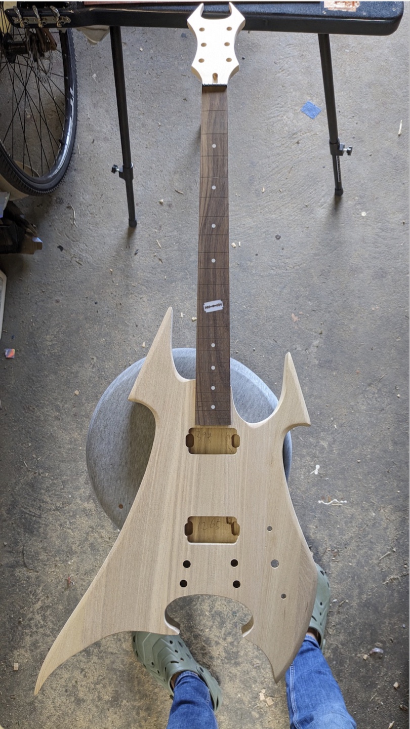

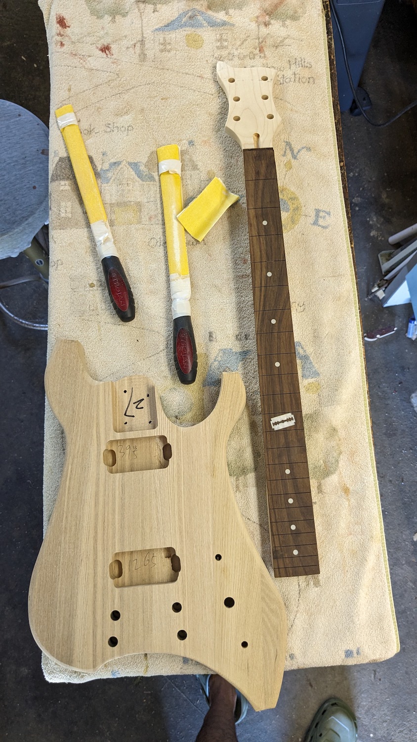

    soooo.... this happened.
    Pitbull had this among the specials and I couldn't resist...

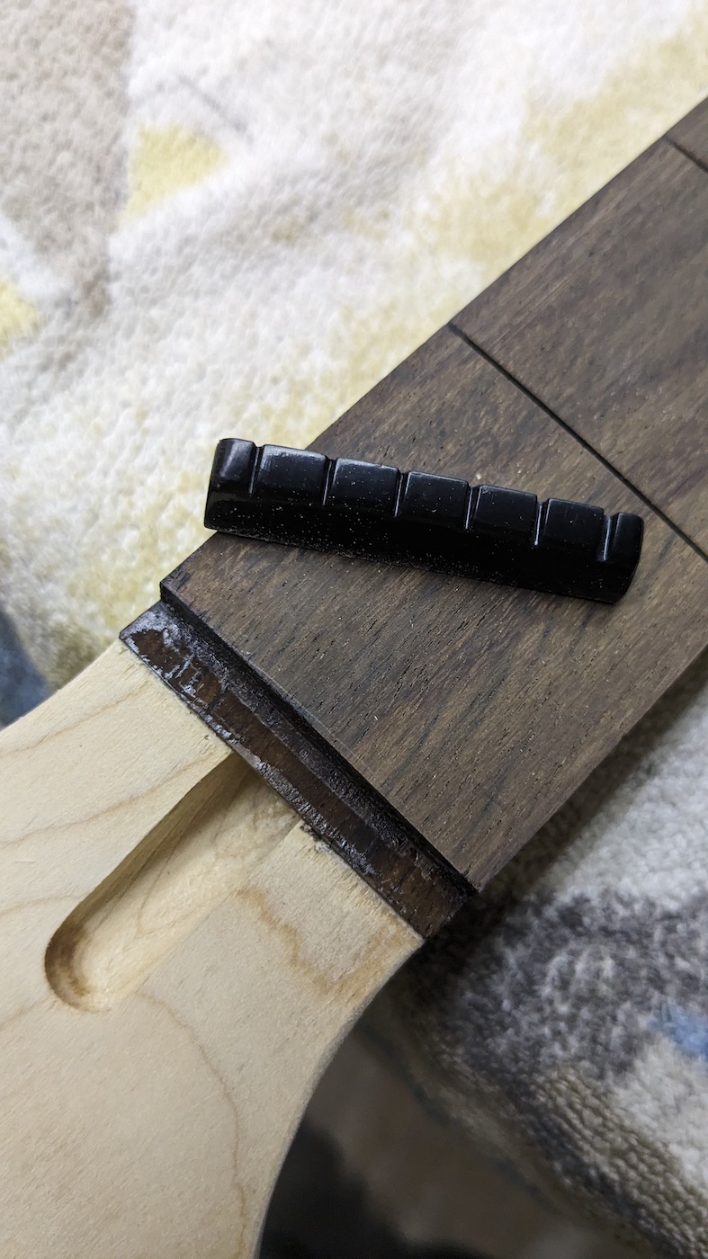

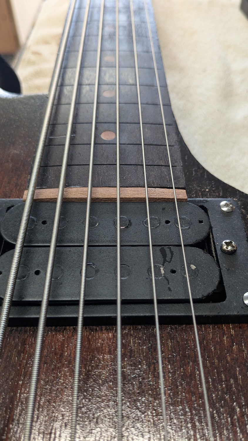

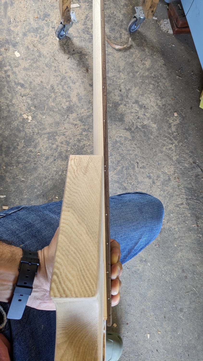

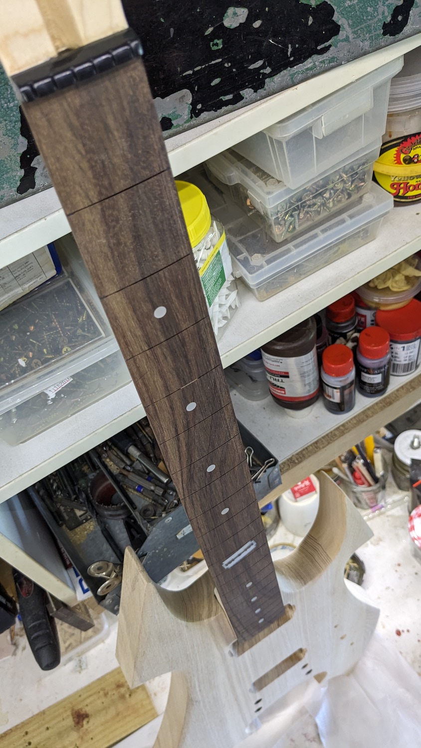

    30" Baritone guitar, the plan is to keep it fretless...
    After a quick dry fit, it all seems ok, except:
    # the neck pocket is a little bit abundant. First time I experience this on a Pitbull kit
    # the neck seems a bit "angled away from the body" (see photo below). Not sure, perhaps it's normal on this type of instruments. Haven't checked with the bridge height yet, worst case scenario the next will need some shimming.
    # the strings provided with the kit are too short (this is a 30" scale)
    # in terms of strings, I am doing some research, for 30" baritone some people recommend bass VI strings. Not sold on this yet, and lots to read about strings tensions and type of tunings... Standard B, or E one octave lower (basically like a bass)...
    # all the electronics came loose and will need to be soldered. I am not an expert but one or two bits and pieces seem missing to me (nothing major, like, there's no capacitor, and maybe something else missing, not a biggie though, could be fun)
    # advertised as ash, but it feels very light (again not an expert, but way lighter than the fretless PB4 ash I build some time ago)
    # the bridge pickup slots is slightly too small, the pick up fits "just", will have to use a Dremel to gently carve 1mm or so

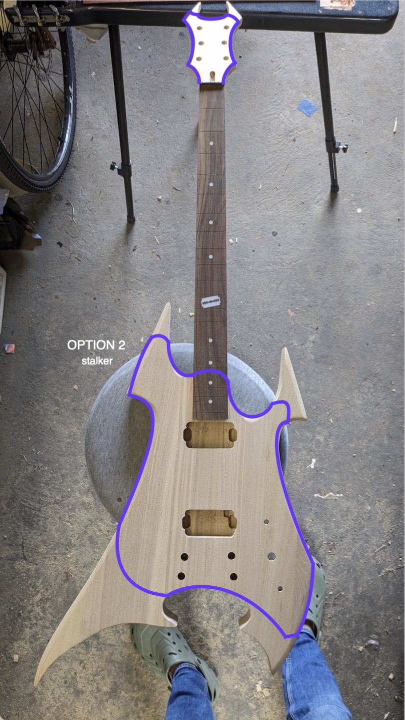

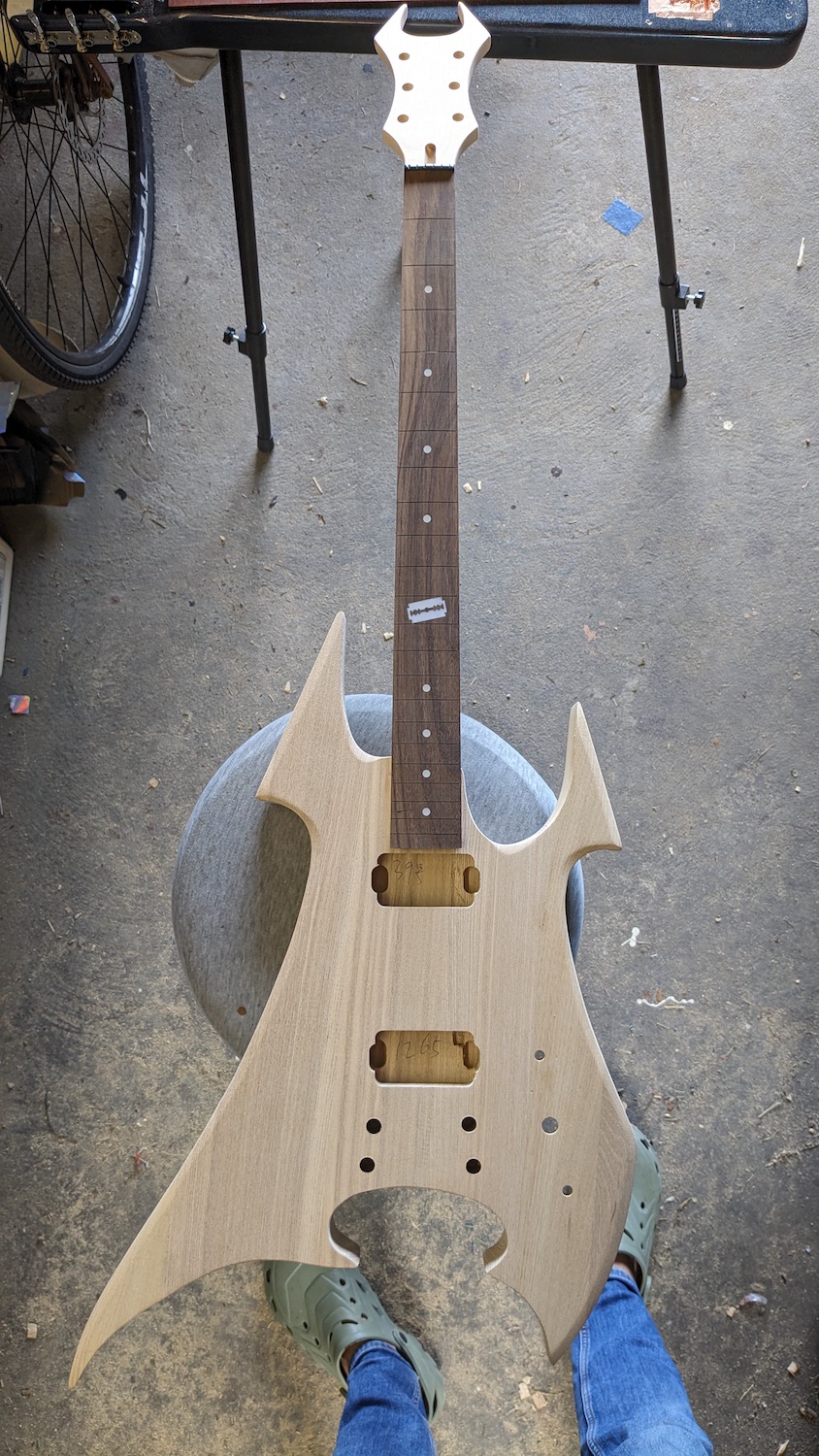

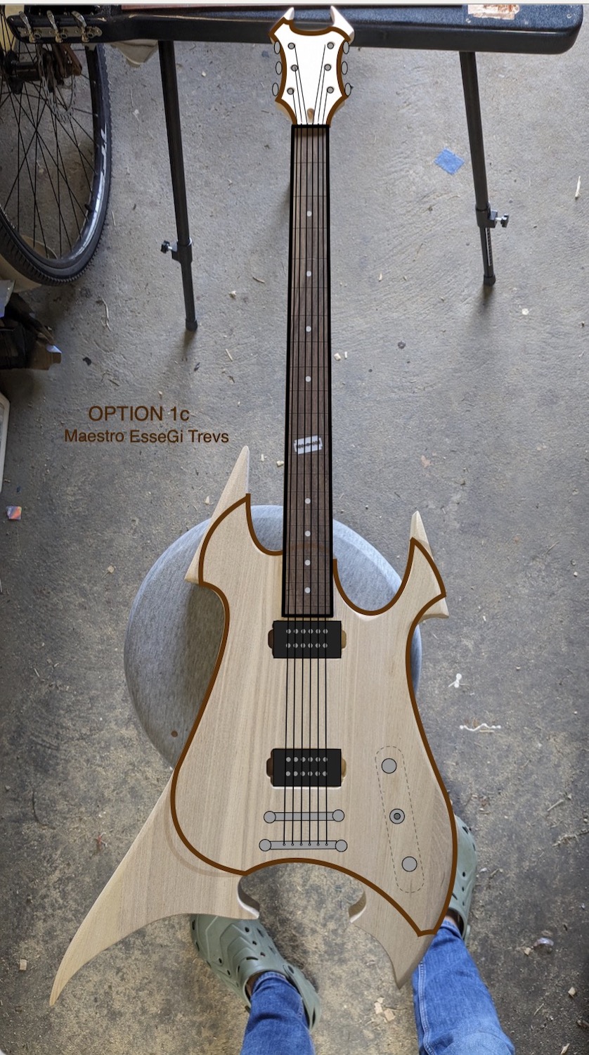

    I have done my good years playing metal and cover bands and all that, I think the body and head stock look great on this kit, but the idea is to mod them to make it less aggressive, still maintaining some interesting angles and shapes of the original design
    here some ideas I just sketched
    #1 Maestro

    #2 Stalker
Name:	02_Stalker copy.jpeg

    Currently more incline towards #1 and #2
    Here a couple of "blank" photos in case someone feels like drawing something to share and idea or two! I am open to suggestions!!!
Name:	01_base copy.jpeg

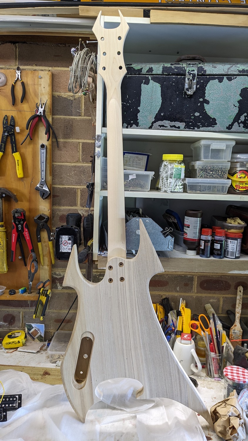

    .and here a photo of the back (notice the electronics cavity position, sort of far back into the body)
Name:	2023-12-22 15.46.20.jpg

    Nice pickup. I will admit that I was also looking closely at this kit!
    I think the neck being angled away from the body is to compensate for the high tune-o-matic style bridge.
    I recall that Simon B has mentioned the black ash versus the white ash. Black ash does has a lower density.

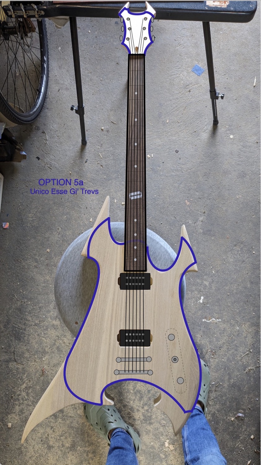

    here we go: (I like to sketch it out as it helps visualising it a bit better)
    #6 Maestro EsseGi'
Name:	08_Essegi MAestro copy.jpeg
    #7 Unico EsseGi'
Name:	07_Essegi Unico copy.jpeg
    Anyone else?

    Hi FaustoB,
    Your drawing #7 looks good to me. You mentioned the body feels light, and with a longer scale length there may be a potential neck dive issue. Keep as much as you can on the upper horn so there is room for playing with strap button placement (won't be a lot but something to think about).
    This is a one off, so it would pay to check the neck angle is correct with the bridge you will be using. Being a bolt on, adding a shim if needed is easy enough.
    It's a bold shape, do you have a bold colour scheme in mind?
    Enjoy being creative with this one.
    Grant

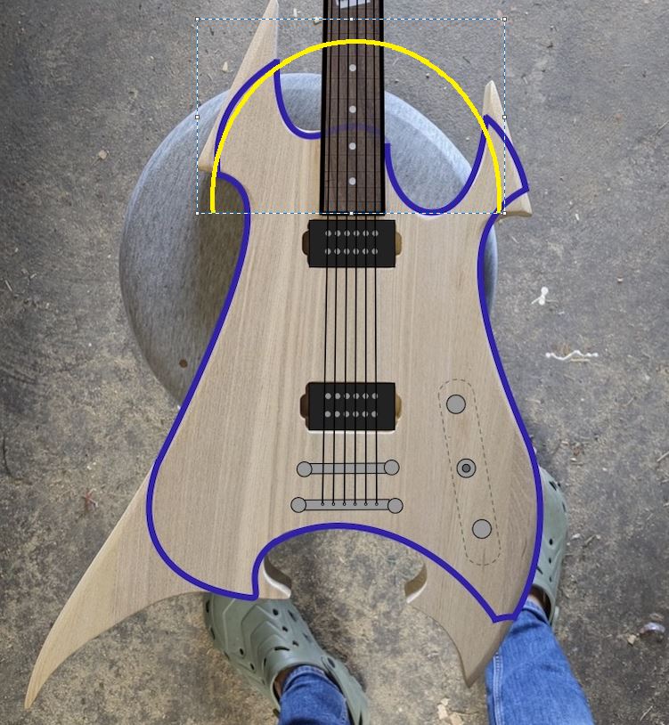

    2,038
    #6 and #7 are much better IMO. Please note that I have no art skills at all!
    Still my 2 cents:
    the right horn looks too much like Shrek's ear trumpet! Maybe the curve needs to be the same as the left horn!
