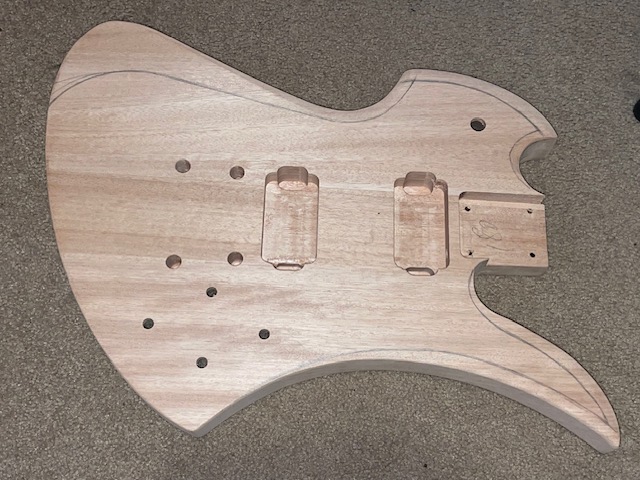

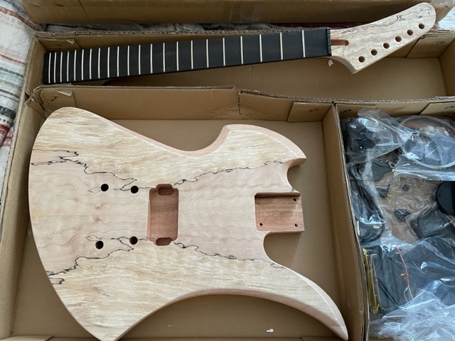

    I managed to purchase the Custom MBM-1 from the specials last week. Mahogany body and neck with a Spalted Maple veneer, reverse hockey stick headstock, and no fret markers. The kit arrived with no hardware - but Adam has since delivered a black hardware pack (thankyou).
    The kit looks good in the box. Not sure when I will get around to starting.

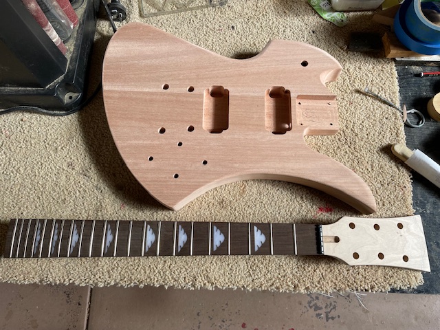

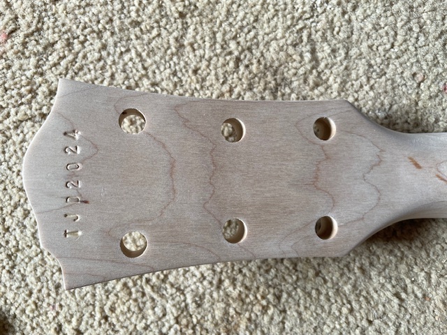

    Before I purchased the Custom MBM-1 kit (mentioned in post 1), I had purchased a standard(!) MBM-1 kit. I have finally got around to starting this.

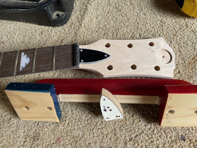

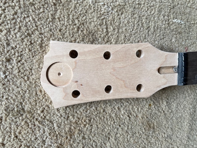

    Starting with the neck I have sanded to 240 g, shaped the headstock, drilled out a shallow 30 mm hole for my logo on a pearl disk, stamped my serial number on the back of the headstock, cut out a 3-ply truss rod cover, fret levelled, fret filed, filed the fret ends and polished the frets.
    I'm still (for the last 12 months) thinking/deciding how I want to finish it!
    Next, I will make the body contours a bit larger and increase their angle a bit.

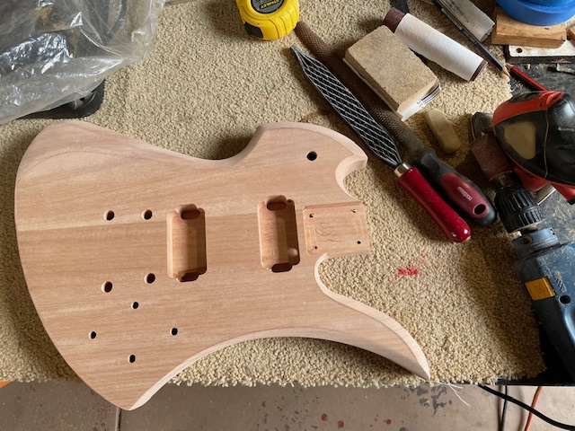

    Body contours including a belly contour and arm contour have been added. The before and after shots, including the tools used.
