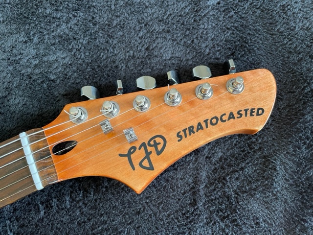

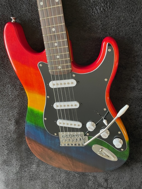

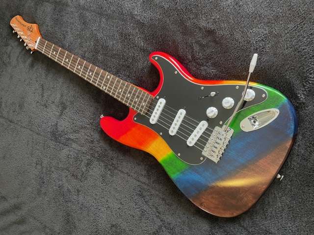

    Another work build!
    The body was stained with Ubeaut water dyes (diluted to 25%, 2 coats) Red, Orange, etc. The purple (!!?) was a mix of red and blue. The neck is 5% cedar. The body was given 3 brushed on and 6 wiped on coats of Tru-oil. The neck was 10 coats of tru-oil. Both sanded along the way up to 2000 g. The headstock logo is a Cricut vinyl sticker put on after coat 3. The serial number is stamped on, filled with ebony Timbermate and sanded flat before the stain and Tru-oil.
    Stock hardware except for the black pickguard.
    Not my usual as far as colours go! I was trying to use all the colours in the Ubeaut water dye set! (I should have used the black instead of my purple). I used masking tape to guide the placement of the colours, and then tried to blend the edges (which was quite difficult).
ID:	44814   Click image for larger version.
ID:	44815   Click image for larger version.

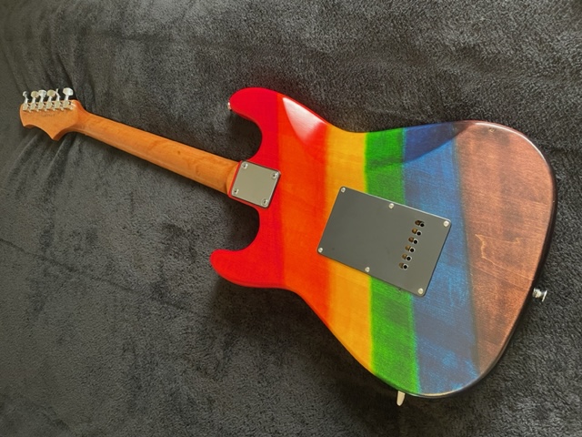

    Looks lovely @Trevor Davies. Did u shape the headstock? Do u have pictures of the back?
    Sent from my NE2211 using Tapatalk
    1,979
    Quote Originally Posted by Drashkum View Post
    Thank you. Yes, I did shape the headstock. It was from a template I made for my scratch tele builds. There is a link to a post here:
    https://www.buildyourownguitar.com.a...l=1#post222831
    The back:

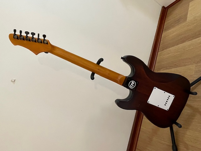

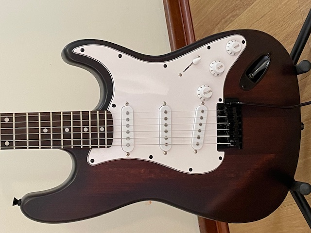

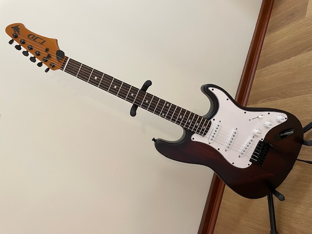

    Another work build.
    The body is stained with Ubeaut water-based cedar dye (100%), coated with wiped-on tru-oil. I have also added a few sprayed coats of Cabot's water-based gloss polyurethane, 2 burst coats of Cabot's water-based gloss polyurethane with a black stain, and finally 4 coats of Cabot's water-based satin polyurethane. The satin final coats was an experiment to see how satin it ends up! Also, whether the w/b poly can go onto the tru-oil. I also have not polished it.
    The neck was finished with a Cabot's cedar stain and finished with Cabot's water-based satin polyurethane.
    This kit is a mismatch of hardware - Black hardware, but a white pickguard and pups! I'm happy with the white guard on the front, but I think I will change the back cavity plate with a black one when I can source one!
ID:	45091   Click image for larger version.
ID:	45092   Click image for larger version.
    3,047
    I like that last one...and generally the results you are getting with the Ubeaut dies. I have never seen them here...but you are certainly getting good results.
    I also liked the neckplate...curious how you did it?
    1,979
    Thanks fender3x. The neckplate is simply a vinyl sticker. I'm not sure how well it will last there, but it is a "permanent" sticker! I have placed a sticker onto the pickguard of another build, and it seems to be holding well.
    I'm using these work builds to try some different things, and show off more options, that I would not try on my own builds!
