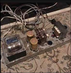

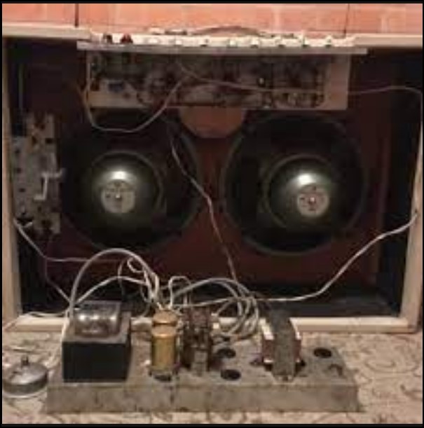

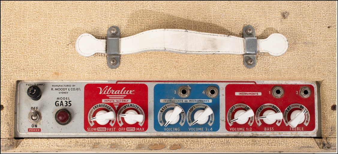

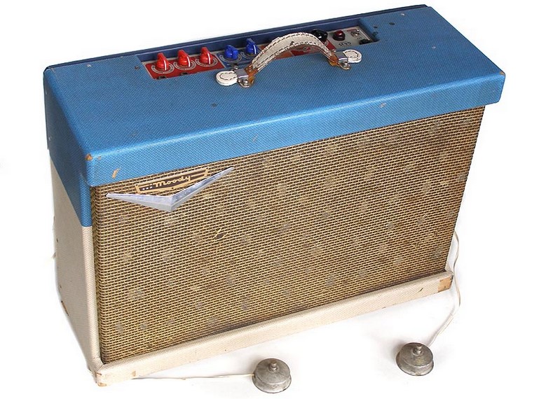

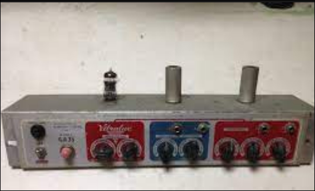

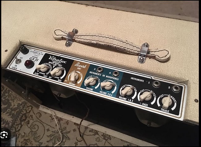

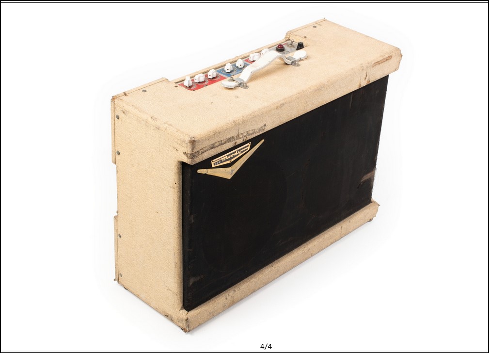

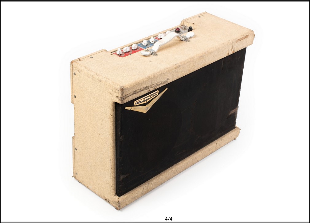

    Come on guys i had a two tone blue and white one of these with a hounds tooth grill with rola plesseys in it years ago and althought not a screaming 50w from 2 el,s it was about the best & coolest sounding open backed guitar amp i ever owned and i have owned many Aus made vintage guitars amps several Goldentone basmasters & guitar combos & heads maton 60 watt combos and lots of others i picked up over the years, how about generating a copy of this very cool Aus made circa 1963-4 amp for us to build in 50 watts class a-b or 35 class a as the original, it was made from ply wood the cab and the knobs were chicken heads 2 el 34,s 3 ax7s from memory the volume was "soft & loud" and the bas & treble read "boost & cut" it also had a great reverb and vibrato i loaded it with real greeback 25s at the time and had the best sounding open back amp i ever owned, i would pay money $$$$ to be able to make this as a kit, i rekon others would too its such a cool amp and uniquely Australian with respect always,
    Check him out folks......it has 2x12,s its a bit bigger then you think but not huge i tells you in person they are the ducks guts of very cool ozzer valve amp design i swears. Mine also came with a midrange horn above the 2x12,s in it but it blew however when it did work the combination of 2x12,s and a horn was outstanding for lead and just gave it a very overall great range of sounds anyhting sounded good in it.
    Made in Sydney.

    I had the two tone blue and white one with red pre amp face etc, oh man i miss that sweet singing ozzy amp.
    Dear Guitar Gods please make it happen lol.

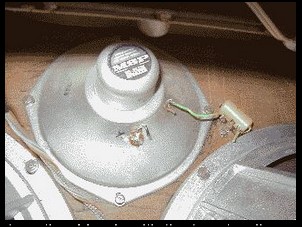

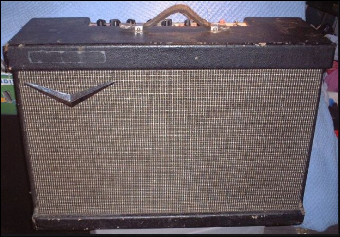

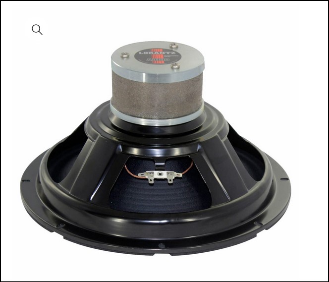

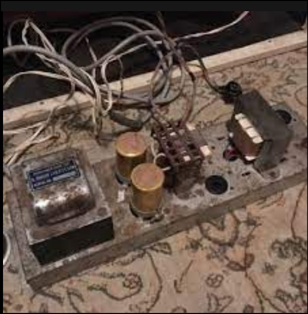

    Heres the midrange it had but mine was disconnected as well, i did wire it in but it blew i was spewing i loved the extra chirp it gave just not a powerful enough speaker etc.

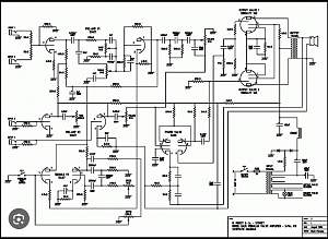

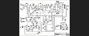

    You may be able to order the majority of the parts and chassis from this website, they're based in Australia, and I've had great service from them:
    www.evatco.com.au
    I would very strongly recommend setting-up an account at their website.
  7. Liked by: david bodycomb
  8. #6

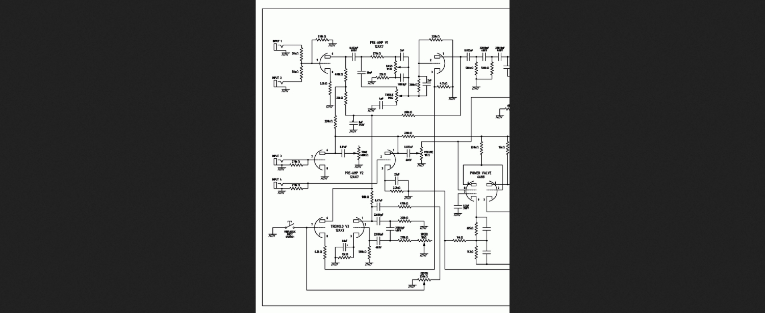

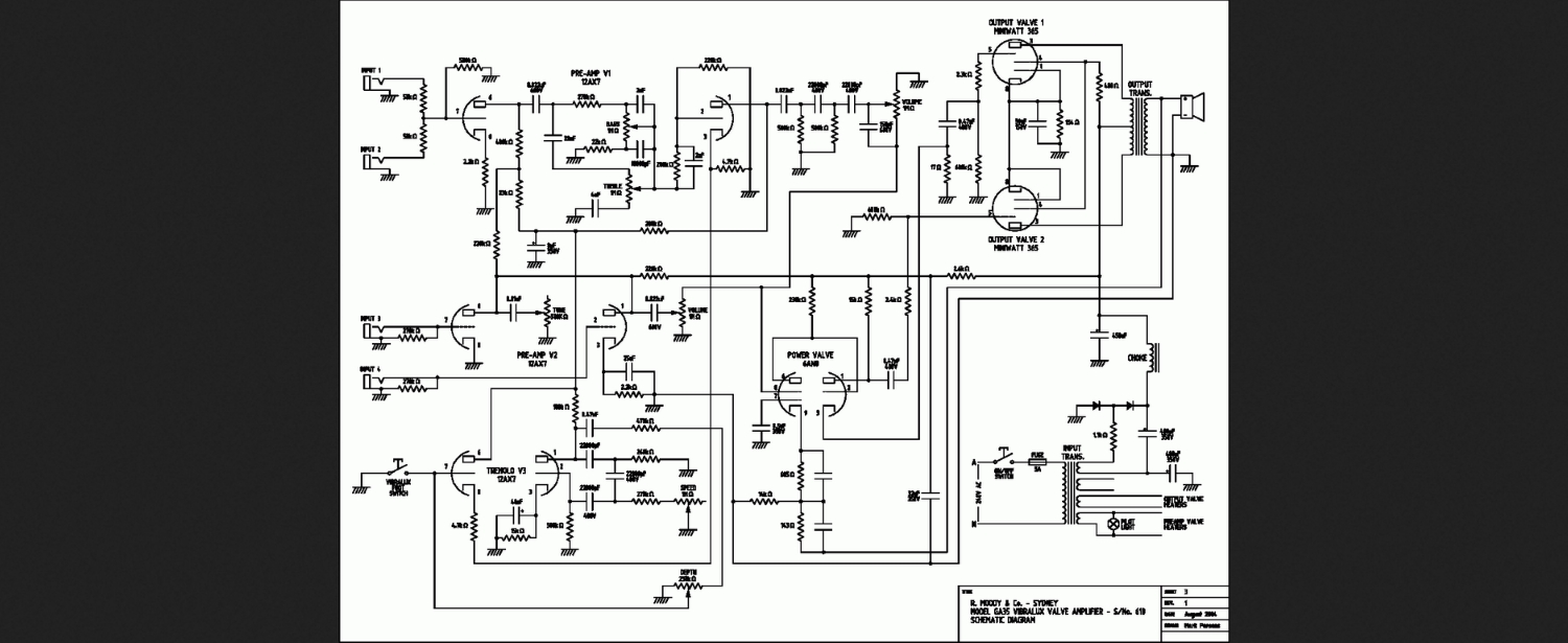

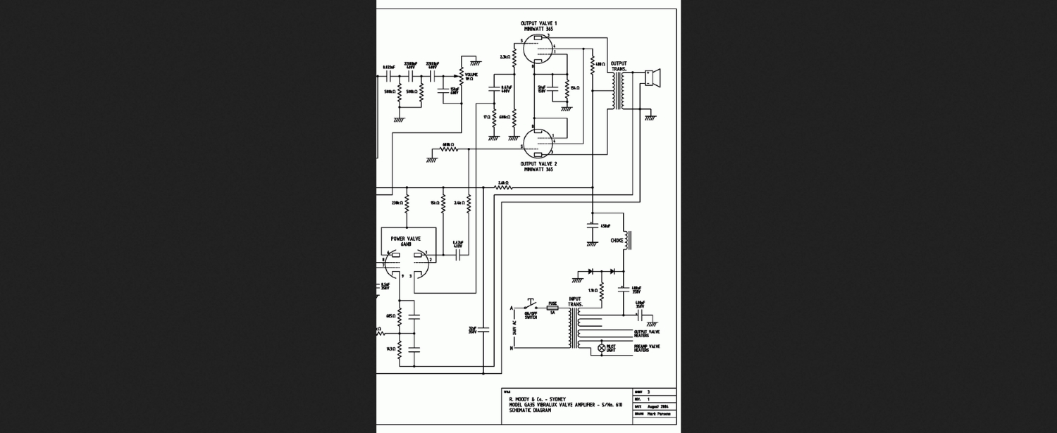

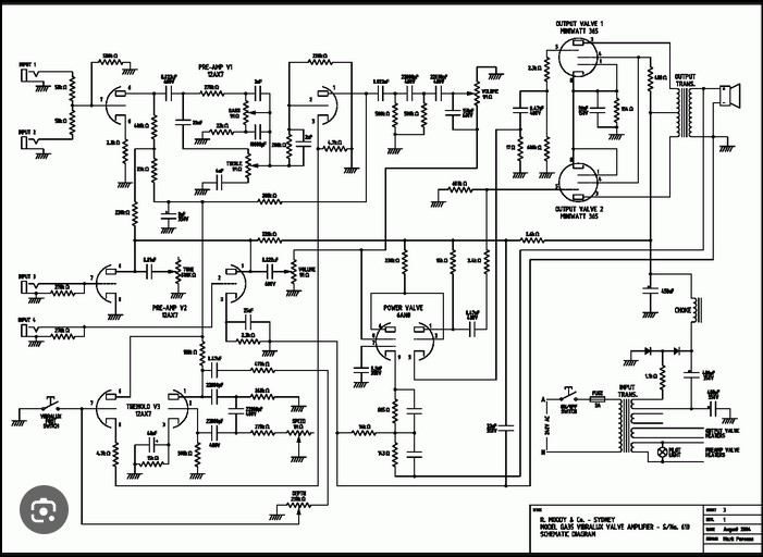

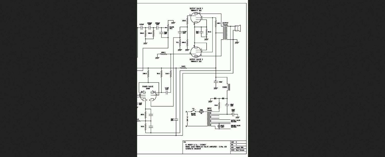

    I can’t make out the full name of the output valves M**MATE(?) 365, (possibly a rebrand of another valve name, maybe MOV - Marconi Osram Valves) but they certainly aren’t one of the common valve types and it looks to be a tetrode. The ‘power valve’ (a phase inverter?) also appears to be a non-common valve number. These valves may have been plentiful at one time, probably because they were used in TV sets, but since all commercial TVs swapped over to transistors in the 1970s, an awful lot of once-common valve types simply went out of production. So to make an exact copy you’d be reliant on finding NOS valves for both construction and maintenance.
    If you could find a data sheet for the rare valves, you may well find equivalent valves still in production that could be used with a little circuit adaption, but the amp won’t sound quite the same. 6V6, 6L6 and KT66 are all power beam tetrodes available today, and you could probably substitute one of them for the 365, but they all have their own sound.
    The speakers used will also have played a big part in how the amp sounded, so you’d need to find something similar to use. You might be able to find data sheets for them if you could find the model number.
    Hopefully there’s a more detailed version of that circuit diagram available, as there are too many blurred numbers and names on it to make a full parts list from it unless you were experienced in valve circuit designs and could determine what the blurred values should be. The output transformer doesn’t show the speaker ohmage value. It’s most likely to be for 5.3 ohms (3 x 16 ohms in parallel), as the main alternative of 2.7 ohms (3 x 8 ohms in parallel) is far lower than commonly used. Unless there are more details available elsewhere, you’d need to find an intact amp to really find out all the missing info e.g. there’s no indication of what pots are linear and which are log taper. You could guess based on other amps, but you might be wrong.
    The twin feedback paths is a rare feature that I haven’t noticed before in other amps. If there is feedback from the power amp output, it’s normally a single path, or part of a presence control. (Note that I can follow these circuit diagrams and know roughly what bits of the circuit should do, but have almost no detailed knowledge of how the bits really interact).

    The one i bought came with 2x el 34 power amp valves and 3 12ax7,s that were in it from memory, one may have been an at7 re tremolo circuit etc but it wasnt marked that way on the valve socket or chassis etc, cant remember the phase inverter tube so long ago, the original speakers were very similar to these
    but they blew so i put a pair of etone 30w in and then a pair of greenbacks after that as i used the etones for a goldentone bassmaster 60w i had and another cab etc.

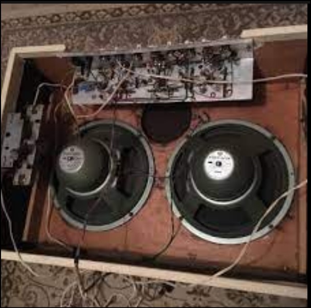

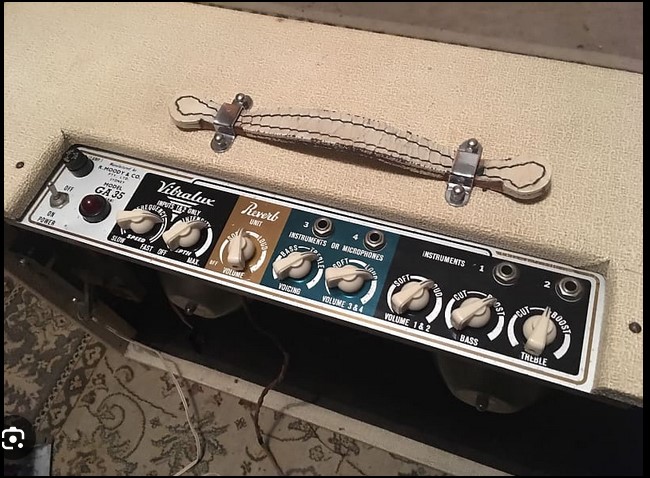

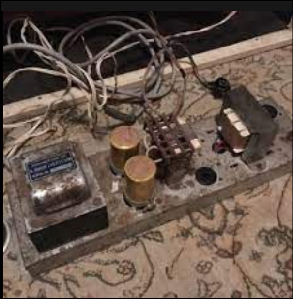

    Heres some more shots of the electrogizzards of others out there with diff speakers then what mine came with at the time.

    The output trans in that image above is not the original i dont think as mine was similar make and appearance as the power trans. Just smaller.
    The nuts on top of the original speakers were bigger but a very smilar design pattern, pressed grey metal colour though, i thought they were rolas but could be wrong there were no labels on them but they were a common speaker back in the day in Australia i saw them in p.a. boxes of the time and other stereo speakers around. There was a midrange too but grossly underpowered for the amp, i want that 2x12 + midrange sound configuration again though, as while it did work it sounded just great with the extra chime of the midrange, however i will use one with greater wattage then the original.
    I thought of using a jtm 45 kit would be great if its too hard to recreate the exact amp config of the original with a pair of 12" celestion rubies & a eminence 6 or 8 inch pa midrange, it would be some work but not impossible for me.

    Heres a better schematic.
