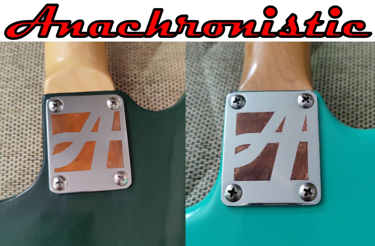

    I have not liked the bare naked neck plate on my builds. I did not want to put a Fender F on it, or an etching of SRV or any of the purchasable etched products I saw on Reverb. I don't have access to a vinyl cutting printer. I am not particularly artistic...but I wanted to do something. I decided to do simplified version of the A in Magneto font that I have been using as a logo. (Below the logo is black and red, but I have been varying the color depending on the guitar's color). I am not sure this is a "good enough" idea but worth a try...and I thought I'd post it if anyone else is interested.
    I will attach a video from Youtube of a guy doing something similar. He has a vinyl cutting printer, however. He also did not take the plate off the guitar.
    By contrast I did mine entirely with 3M 1/4" Fine Line tape and electricians tape to cover most of the neckplate, leaving exposed only the parts that are no longer chromed. I did this primarily because fit did not require cutting the tape at all. There is no stencil and I was working by eye-balling a big Magneto A, which is why they are not quite alike. I think they ended up looking a little cartoonish.
    The guy in the vid used the same process I did, roughly, although I covered my neckplate more thoroughly, and taped the anode wire to the back. You need to change the Q-tip frequently because once it has picked up some chrome it stops working well. The guy in the vid says it "looks like a penny," where you've etched. That's because what is under the thin layer of chrome is mostly copper. He polishes his to get the copper as shiny as the chrome. He may not realize that unless he varnishes the neckplate, the copper will oxidize again and will eventually look like an old penny. I have already started to see that mine has darkened somewhat, and am sort of looking forward to it looking like old penny. It may not get fully consistent like an old penny, but I don't hate the way it looks now...so we'll see.
    For a power source, I used a 19.2V Craftsman power-tool battery. That may not work for everyone. I noticed that my Ryobi batteries do not produce voltage unless they are plugged into a tool. Lots of ways to power the process though if your power tool battery does not work.
    Not an artistic masterstroke, but maybe worthy of the FWIW pile of ideas. If not, it may be an object lesson for others who surf by similar YT ideas ;-)

    It was definitely an experiment. I think it would look better (and perhaps at some point it will?) if the copper oxidizes as on a penny. I think you could probably polish it and get it re-chromed, but that might be more trouble/cost than it's worth. Also, I am not sure you'd see the logo anymore. This approach just removes the chrome. Other than a bit of oxidation it doesn't seem to do anything to the copper(ish) metal underneath. The chrome plating is so thin that I am guessing that if you re-chromed after doing this the logo might disappear.
    Folks using this method often say that if you don't have access to a vinyl cutting printer that there are places that will do it for you. But it seems to me that such an approach would not be much cheaper than using one of the laser etching services on Reverb or eBay that will make the logo from a jpeg. Laser etching appears not to go through the chrome, but just returns the neckplate with your logo in chrome matte, which may be closer to what you're after. Or so it is advertised.
    For a super simple logo like what I attempted it took me about 20 min to get the tape on neckplate, and another 15 to carry stuff out to the kitchen stove and do the etching. Less than 3/4 of an hour start to finish. (I did it on the stove to have the hood sucking air out. Pretty sure chrome fumes are not good to inhale...and it does "smoke" a bit.) Not bad for a DIY process...if you like the outcome.
    It also occurred to me (albeit late in the process) that a person could do the logo on the back of the neckplate. If you like it, replicate on the front. If you don't, it's only cost you an hour.
