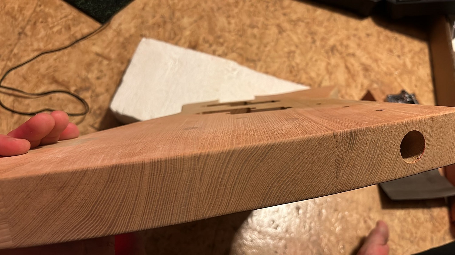

But meanwhile i got myself a japanese saw and dowels and practiced on cutting boards (i also used those to practice shaping the headstock). Well... some more training until i feel fully prepared, but it gets more promising.
Also I practiced with the cheap drill press - that won't work, I will find someone with the real thing.
