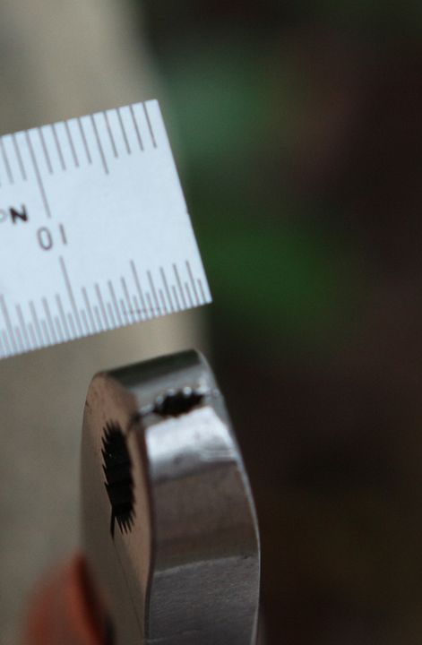

    depending on whether you want to use this as an excuse to buy another tool or not, Jaycar did used to sell a pair of pliers for such occasions. I have found them very useful, but I guess it depends on how much other DIY stuff you do as to whether or not you can justify the expense.
    Hey Rabbit, are these the ones you mean? https://www.jaycar.com.au/fujiya-175...rchText=pliers
    The only thing is i'm not sure the head will fit between the pickup and the cavity wall....its really tight.

    Take your needle nosed pliers and make some new grooves which will grip the screw head.
    Most slots on the pliers are made to grip the item so they are at right angles to the handle. The pliers from Jaycar have their slots parallel to the handles so they will grip the screw. Just take the pliers and file some slots or a single slot towards the handles and it will grip the head much easier as the pliers will bite into the head. At the moment the slots are parallel to the base of the screw head and wont bite into the head.

    Quote Originally Posted by a_novice View Post
    Yeh, those are the ones. here is another view with a scale to give you an idea of size:
    Thanks Rabbit, i can at least measure this to see if they will work, but i'm guessing i won't fit them in. However removing the head of the screw and getting the pickup out may just provide the room i need so will look at that.
    Also the pic is really handy as it shows what Dikkybee007 was saying about the grooves running vertically rather than horizontally with respect to the screw.

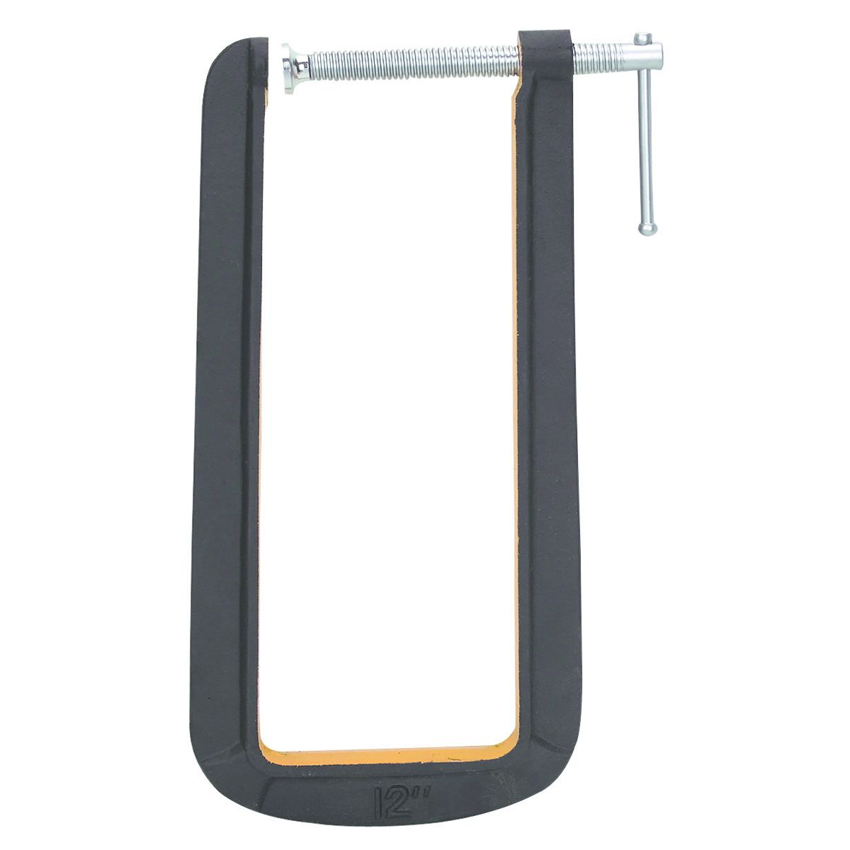

    Assuming that the pickup is on springs or a piece of compressible foam, maybe you could try pushing the pup into the body so you can get better purchase with pliers on the top of the screw...or expose the top to make it easier to cut off without damaging the pup or finish. Something like this with a block of wood on the pup and a larger piece of wood on the bottom so as not to mar the finish.
