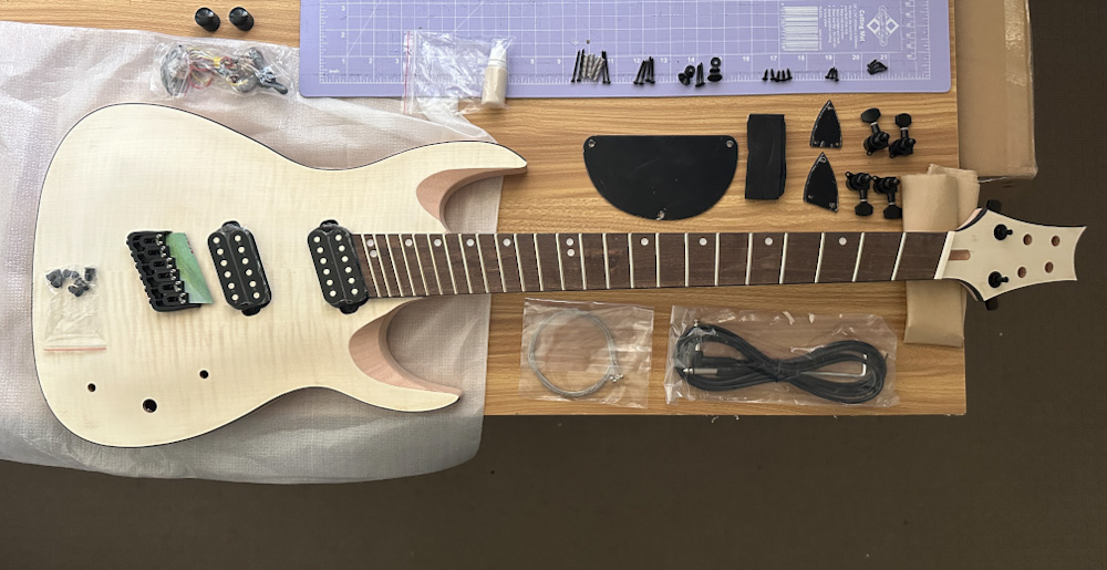

    Here's info from my unboxing/inspection:
    Firstly, I'm really impressed with the veneer and the styling, I don't think I could expect a better looking guitar.
    I would be keen to do a couple of minor modifications to the shaping at the neck joint and cutaway areas but I really like it. Its unique and compact and the woods appear to be amazing quality.
    As for the styling i honestly don't know what this compares to but its really cool.

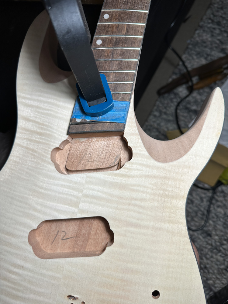

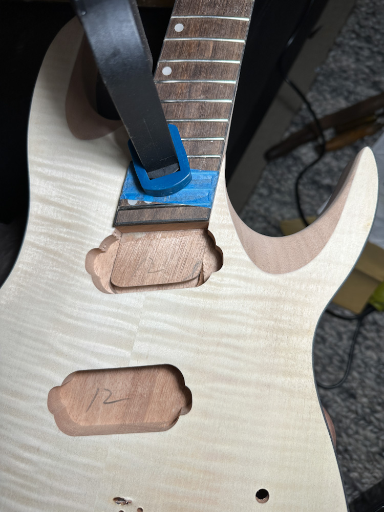

    There's a couple of things about the test fit I'm not confident about:

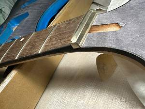

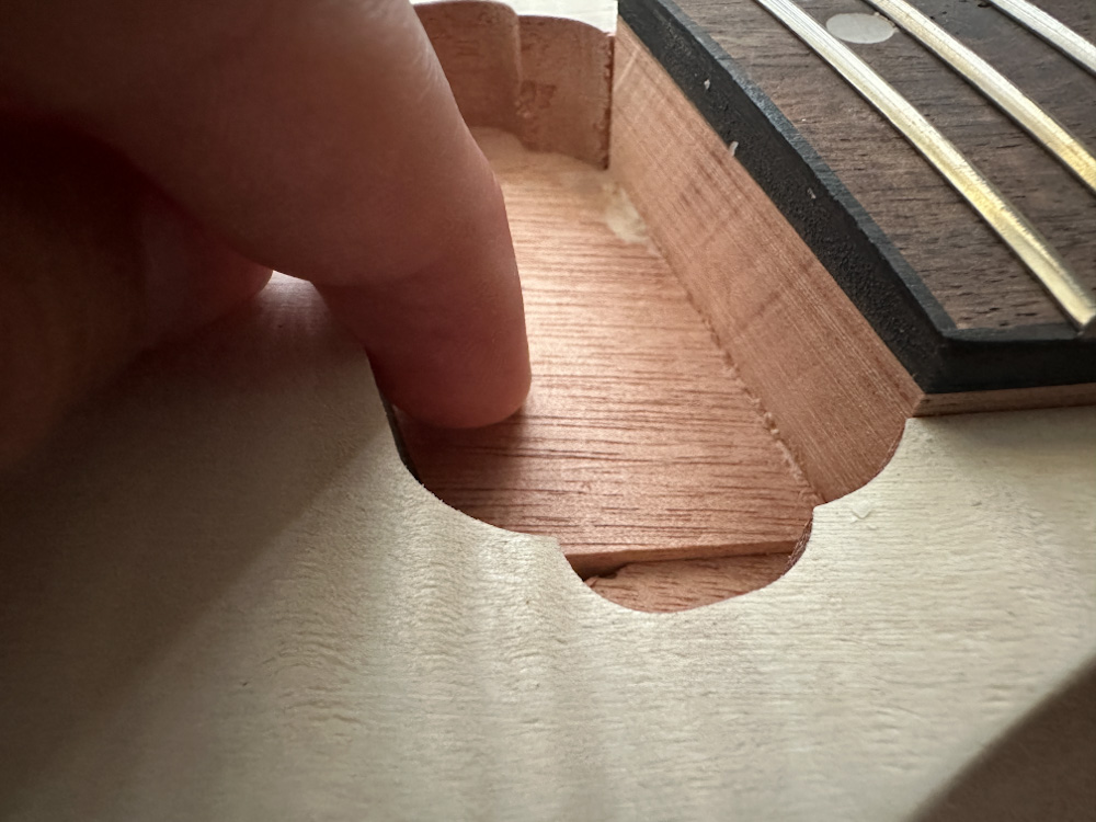

    • the neck pocket seems way too loose. It almost appears as if the routing was done slightly off because of the arch top. I can fit a 0.8mm pick down one side of the neck. I am seeking advice on how to deal with this(or if it can even be dealt with?)

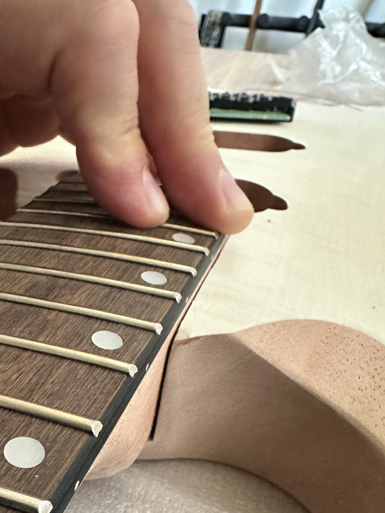

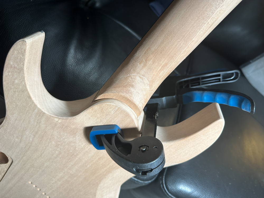

    • the neck appears to sit too high-ie. it lifts the fret board too high above the body, otherwise it appears the bridge is too low, unless the saddles are jacked way up on an angle. I dont think I'll be able to actually test this until things are fitted like the bridge is fastened down, strings fitted etc. Neck bow adjusted.
    • again the neck heel appears to sit high in the pocket-so as to loose the clearance underneath the neck PUP. But as above I can't really test this yet. I don't know if any material can be safely removed from the bottom of a neck heel without affecting alignment in other ways.

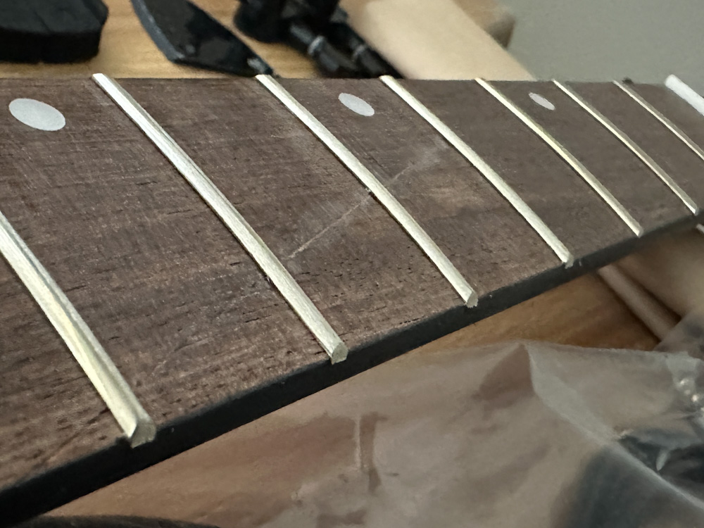

    As for defects:
    • there's one that looks easy to deal with - a tiny tear out in the veneer at the neck joint. No problem.
    • the one that I may not be able to handle - the fretboard has a gouge across quite a few fret positions and it's in a prominent position.
    Excited to get started and hoping that these issues can be solved asap!

    Update
    Thanks Adam for promptly assisting with these queries.
    Going ahead with the build after some advice and assistance on the kit/parts.
    I have taken some averages from my fender and Jackson guitars to estimate scale length setup for the low and high strings in this multi scale setup, hopefully accommodating a decent range of string guages.
    I've created these measurements in mm from nut to 12th fret + 12th fret to saddle
    * high E(MS 323+324.5)
    * Low E(MS 340+345)
    So for high E, I added 1.5mm string bend
    And for low E, I added 5mm string bend
    The bridge placement is preset by the string-through drillings.
    So I will set up the bridge first then measure the set-neck position from that.

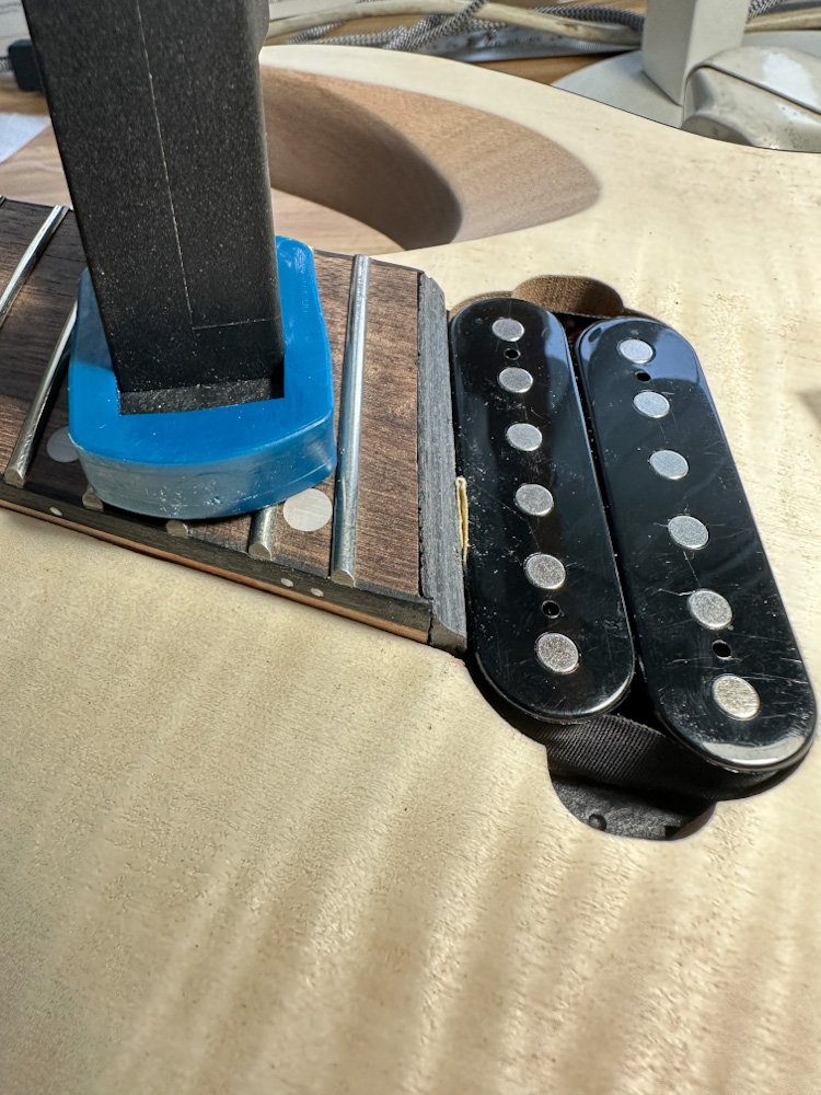

    At this point the neck set position is quite a bit pulled out from the pocket where you would expect. This improves the tightness in the pocket, but it creates a large gap in front of the PUP.
    This is not optional so I'm toying with ideas on how to fill that gap if anyone has any input on this? I'm thinking it should be something that's an extension of the neck, or something that's an extension of the pickup itself.( there's no option the have another piece of flame maple inserted in there-I'm not ready to consider deleting the flame maple finish yet)

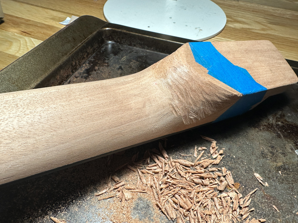

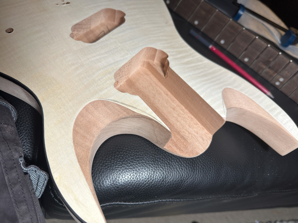

    This only took a couple hours and I'm ready for sanding
    Chisel/Spoke shave/scraper FTW

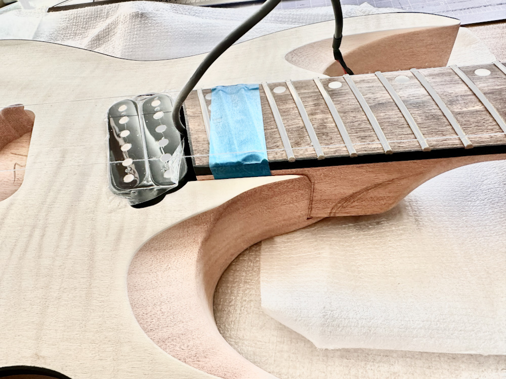

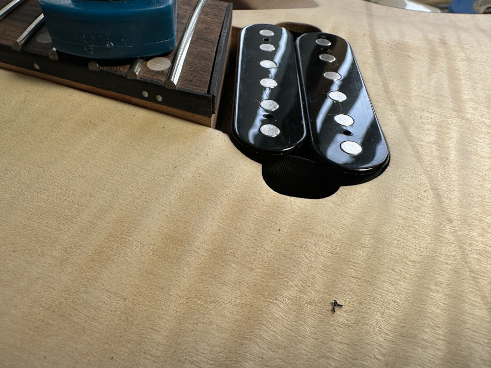

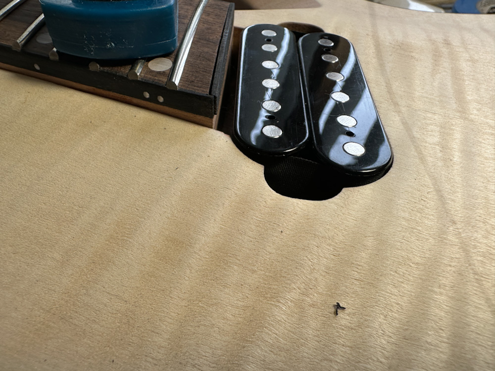

    With the bridge screwed down and outer strings mounted I can confirm my scale length calculations are true to intonation.
    So with the neck pulled to suit, the gap between fretboard and pickup is as shown.

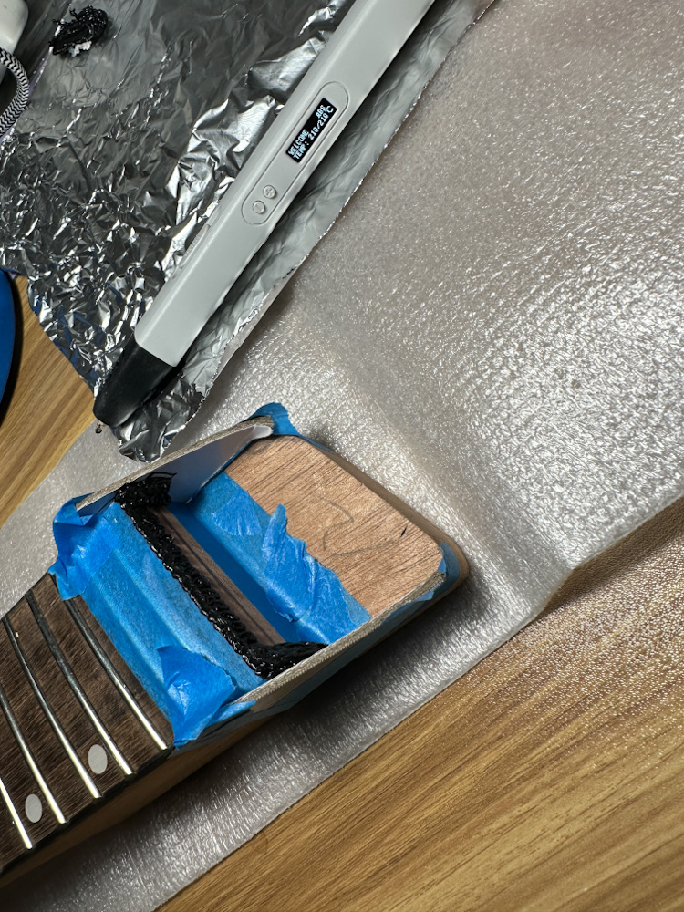

    I have begun sculpting a replacement binding/filler for the foot of the neck to fill the space and still look "legit" using black ABS filament.
    I dont know if PBG bindings are made from ABS but it should match ok Experiment #1:

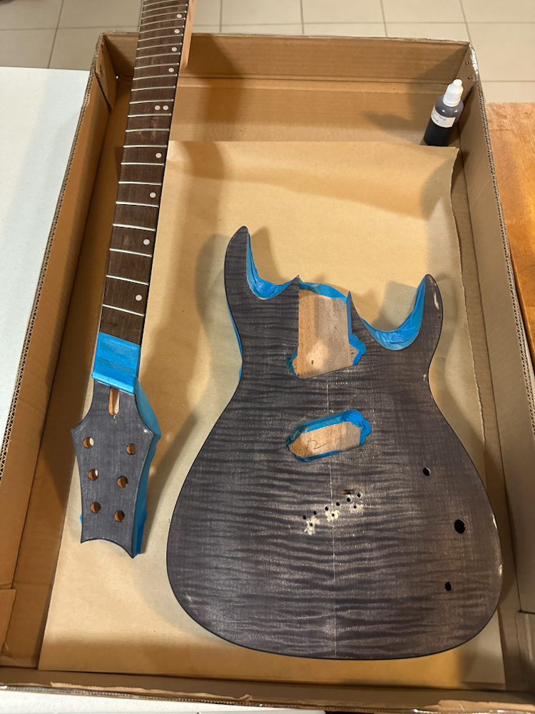

    Hunter Valley
    9

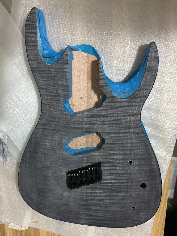

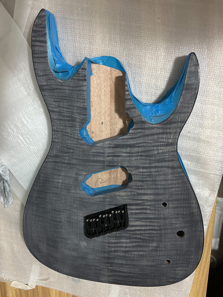

    Starting with a black colourtone stain on the maple surfaces.
    Still not sure if I want to add a secondary colour.
    If it suits I would go for a super dark green in a burst to black.
    Then considering running a solid gloss black backside including the neck.
    I've encountered a few good glue spots around the edge, and a line is there - along the centre join.
    I can confirm that after testing on a few edge grains - timbermate filler takes the stain perfectly so while I'm patching up these spots I'll add some more grain fill where needed in the centre/frontal areas before I continue adding colour.
    Here's the repairs so far.
    I used some acetone on white rag to soften glue marks(very carefully!) then attacked them with a mini wire wheel on rotary tool(super carefully!!) and it seems good.
    Hopefully I can pull off something nice with this fantastic flame pattern!

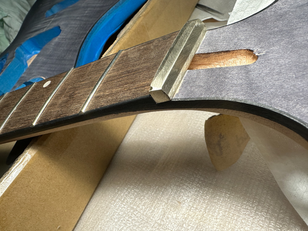

    I'm being patient waiting for stain and more tools to arrive, and I haven't been able to source sanding sealer nearby. Can anyone recommend a place to find that? Online?

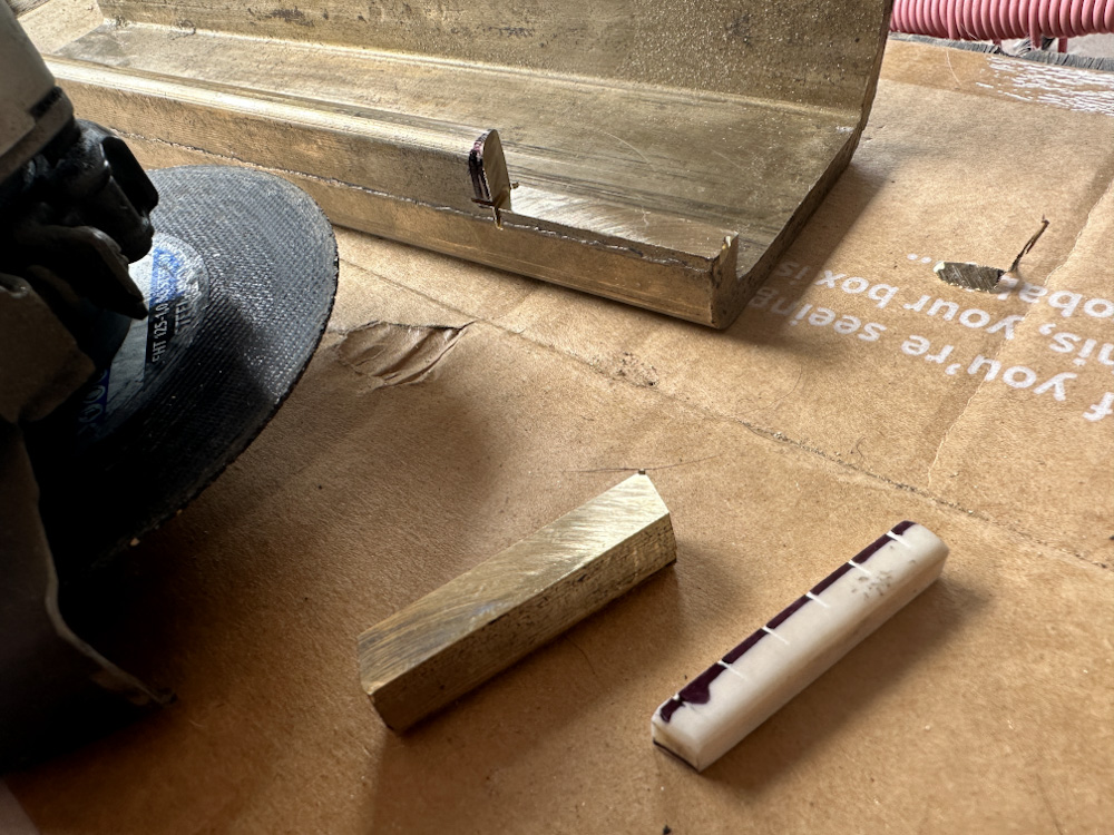

    Meanwhile Ive procured a chunk of brass, and since the nut supplied requires a lot of work already, im trying my hand at shaping my own.
