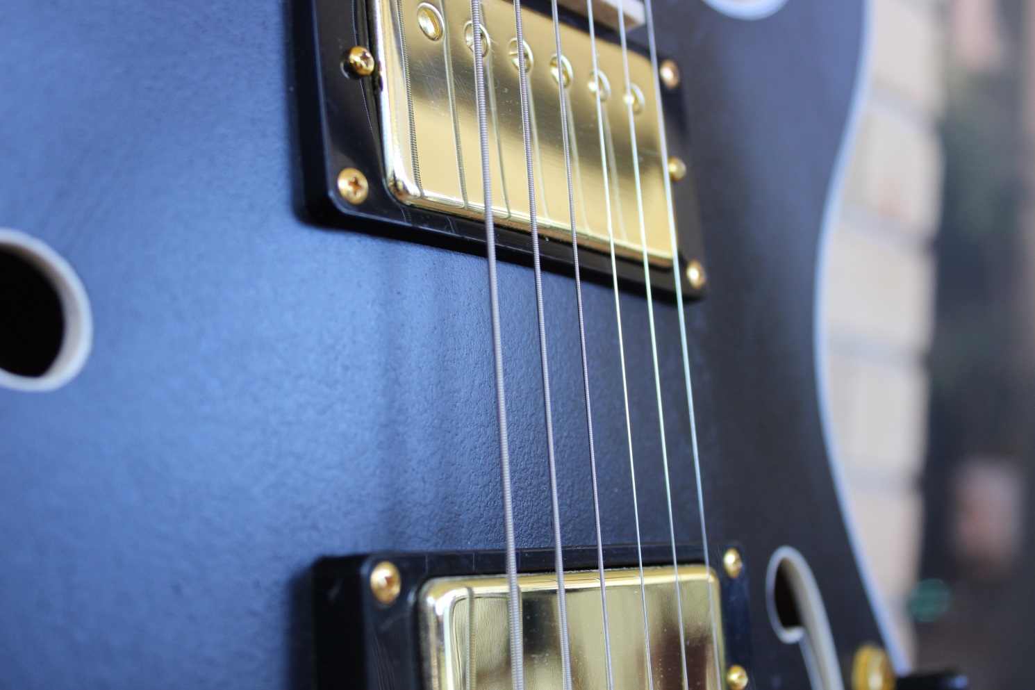

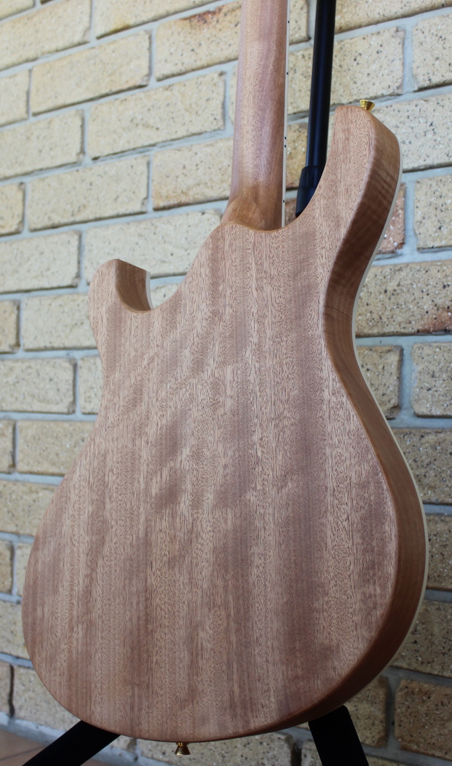

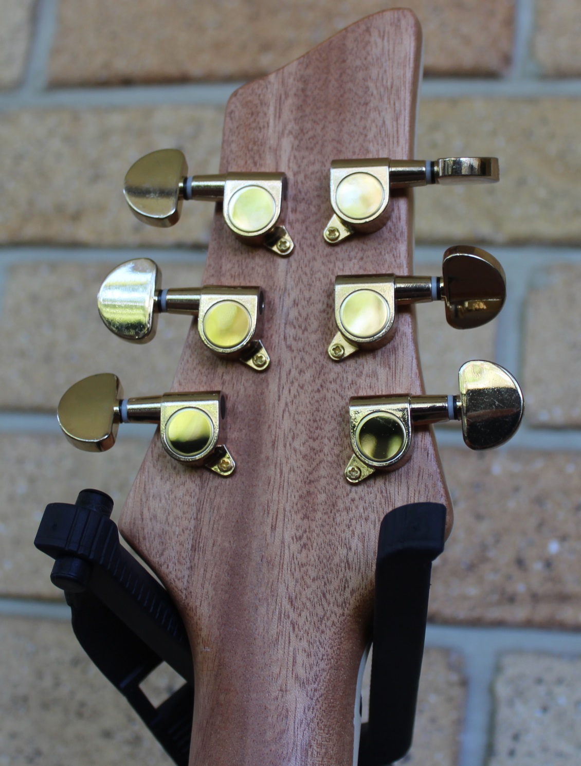

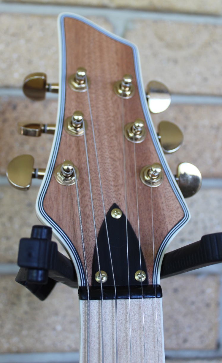

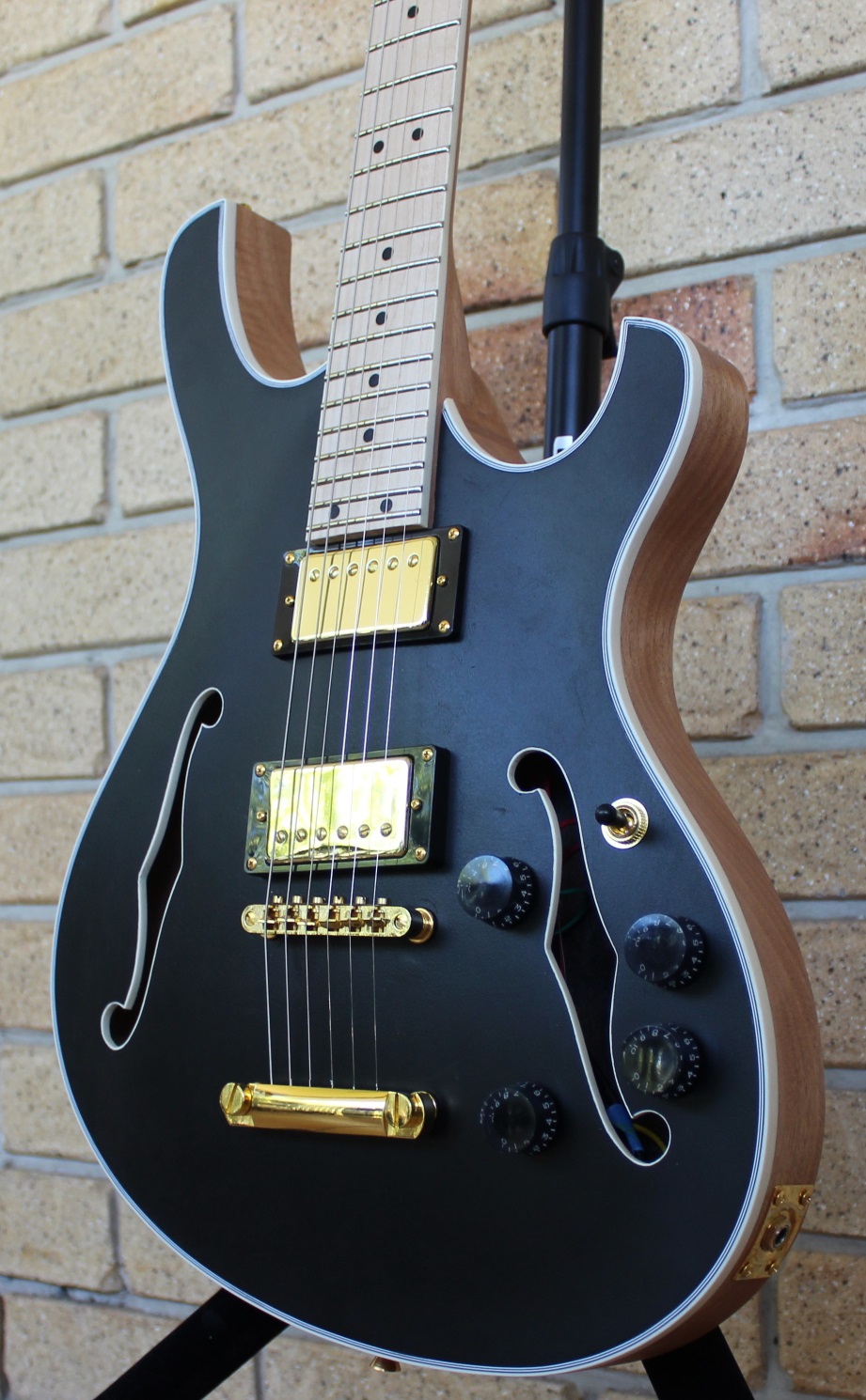

    Bought this GPR-1M kit nearly two years ago and only just finished it today! Was a factory second with a few flaws and issues but mostly all fixed up! All stock parts from what I remember except the nut which I swapped out with a black plastic one I had around and d'addario strings.

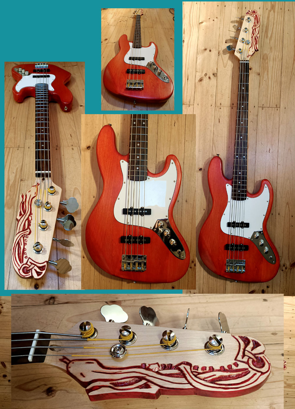

    A Jan 2023 entry perhaps? (I can't compete with Benjh96's beautiful guitar!) Body was many many layers of dingo red stain, and blue/ red oil paint mixed with more jara stain. Neck is handploy finish over a carving using celtic eagle intertwined with a snake, grooves filled with oil paint/ stain mix then sanded back to clean up edges. Went with flatwound strings to differentiate from my other bass. Very nervously adjusted neck and internation. Sounds excellent

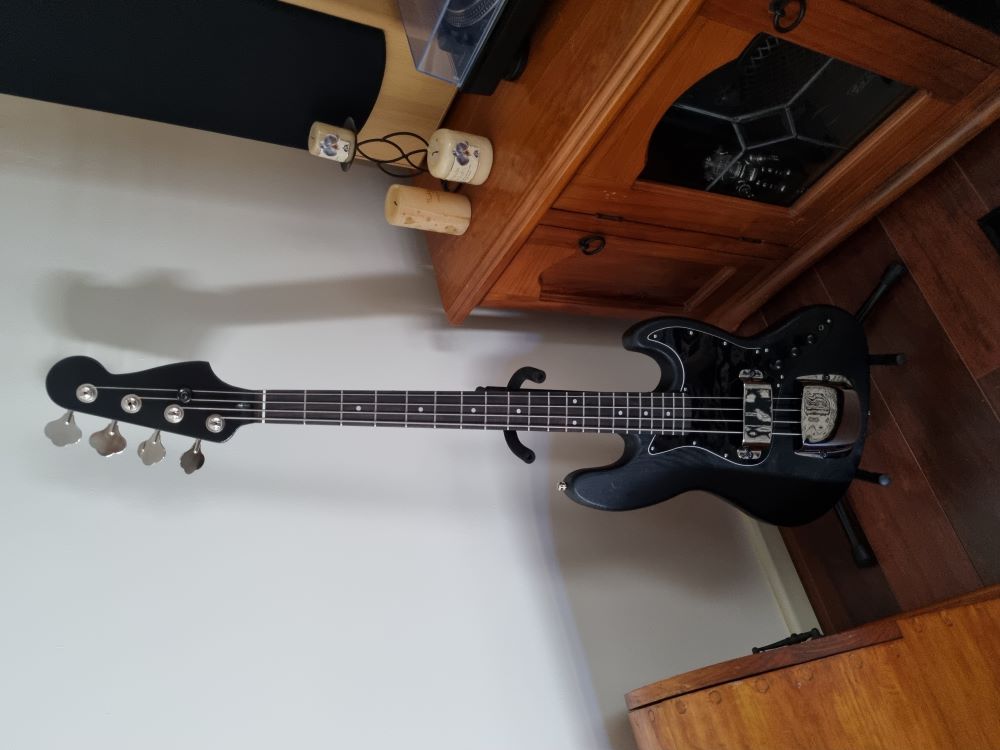

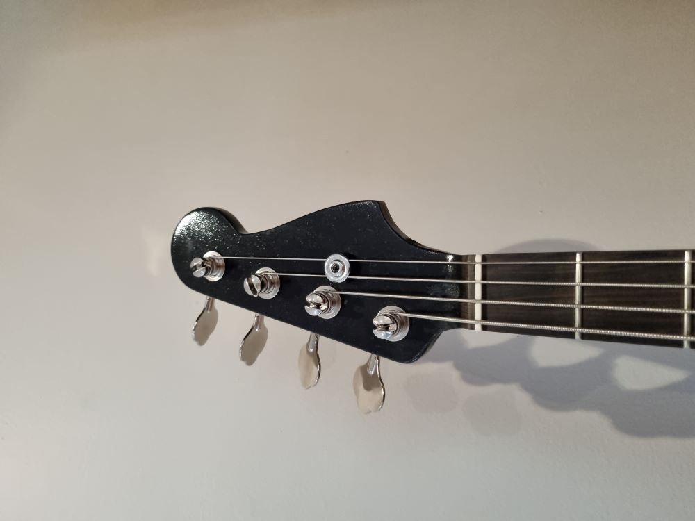

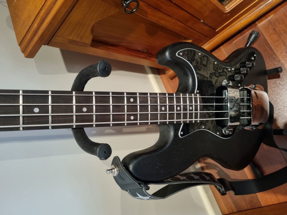

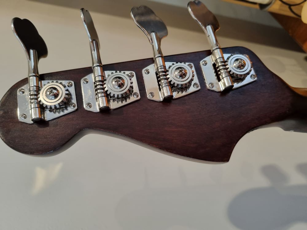

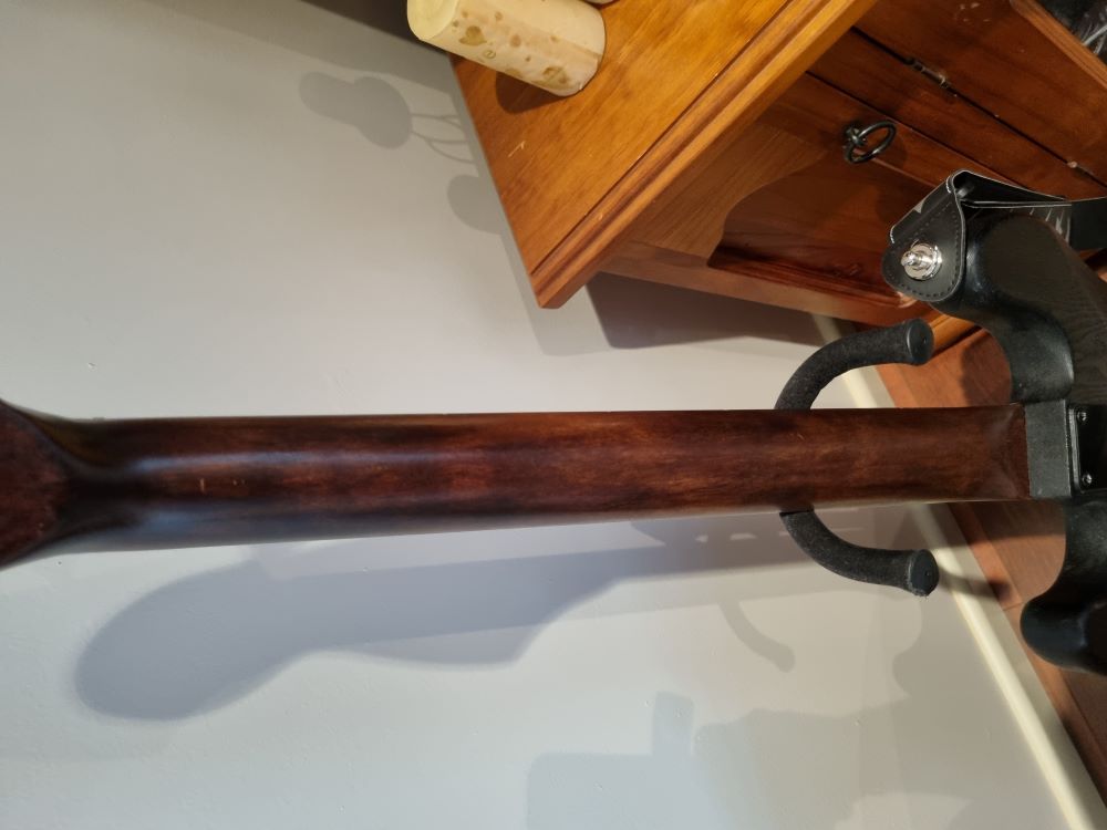

    This my contribution, finished this a couple of weeks ago. Not the shiny sparkling body but a bit more of a gothic approach without going overboard. JET BLACK is an Indian ink option I chose as apposed to the high gloss. The neck I used an Ebonising stain using fine grade steel wool and soaked in Vinegar for a couple weeks, the body and neck were then spray in a Saturn clear. A few up grades, Tone rider jazz pickups, eagle tuners, bone nut, Schaller strap locks, chrome bridge and neck pickup covers. Low action plays great, a little heavier with the Ash body and the bling but sounds just fine and plays nicely. Click image for larger version.

    The black and silver sit very well together. Nice.
