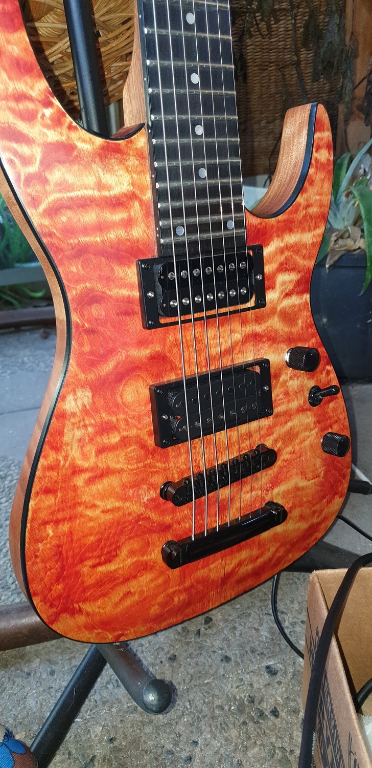

    My first kit was a Pitbull Guitars 27" 7-string. All mahogany body and neck, with a quilted maple veneer. (2019)
    Long story short; I ended up with a second kit around the same time. Same woods, etc. This time, it's multiscale. (Very similar to the current SMS-7Q).

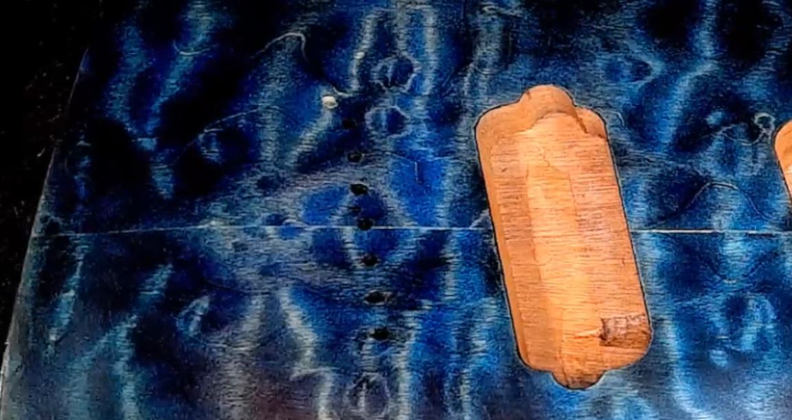

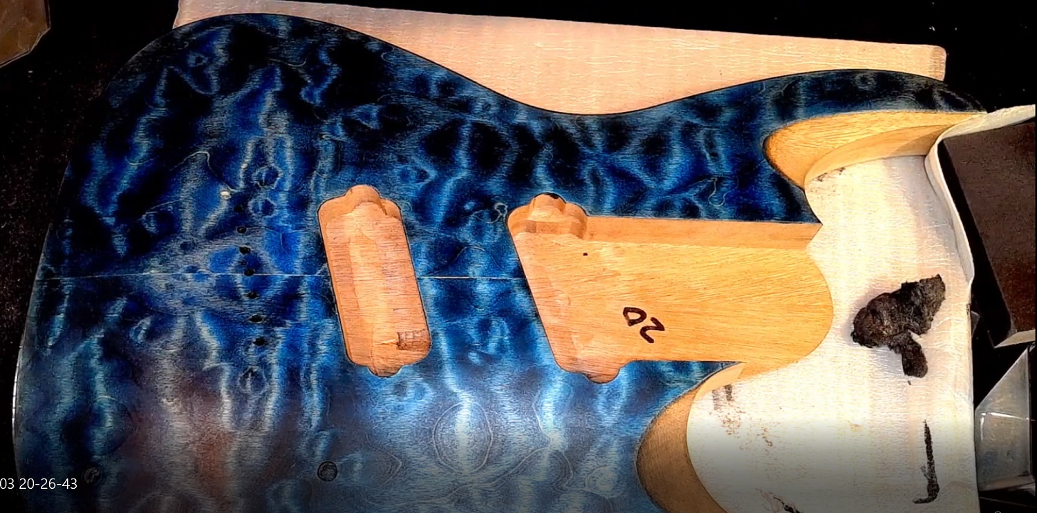

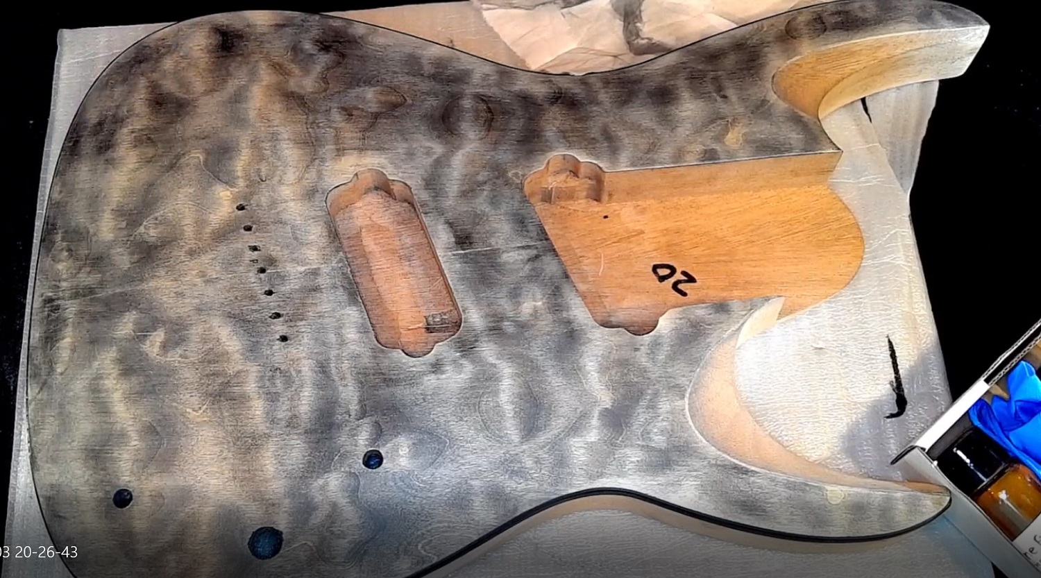

    Only after applying stain to the veneer, did I find a very visible glue line running down the front of the guitar, where the two pieces meet (See attached).
    There was no issue with my first kit when applying the stain over this seam. Dingotone is used in both cases.
    Are there any tips/tricks to fix this, or minimize it? Or is this just a factory flaw that I'll have to embrace?
    Thanks for your time!

    2,023
    Hi and welcome Rhett.
    Your questions are possibly best for a Build Diary thread. Sometimes it will take a while for members to respond to a question.
    The glue mark affecting the stain is a common problem with the veneer kit builds and there are some good solutions to lessen the appearance of the line. I'm sure I recall someone scraping the glue out of the join mark, filling and then re-staining. But I'm not the expert on them though, and I cannot find a thread on where to find solutions.
    Hopefully you will get others responding soon.

    Magical Trevor with the goods!
    Thanks so much for the responses. Having a read through these posts gives me hope. I kind of like the hairdryer option. Warm the glue and delicately scrape. I don't mind if I can still see it, I also wouldn't mind if it looked intentional, like a feature stripe. Up close, the line varies quite a bit in thickness and looks like a mistake ATM (less obvious in the photos than in person).
    I'll see if I can recreate this thread as a diary and modify this post to be more in line with the forum.
