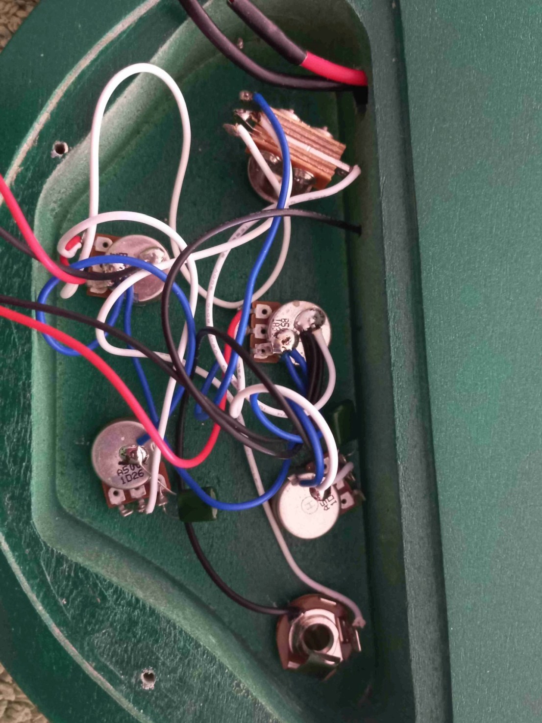

    The pots are all in the correct positions, after my second set up , and the wiring was all prewired, pre soldered so all I had to do was attach the controls (pots, switch and plug) and connect the PU's. Just a push together plug. I have had a close look and to my untutored eye it seems ok, but again I don't know what should be connected to what. There are however no loose wires.

    Hope this is of some help.

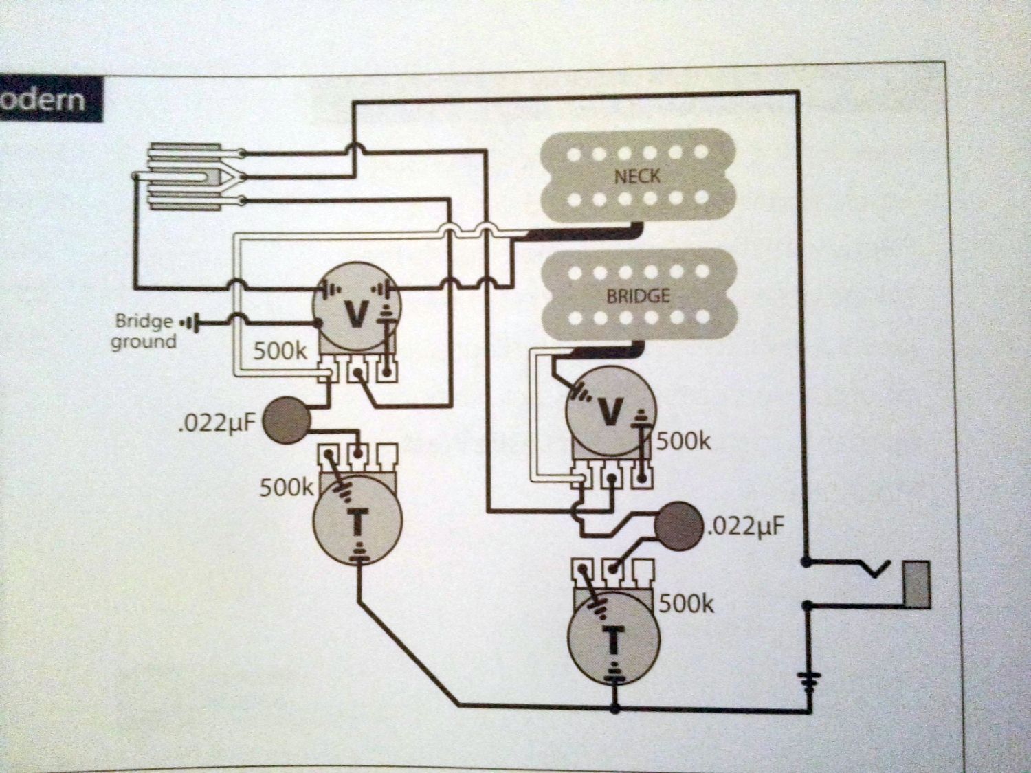

    Olddon, I think I might have a circuit diagram for a Les Paul, or SG in amongst the circuit diagrams in my Dan Erlewine Guitar Player Repair Guide book, I'll see if I can find it and post a pic of it here for you.
    Here we go, this schematic is for a Les Paul but the SG uses the same exact schematic, hope it proves useful in sorting out your SG build:
Name:	Les Paul_SG Schematic_resized.jpg
    Note that most Les Pauls and SGs these days use a .047uF, or 47nF tone cap instead of the .022uF or 22nF shown in this schematic.

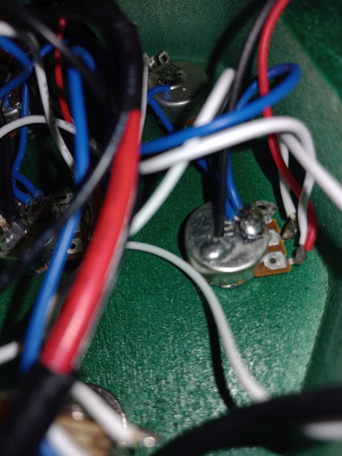

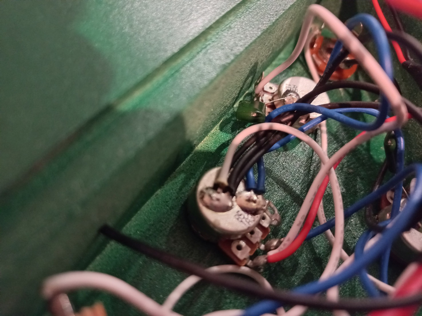

    I'd ideally like some more photos. You've got wires covering up a lot of the pot connections, so I can't be 100% sure of everything. It generally looks OK, but there may be something hidden that's not right.
    The bridge tone pot capacitor legs look like they might be touching each other. Definitely move the cap so the legs are separated (check on both tone caps).
    I'm not 100% sure the neck volume pot has the lowest tab in the photo folded back and soldered to the casing properly.
    It would have helped if they'd stuck to a decent colouring choice for the wires e.g. all grounds black, all bridge signals white and all neck signals red, with the common output blue. Then it makes it much easier to follow the wires.
    But as I've said, there are still wires covering up a lot of the pot connections. You may have to take photos of the individual volume pots (the tone pots look OK apart from possible shorts between the capacitor legs).

    Dr, I have checked my wiring against your diagram and all seems good.
    Simon please find enclosed another couple of photos. I have checked the potential problem area's you mentioned and they all seem fine. The fact that the symptoms change after both volumes have been set to zero makes me think it is more an electronics problem than an electrical problem. If that makes sense.

    It's possible that the volume pot for the non-working pickup might have a loose solder lug on it, by loose I mean that it's not making proper contact with the carbon track inside the pot, you can check that by gently wiggling the solder lugs with a finger, they should not feel loose, if one does feel a bit loose then you'll most likely have found the cause, sometimes pots develop loose solder lugs if too much heat is applied when soldering the connections, I've had that happen to me a few times.
    Those 16mm pots are notorious for developing loose solder lugs when they get a bit overheated, I've found that strangely, some pot values seem to be more prone to it than others.
