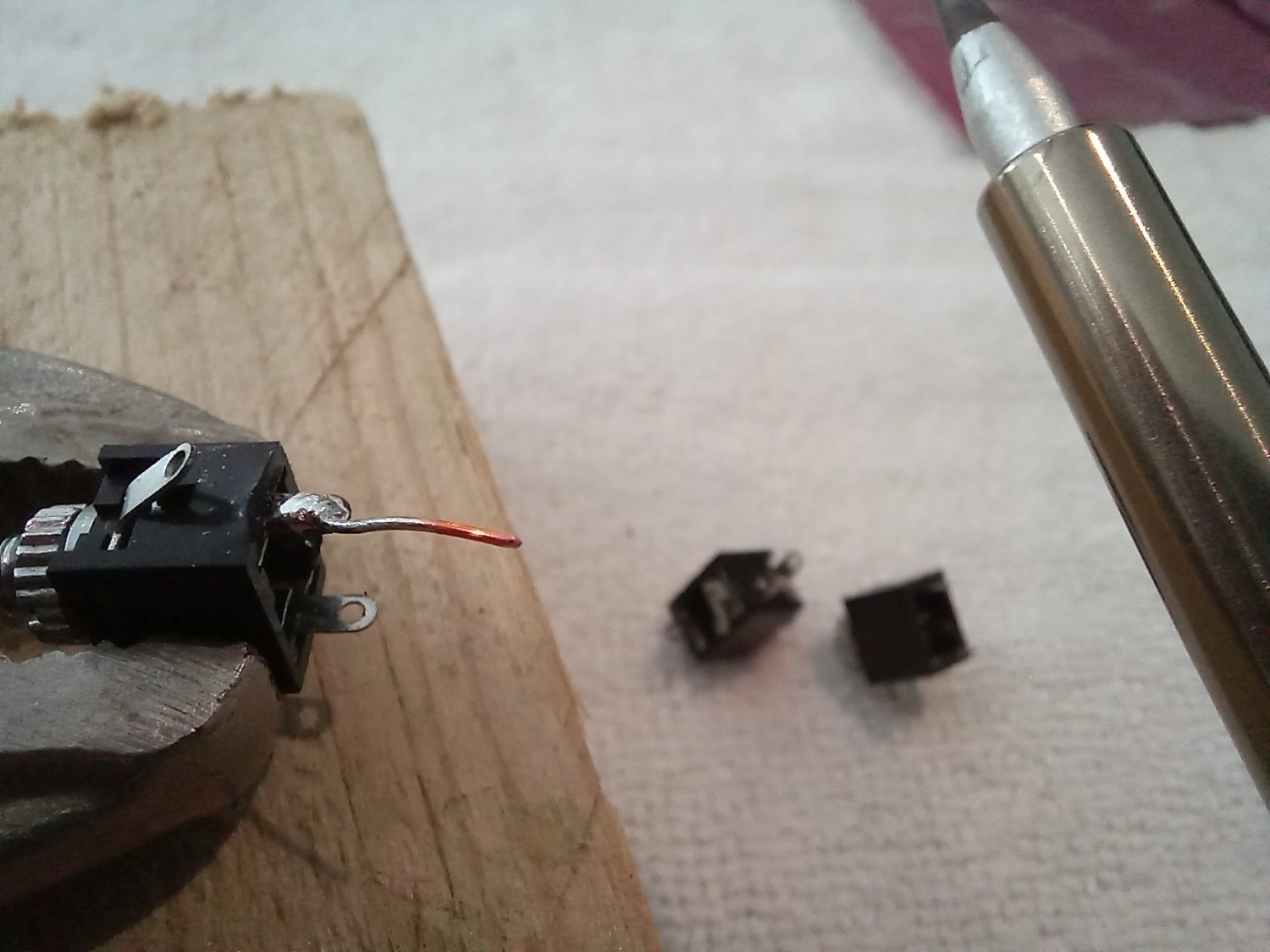

    So far I have bought a soldering iron kit and a couple of small jacks that have tabs for soldering, and I have tinned a wire and soldered it to the jack. Should I put a multimeter on it to check for resistance?

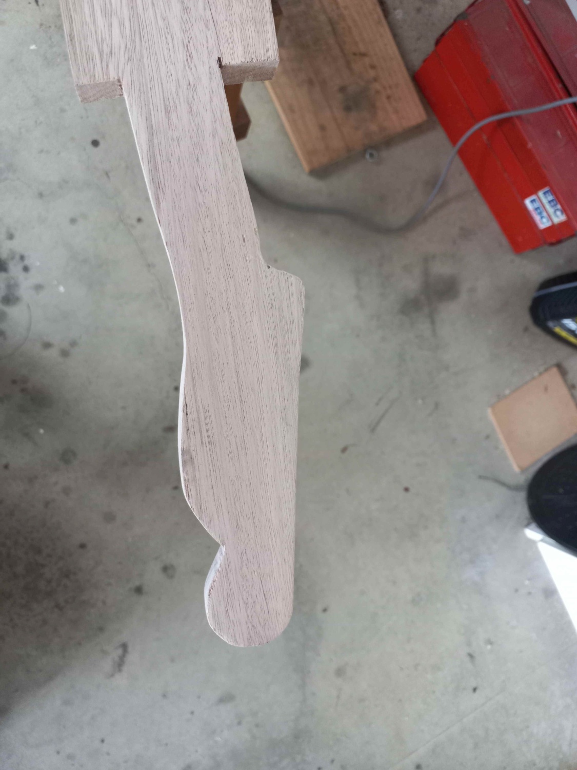

    I also bought a plank of Tasmian oak and did my first practice cut of the headstock. I hope to do at least another 3 before trying the real thing.
    A few questions. Is the tasmanian oak similar to maple (my real neck) in regards to cutting and sanding. And if I do some practice painting on my practice headstocks, can I expect similar results.
    Thanks Don
    Aug 2021
    Blue Mountains NSW
    142
    Quote Originally Posted by Olddon View Post
    Thanks Don
    Hi Don,
    about practicing cutting the headstock, that's an excellent idea and that cut looks great.
    However I wouldn't just practise cutting the shape of the headstock; get familiar with your tools and with different types of timber. Practise on timber with different thickness as it will respond differently (I might be wrong but the timber in the photo you have attached seems much thicker than a headstock).
    Practise also cutting precise 90deg angles, or cut a long straight strip 1cm wide and 20cm long.. cut a circle, cut free hand shapes, cut 90deg angles then try to round the edges, and so on... this will get you familiar with your tools, will make you comfortable with cutting and correcting different shapes, and will give you a sense of how different timber responds and vibrate.
    About vibrations, when you eventually will cut your headstock, make sure to clamp the neck as close to the headstock as possible, to avoid excessive and unneeded vibrations that could potentially crack the timber.
    I usually use two clamps, I make a sort of sandwich with the neck in the middle, some cardboard and some scrap wood I have around (plywood or anything), to avoid leaving the clamps marks on the neck.
    If I am cutting a bass headstock (for example a classic Fender precision headstock for example) I put two clamps slightly apart where the low 'E' and 'A' tuner will be.
    I am not sure if Tasmanian oak is similar to maple, however I would proceed in a similar way. Get familiar with sanding and do test painting on as many scraps of wood you can find (without breaking the bank!).
    When you will cut the headstock, there will be the parts that you have cut out that you can use for painting and finishing tests.
    For the body, I usually do my tests inside the electronics cavities. These are small surfaces compared to the back of a guitar body for example, some tests might not be 100% accurate but they will still give you a very good indication on how that timber will respond and look.
    Aug 2022
    Brisbane, Australia
    25
    Thank you very much for that feedback, and well picked up on the wood. That is 19mm, which was the closest I could get to what I believe will be 14mm on the real thing. After your comments I will try harder to get something closer to 14mm. I have had my jigsaw for close to 30 years and it hasnt done much in the last 20!. I will certainly be trying different cuts as you suggested.
    After my painting trials I have an idea of what I want to do, but trying off cuts and seeing if the paint looks the same is a great idea.
    Thanks for the feedback. Cheers Don.
    1,794
    Hi Don,
    If you have a multimeter you could check for resistance for your own piece of mind (it would be really small (less than 0.1 ohm!)).
    Most times you can see if you have a good solder joint - it should be shiny and smooth over the two parts you are joining.
    It is hard to tell in the picture - but did you feed the wire through the tab hole? I normally twist the wire around itself after going through the hole, especially with the stranded wire that the kits come with (I crimp single strand wire around the tab hole with pliers) . Then I solder the tab and the twist
    Not sure about the tassie oak, but I do know that the maple is really hard (I now use a jigsaw rather than by hand with a coping saw).
    It never does any harm to check with a multimeter. If you’ve got two or three wires going to a terminal (common with potentiometers on guitars) then it’s possible for them all to look soldered but for one to remain unconnected, often due to the insulation on a wire being pushed too near the joint and the insulation is held in place by the solder and friction from the other wires, not the wire itself. Less of a problem with the typical PVC kit wire insulation as that melts at quite low temperatures, but some other insulation types and heat shrink insulation are far more heat resistant.
    Touch the probes together first and see what reading you get. Whatever it is, you’ll never get any lower than that. On mine it normally reads 0.04 ohms. On my previous one it was 0.08 ohms. Partly internal resistance, partly lead resistance, partly the design of the meter.
    Aug 2022
    Brisbane, Australia
    25
    Thanks for the feedback guys.
    I can’t get resistance figures quite that accurately.
