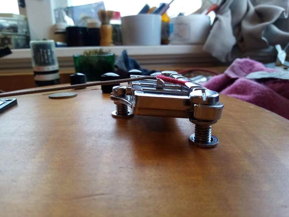

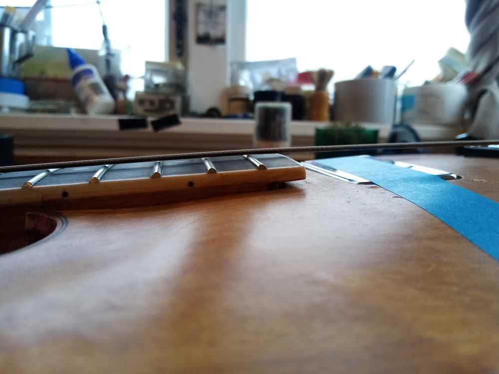

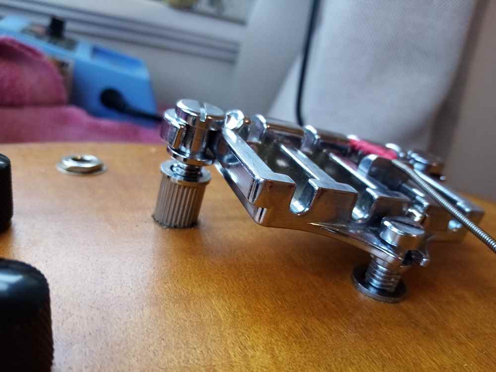

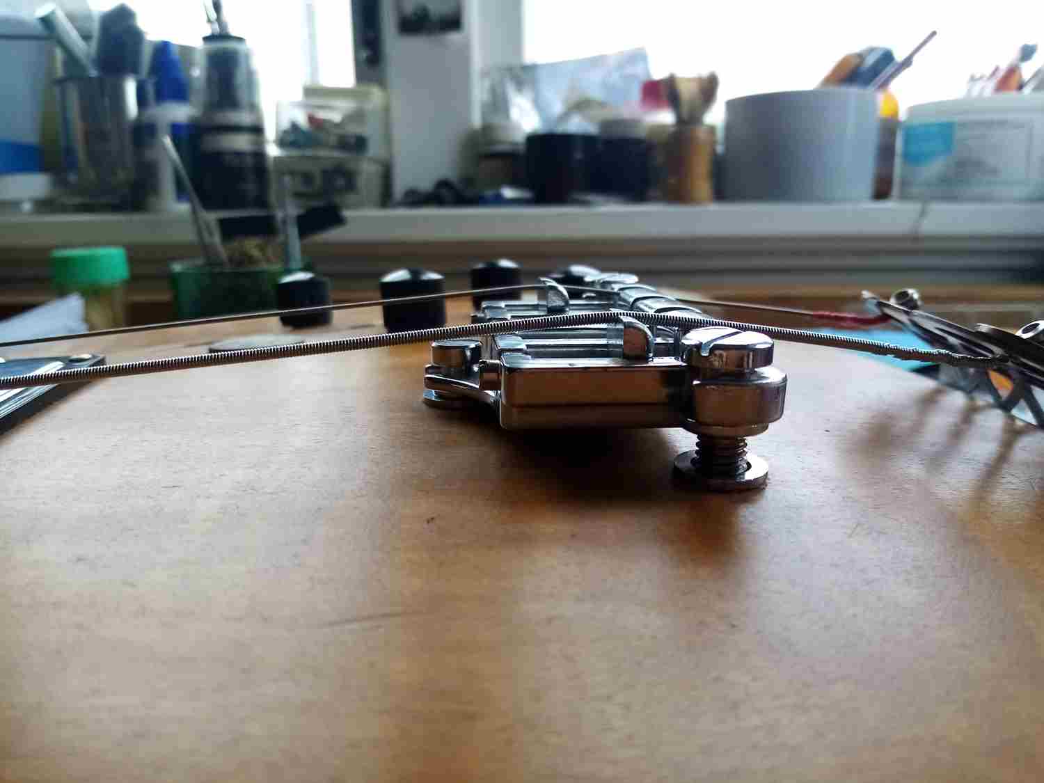

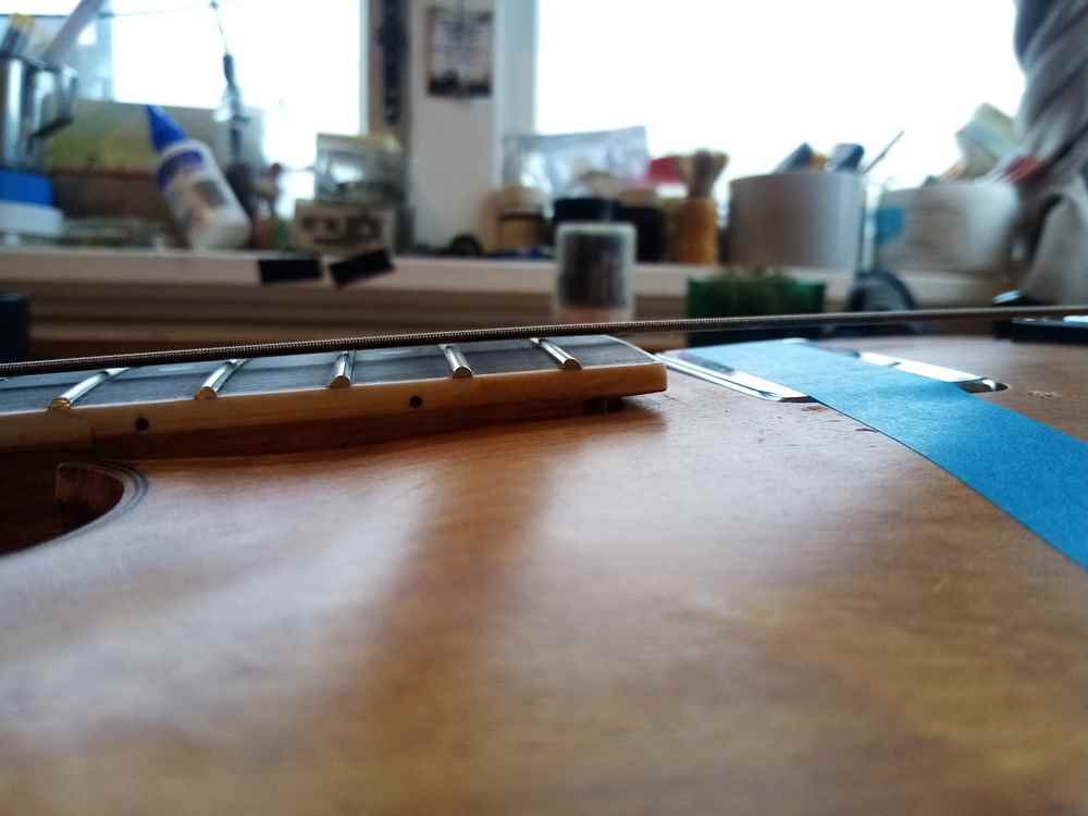

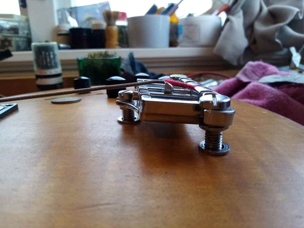

    Hi - I've glued the neck on/removed it 3 times as the strings are flat on the fretboard - I've raised the bridge to its maximum height - then the posts pull out of the body - really the neck is not the problem - the back of the body, where the bridge sits, slopes downward - the bridge actually sits lower then the fretboard. I eventually made a trapeze arrangement - from a potato masher! so the strings dont attach to the bridge. The strings go over the bridge putting no stress on the posts but still no good - anyone got some advice??? also I cant upload a pic - keep getting the pitbull.com image upload failed . . .must say this site is a bitch to get around . . .Click image for larger version.

    The bushings pulling out of the ESB-4 has been a long standing problem, partly due to the angle of the body where they go in, but mainly (I think) because the solid wood block down the middle is very soft (probably Paulownia) and it just doesn't grip the splines well enough. If you've finished putting the finish on, I'd just epoxy the bushings into the body. The bushings aren't the longest bushings there are either. I started building one of these kits and found some extra long bushings (30mm IIRC). I had to drill the holes a bit deeper to match. I didn't finish the guitar as the bloke it was meant for b**gered off and so gave it to my friend JimC to finish. https://www.buildyourownguitar.com.a...highlight=JimC
    But I did buy a Hipshot bridge to replace the kit one, which isn't the best bridge in the world. That doesn't solve the bushing problem on its own, but it does make for a more solid string anchor.
    With the kit bridge, you're best getting the bridge sitting parallel to the strings rather than to the body, as this reduces the upward force slightly on the two rear screws, so more of the force is forwards rather than upwards.

    hhmmm - the bushings arent the problem - the bridge isnt high enough at its maximum height - strings are on the neck no matter how high I raise the bridge - seems to me the neck is at an angle right where the strings 1st hit the neck - after I've taken the p/up out so the strings dont rub across the top..dunno - I think the slope on the base of the neck, where it sits in the pocket is wrong . . I'll do some pics and might help -

ID:	43458 - does this help? - bridge as high as it can go -actually Ive raised the bridge to a ridiculous height to make the strings parallel with the neck - its the pocket/neck - just a bad design or someone in china was having a bad morning . .

    It’s the first ESB-4 I’ve heard of with a neck angle issue, (though the bushings pulling out is common) so it is more likely to be a factory machining error. Unless things have changed recently, the various factories Pit Bull get their kits from don’t use CNC machines but hand routing using templates and a large proportion of the workforce is young unskilled labour. The templates wear over time so tolerances can get sloppy if the template isn’t replaced on time.
    Or as the neck and the body neck pocket routs are matched using the same template, the wrong neck for the body has occasionally been sent out, though this is rare (the pocket and neck should have the same number or symbol pencilled on them).
    If you’ve taken the neck off before, then it looks like you’ll need to do it again and either put an angled shim under the neck heel, or have a go at adjusting the bottom of the neck heel directly to angle the neck so it points down towards the body a bit more.
    I’d certainly raise the issue directly with Pit Bull Guitars.
