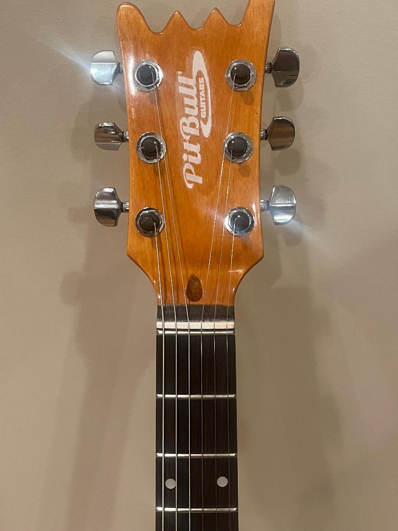

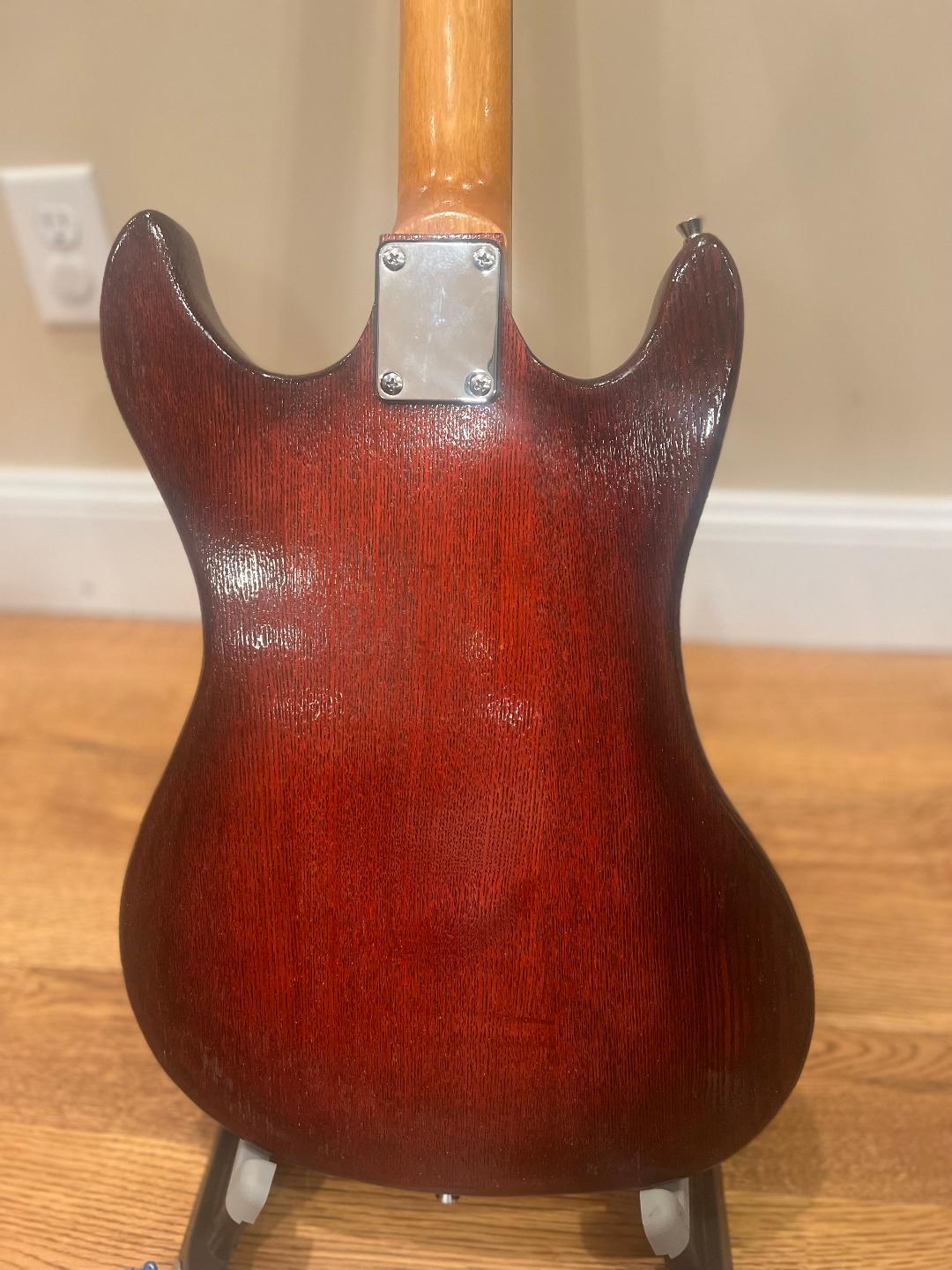

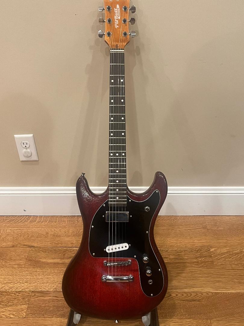

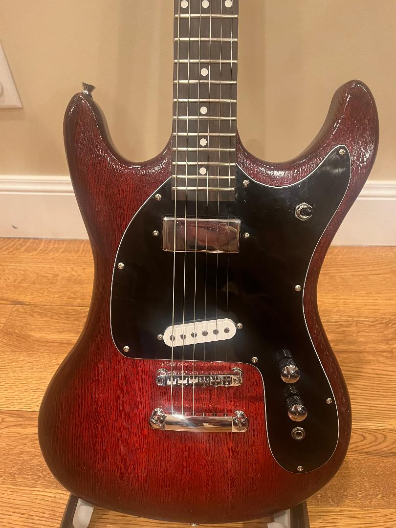

    July GOTM

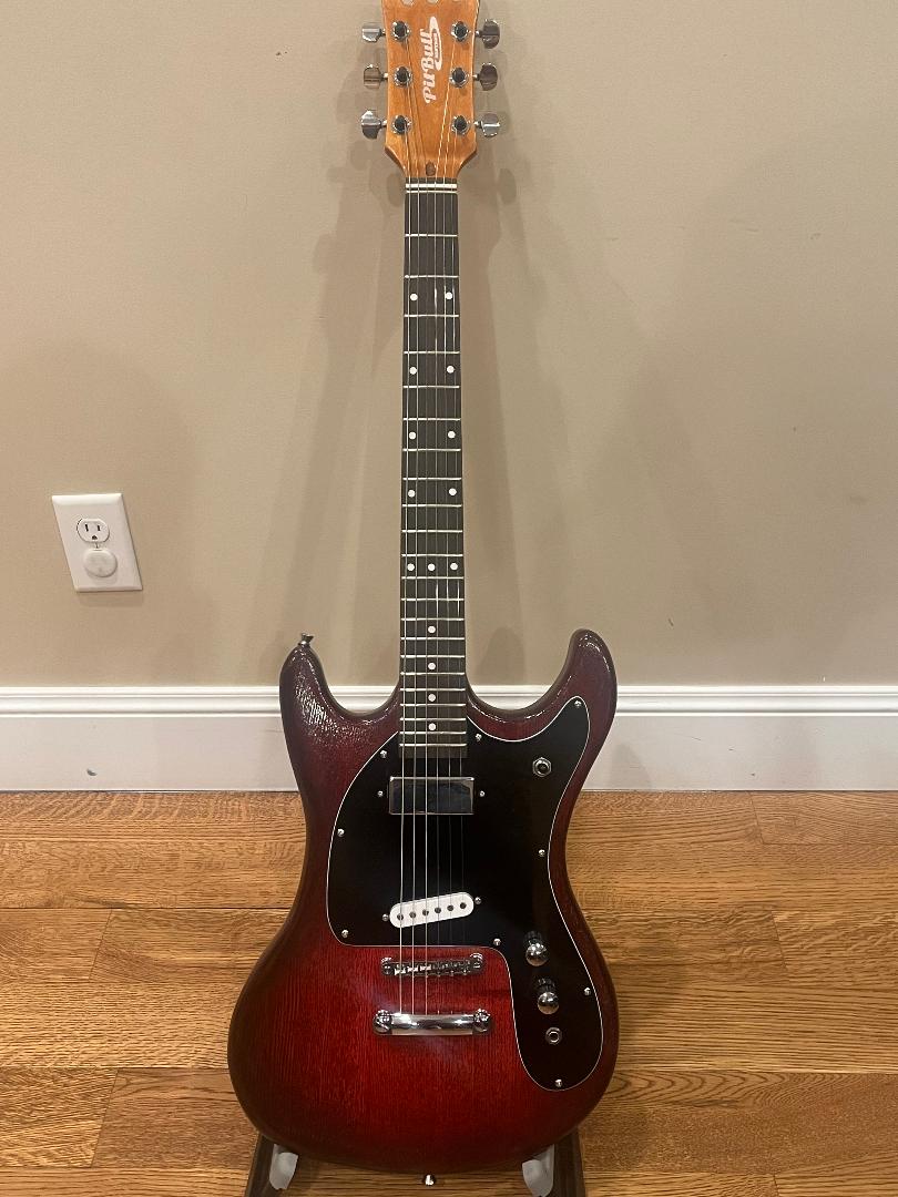

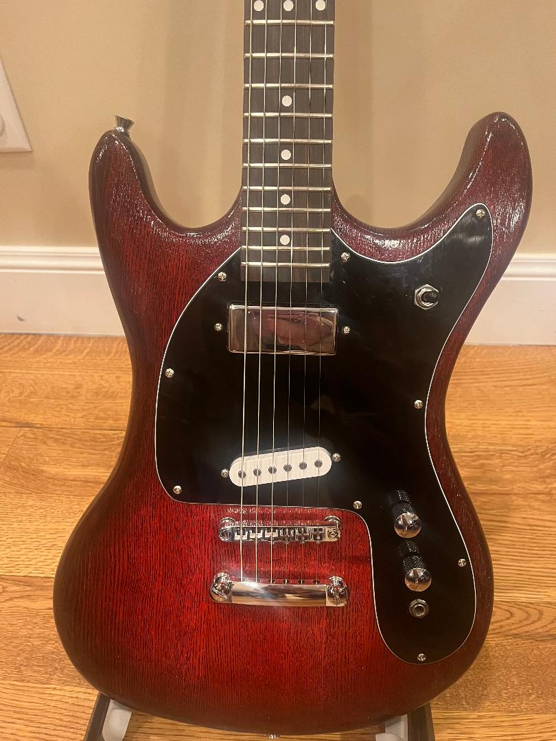

    Considering the artistry that shows up on this thread, I don't know if this qualifies as a GOTM contender. But I've gotten a lot of complements on it, so it might as well be seen. Mostly stock PBG, with D'Addario tuners. Left a very slight grain in the ash body, which catches the light an gives it a sparkle.

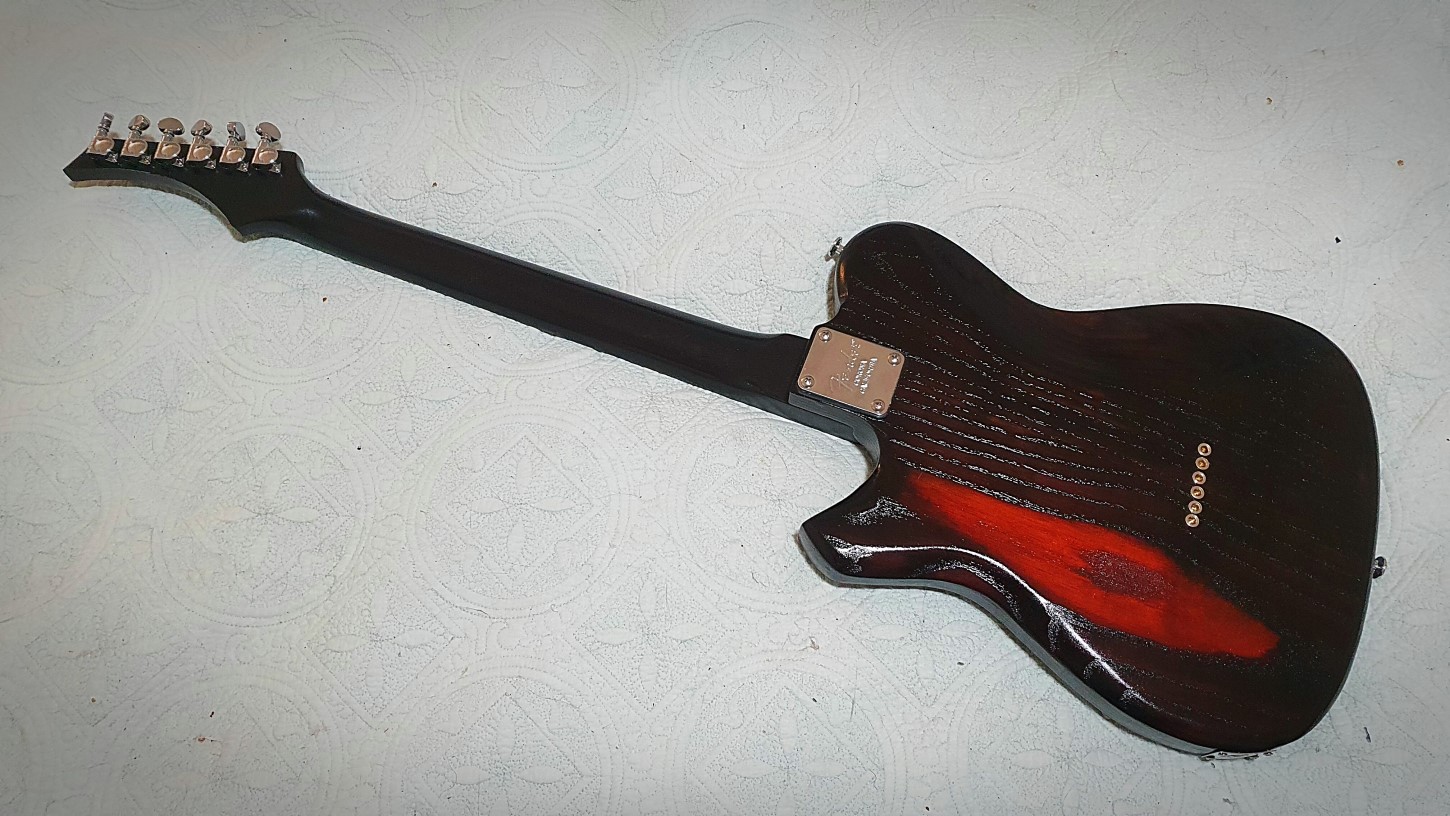

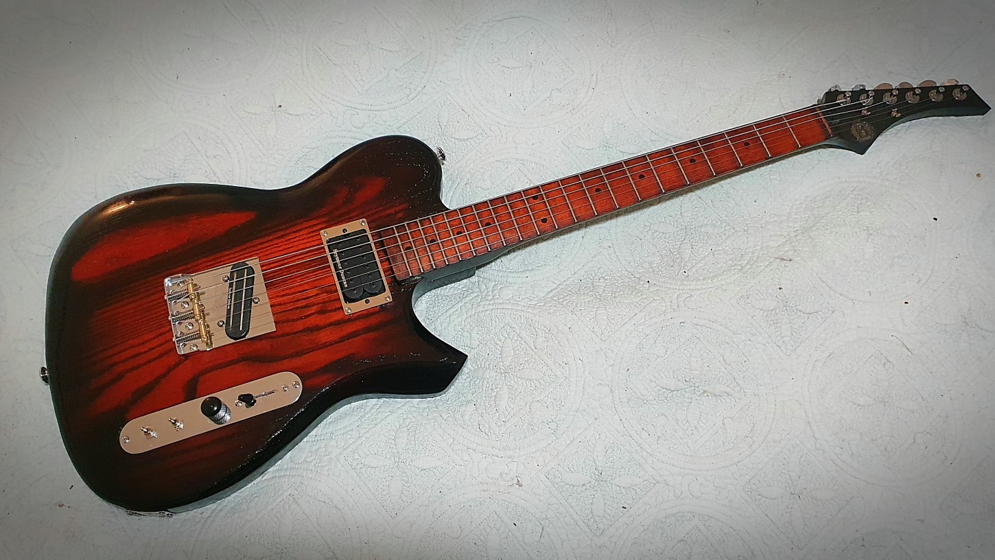

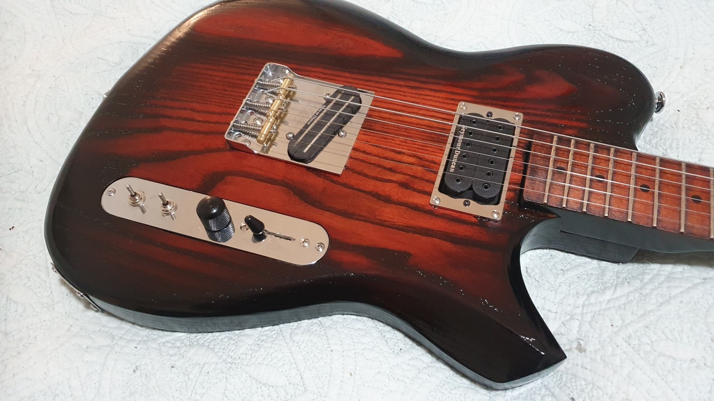

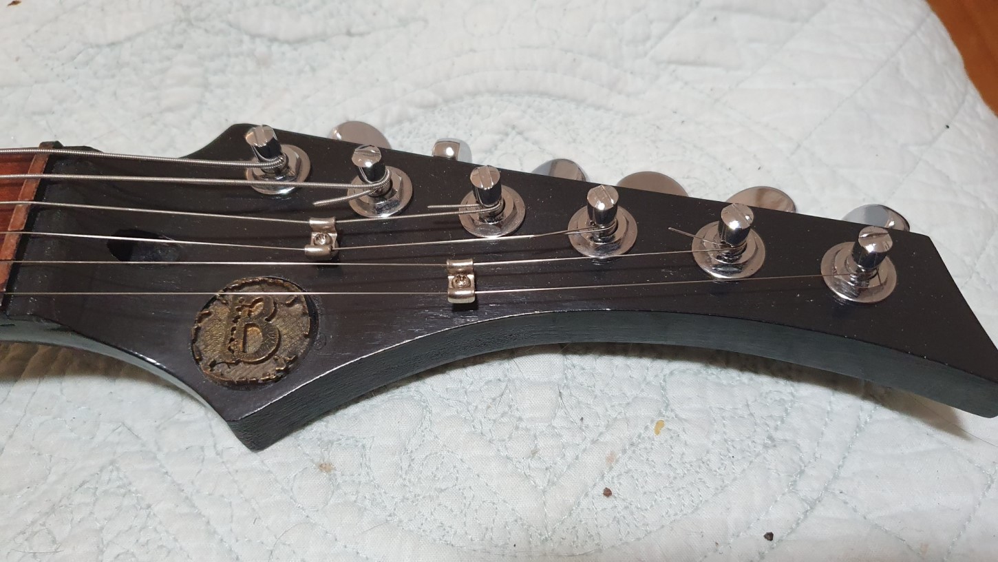

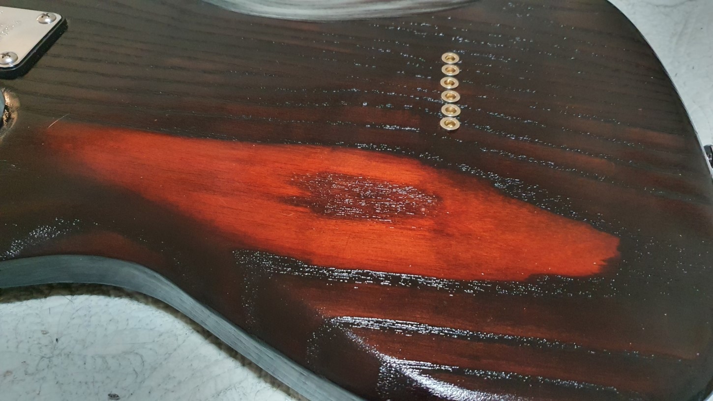

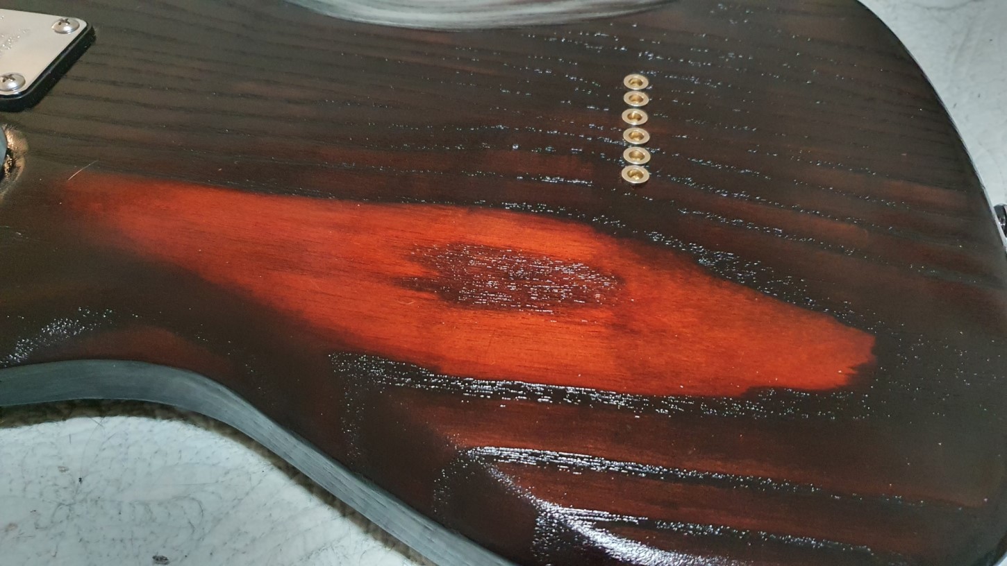

    This was the first kit i got from Pitbull. This is it's 3rd iteration over 2 years.
    Finally happy with the result.
    The figuring on the ash body was not done justice to until this time around. My first effort was with poor dye, the second was with a torch, it was ok but just didn't hit the right spot for me. I have heavily modified the body from the original. Lots of carving, humbucker rout for the neck and a new lower horn. The control plate has been recessed into the body. The stain is from Crimson and I used Dulux Duramax for top coat. Sanded with 600 grit after 1 can. It is not polished as I wanted the texture of the grain to be a feature.
    Pickups are a pair of Seymour Duncan's. Wiring is 3-way with a Single volume control. Mini toggle on neck for South coil/Series/Parallel, Mini toggle on bridge for North coil/Series/Parallel.
    3-Saddle Top Load, String-Through bridge with Compensated Brass Saddles and Grover locking tuners.

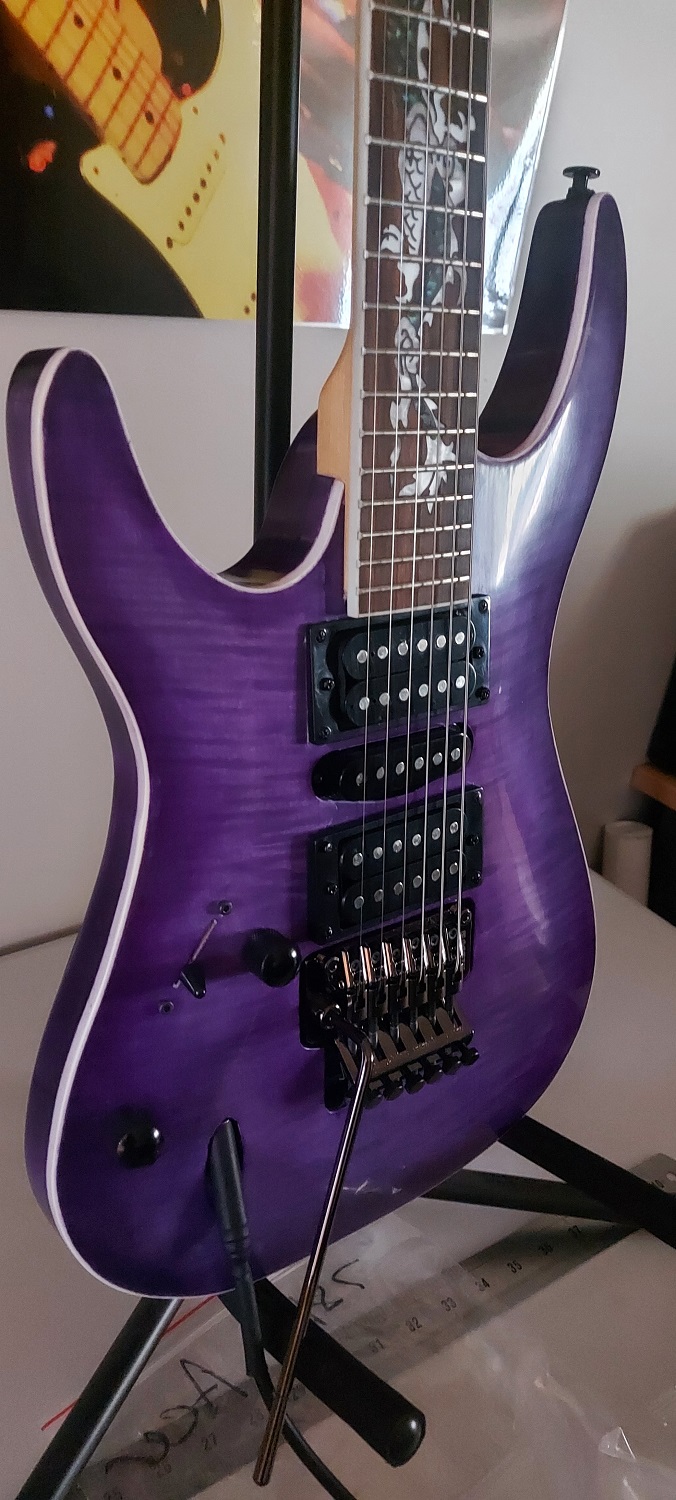

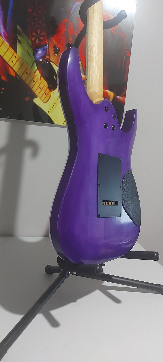

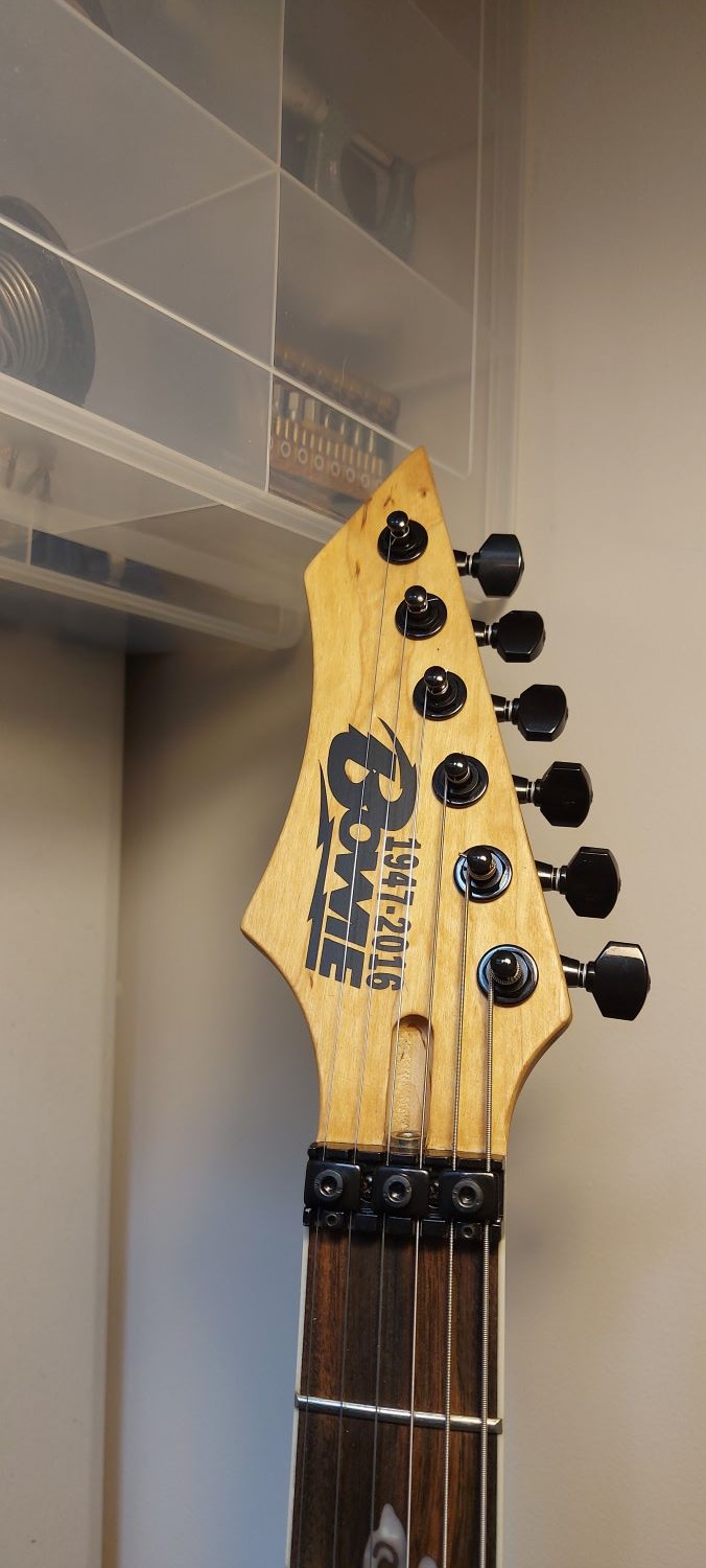

    Purple lefty IB-1F

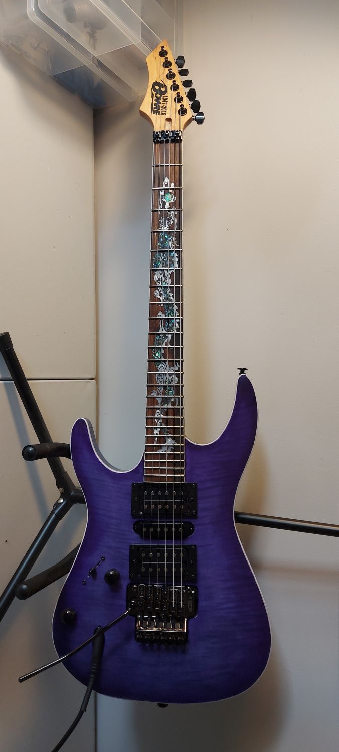

    This is my first foray into building guitar kits. Upgrades include gotoh tuners and tremolo .
    Neck treated to pale boiled linseed oil, left the natural look to contrast with the colour .
    The body was sealed with water based clear and polished.
    Also off set the tuning pegs for a bit of a difference.
    Got set up at the local guitar shop and had a good reaction from them.

    1. XP Rider's MKA-2 -
    Nice cherry red. It’s picked out the ash nicely. Overall great guitar!
    Noice. Can see this thing making some noise! Great looking guitar with some sweet looks. Use of the D’Addario tuners is a great idea. Minor point – next time feel free to experiment with your own logo!
    I think your comment undersells the guitar! It looks like a great guitar and looks like it will turn heads. Ultimately though if you’re happy – that’s all that matters.
    Classic style and looks – what more can you ask for?
    I love the colours and the bold headstock! This guitar has an antique and matte feel that that is very charming. It makes me feel sitting by the fire and jam along with some friends! The PitBull decal is great but it would have been great to see a custom logo or something a bit more personal
    2. Johnbamb's TLA-1 -
    Lots of custom work on this one – end outcome – something special. Looks like third try’s a charm!
    John – worth the third attempt – this is a great looking guitar. Looks like a Tele and a MusicMan bass had a baby – great looking guitar!
    Nice tweaks and adds. Great that you’ve kept the grain as a feature, but the colours and styling seem to enhance it. Awesome work!
    Love the shaping – really makes this guitar. You’ve done an awesome job on it!
    I love the dedication and the fact that you embraced the long journey until you were satisfied!
    The grain on this guitar is absolutely beautiful and it has been treated very well.
    The red and black combo on the body is very elegant, the black neck is a great choice and that headstock shape & logo are very great choices, congratulations! I would definitely try this guitar if it was in shop or for sale.
    3. Senobi's IB-1F -
    Love the take on a classic. Nice reflection on a legend. Keep it up.
    Purple worthy of a Prince guitar! Fitting tribute to Bowie!
    Great finish – the purple is awesome – coming from a not purple fan. Nice work on the Floyd as well.
    Senobi – nice start! With guitars like this it’s easy to see why this is becoming such a popular hobby.
    This is neat, wherever I look, this is very neat! The body colour is absolutely brilliant, I love the headstock decal and the general feel… very aggressive, in the most musical and positive way! A very professional looking & finish, perfectly assembled instrument.
    Well done!

    So - based on the judges feedback - runner up is:
    Senobi's IB-1F - - great choice and delivery of colour and a fitting tribute to the legend.
    And a winner - with all the custom work - congratulations to Johnbamb's TLA-1 - ! Awesome work!
