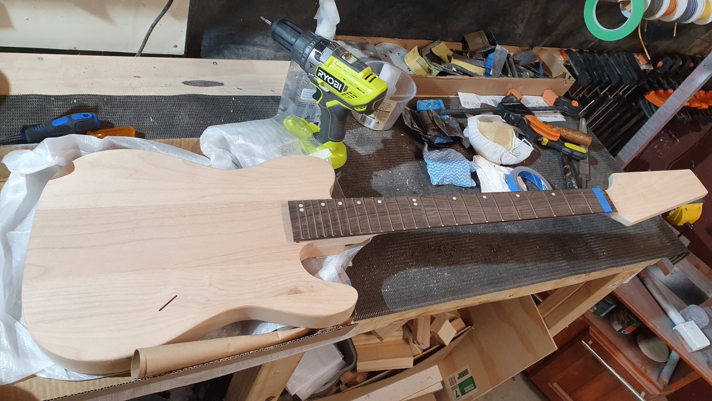

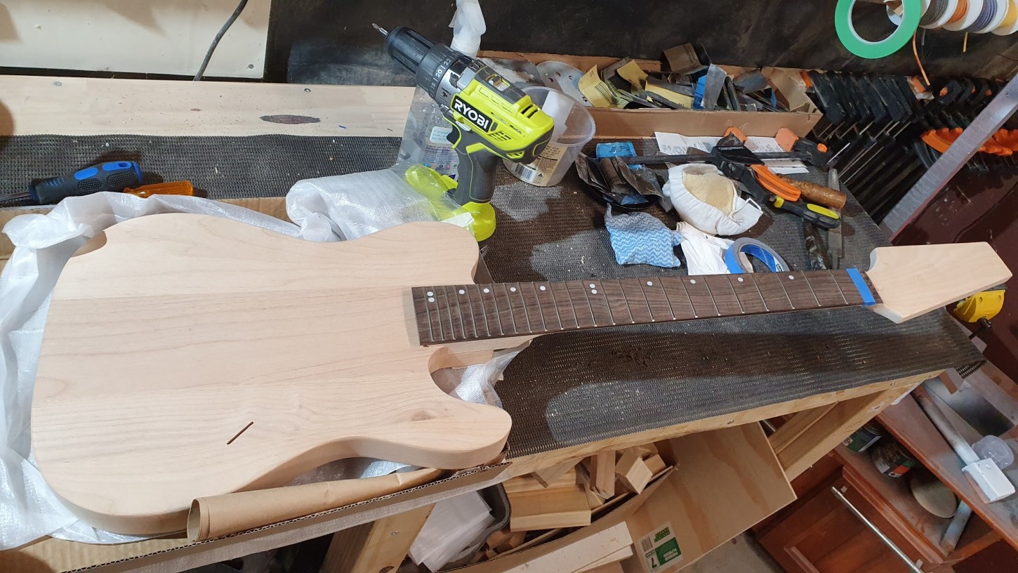

    Here is my custom order Tele.
    I spec'd and ordered this last year for delivery in March.
    I am very happy with what showed up.
    The body is amazing, neck fit very precise and the fret board has great figuring.
    It has been in my workshop since to acclimate the wood.
    NECK
    7 String Maple Neck - bolt on
    27″ Scale length
    C profile,
    Rosewood fret board
    24 medium jumbo frets
    MOP offset dot inlays
    Reverse paddle head stock – No pre-drilled holes
    Bone Nut
    BODY

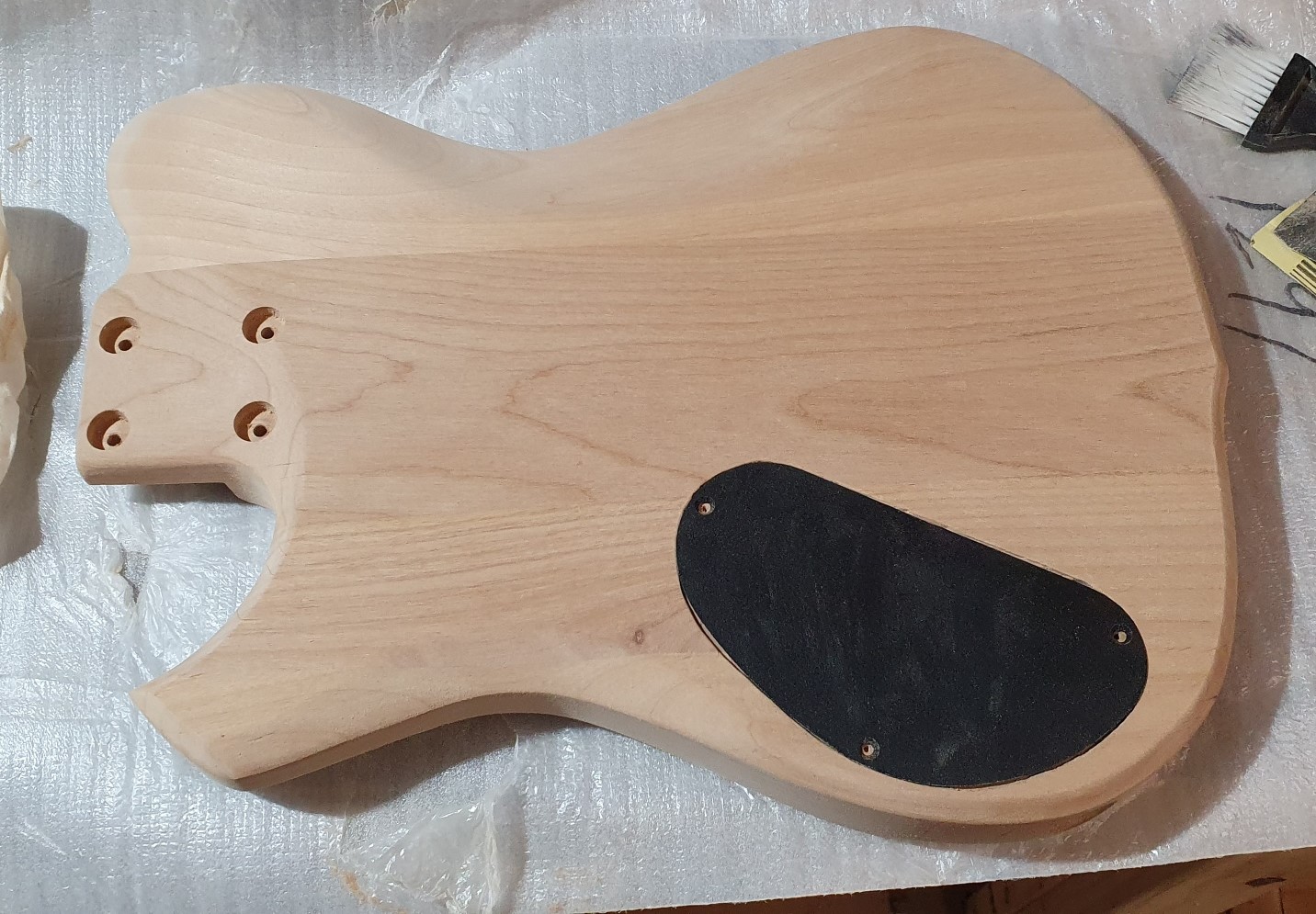

    TL style guitar - alder body
    Rear control cavity and layout as per IB-1F model
    I have big plans for this.

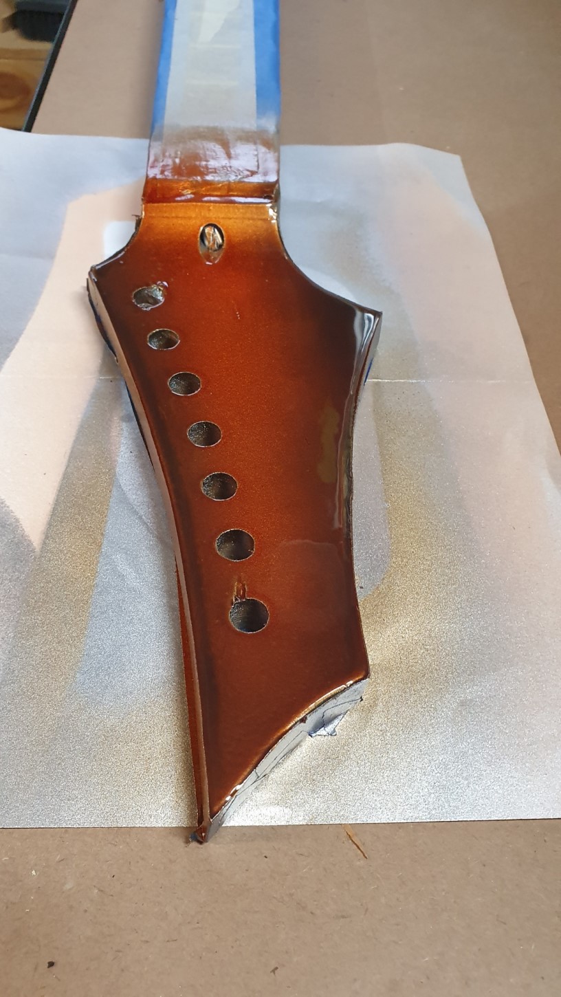

    Headstock

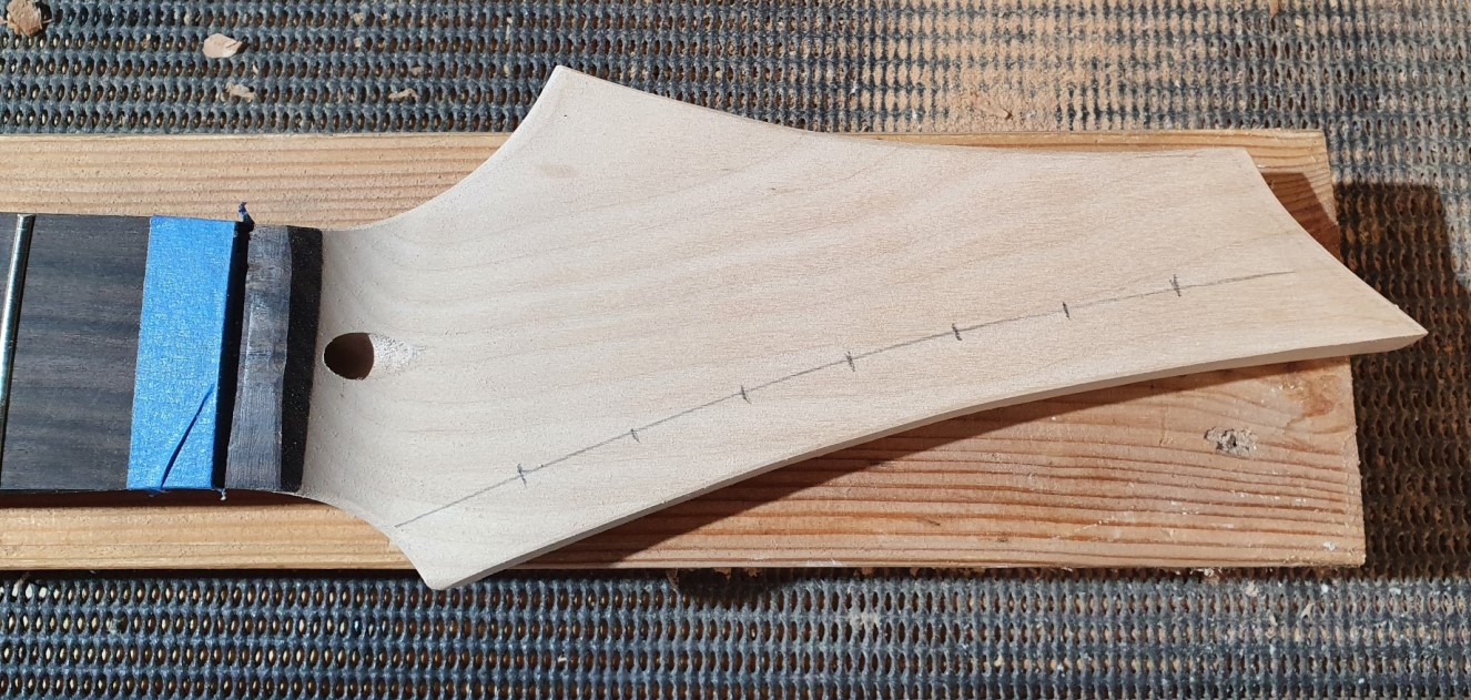

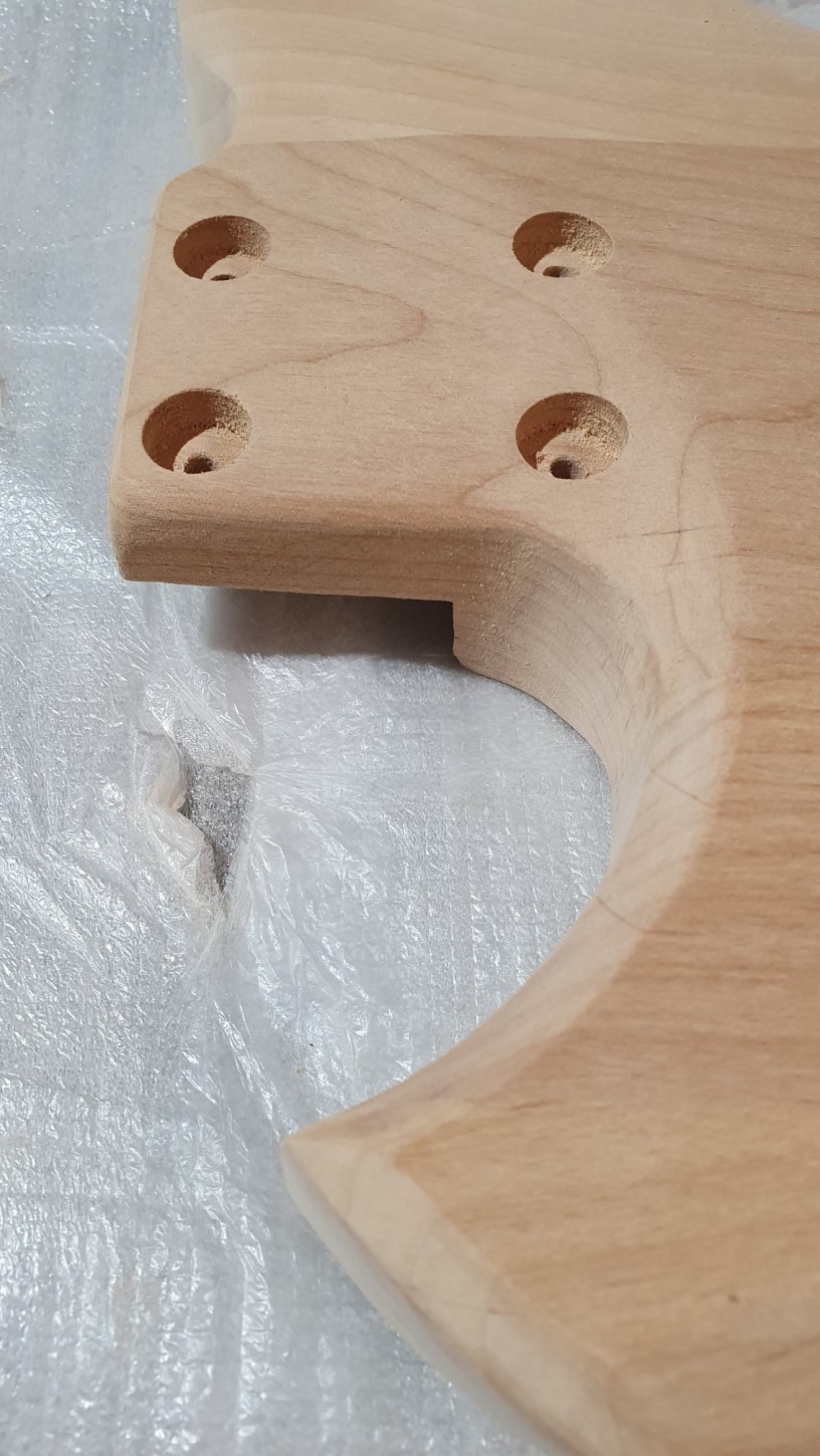

    The headstock is reverse cut and curved. This matches a Strat style i build a few years ago.

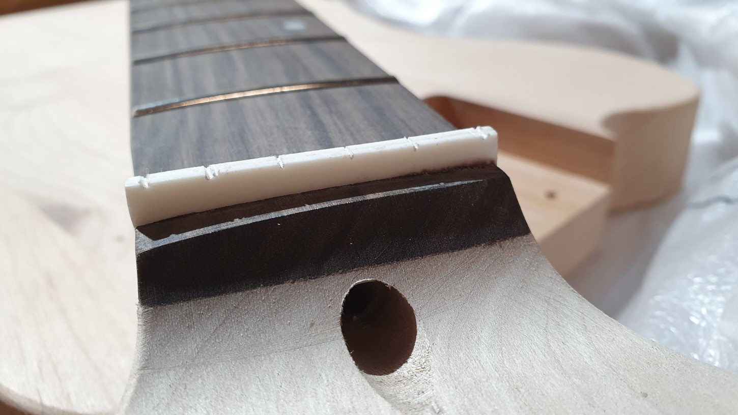

    The only thing i didn't like was the nut. It has been distpatched and a Black Tusq nut is ready to go.

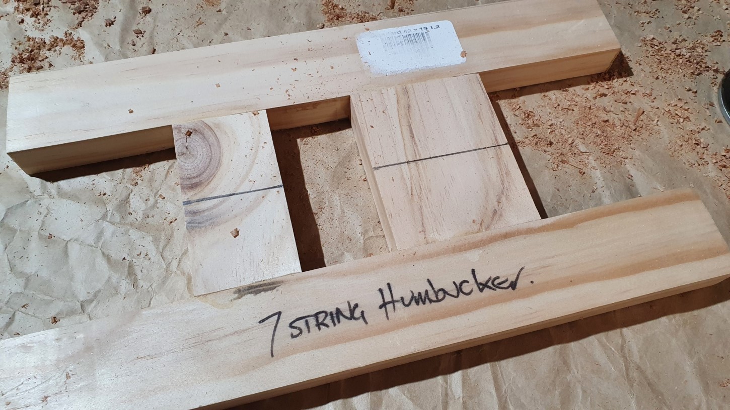

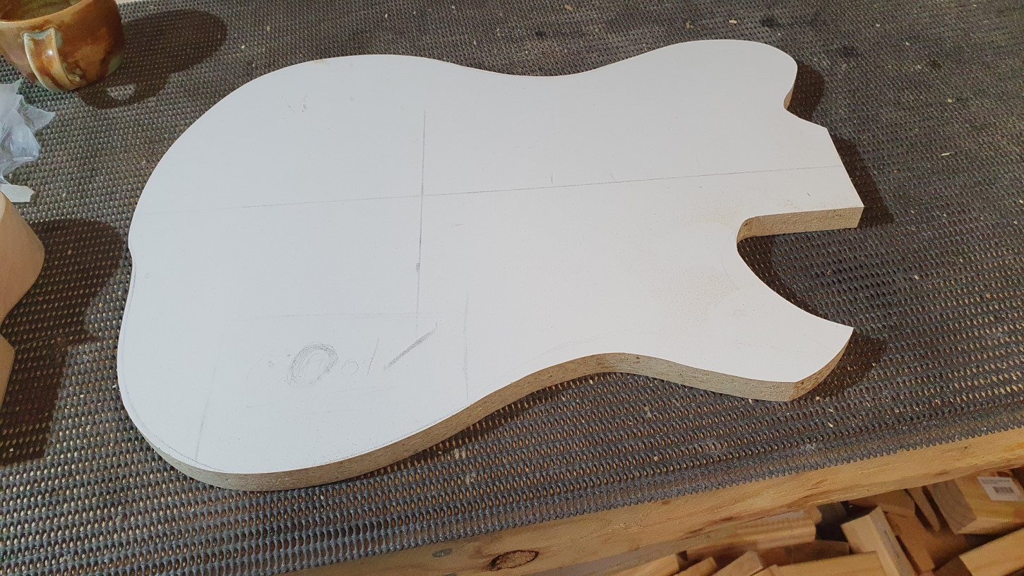

    Plans for the body.....
    Shorten the traditional Tele by about 10mm and narrow it by about 15mm.
    Reshape the lower horn and do a load of carving and contouring.
    Template first

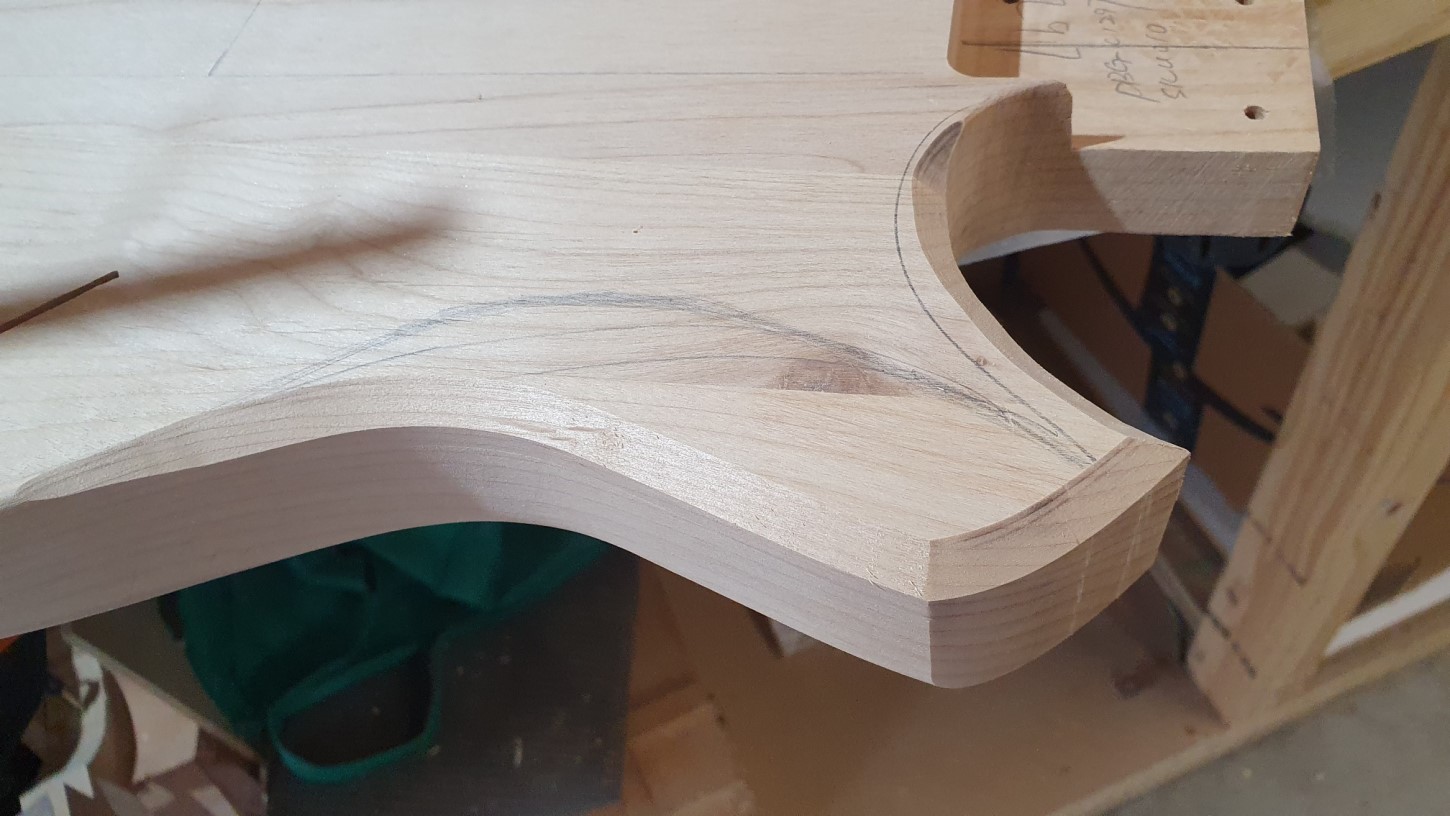

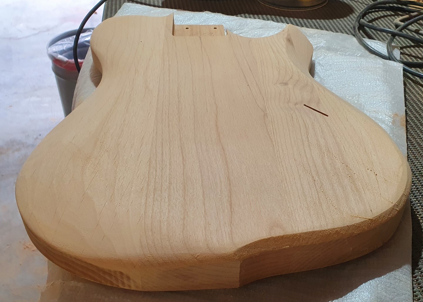

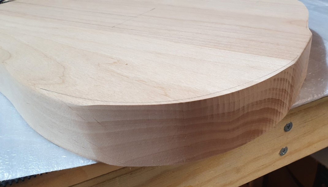

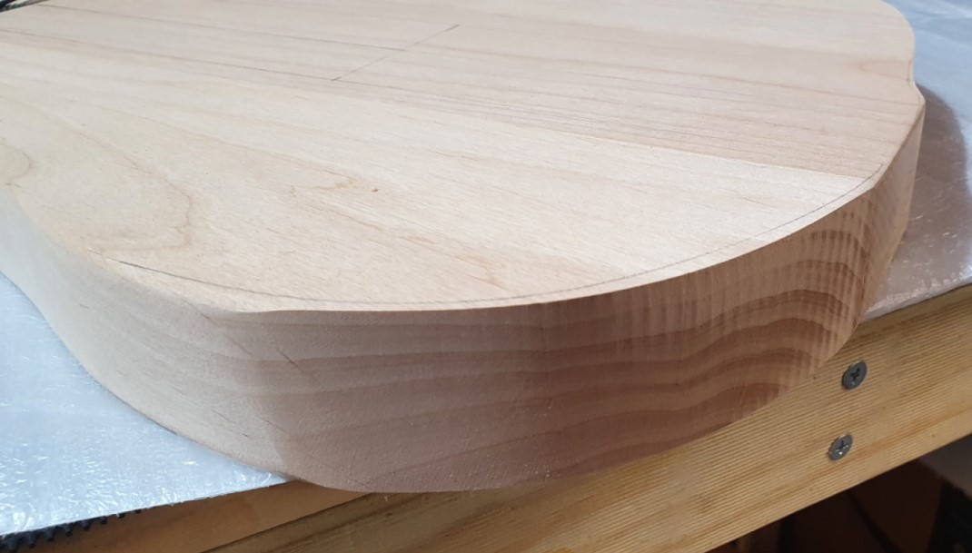

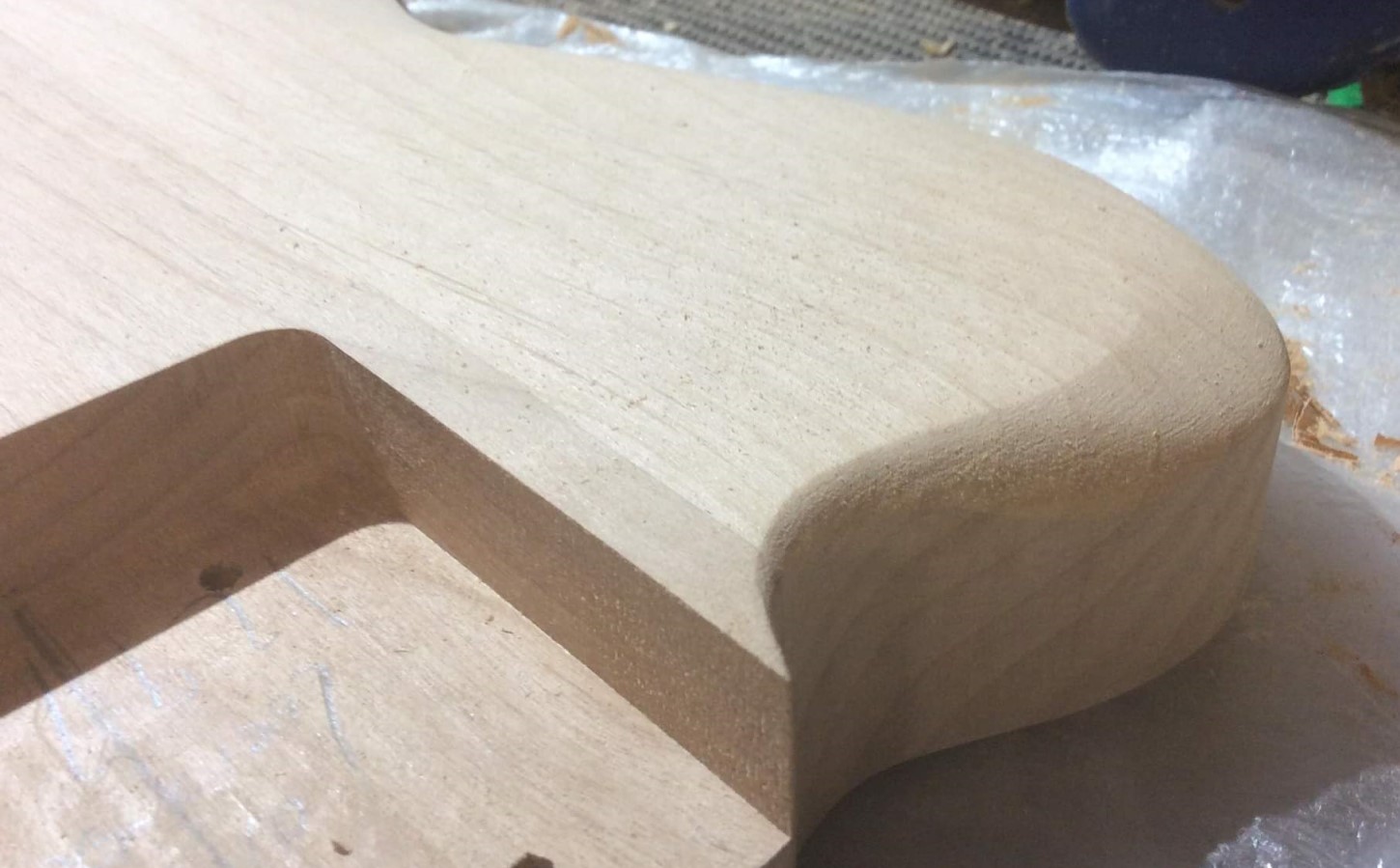

    Body cut and carving done. Lots of sanding over the next few weeks to get it ready for painting.
ID:	43032   Click image for larger version.
ID:	43033   Click image for larger version.
ID:	43034   Click image for larger version.

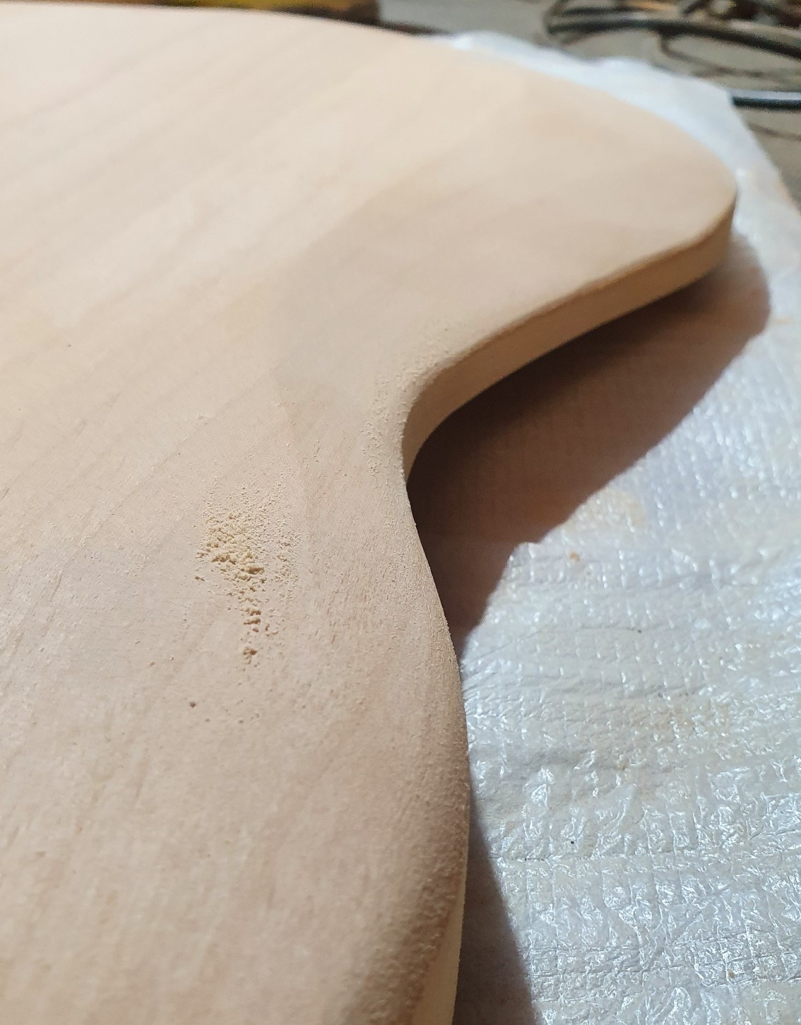

    Feb 2021
    84

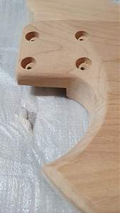

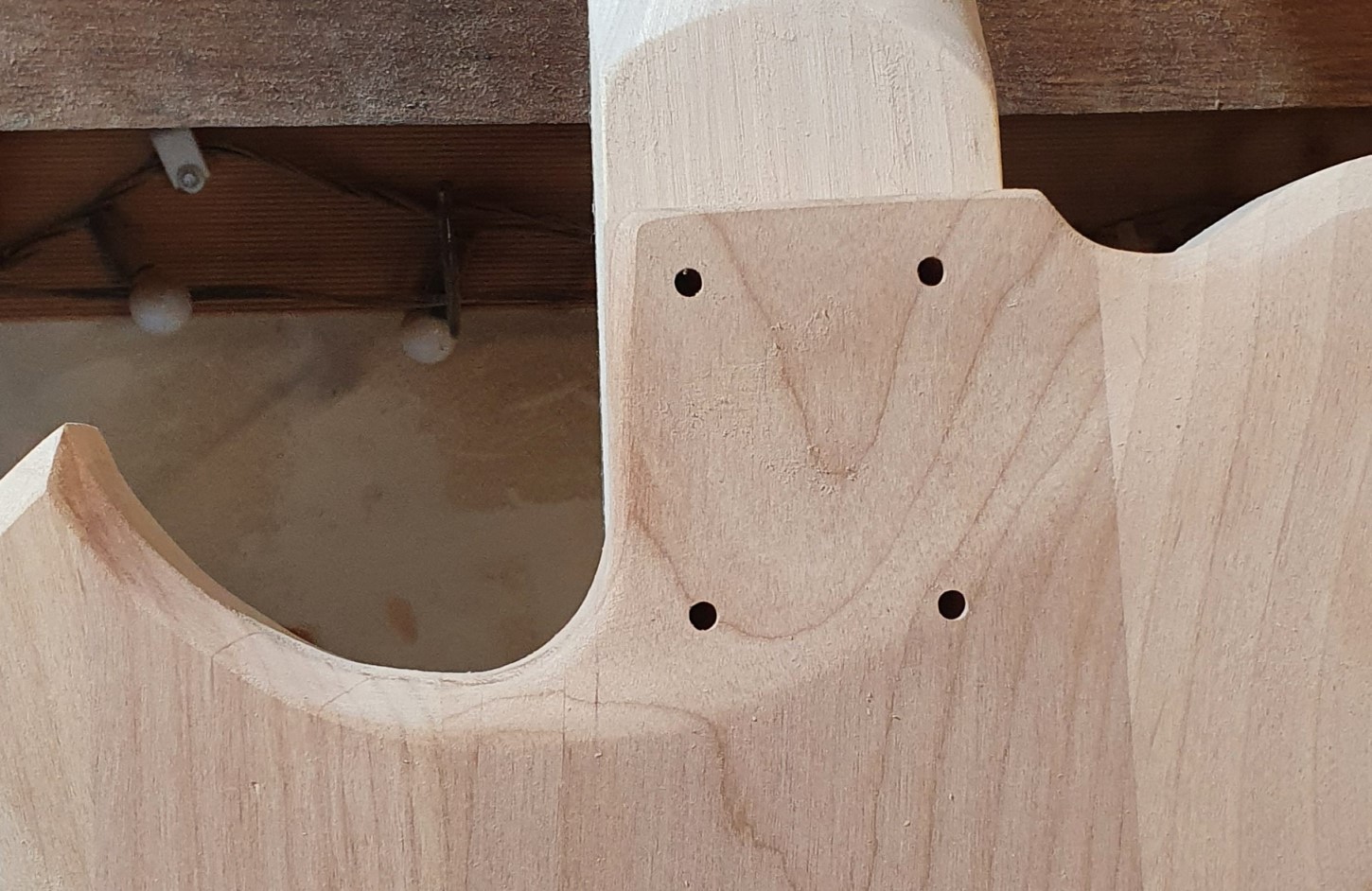

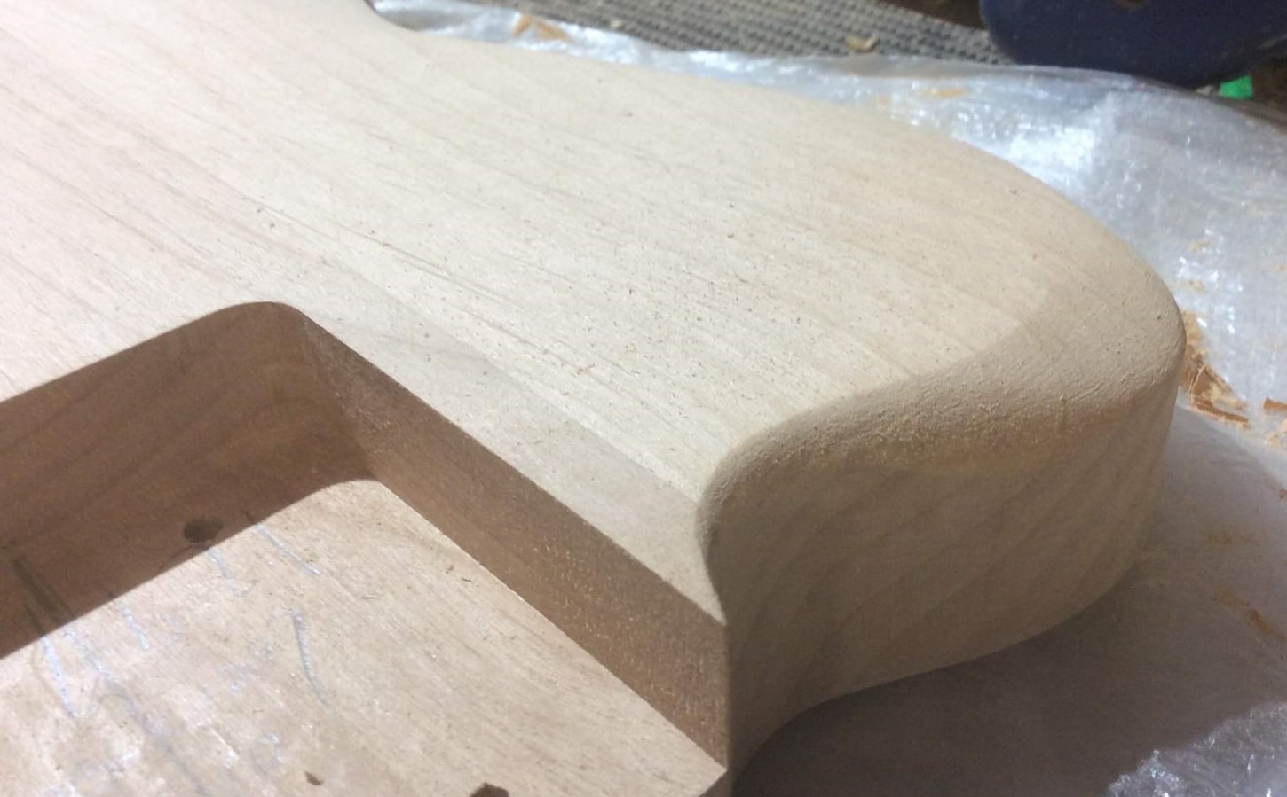

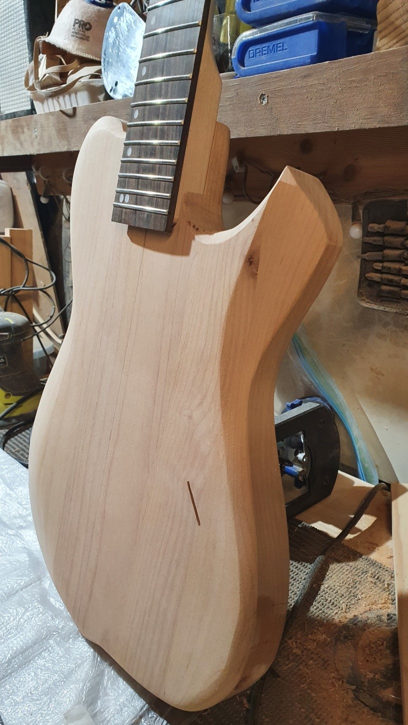

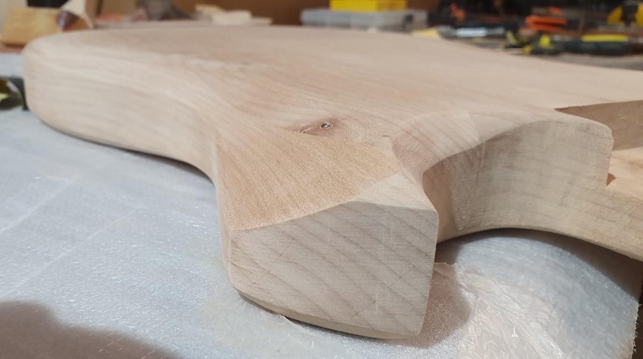

    Refining the horn and upper curve. Comfort carve to heel and neck pockets area

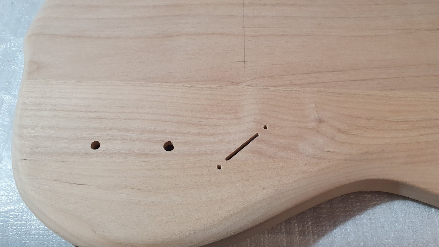

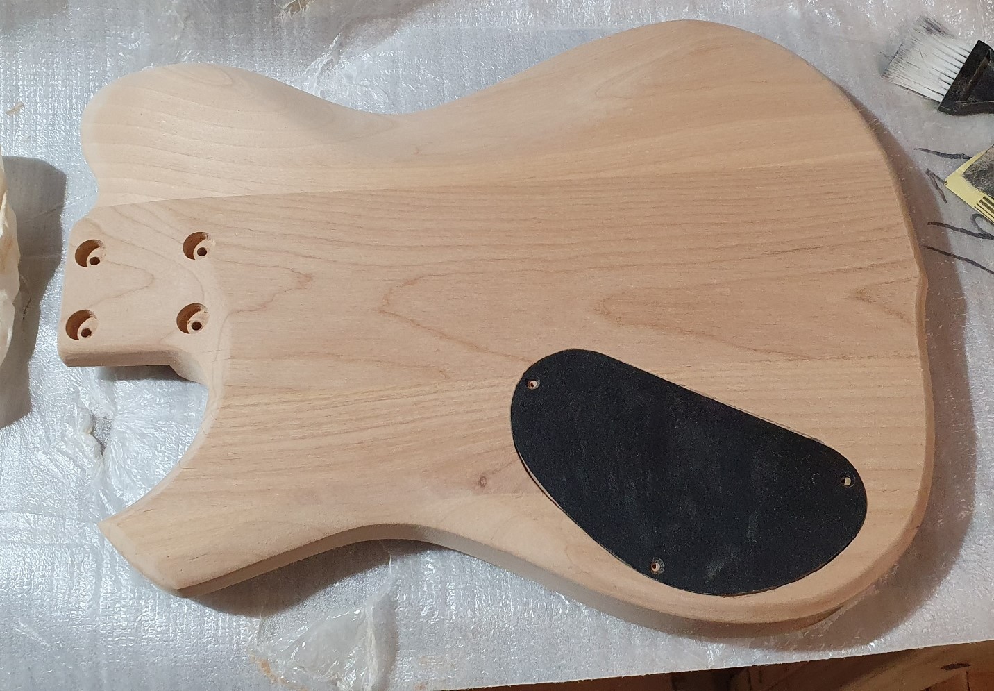

    Rear cavity adjustment and control area

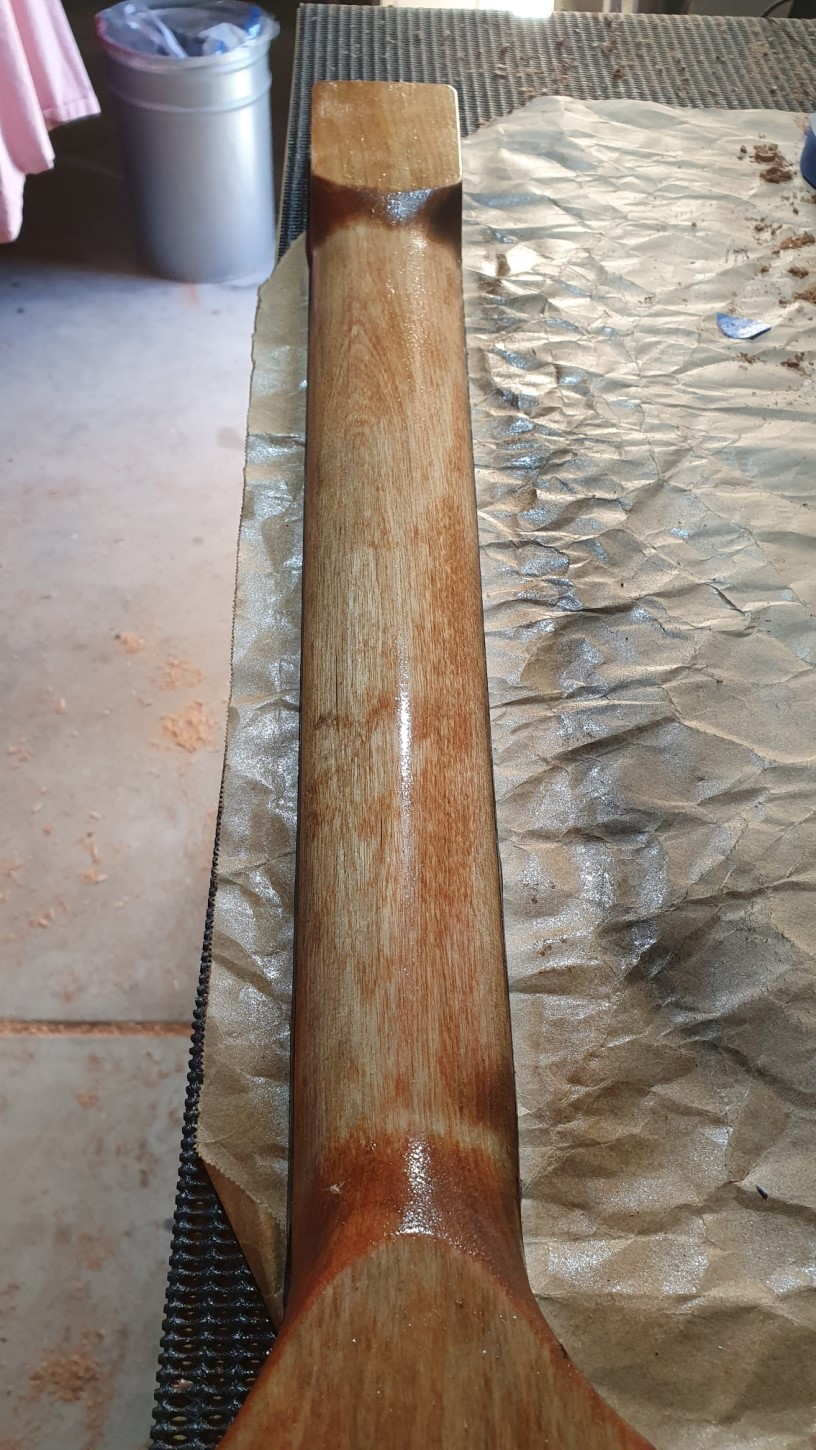

    Feb 2021
    84

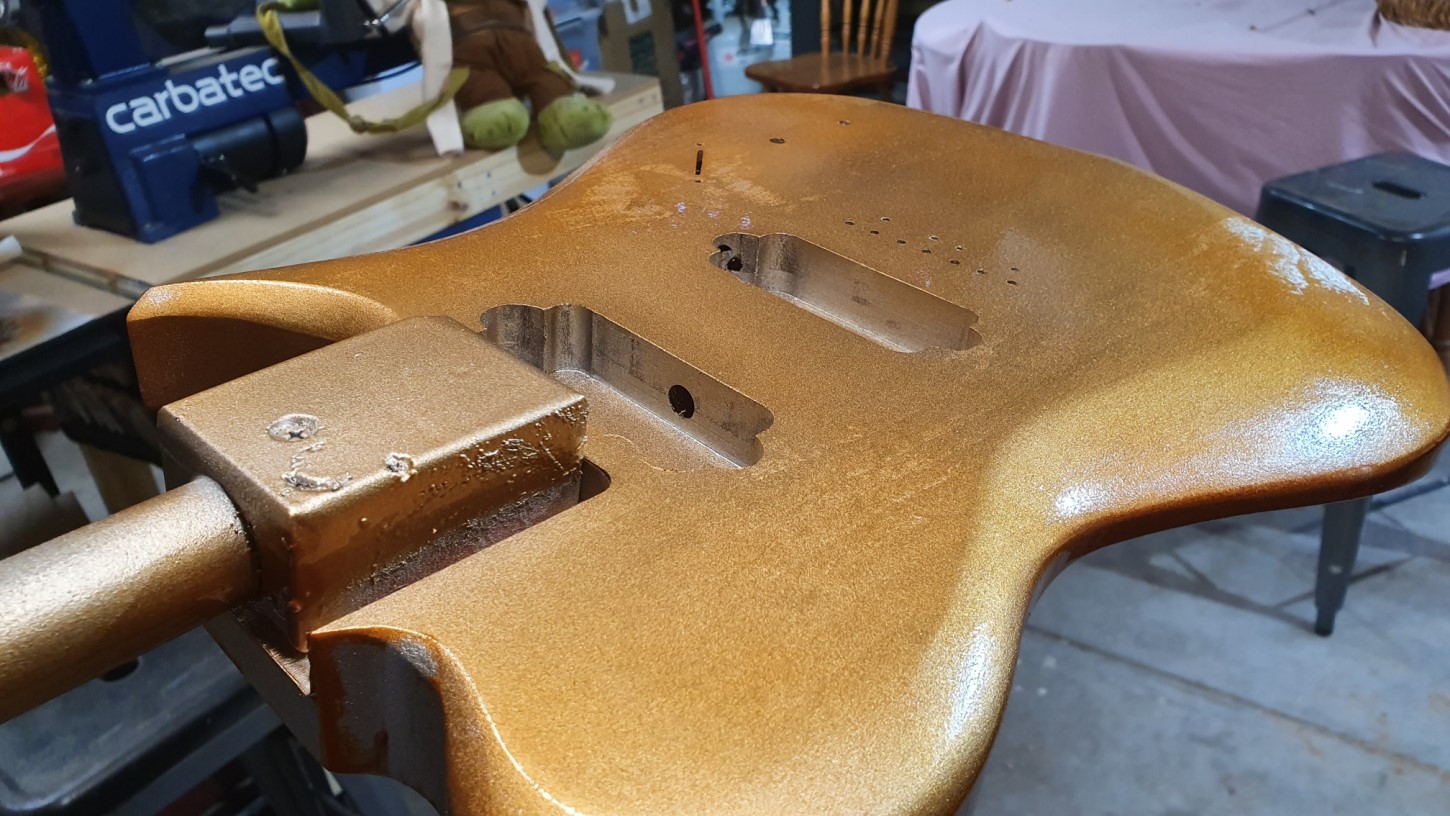

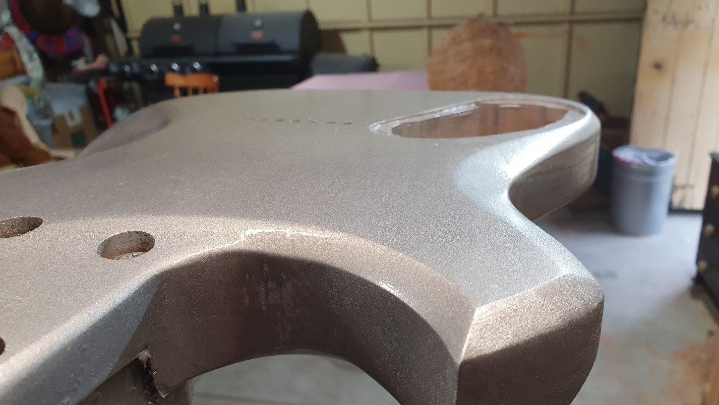

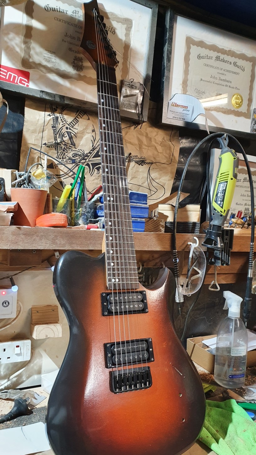

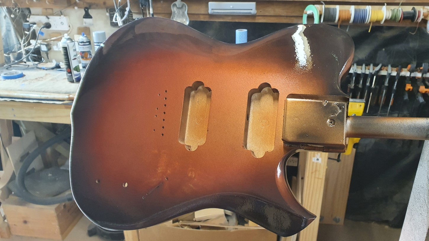

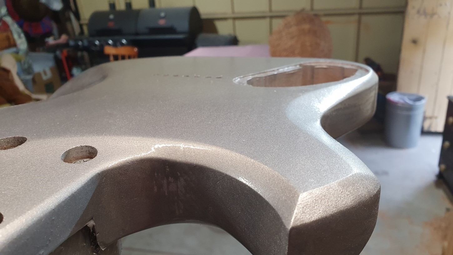

    Trying something new this time. Dupli-color Metalcast.
    I have learnt i would never want to paint a whole car with this stuff. It is incredibly wet to spray compared to regular paints. So small light passes and build it up slowly. Which is difficult, but that's what trying something new is all about.
    Base coat first which is a silver-ish metallic look. Then orange. This color really didn't like the end grain. Last is a grey for the burst.
    It works a bit like nitro.
ID:	43069 Click image for larger version.
ID:	43071 Click image for larger version.
