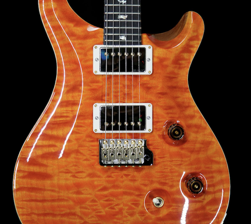

    I have a couple of PBG's on the go and looking for some opinions on a dye finish. All my guitars to date have been either spray painted with cans or one was finished entirely with truoil.
    I'm looking to finish off a quilted maple top as per the pic below. I've been looking at the Angelus Leather Dyes for the orange colour.
    My question is that given i haven't done a dye finish before or worked on a figured top, i'm wondering if the below colour is more than just an orange, and whether it may have some other colour under or over the top?? Thoughts? Possibly it has yellow and not just orange? Would something with so much depth just be a single colour?

    sorry but I do not have any experience with a quilted maple top yet. But I would assume orange , rubbed back, then yellow.
    Check out Dozy's quilted build at https://www.buildyourownguitar.com.a...l=1#post209823. This was black, rubbed back, then blue. I think from memory they were water based (Ubeaut dyes). Hopefully Dozy will chime in and add more (or the truth!).

    Looks to me like a single colour orange dye/stain applied on that PRS. Take into consideration the colour of the veneer as that will affect the final colour. All the pattern variations seen on that PRS are down to the maple used for the top. You'll need a very figured bit of veneer to get it to come out quite like that.
    Use the wipe over with turps or metho trick to see how figured its going to look with a single colour stain. If it's not that intense an effect, then you may want to go over with a darker or even black stain first, and then carefully sand back before applying the orange. This will 'pop' the grain that is there.

    It will work (sort of). Shellite (aka naptha in US) evaporates really quickly so you don't get a lot of "viewing time".
    Metho also has a quick evap time, but slower than shellite.
    If you're going to be using water based dye, I would avoid turps. It may be fine, and ftr I have no evidence to support my thinking, but I always try and minimise anything that might cause incompatibility issues when it comes to finishing.
    If you're going to use alcohol based dye, I don't feel it's an issue. eg: Feast Watson Proof Tint is alcohol based and can be used to tint oil based polyurethane.
    I've happily used turps and/ white spirit before using water based stain, but you need to allow time for the turps/spirit to evaporate fully before using the stain. Probably wait until the next day. Turps is just so much nicer to use than white spirit.
