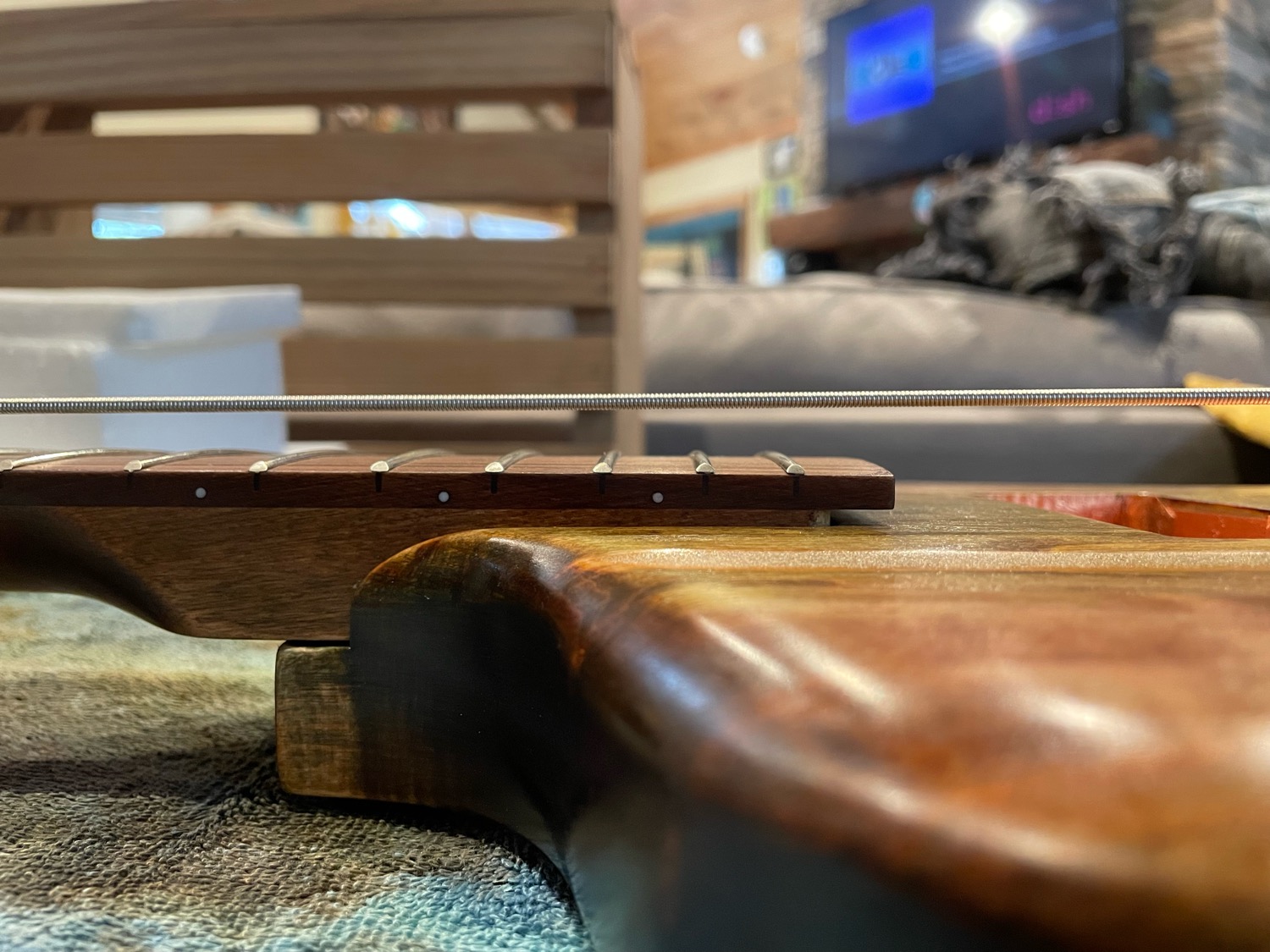

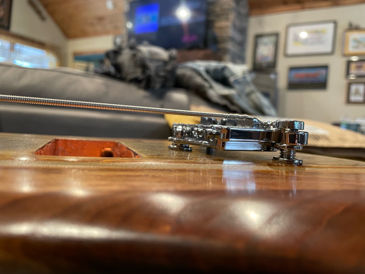

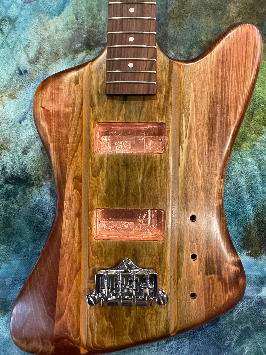

    New builder and I just had to have the T-Bird, even though I read a bad review about the string action being so high that it’s basically unplayable. Any experience with this by anyone else who has fixed it this issue? The first time I opened the box and saw that the front, center section was raised. That, coupled with a ridiculous 3 point bridge that mounts the bridge WAY too high. Even if the bridge were to sit flush on the deck, the string height is about the height of that raised center section. Why is it even there, be a much better and easier build if it were a true flat front. The only way I see to fix is to route out a nest in the body to sit the bridge into, if you want to make use of the 3 huge holes in the body to mount the thing. Then there is the “replace the bridge” option, but then you have to plug those 3 holes and since you don’t know about the “height” issue until after finishing, and matching the stain is impossible turning it into a strip it and paint option. Anyone with ideas out there?

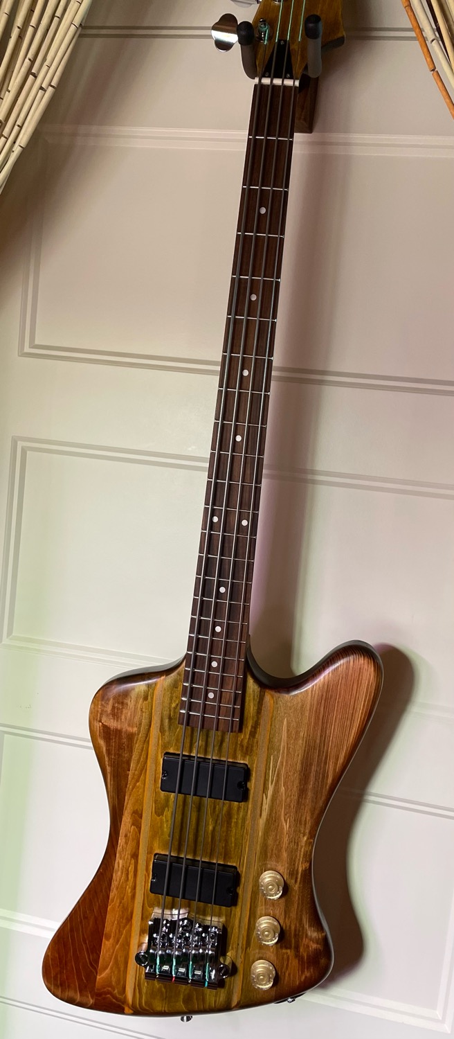

    As of 19 mar 22: The pics show after bolting neck on, then mounting everything and stringing up. That’s when I knew that was just too high. I got the upgraded bridge, counter sunk the inserts, and shimmed/set neck correctly and she played great now. Last photo is the completed project. Thanks for all the assistance!

    If you've already finished it, the easiest option would be to shim the neck - a thin shim in the neck pocket will tilt the neck backwards, lowering the action.
    Thanks! I really didn’t want that option but if that’s the only one……I was hoping to hear from another TB4 builder to at verify the stock situation and relieve me of feeling stupid about it.. thanks again.

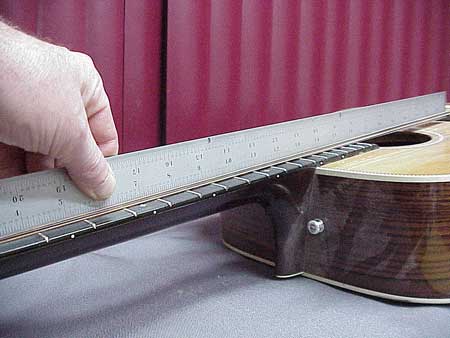

    Hi Johnny,
    The best way to check this is to dry fit your neck in position and lay the bridge in it's position as well. Run a straight edge up over the fretboard resting on the frets so it hangs over the bridge. You can then check to see how the angle looks as well as how much you would have to raise (or lower) the bridge to get a playable action. Remember to add a mm or two for string clearance over the frets. Feel free to post photos of your tests, with a the measurements included so we can chime in and give you some advice.

    I have a 3-point bridge from my first kit. I have tried installing it on two basses. Gave up both times. Mine were on ES kits where they have been really problematic. They may work a bit better on TB kits.
    Here's a vid from a guy who thinks they're not bad...
    https://youtu.be/4L2evDh7eAc
    Sent from my LE2125 using Tapatalk
    The T-bird kit uses the same 3 point bridge the EX-4 uses, and I believe *all* the kits using the kit 3 point bridge suffer the same issues. With my EX-4 I countersunk the holes for the threaded post sockets so they fitted flush to the body, which may help. I also installed a Babicz bridge. Initially I had to lower the saddles , but after it had been strung a while I re-straitened the neck and I had to raise the saddles because the action was too low. This may be a pricey fix for you... The bridge is a very nice piece of kit, but spendy.

    Thanks all! I will post pics soon but what I have chosen to do was go the “pricey” route as mentioned by Rabbit. I ordered the set of shims from stew Mac, the Babicz bridge. I still feel like that raised center C-section is a design flaw that just is ignored. Flattening that area fron bridge holes back AND countersinking the bridge posts.BTW, what’s the best way to pull out those posts without ruining them? Thanks again.
    Find a small screw and put in th post hole base down. Screw in the post and the bushing should start to rise up. The screw head needs to be smaller than your bushing hole. There are a few you rube videos showing how to do it.
