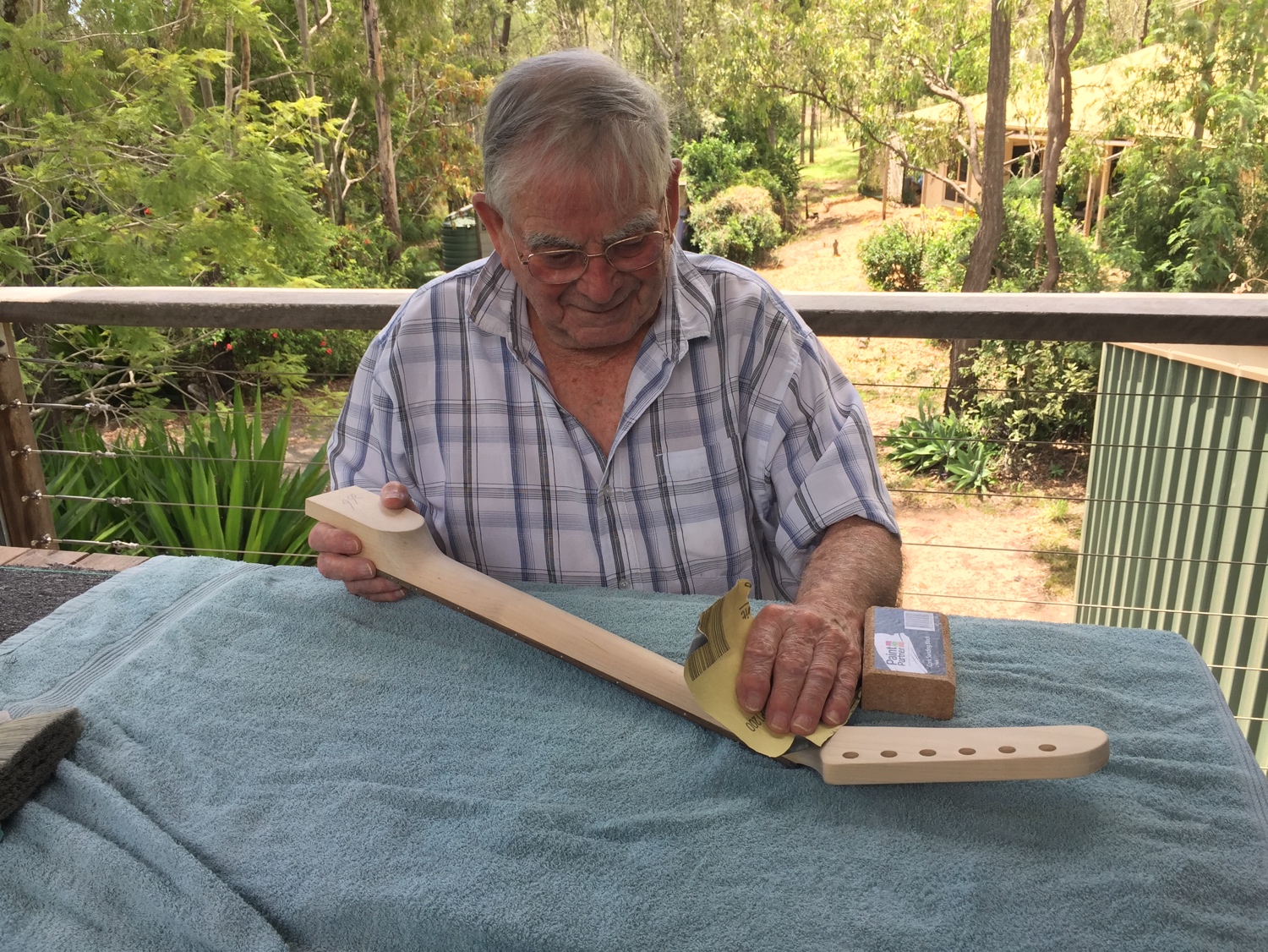

    Day 1.
    Its great working on a project like this with my 88yr old Father, neither of us have built a guitar before and we are enjoying the activity together.
    We started with dividing the work and my job is fret leveling and my Dad has started sanding the body.
    Using a sanding block and 180, 240, 400, 600, 800, 1200 is the plan.
    He is a retired carpenter, so is delighted to see the wood grain patterns coming to light.

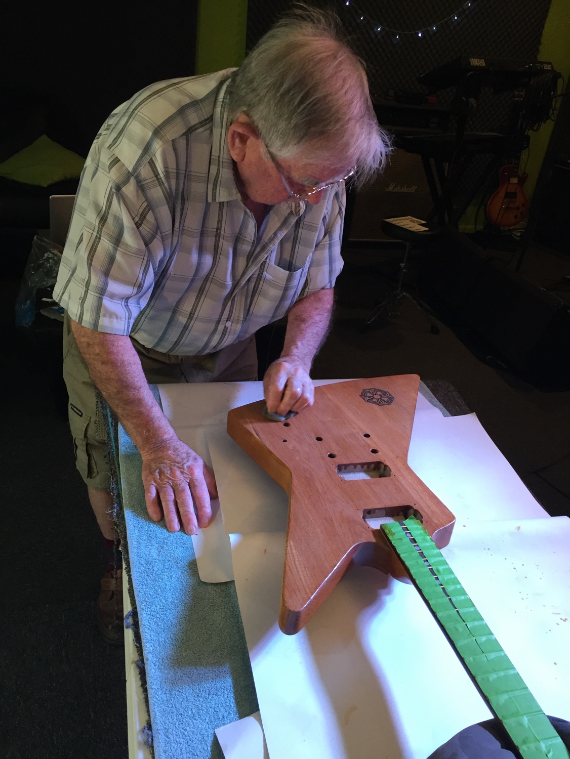

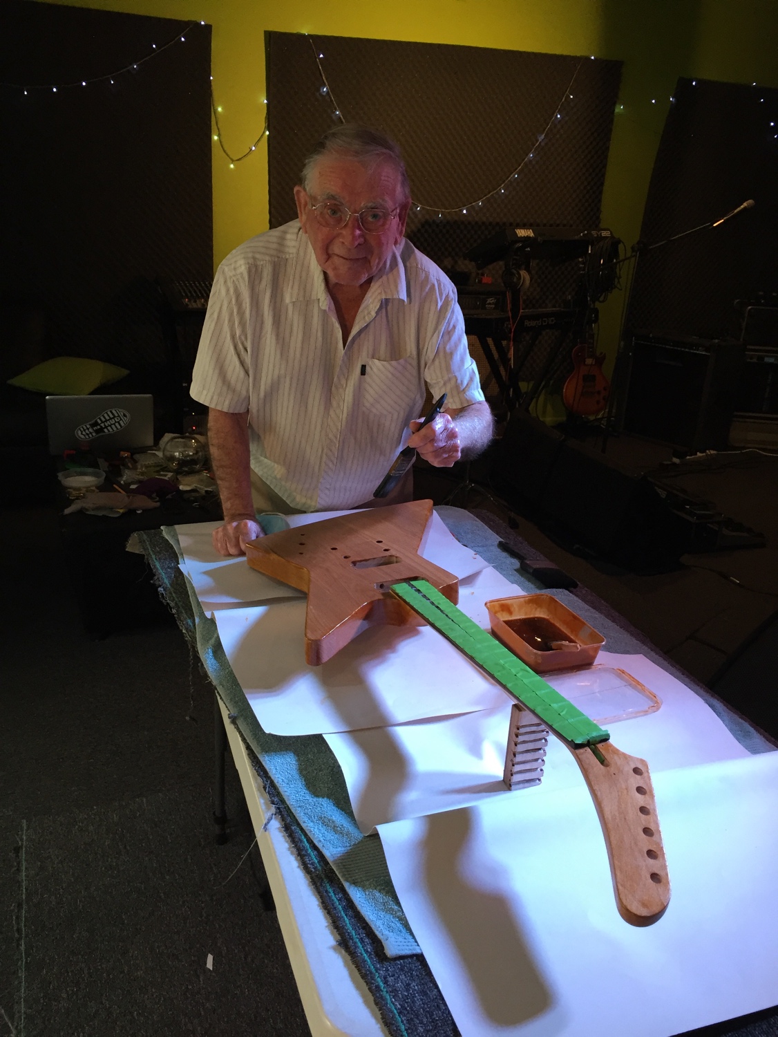

    Day 2.
    More sanding of the body, its starting to look very good and feels smooth.
    Dad is doing some minor contouring of the edges also.
    Neck wise, well it turns out that the tape I used has left residue on both the rosewood fretboard and the sides of the neck. On the fretboard I used a small amount of handsanitizer to good effect to remove the gum. Im not concerned as the fretboard will get a good Dunlop oil in due course..and the neck needs a little sanding anyway.
    Sanded the neck with some 1200 Grit. It needed very little, as it was a big leg up to have it delivered so well from the factory.

    Day 3.

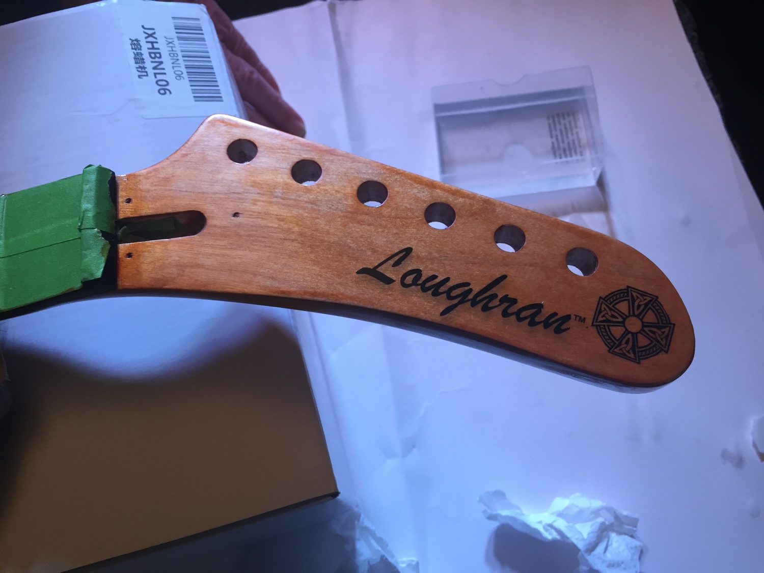

    We made a couple of templates to experiment with different headstock shapes and settled on just slimming down the banana headstock. I think the stock shape looks like a clog
    In the end, rather than use the template, we just bent a flexible steel ruler and used that to pencil mark the new shape.
    Sanded the headstock into the slimmed down shape, there was only a few mm to remove and it was finished within 40 min or so.

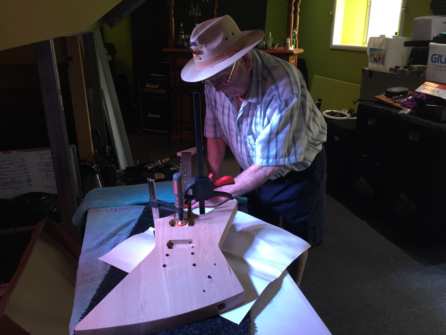

    Day 5.
    Prepared the neck and body for glue. (Put some minor scoring into the wood, to give the glue extra cavities to bind with). Placed tape at areas where there may be glue spread out on clamping. Made a block to ensure the clamp designated for the pickup cavity will reach and operate without binding on the body.
    Made a small block of wood for the fretboard area clamp, cut with fret grooves.
    Applied the supplied PBG glue and spread with a small artist paint brush right into the corners etc, ensuring all contact surfaces had glue covering. So a thin glue coverage to coat the neck heel areas and body cavity (no gaps in the coverage).
    Positioned clamps, tightened the fretboard clamp first and then the one at the neck pickup cavity. Visually checked for gaps and that the neck was correctly seated as it was per dry test fitting,

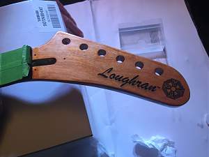

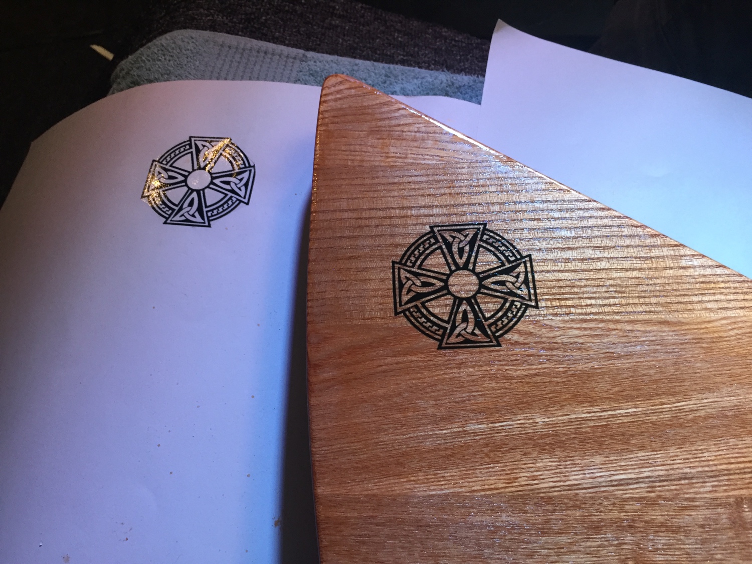

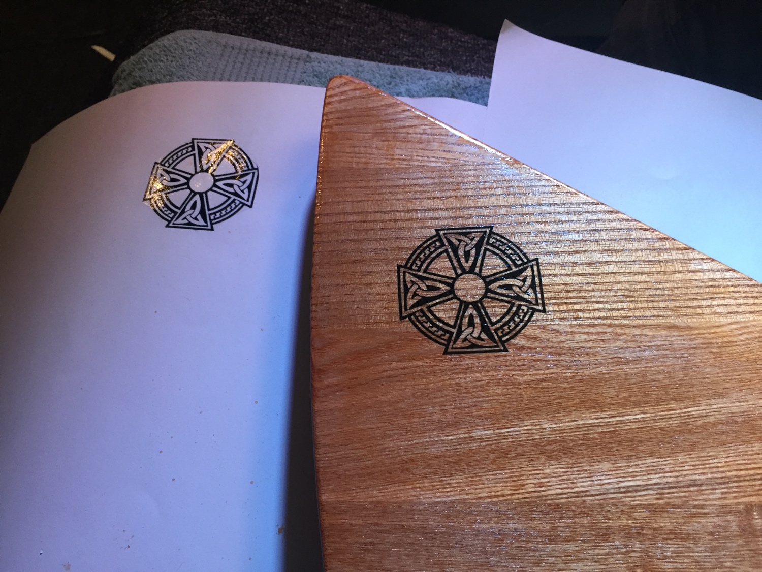

    We also applied the water slide decals today and added another coat of the 'finger painting quality' / shellac.
    The decals were Ink Jet printed and therefore needed a spray coat of clear lacquer to seal the ink prior to applying them.

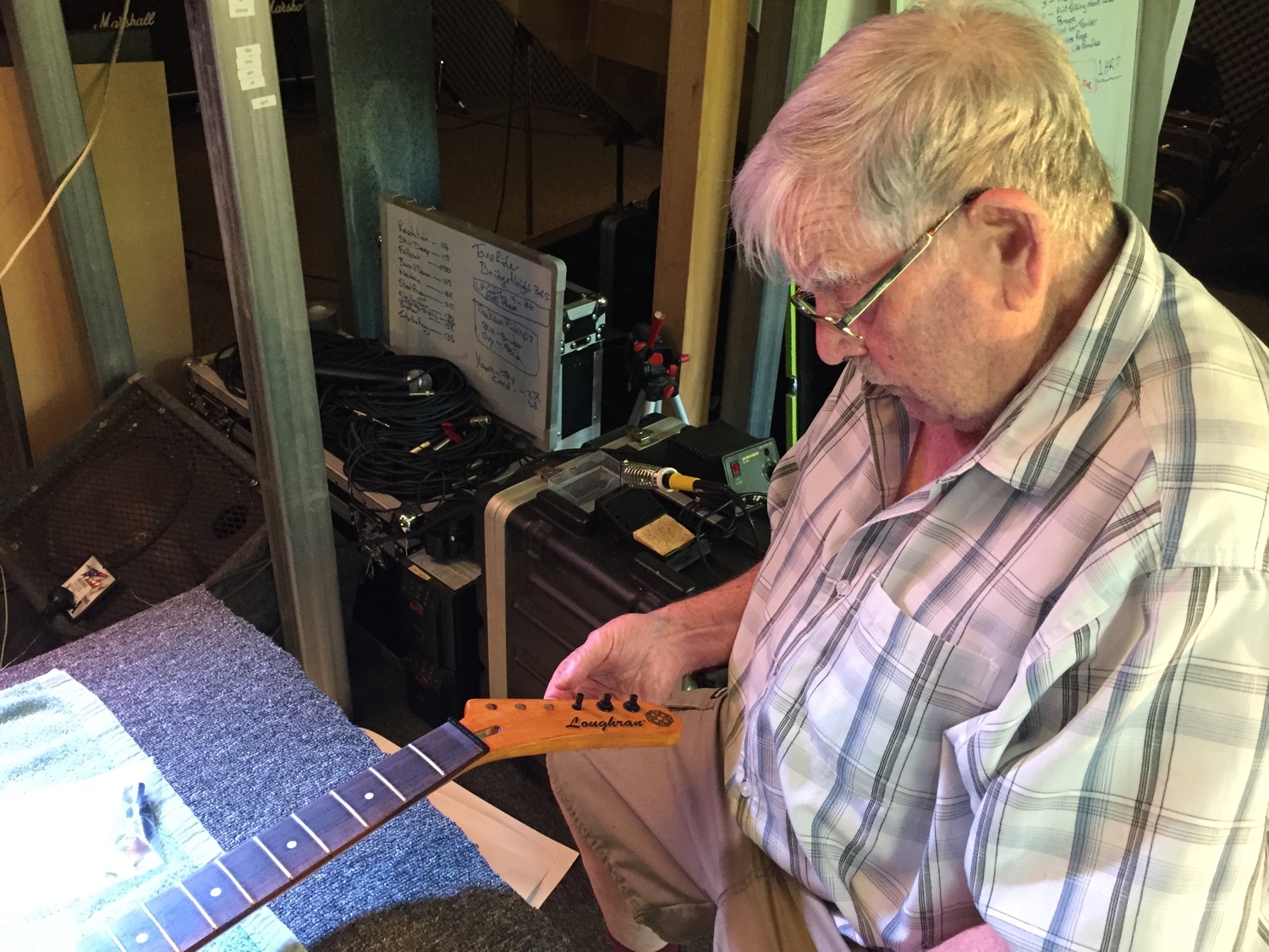

    First the Tuners /Machine Heads..

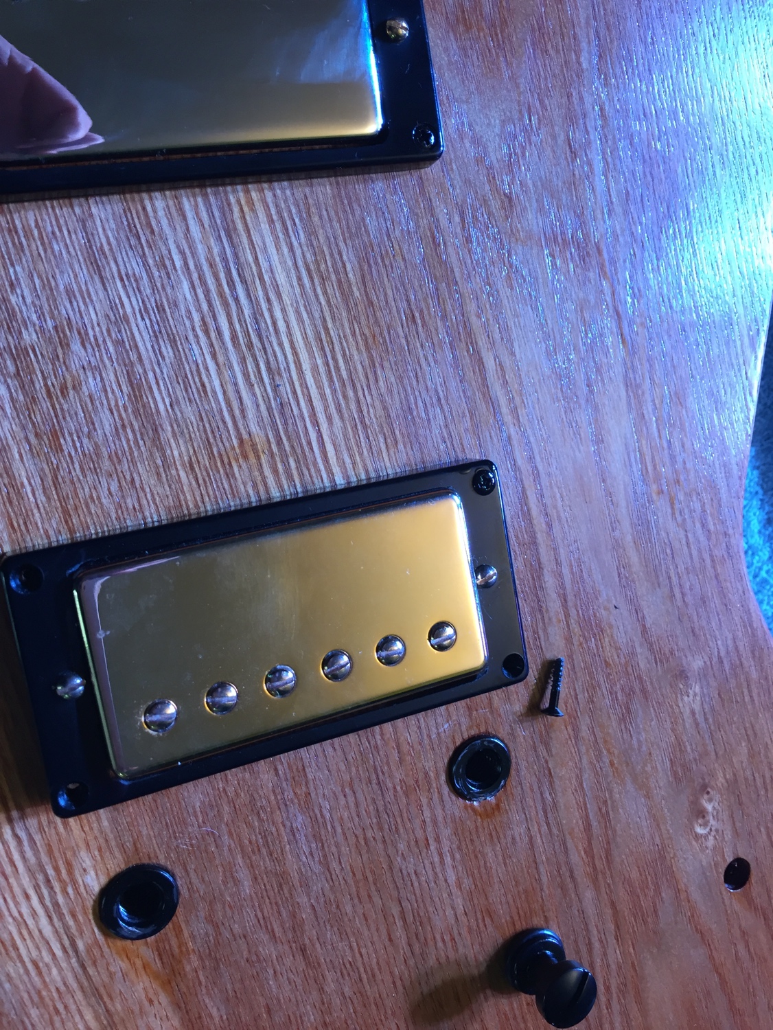

    On sanding it was apparent that the bridge pickup route had a wire channeling hole very close to the surface of the body and directly aligned with one of the pickup mounting ring screw holes. So if you used a full length screw here, you could puncture your pickup wiring. So we trimmed that particular screw down a few mm and ensured it had a blunt tip.
    That was the problem avoidance part...
    Now to the problem.
    The neck pickup wire channeling hole is also close to the surface and given the pickup route itself is narrow (rather than widen a little on the channeling side below the surface of the body) it means that the wire coming from the base of your pickup needs to make a sharp upward turn, squeeze between the pickup cover and the guitar body (an impossible space) and go into the small channeling hole. We managed to fit the pickup and it aligned perfectly with our pre-drilled holes and the pickup ring 'just fitted' in place between the neck base and pickup.... but on doing our wiring test we found that we had completely severed the pickup wire between the pickup cover and sharp edges of the channeling hole (photos to follow tomorrow).
    So to remedy this we
    1- Enlarged the channeling hole entrance making the hole entrance start lower into the guitar body.
    2 -cut the front of the pickup ring, which enabled the pickup to sit just a little more forward.
    3- And, fit a new pickup.. (Thankfully I had a spare Iron Gear Blues Engine neck pickup on hand).
    This combination enabled us to fit the neck pickup without damaging our (slightly thicker) pickup wiring.

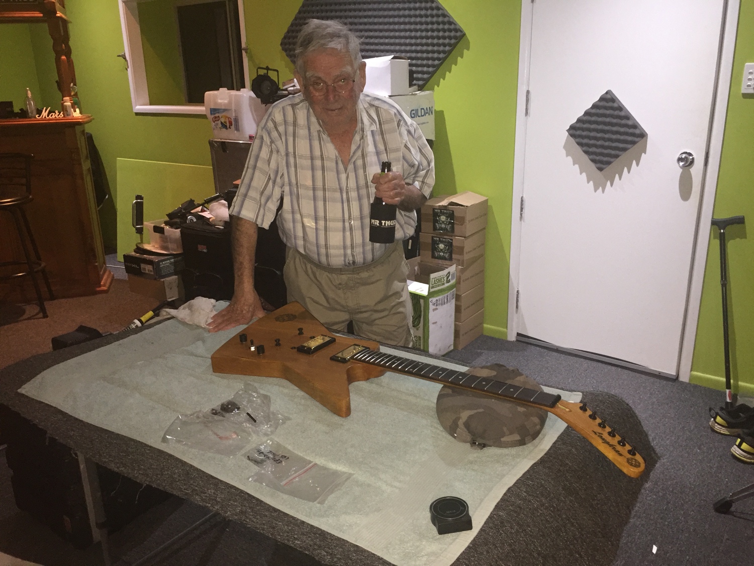

    That was a long day and a well deserved beer, may mean a later start tomorrow!

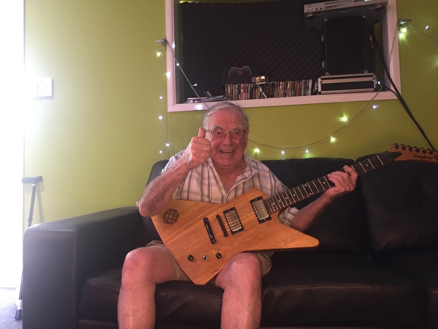

    How does it sound?
    Absolutely brilliant!!
    There is not a single buzz or choked fret area on the neck, and the pickups are a great match for the guitar woods. Neck pickup sounds warm and full, bridge sounds ideal for confident solos and the mid position has the out of phase tones I expected, especially if you slightly roll off one of the volume pots (I wired it for 2 vols).
    So we completed the build and are just 1 day over schedule.
    I will honestly record with this guitar, it really does sound quite different that any other I have and I love it.
    The objective of this project was to give my Father and I something to do together on his short holiday with me, and irrespective of the quality of instrument we produced it would still have been of sentimental value to me, but I didn’t dream it would turn out to be such a nice sounding guitar and that really is a bonus.

    Well that’s my Diary finished, I hope that something here inspires, or helps someone and if not then I hope at least it had a little entertainment value!
    Happy Building!!
    See you next time!
    G (& Dad!)
