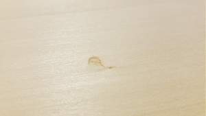

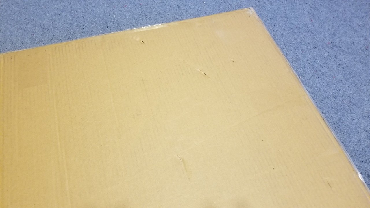

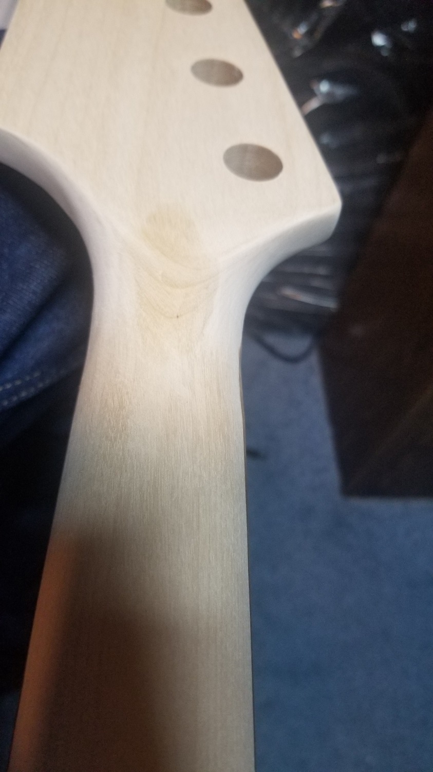

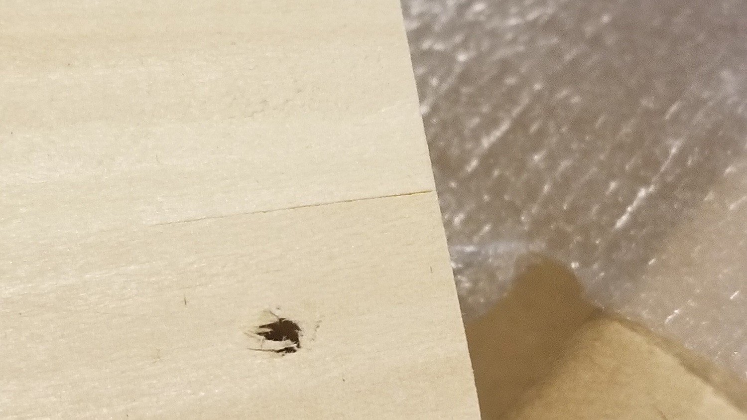

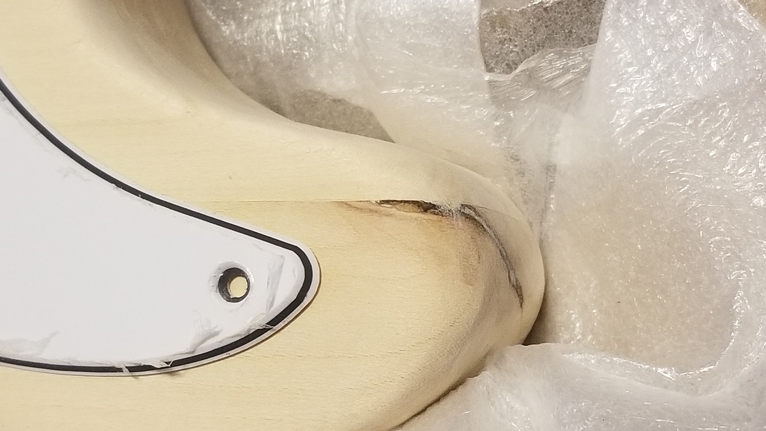

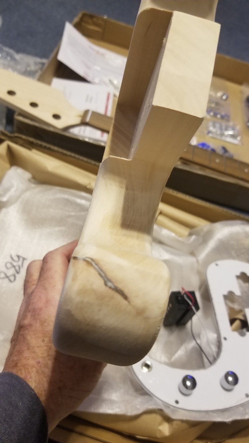

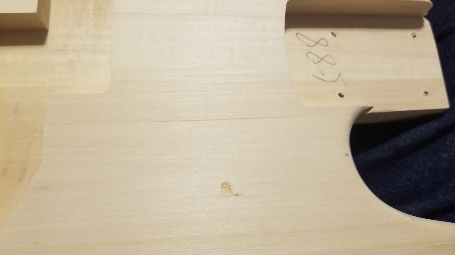

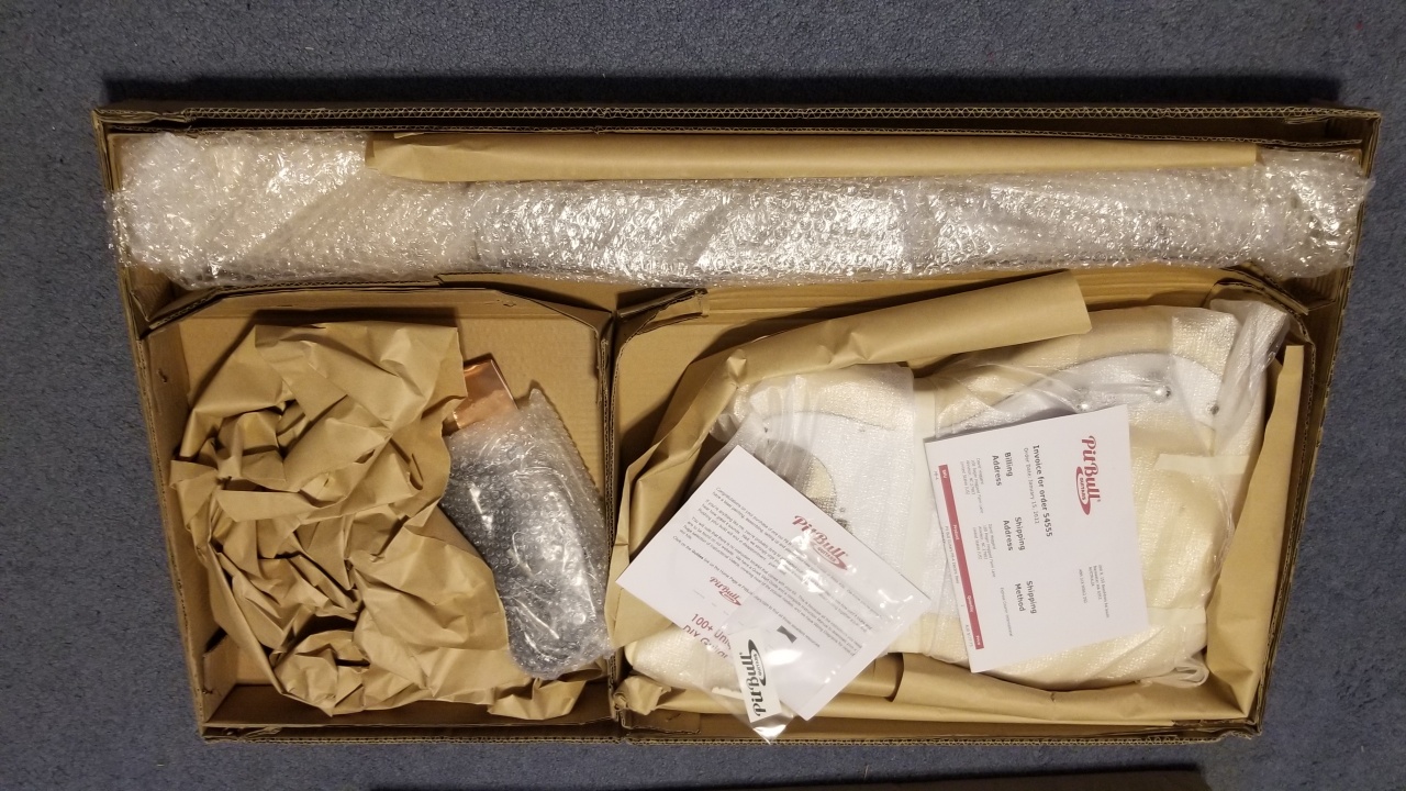

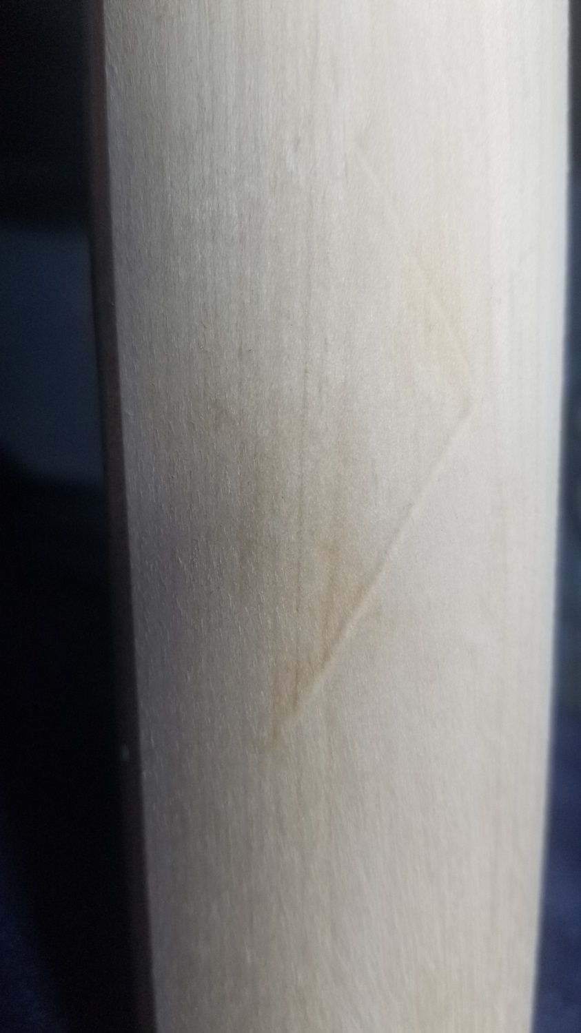

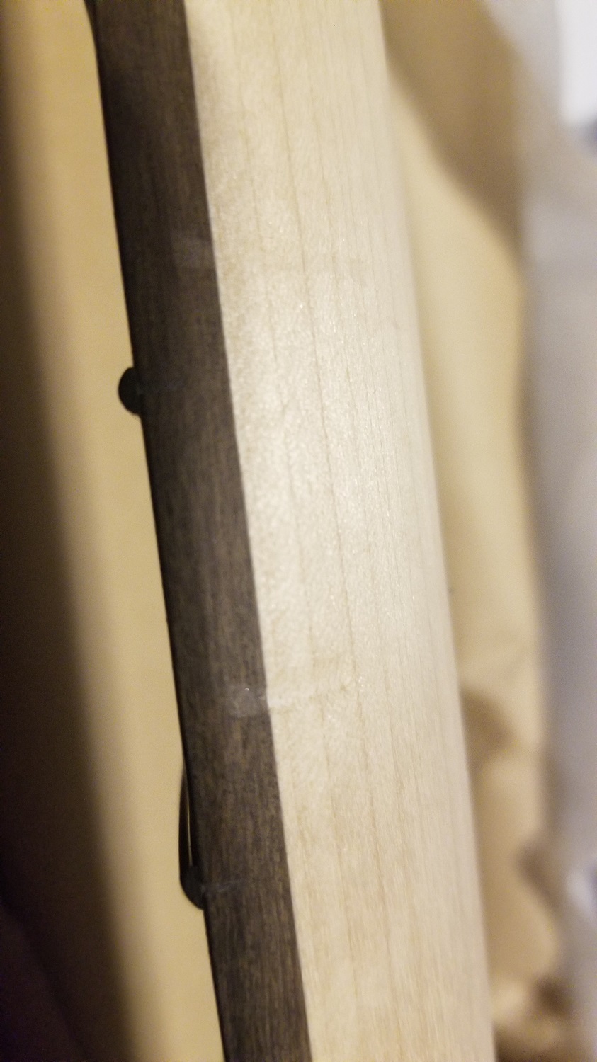

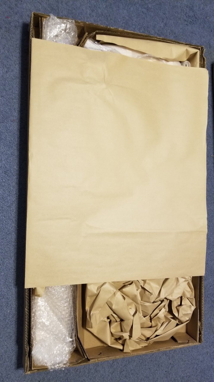

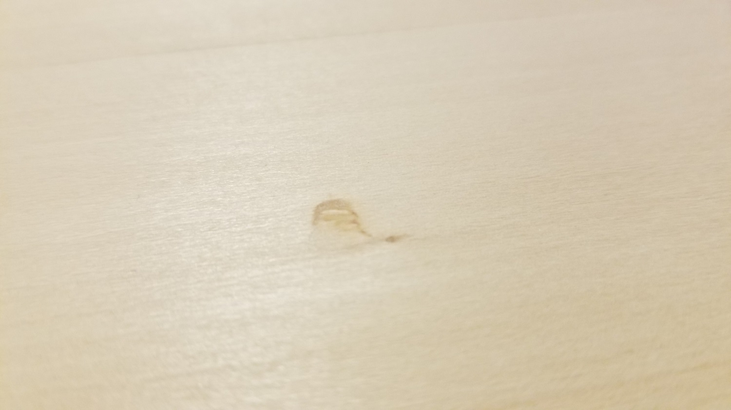

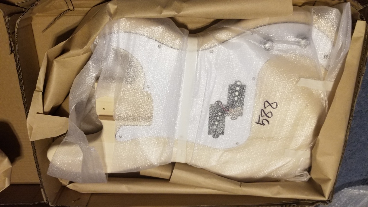

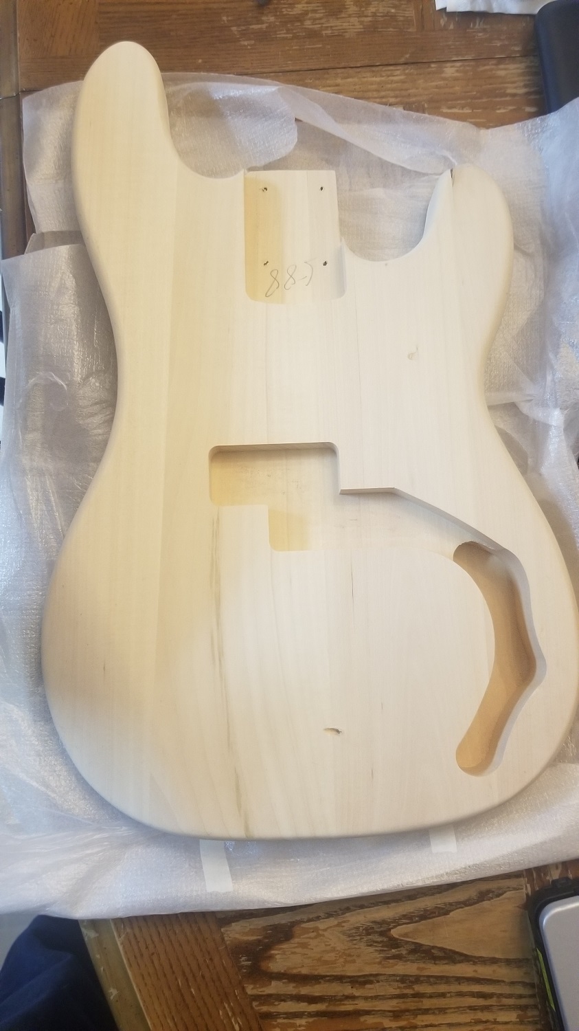

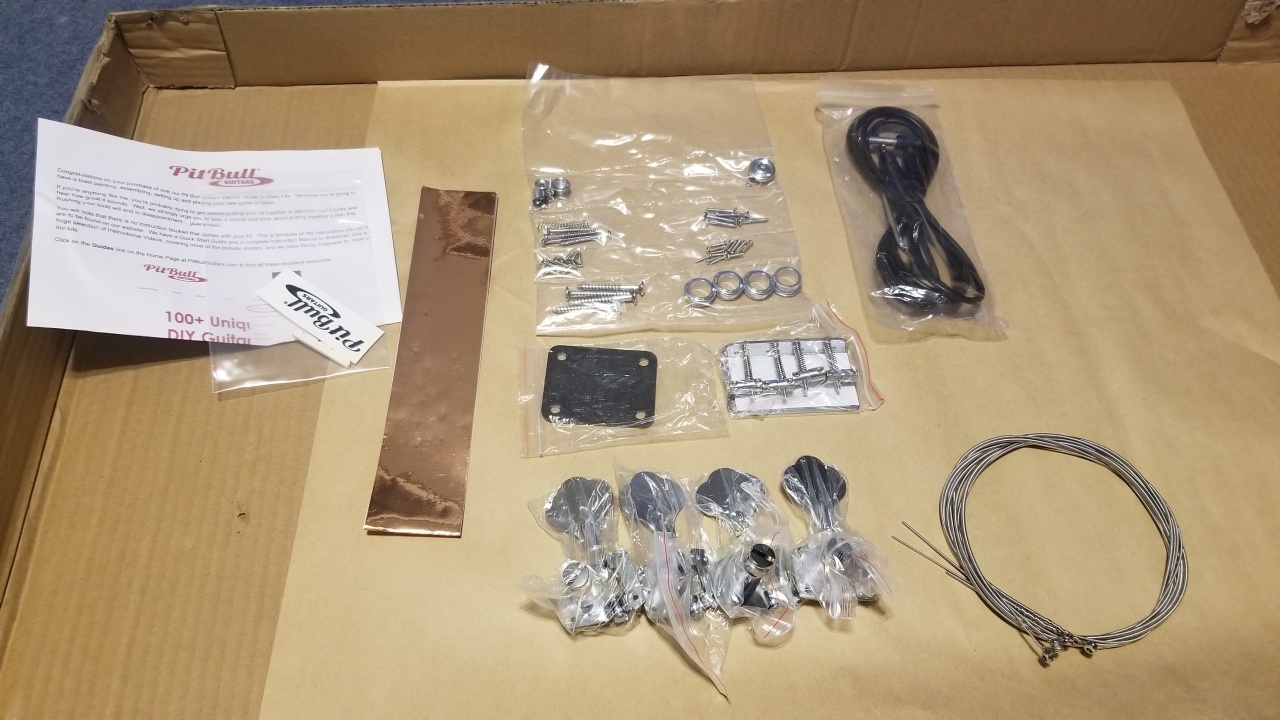

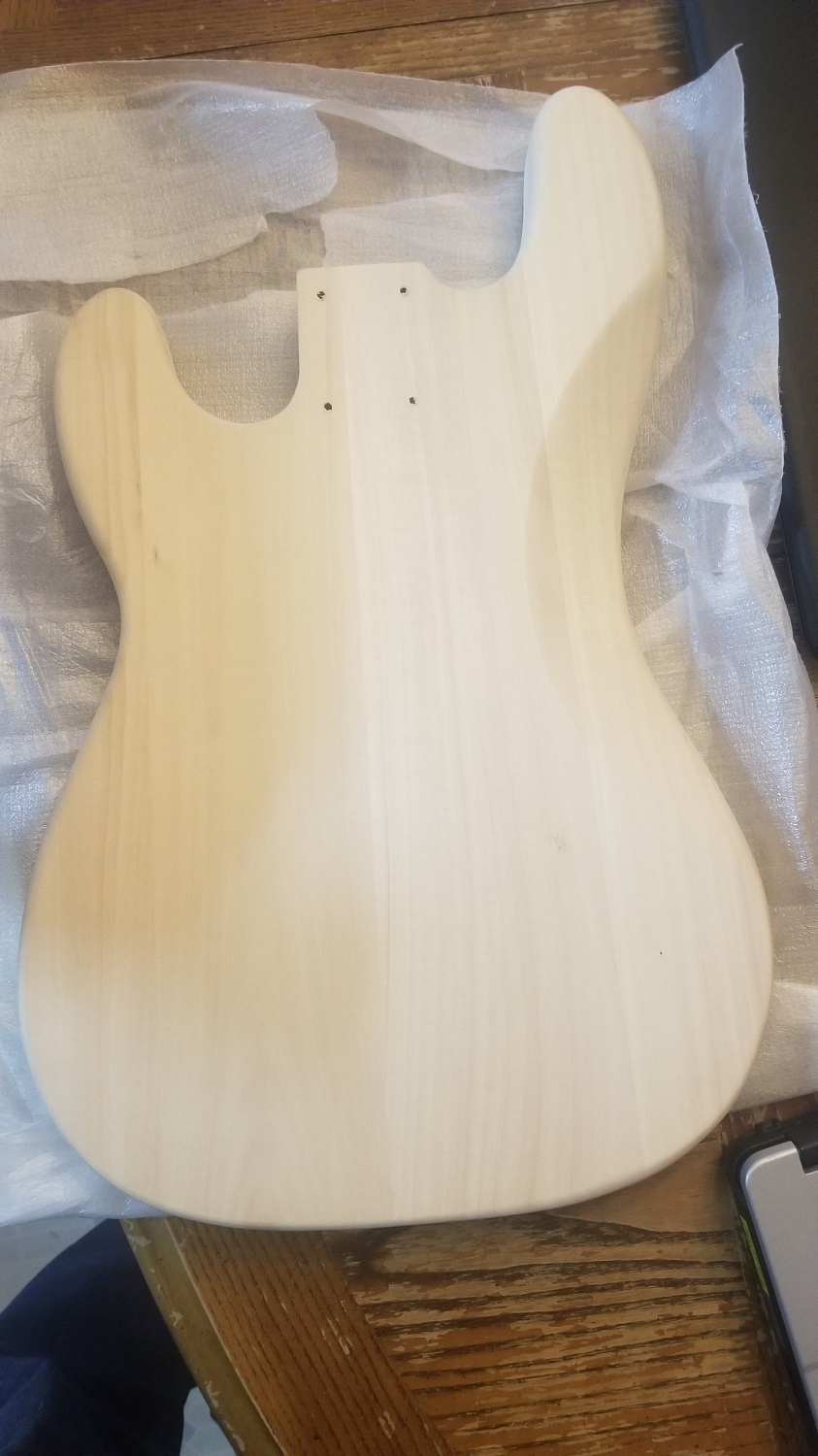

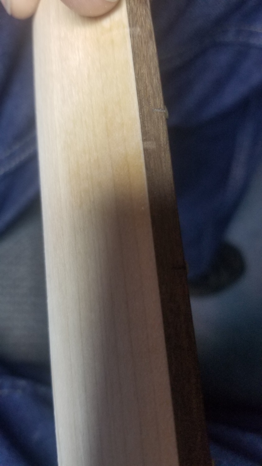

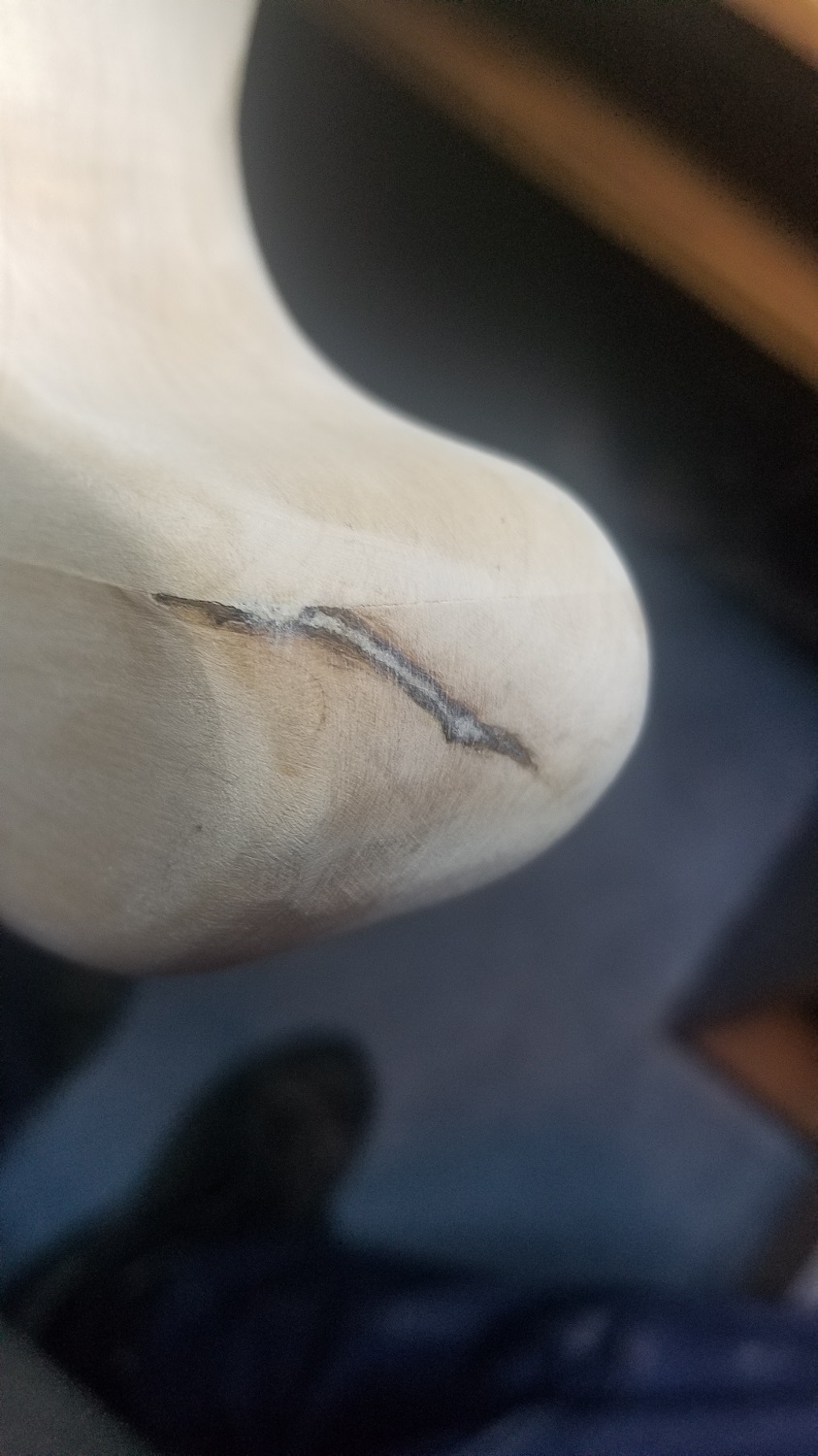

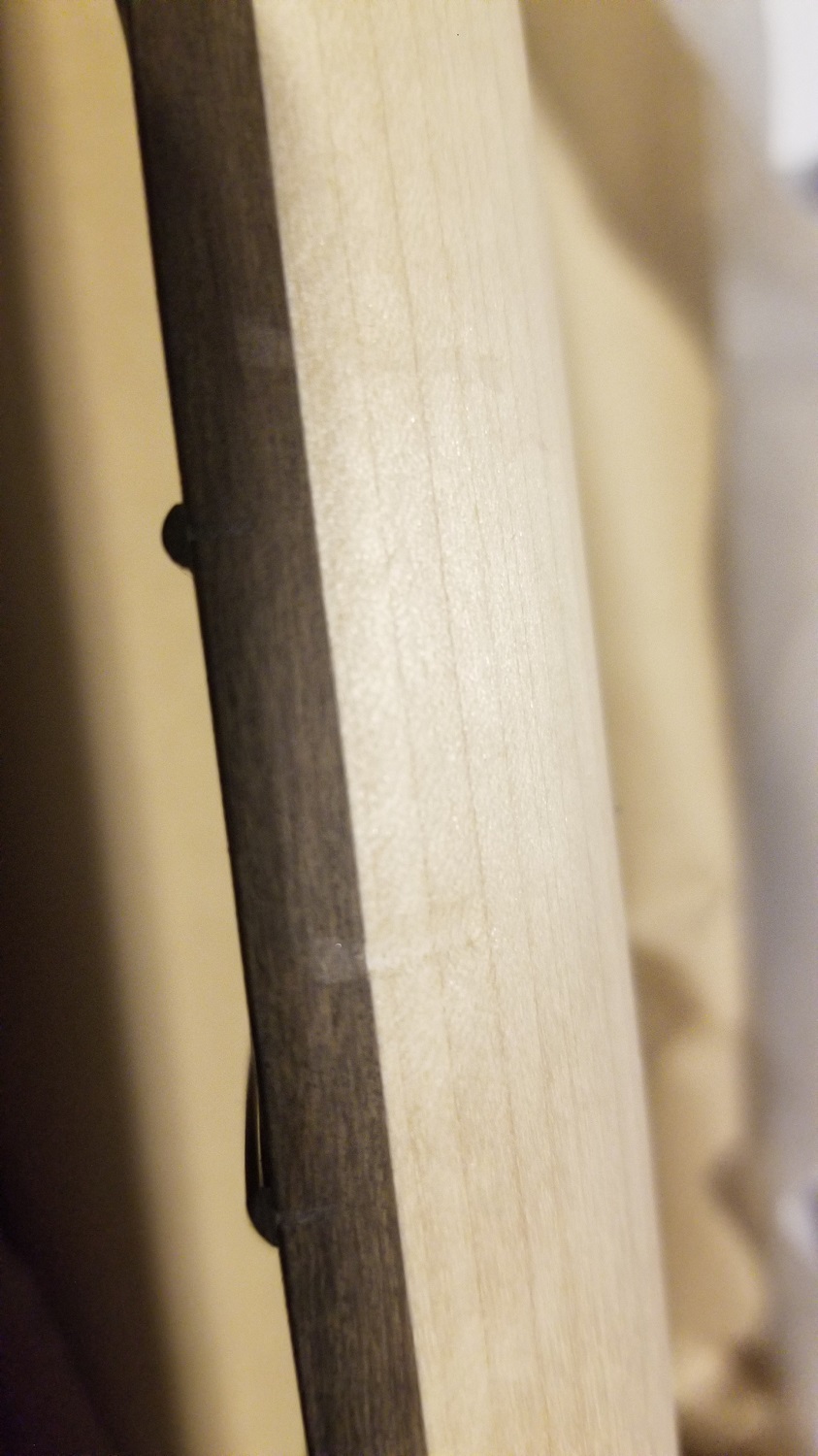

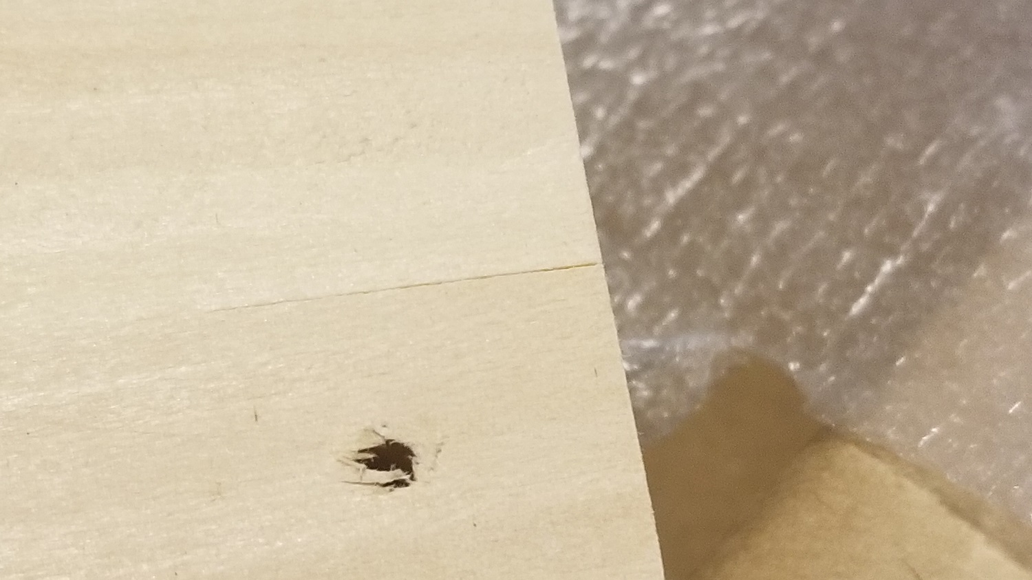

    So, I have unboxed the PB bass and have taken a few pictures to document what things I have noticed. First I would like to say that the box had three small dents that did not penetrate the cardboard. Considering it has been from Australia to Singapore to Hong Kong to Ohio, to NC and then to my address, I think this is a modern day miracle. I also have noticed this body is composed of 4 glued-up pieces of basswood. I was expecting 2 pieces, but not 4. I guess that is the sign of the times as old growth forest are no more. Being this is my first kit, I really don't know what is considered a "good" kit versus a "bad" kit and how to judge this particular one against the normal quality of the wood that ships in these kits. I will describe what I notice and let you more experienced builders render your opinions. The body has a small knot that is in the bottom elbow of the body but is mostly clear other than that. There is a spot in the neck cavity where there appears to be a one inch split. Upon closer inspection, it is where the two center sections were glued together and the joint is not quite tight in that area (jointer runoff?). This means there is a joint under the neck so two screws in one piece and two in the other piece. Could this cause a problem of neck stability later on? There also appears to have a similar thing going on in the area around the pick guard behind the pickups. There are another couple of blemishes that are small and can be sanded out. There is one small dent on the bottom of the neck very close to the glue joint of the fretboard. It appears it was dropped or something dropped on it. The dent is small but deep enough it can't be sanded out (IMHO). I am thinking it might can be taken out with a hot iron/steam technique. Any thoughts on how that would work on maple very near the fretboard glue joint? The nut is not set straight but is no big deal as I ordered the bone nut upgrade. I had been waiting to get the raw wood before spending too much time thinking of how I would finish this. I think the wood has determined it needs to be painted and not stained. I will give it some sanding before I make that decision final to see if the blemishes disappear or not. I will attempt to post the pictures for all to see and give their advice/opinions.

Name:	PB BASS box.jpg
ID:	42434Click image for larger version.
Name:	PB BASS Dents in shipping.jpg
ID:	42435Click image for larger version.
Name:	PB BASS body as shipped.jpg
ID:	42436Click image for larger version.
Name:	PB BASS hardware layout.jpg
ID:	42437Click image for larger version.
Name:	PB BASS open box.jpg

Name:	PB BASS wood blemish 1 closeup.jpg
ID:	42441Click image for larger version.
Name:	PB BASS wood blemish 1.jpg

    29
Name:	PB BASS wood knot.jpg
ID:	42443Click image for larger version.
Name:	PB BASS wood knot closeup.jpg
ID:	42444Click image for larger version.

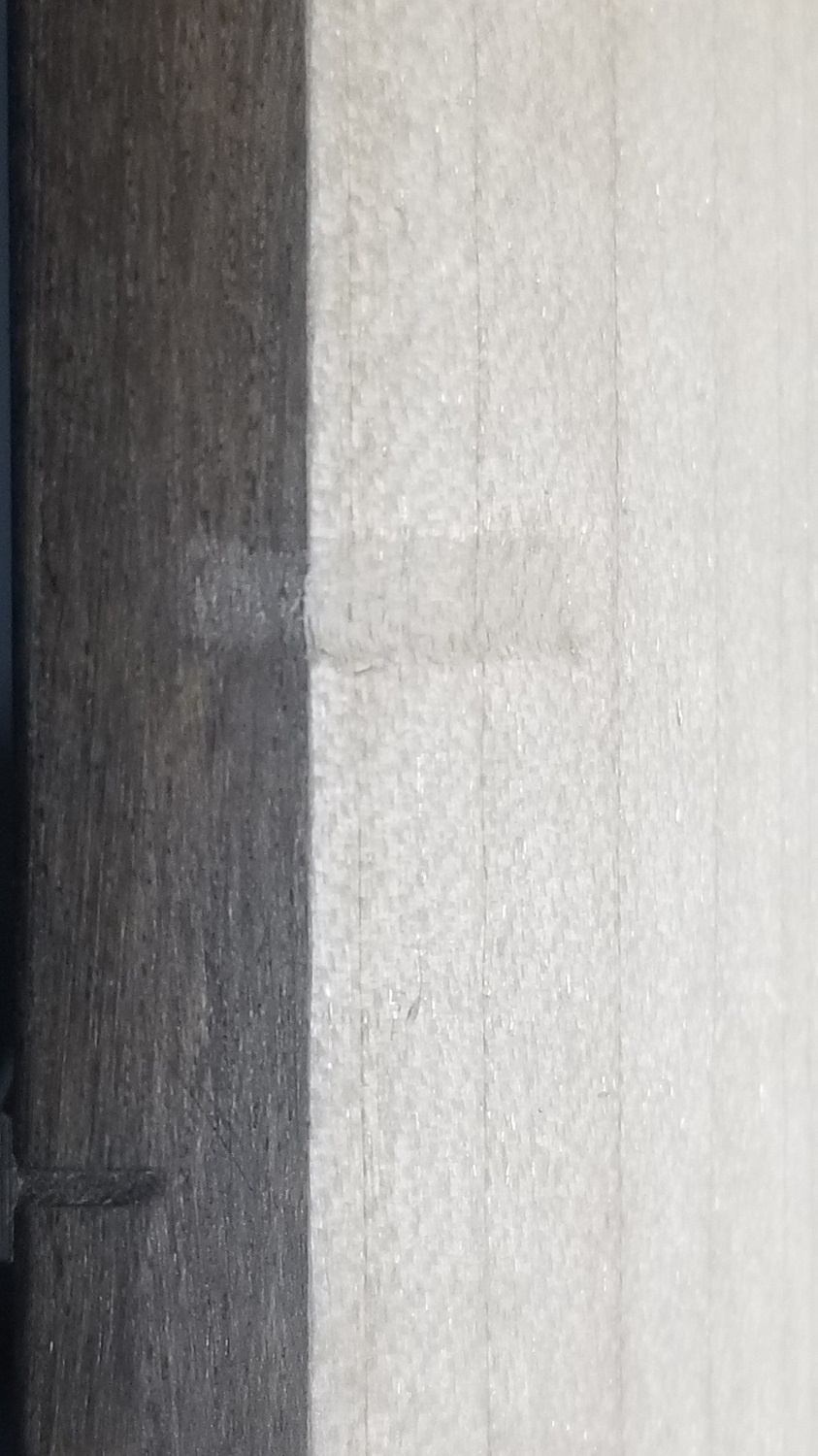

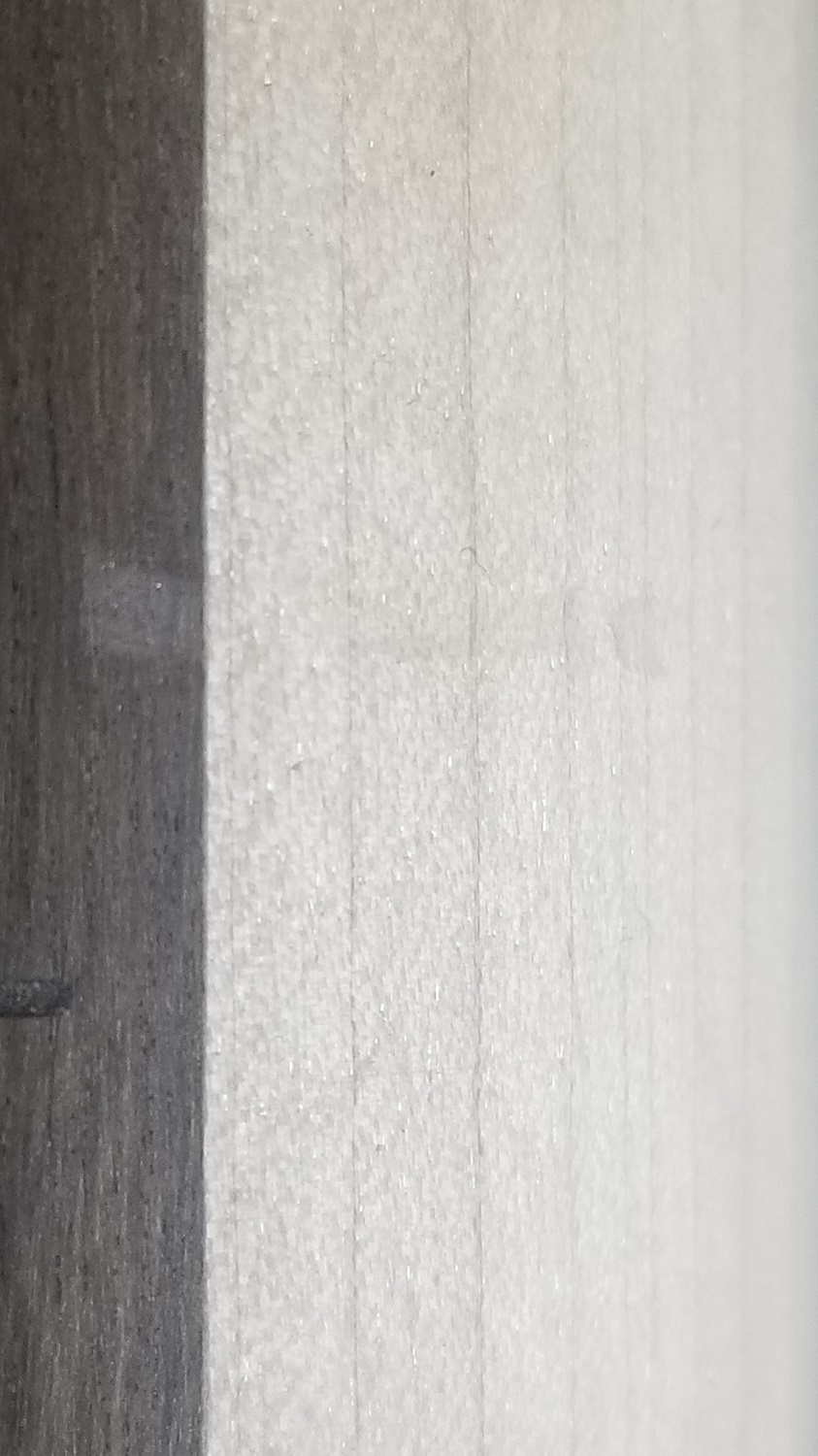

Name:	PB BASS neck dent.jpg
  11. #9
    Wow!
    If it was just that ding on the front, I'd just say steam it out, but that lower horn... that's disgraceful.
    It could likely be filled, smoothed and painted over so it was not noticeable, but that's pretty poor quality IMO. Whilst basswood isn't known for its great figuring, the decision to stain or paint should be up to you, not determined by how crappy the wood is.
    For positive input:
    I think the ding in the neck could also be steamed out, but if not totally, and if you're not planning the stain the neck (just apply clear coat) it could be drop-filled with CA during the finish process. I think you could very nearly make it invisible.
    The gap in the pieces in the neck pocket are pretty minor from what I've seen. If it's a concern for you, I would wick some water thin CA into the crack until it's filled then sand away any residual.
    Whilst it is disappointing that it is a 4-piece body, I would not be concerned about having a seam in the neck pocket. Even a high quality 2-piece body is going to have a join there as it would be the exact centreline of the body. No away around that. Two screws on either side of the join is normal.
    Overall (apart from that horrible knot) the little dings and such are fairly normal for this price range of kit, and as I've comment above, workable.
    However, I would certainly contact PBG via email and include all those photos. They are well-known for making things right when things are wrong, but it's frustrating that the onus repeatedly falls on the customer, rather than better pre-ship QA (QC in your part of the world).
  12. #10
    1,746
    Hi PB4ME,
    My 2cents:
    +1 for steam the neck ding. Later, CA glue if required.
    For the body ding - Since it will be hidden by the pick guard I would simply fill with putty, sand and hide!
    The knot - well I like knots, I think they give some character (I normally search for knotty wood for my furniture and wood turning!). I would still use a stain if that is what you wanted. Then, I would fill it with CA glue. If you are painting it should not be a concern once filled.
    FWIIW - I would work with it as some kits lately have been a bit below par (and I feel there is possibly a high chance of a replacement being worse!)
