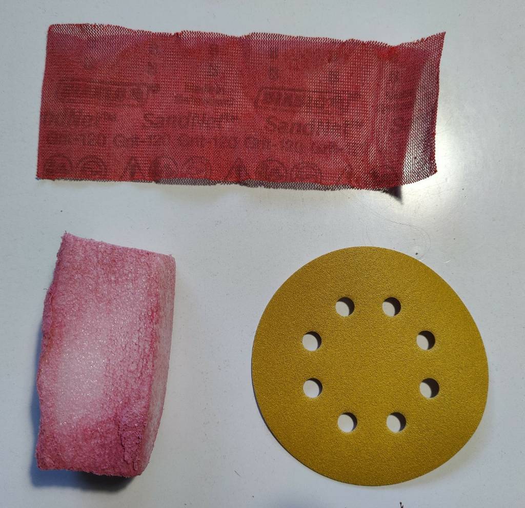

    I wish I could. I have a cheap Chinese random orbital (Chicago Electric/Harbor Freight) and a Ryobi 4" palm sander. Neither worked well. I have gotten this far after about 5 hours of elbow grease using a diablo sanding mesh, and conventional 150 grit sand paper (US grits)Click image for larger version.

    180 grit may be the way to go. I was using 240 grit on the blade for the axe bass and it was surprising how much timber it was removing in fairly short order, and that was on hard maple. Be prepared to have lots of disks on hand, if the paint is soft it is also probably gummy and will clog the paper in fairly short order.
