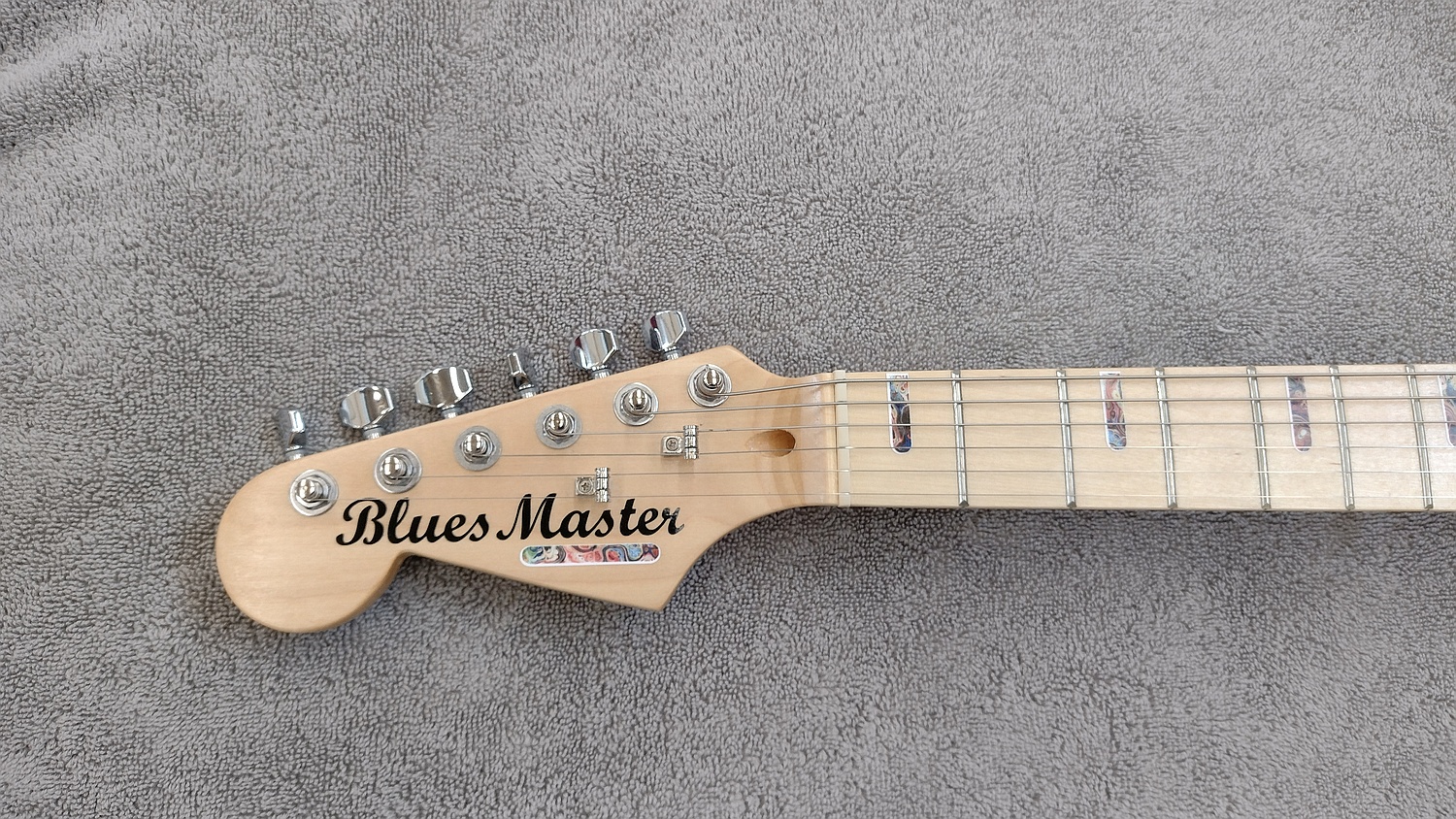

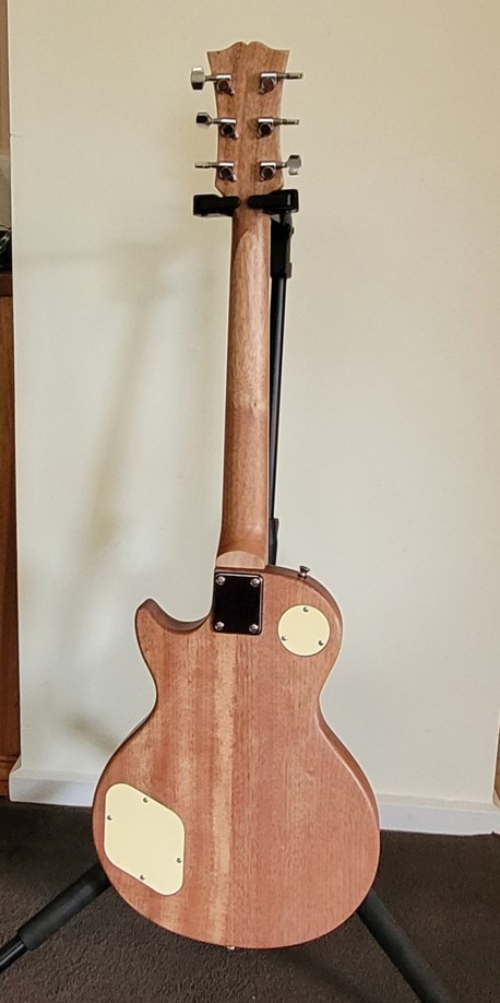

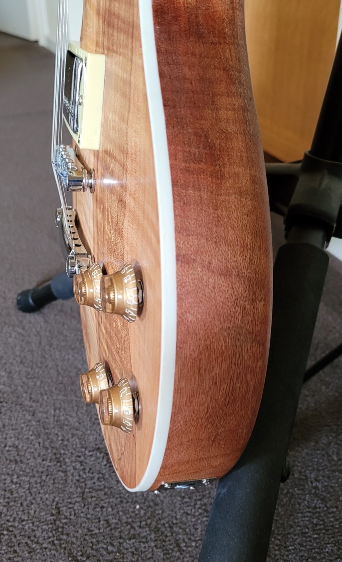

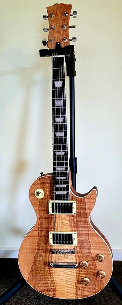

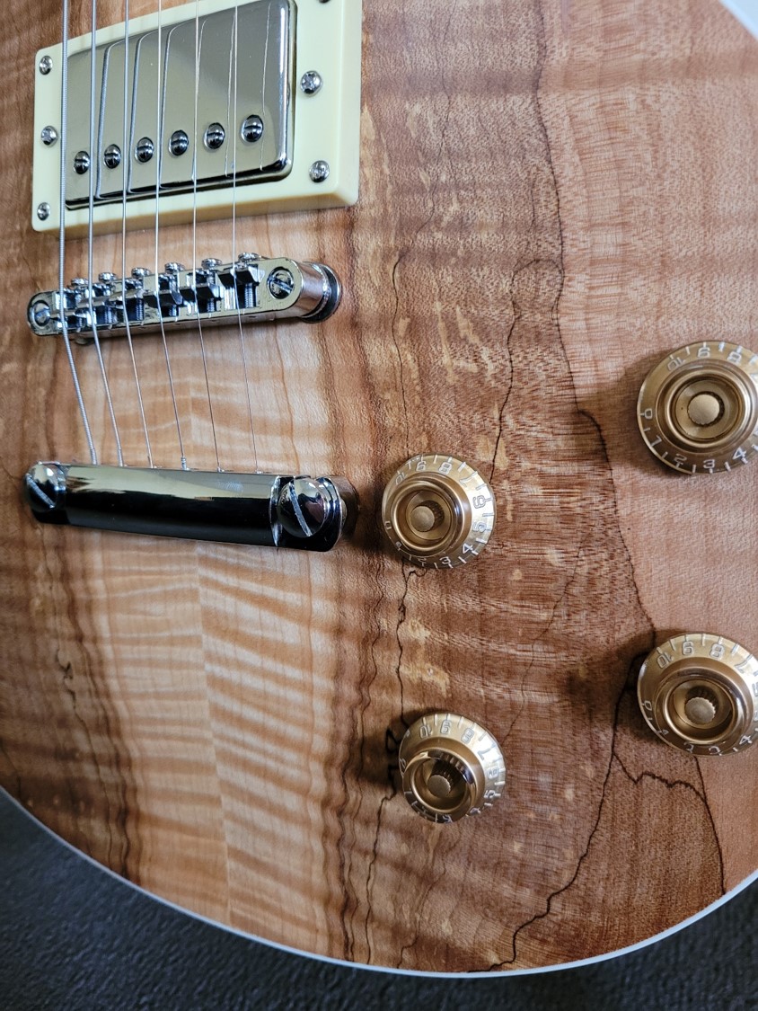

    Hi. This is my first build, a DSC-1S Spalted Maple with bolt on neck.
    The finish is multiple coats of Aussie Oil fished with multiple coats of Renaissance wax. Finish lets the natural beauty of the timber shine through, and there is just enough sheen on the veneer to make it sparkle. Neck has been rubbed back with 0000 steel wool for a super slick feel (it plays like lightning).
    All stock kit components except for a custom truss rod cover I made from Gidgee.

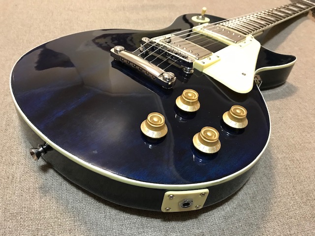

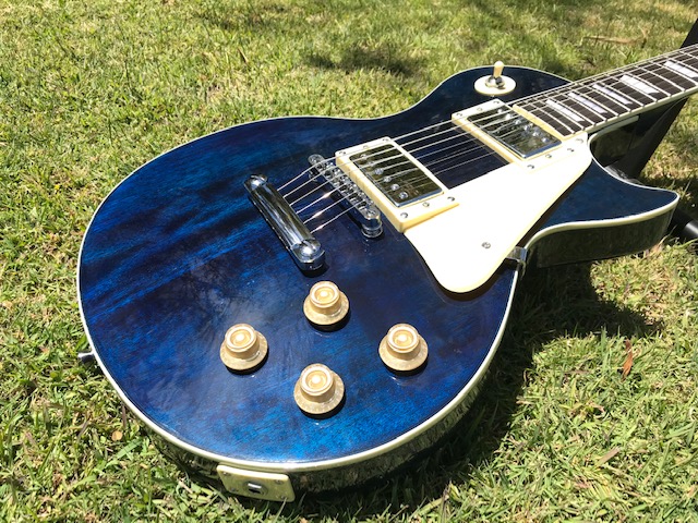

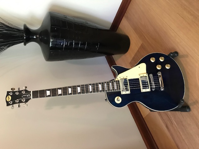

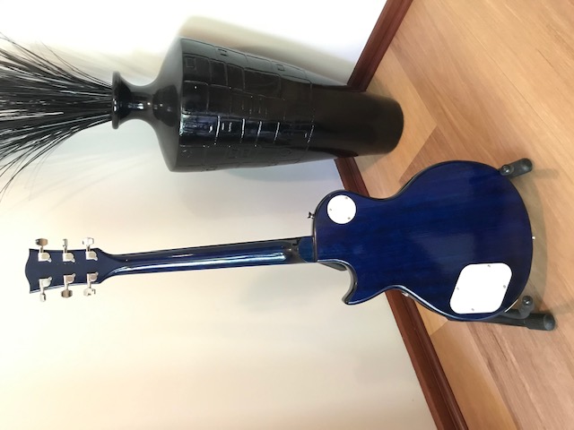

    My DSCM-1 - called Midnight Blues. Body and neck have Blue Ubeaut water based dye. Finished with FW wipe on poly. Headstock is 1-ply pick guard material. All stock parts except for bone nut upgrade, custom truss rod cover and custom jack plate.

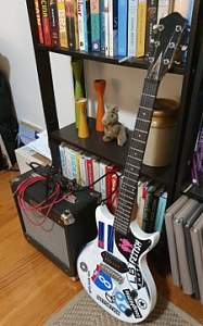

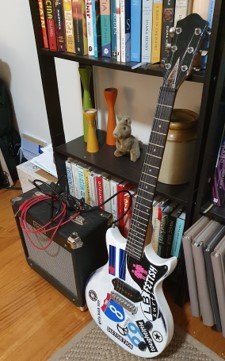

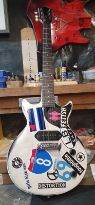

    This guitar started quite a while ago, but with lock downs and regional exclusions I haven't been able to finish it until now.
    A friend of mine is a huge Joan Jett fan. While I am not necessarily a fan of relic or aging I think replicas are OK every now and then.
    This is Steve! her JJ replica.
    It is a standard double cut with all the original parts from the kit. One of the reasons it took so long is that the replica stickers came from Russia but the first set got lost by Australia post.
    The paint is duplicolor white with Duplicolor topcoat.

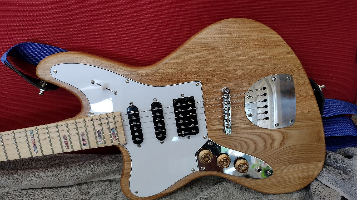

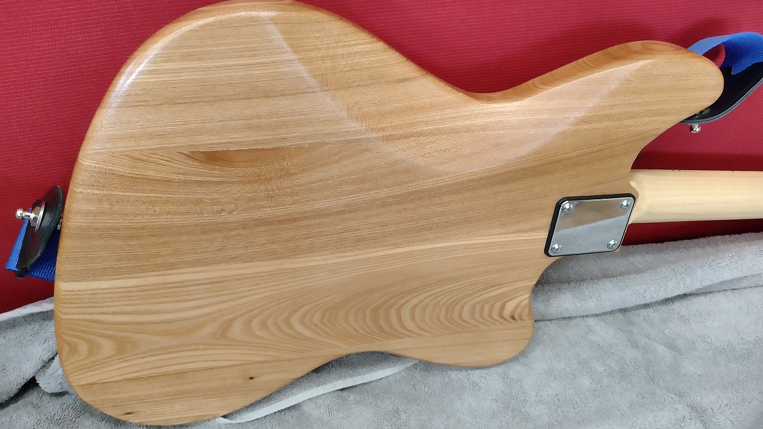

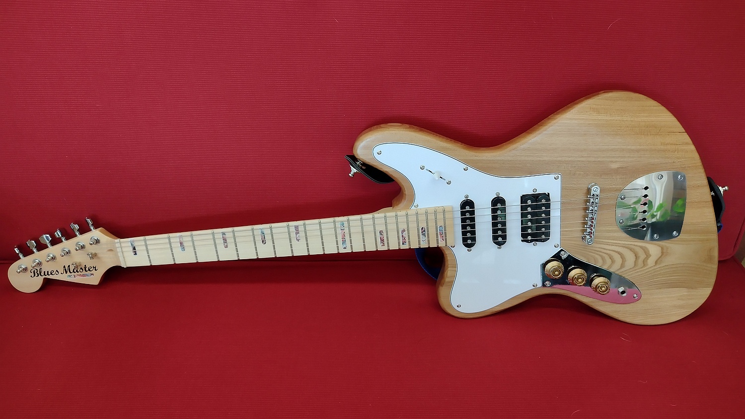

    Thought I might give it a go with this one.
    Picked up a rejected custom order last year and then did not get around to it until this year.
    Made a few changes - some by choice others by necessity.
    Changes:
    * alnico V pickups
    * CTS pots - proper lefty types - the kit pots are all right handed
    * lefty top hat knobs so the numbers go in the correct direction
    * orange drop caps - one for the humbucker and one for the single coils
    * plate replacement for a faulty trem - The plate from the US was my best option. Trying to find a lefty trem to fit was impossible. Interestingly the plate give incredible sustain and very crisp sound. As I don't use a trem much it worked out to be a great option.
    * fret stickers - These came from an online outfit in Germany - Fretlook. They have not budged since I put them on. Looks like they have gripped well. They are very thin so not noticeable when playing.
    * TUSQ nut - great step up in sound.
    Finish is multiple coats of Scandinavian Oil. I did not want to colour the ash but needed a way to “tame” the grain near the control plate.
    Headstock was already cut so that was one less thing to work on.
    All up it plays better then my purchased guitars. Great sound and nice playing action. And the grain in the ash pops nicely.
    I am very happy considering this was someone else's rejected custom order.

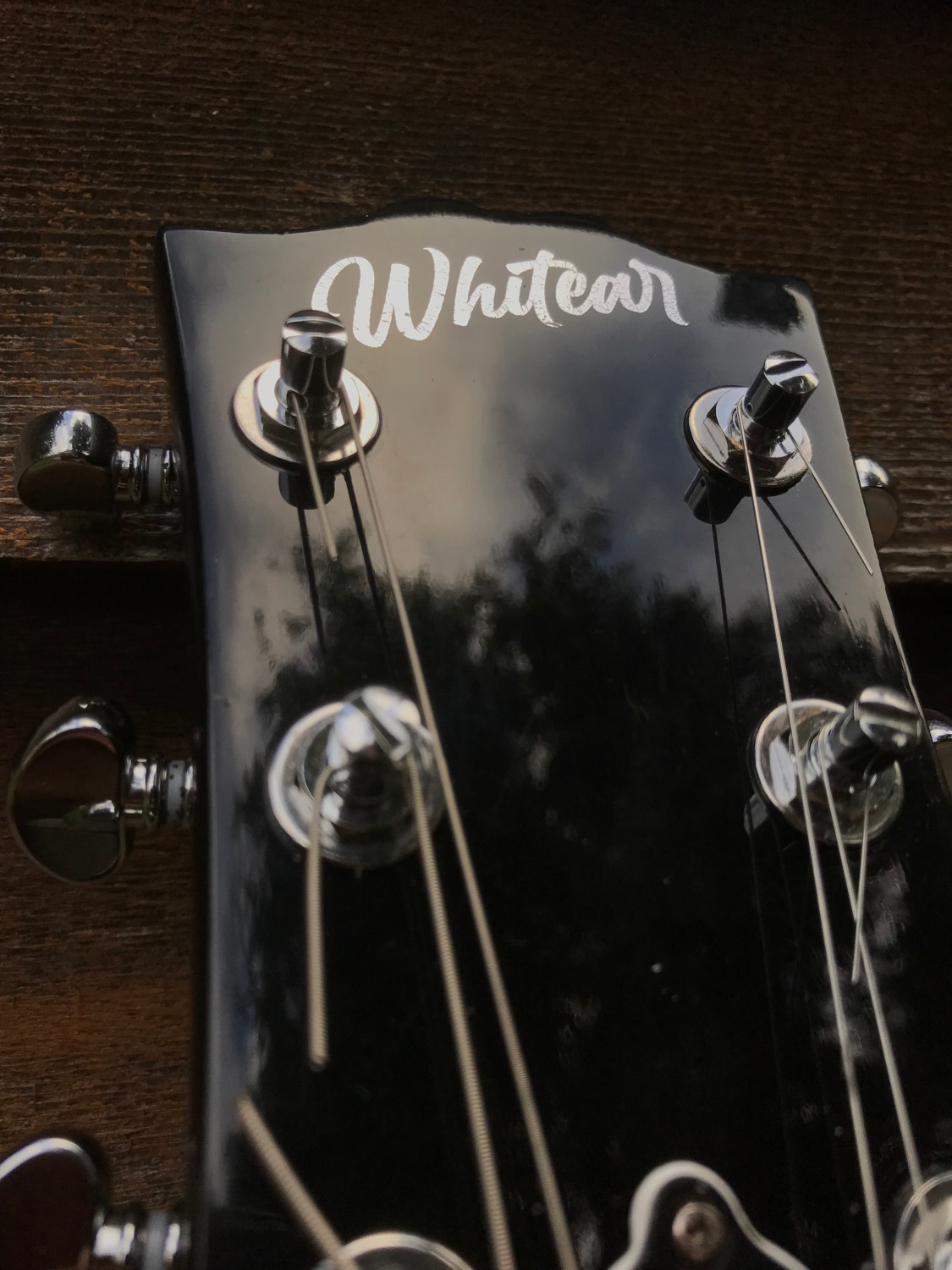

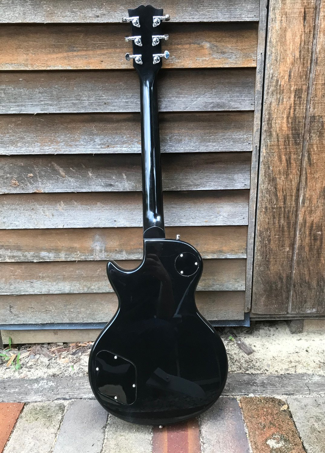

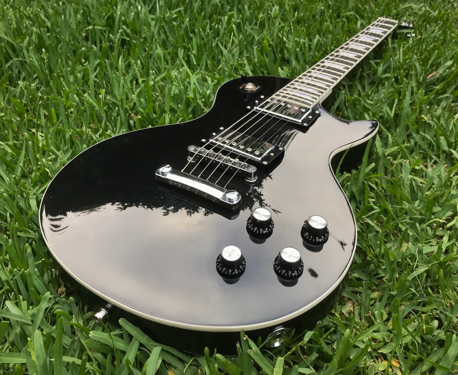

    Here's mine, just to add to the single-cut flavour of the month,
    It's an SSCM-1E, finished in gloss black acrylic lacquer.
    Upgrades:
    • Bone nut
    • Grovers
    • Tonerider AC-II Classic pickups
    • Electrosocket
    • Black pickup rings - the control covers are painted.
    • Electrics: push/pull coil split on each volume knob, and a push/pull blower on each tone
    • Realparts switch and knobs
    It plays really nicely.
