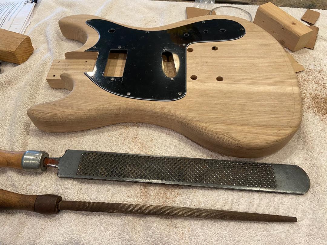

    Well, winter project #3 arrived a couple of weeks ago, and has had time to acclimate to this desert country. Everything looks good on initial inspection, but much sanding ahead. The neck pocket is too narrow, and there are some pretty rough spots on the sides of the body. Ash body, so sanding will be slow. But I moved away from basswood, as on my AG (winter project #2), since it is so soft you can almost ding it with a hard stare. I am not much for imaginative or creative, so it will be a pretty straight-forward PBG build, with some minor upgrades, maybe. Wish my ash body had the killer grain of Grooyman's strat body, but it's OK. Photo when I get the mock build. I plan on staining to show the grain. Dark red or dark blue? Any suggestions on staining strategy? Happy to be back on the forum.

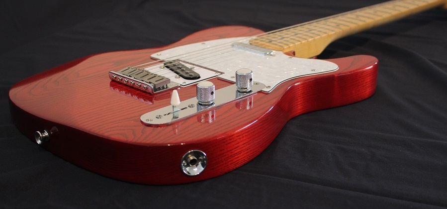

    Putting together what I said previously and what Andy said, you can use a dark coloured grain filler to contrast the grain from rest of the timber when you stain it.
    The ash Tele in my avatar is an example of ebony grain filler (Timbermate) with Colortone Cherry Red dye. It was clear coated with homebrew wipe-on polyurethane.
    edit to add pic:
    Here's a better view -
Name:	2018 Tele side view crop.jpg
    The Tele in my avatar is an example of ebony grain filler (Timbermate) with Colortone Cherry Red dye. It was clear coated with homebrew wipe-on polyurethane.

    Can't say enough about the support you guys provide. McCreed, you are always coming with good suggestions. And Simon, you are the master. Andy, I think you've nailed it. Ebony Timbermate, sand back, then blue or red stain (still on the fence). Finish with poly. Smooth and glossy, as last year's AG is textured by a little bit of rattle-can orange peel, but fairly subdued and evenly coated. I like it. The idea of attacking the ash body to cut the weight scares me a little. But maybe it's time for some adventure. Thanks for all the useful input. Now, sanding....
    Slow and steady with a good coarse rasp, followed by working through sandpaper grits.
    Or you can go a little bit insane with a 4" angle grinder and a flap-disk! (like I have )
  12. Liked by: Andyxlh
  13. #10
    It’s a Mosrite shape, so you could get away with a belly cut as that wouldn’t be visible when playing, but a Strat-style forearm contour would be. It all depends how close you want to stick to the Mosrite look. But that has changed over time. Looking at pictures of them on the web, you seem to have some with simple rounded edges like the kit, but some with a more arched-top look with a ‘German carve’ round the edge and some with bevelled edges with SG levels of bevel. The latter would be the easiest to achieve and would provide some weight relief.
