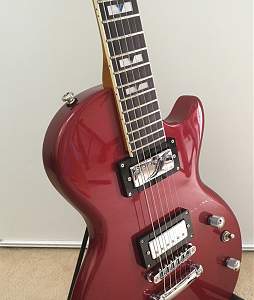

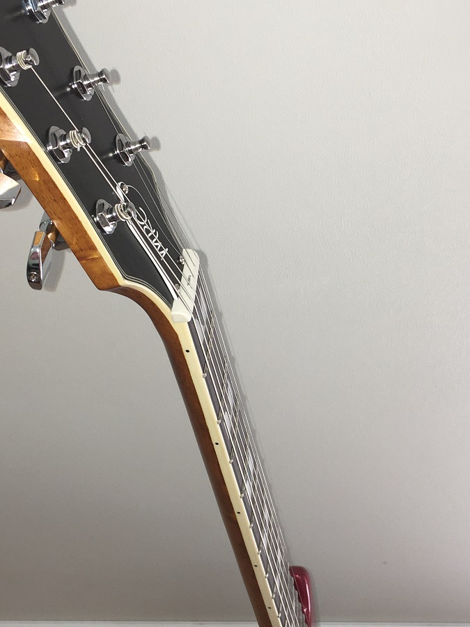

    I posted awhile ago about a neck I finishing for one of my LP-style guitars (I had an issue with the stain bleeding onto the binding when I applied the clear).
    Well, I overcame that and got the clear all sprayed 3-1/2 weeks ago. Last week did a fret level, got it installed and set up (it's a screw-fixed neck).
    I'm definitely liking the new neck compared to the previous. It was always just a tad too narrow to my liking. I am always amazed how much difference 1mm here or there can make with how a neck feels.
    The new one is only 1mm wider at the nut (43mm) and the taper is only .5mm wider at the 12th, but it's chalk and cheese in how it feels. I think the thickness is [just] marginally deeper too. (I can't find my pre-finish measurements, and it's hard to re-measure with the strings on).
    Oh, neck info: Maple neck; Purpleheart fretboard; 12" R; Single ply binding on fb, 4-ply on headstock; Stain is a blend of FW Golden Teak and Old Baltic; Clear coat is satin poly. (FYI: this was a Haze brand neck off of eBay for $50)

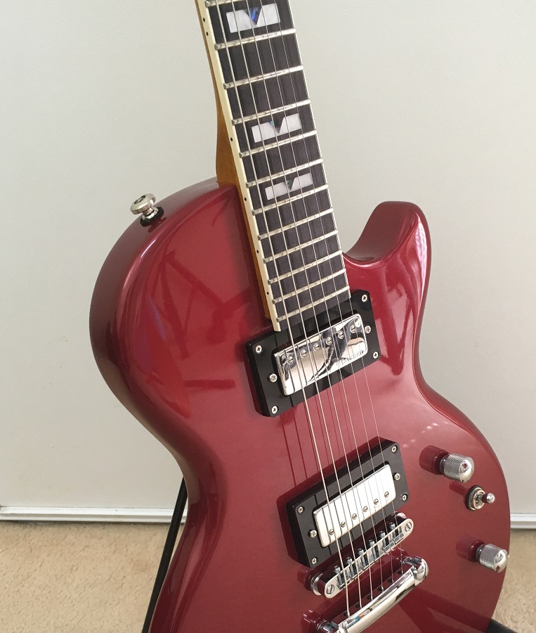

    The other change I made was putting in a pair of Warman Firebuckers (low output mini-HB's).
    They sound great. I don't know how they compare to the vintage Firebird mini's, but I don't really care .
    I've become a major fan on mini HB's. I got them in 3 guitars now!
    Anyway, though I'd share some pics of the new & improved model:

    Thanks for looking!

    Yes, I was pleasantly surprised. It didn’t come with a nut, but I would have changed it to the TUSQ one anyway.
    The frets required the typical end dressing etc but they were quite good when it came to levelling them. Didn’t take a lot of work.
    The first thing I check, especially with budget necks, is the truss rod and this one (dual action) had no issues at all.
    There were (are) some micro fissures in the headstock binding that I didn’t become aware of until the black stain was applied, and there wasn’t much I could do about it. It’s not too horrible, so I can live with it.

    Your Warman pickups are a different construction to Firebird pickups, so are really standard mini-humbuckers. Not quite sure why Warman added a Firebird reference in the name, apart from attention drawing. If they are made like the Gibson/Epiphone mini-humbuckers, then you'll have a bar magnet on the base, a row of screw slugs and a steel bar for the other pole. A normal humbucker would have individual steel slugs instead of the steel bar.
    The Firebird pickup has two bar magnets on their sides 'blade' style, which the coils are wrapped around so they are a very different construction indeed.
    In terms of sound, the traditional Firebird pickups are a closer to a single-coil sound than mini-humbuckers, though obviously the minis are a lot brighter than full-sized humbuckers.
    I recently changed the stock Gibson ceramic pickups on my Firebird, which were over-bright and piercing, for some Oil City 'Winterizer' alnico V units, which sound a lot nicer indeed. I generally find that ceramic pickups don't do subtle very well. Fine for very distorted sounds, but sound pretty flat on clean and edge of break-up sounds.

    The Warmans are actually the Firebucker II's which have the adjustable pole pieces. The regular Firebuckers are solid covers, but have no idea if the internal construction is the same or different as the II's or how similar/dissimilar to the FB ones they are.
    These are also ceramic which I'm generally not a fan of, but since Warman posts both the DCR and the Inductance (6.6k and 3.1H), I had at least some idea of what to expect in regard to "brightness". (I wish more pickup manufacturers would do this)
    They also claim that they use "high quality ceramic magnets" which is allegedly suppose to make for better tone. May just be marketing speak, I don't know.
    In the end, I'm very pleased with how they sound both clean and with overdrive.
