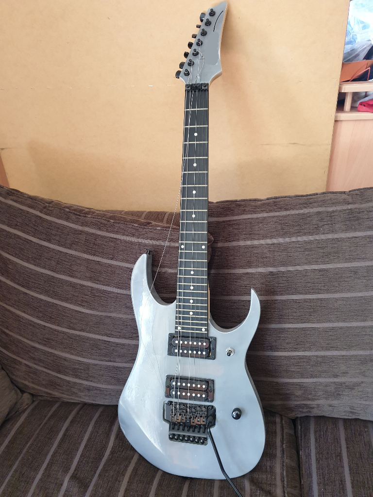

    The original colour was meant to be a chrome type finish along the same lines as Satch's Chrome Boy without the expense of chrome dipping. I knew it wouldn't be as good, but it looked good enough after the Duramax chrome spray. Only problem was that finger prints showed up way too easily and wouldn't rub off. So, I made the ill-fated decision to put on a clear coat to seal it in. That immediately destroyed the "chrome" finish and just sent it grey. Ended up just going with it because at that stage I realised I was never going to get the desired effect and I'd already thrown away enough cash on this paint.

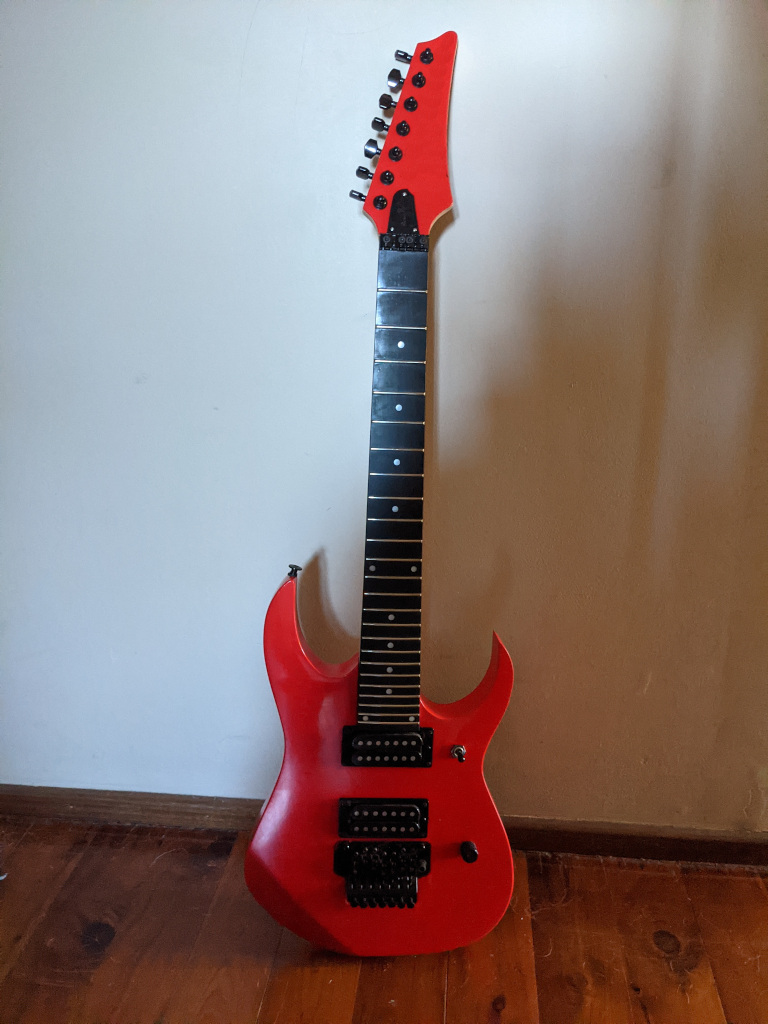

    So, we're now working towards an 80's type of colour. Still sticking with the Duramax but going for "Hot Lips" which is a bright red.

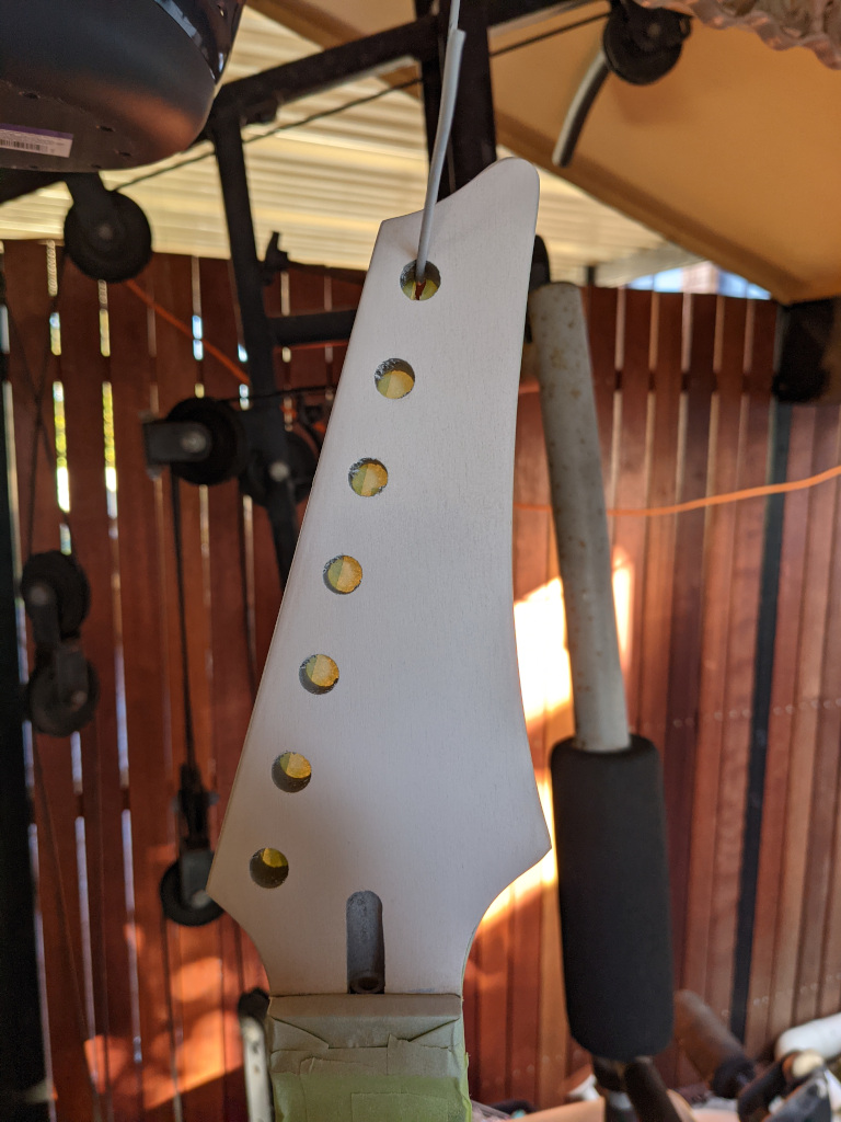

    Here's what I started with...

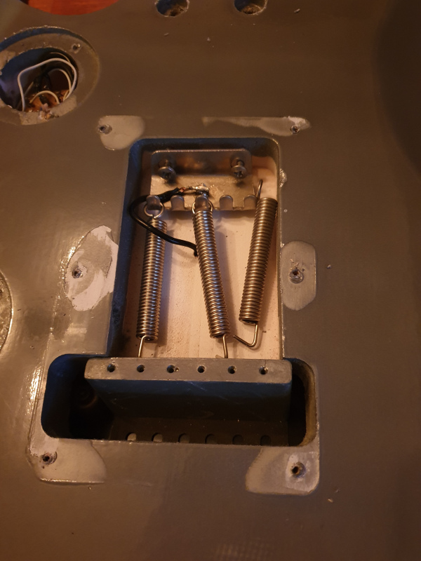

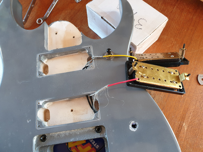

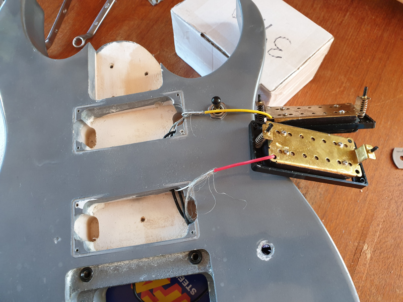

    Pulling out all the hardware, you can see where all the paint just flaked away.

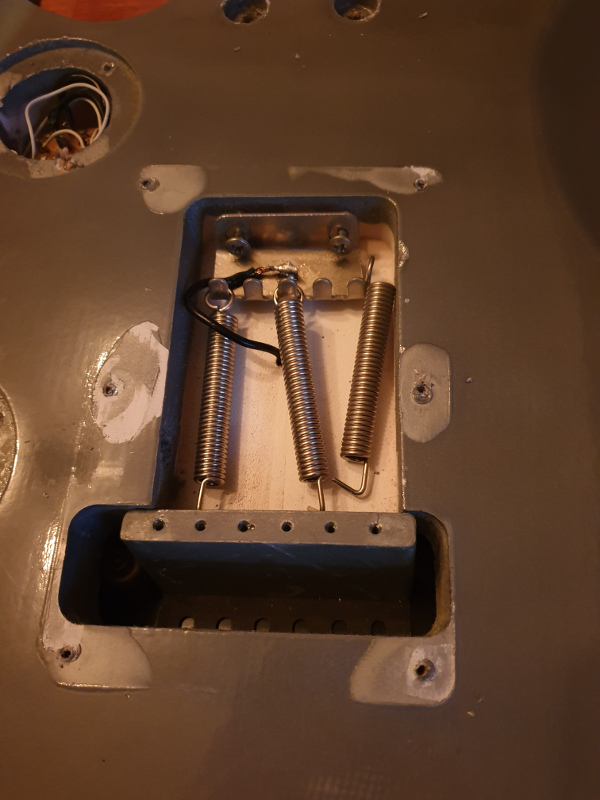

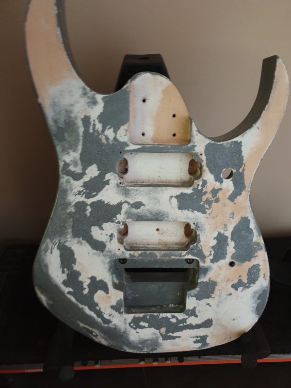

    Sanding was where it became evident the paint just hadn't cured. Hit it with the orbital and the paint was all gummy. Clogged up many sanding discs. I had to strip it back as best I could, let that paint sit exposed for a couple of days to dry and then strip it back more.

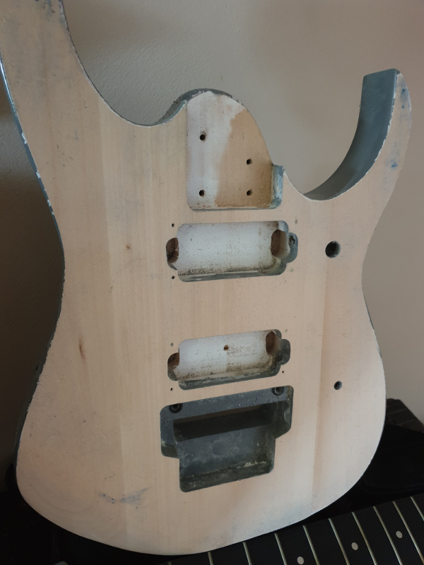

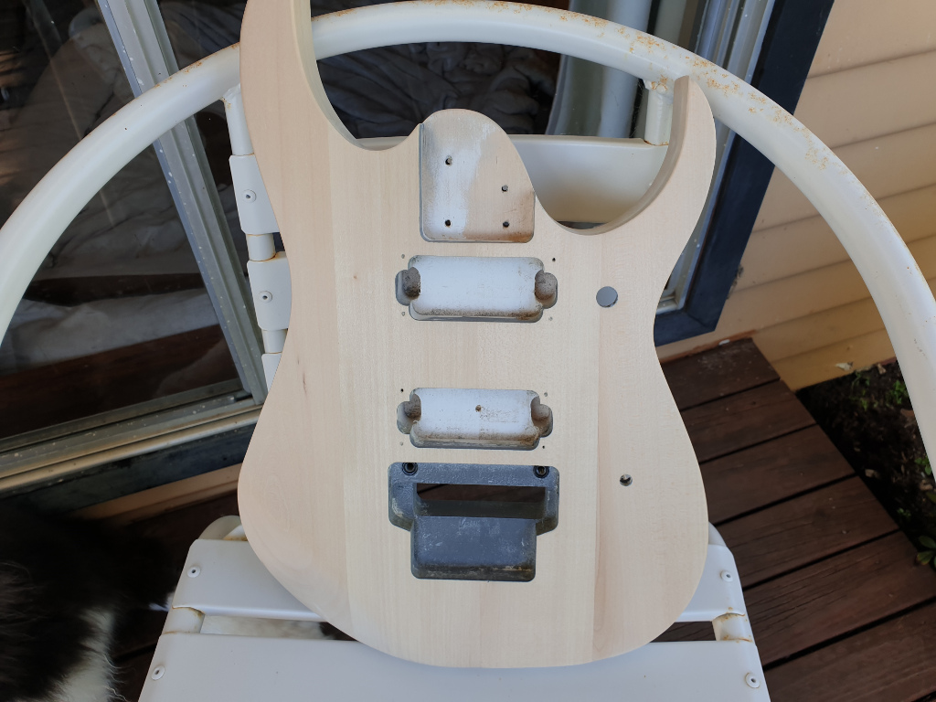

    After a week of sanding and more detailed sanding, I had it stripped back as much as I could. Couldn't get into the cavities and the only way I could see I was going to have any impact was with a chemical stripper which I really didn't want to use. So, I've left it as is and roughed up the surface a bit in the hope the new layers stick. Don't care about the pickup cavities and all the bits that will be hidden, but the Floyd cavity might be an issue. I'm just going to hope it isn't.

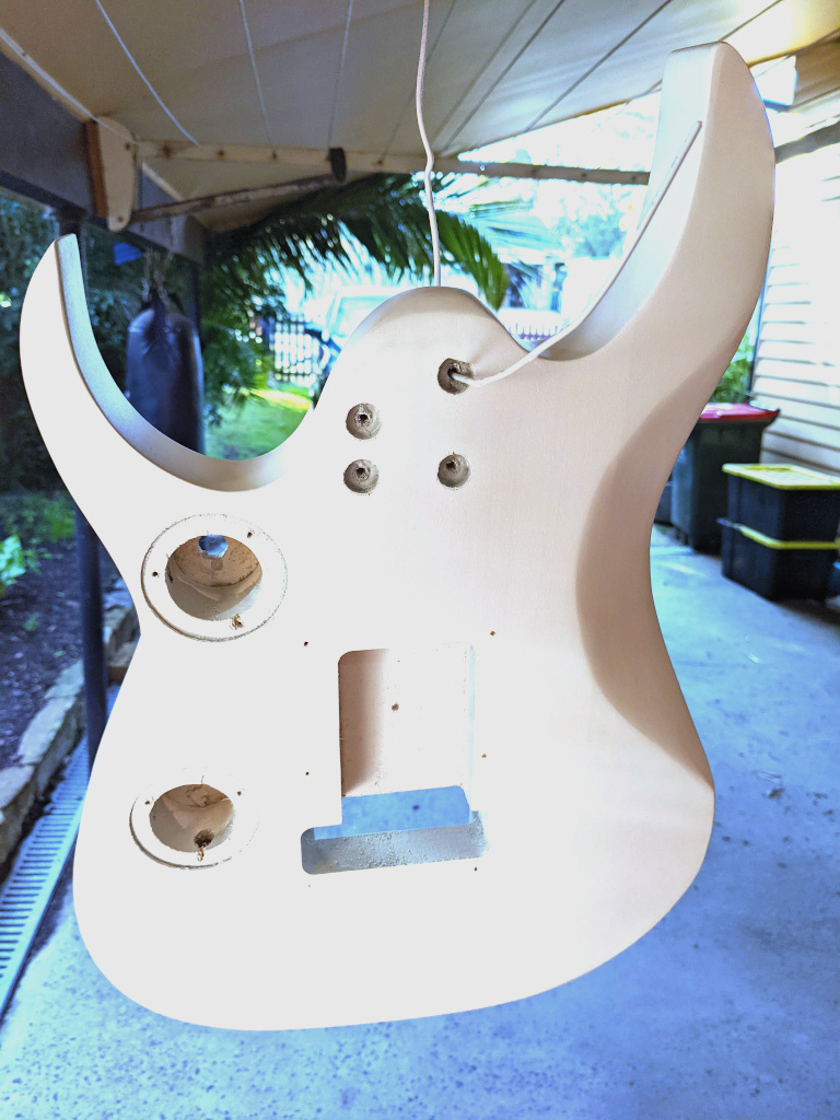

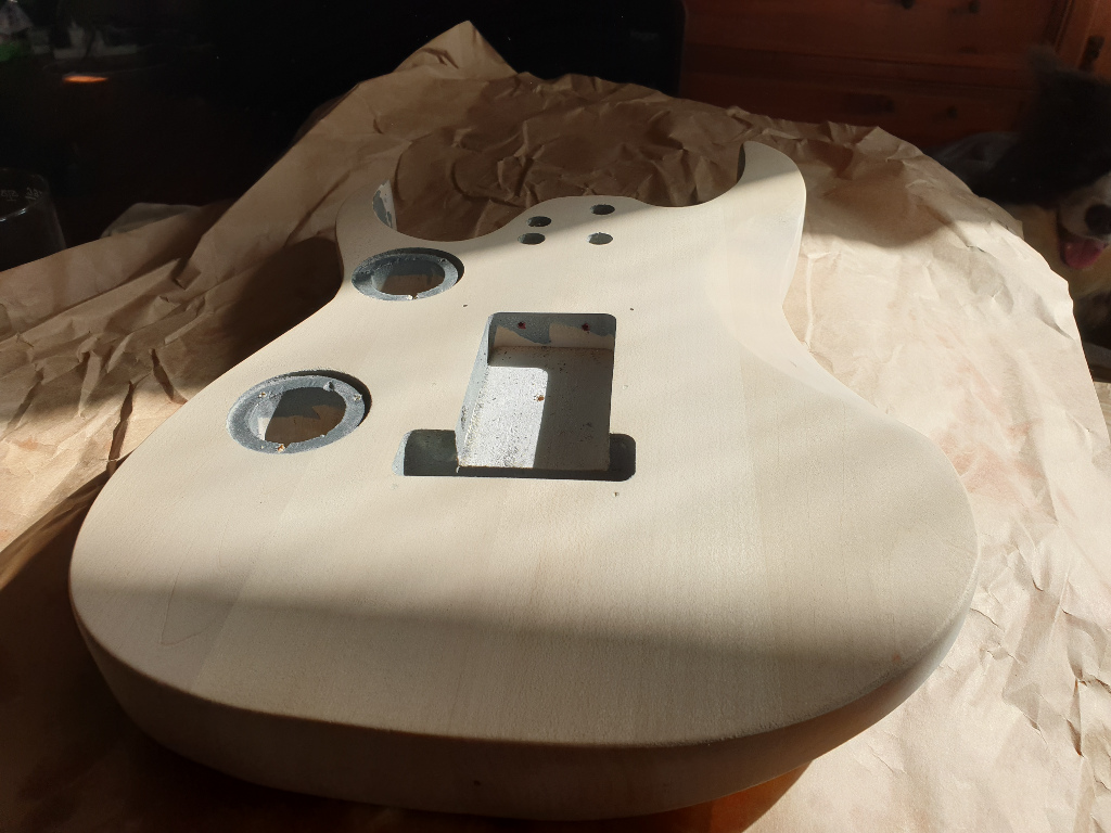

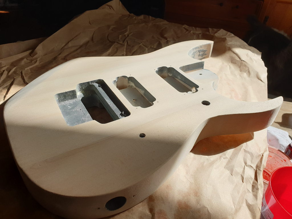

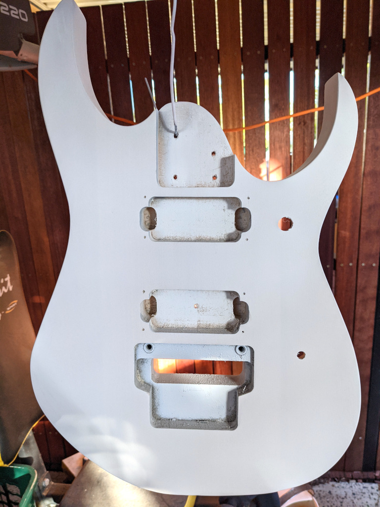

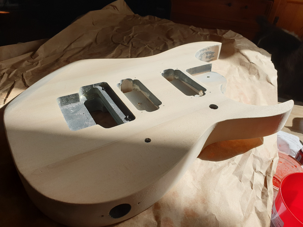

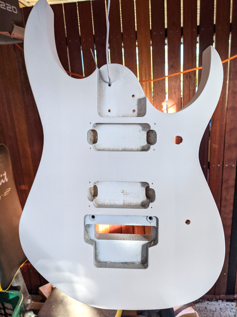

    This is where I left it for the past 10 months as I worked on a couple of AG kits. Didn't have the room to work on three at a time. Just finished one of the AG's so I've picked this up again. Fixed up a few little holes here and there and put three coats of undercoat on the body and headstock today, sanding between each coat.

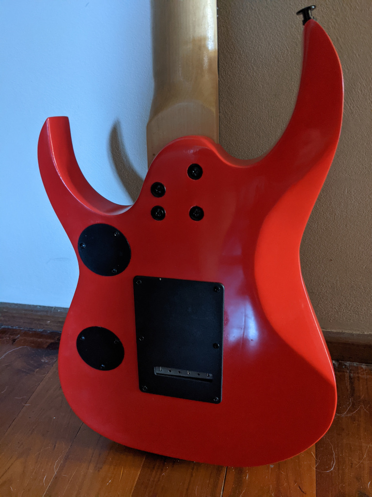

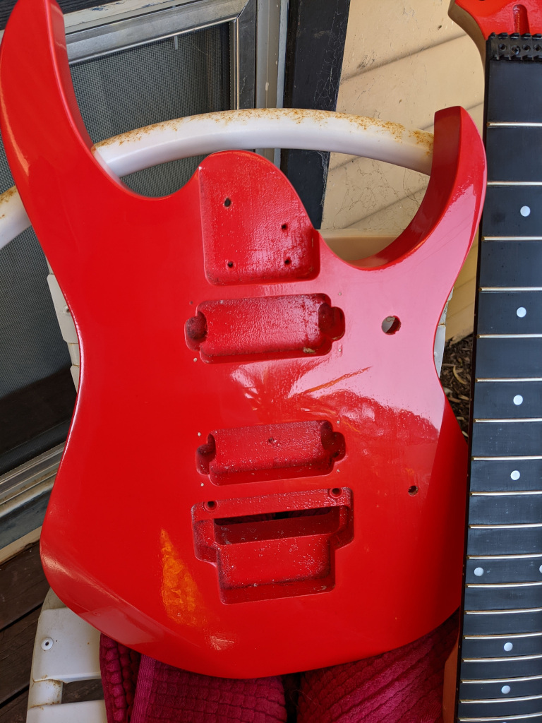

    While I'm waiting for my ST to dry off, thought I'd do a bit more on this. Looks like my wet sanding skills still leave a lot to be desired. Think I need to go back for more sanding and then polish again.
    Speaking of wet sanding skills, I think I'm using too much water in the process, or I need to somehow protect drill holes better as this is not the first time I've had streaks of timber swelling underneath the colour because water gets in where it's not sealed while sanding. What's the best method here? I was thinking maybe a smear of vaseline or maybe some wax in the holes and around the unsealed edges but I don't know how effective that'll be.
