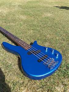

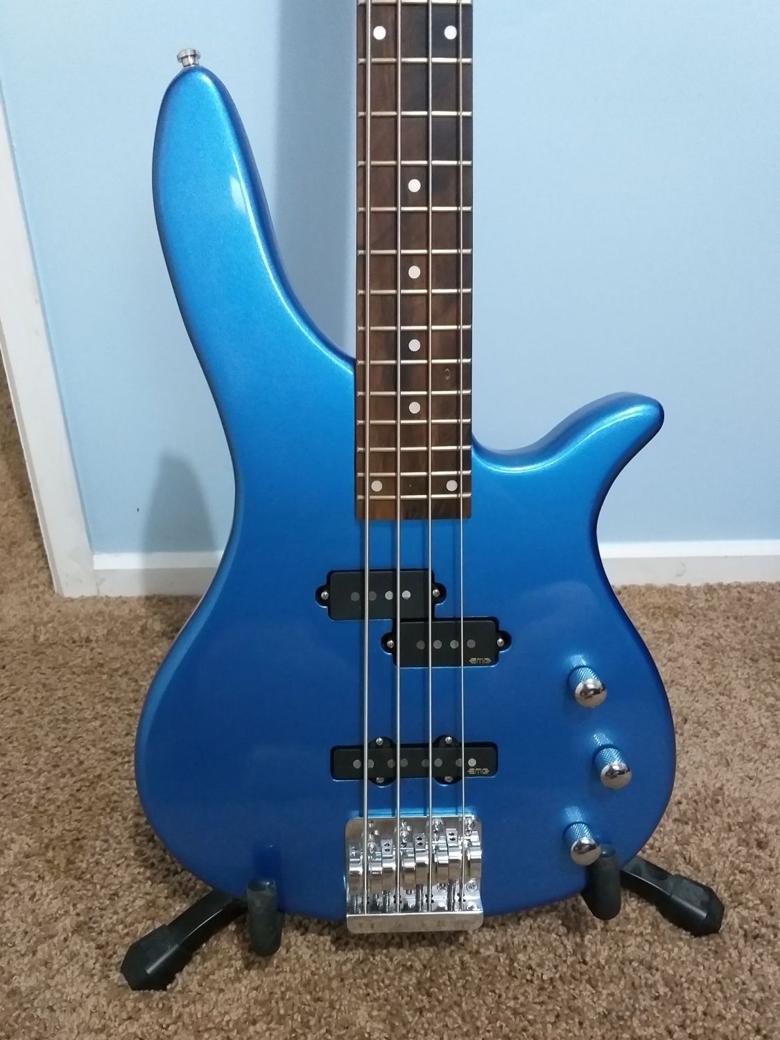

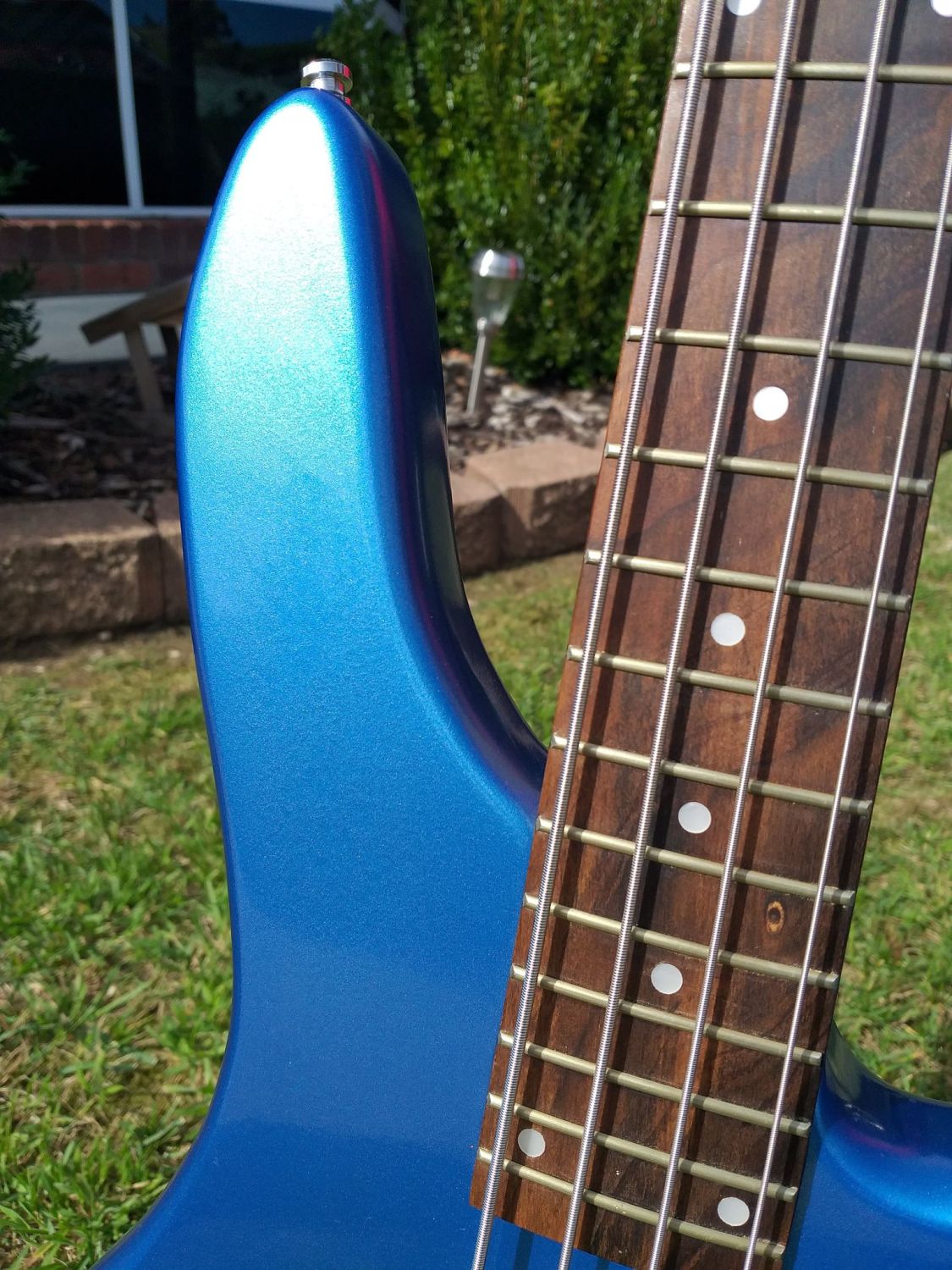

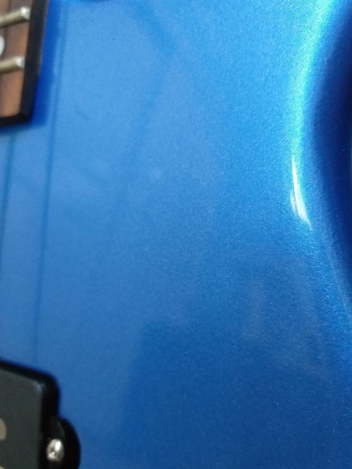

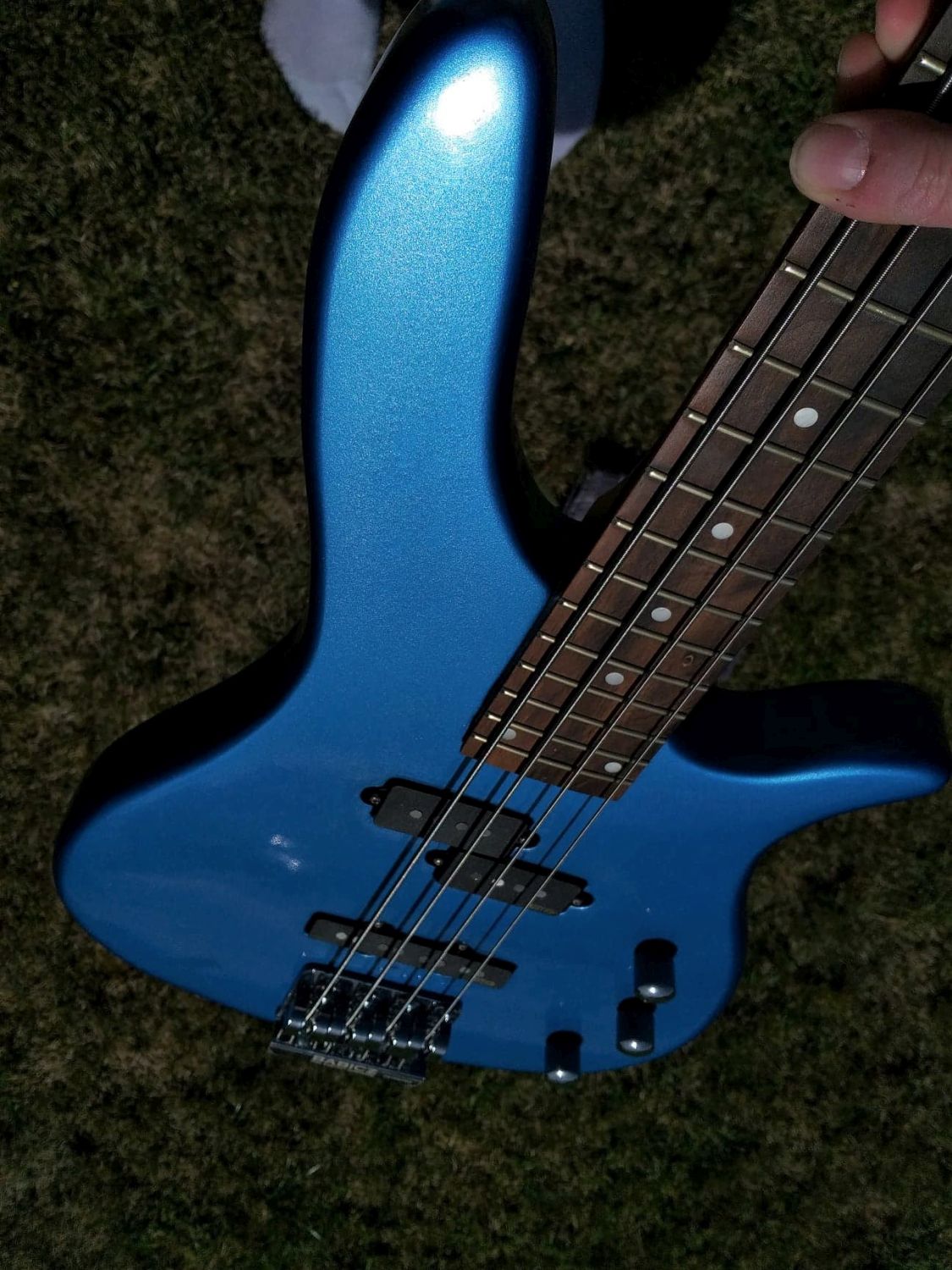

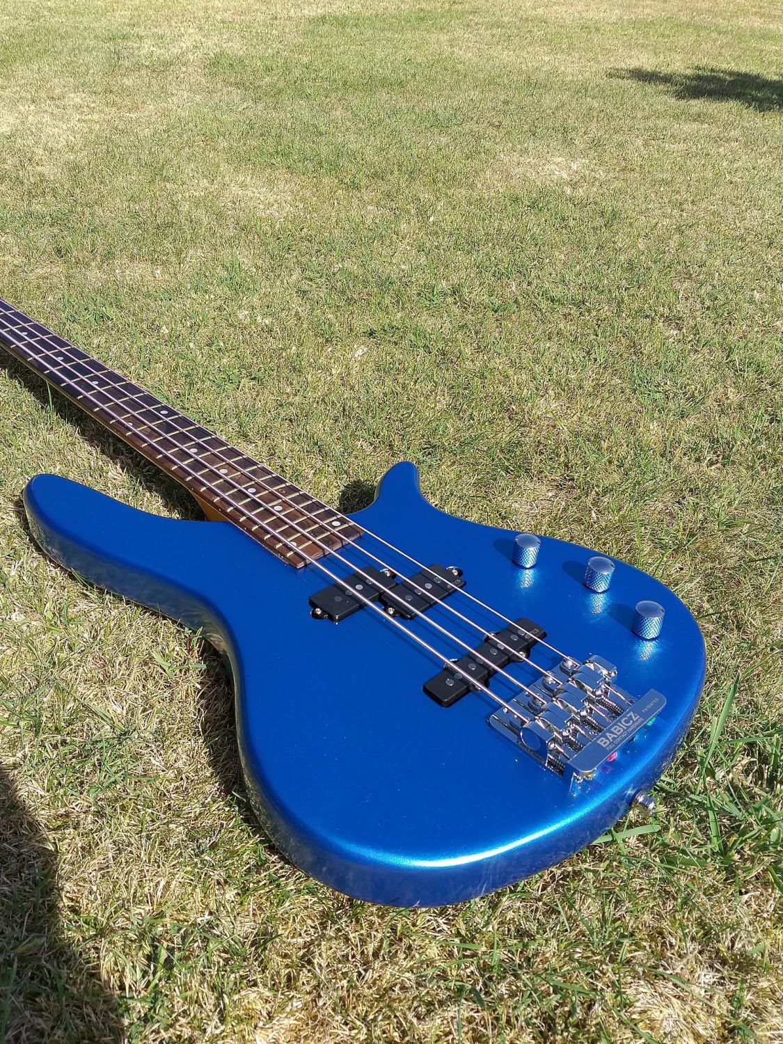

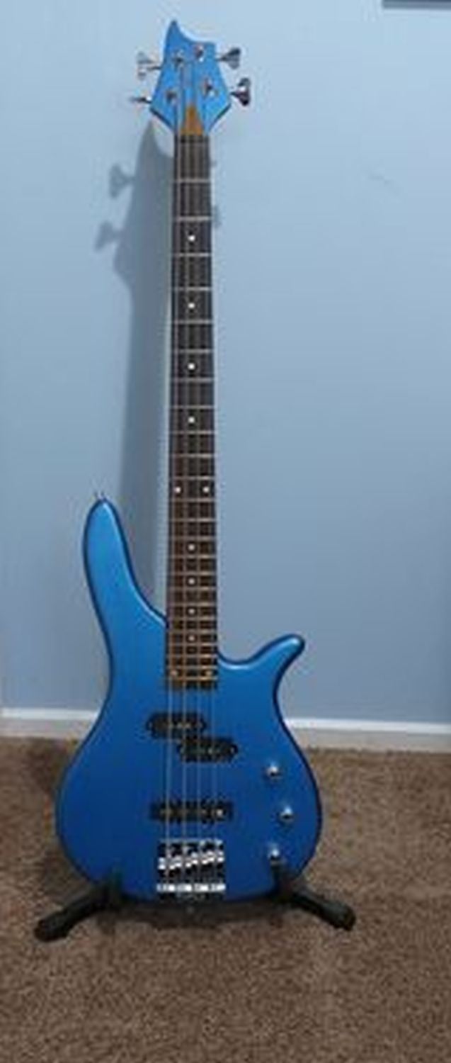

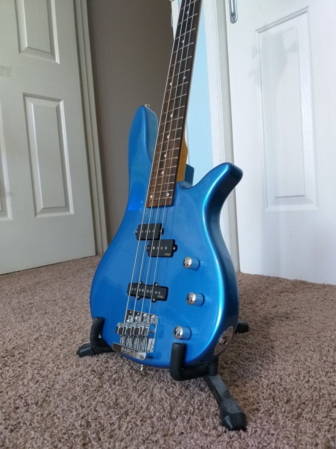

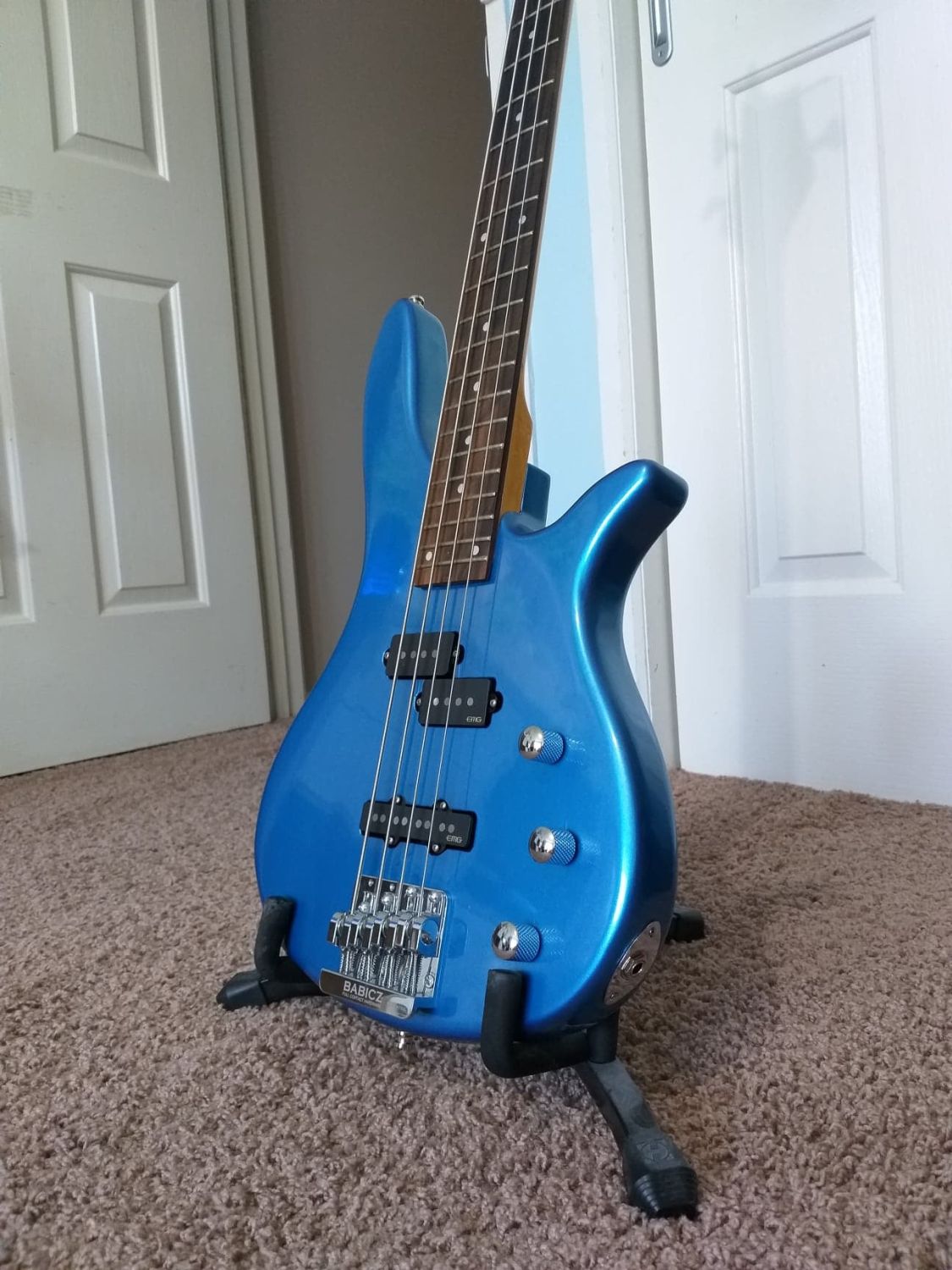

    So, here is what you can finish up with when everything, yes everything, that can go wrong does... Just soldier on...

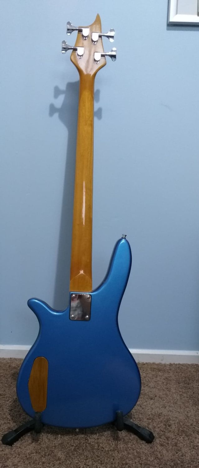

    This kit is a YB-4 bass kit. It has been put together with the following: EMG geezer butler PJ set pickups (for the record if anyone is going to use these, their neck pickup is longer, noticeably longer than standard.. hopefully this knowledge will prevent you from this discovery after you have painted the body like I did. This upgrade was an afterthought), Schaller tuners, Babicz FCH 4 bass bridge, Schaller strap locks, Lake Placid Blue nitro finish with high gloss nitro top coats (was initially pelham blue, I ran out of colour, so did Australia, no more coming out of UK because of Covid, YAY, had to change colour), nitro Tobacco neck tint again with high gloss nitro top coat, more swear words than you can imagine, some Id never even heard before.

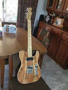

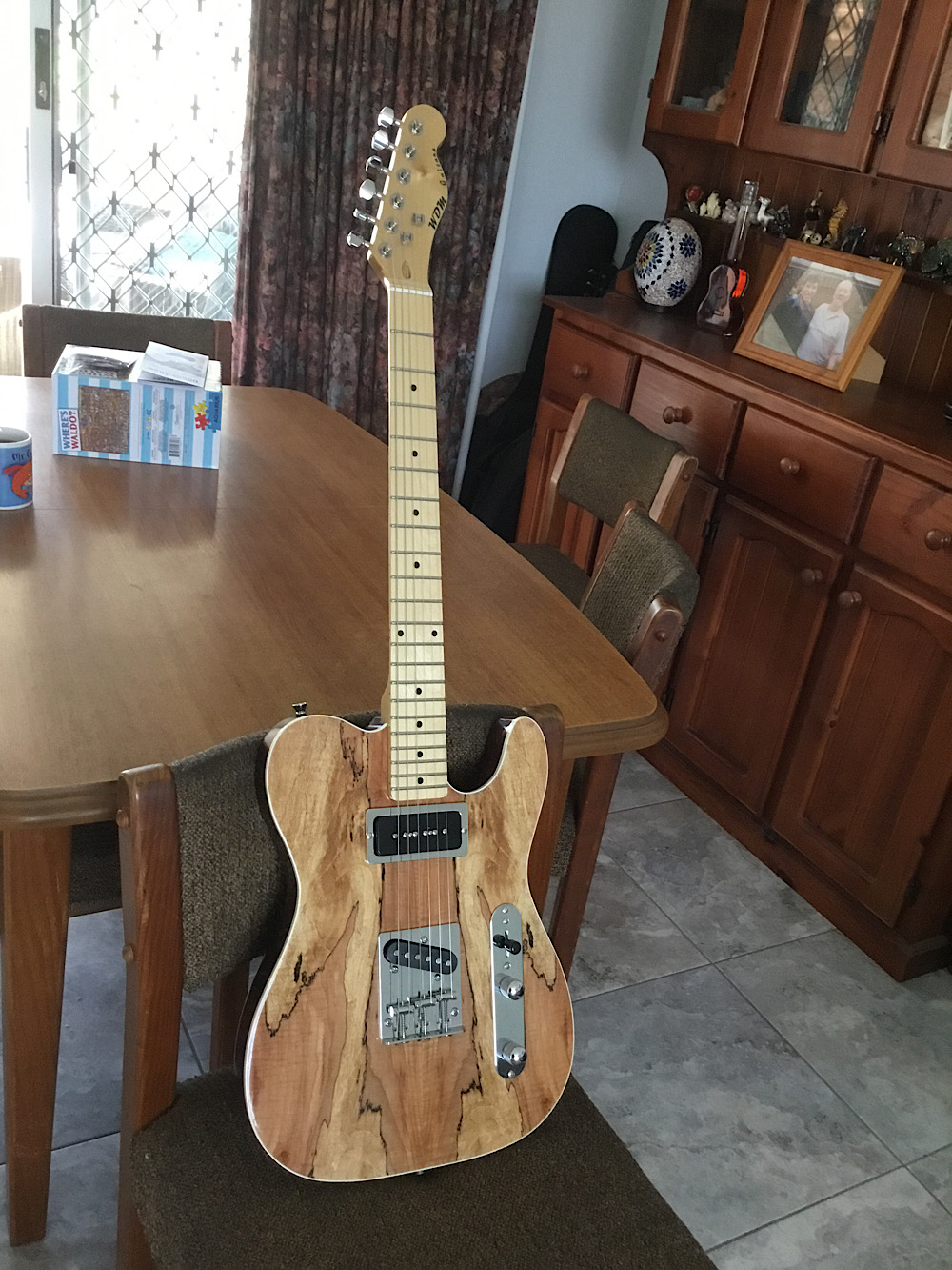

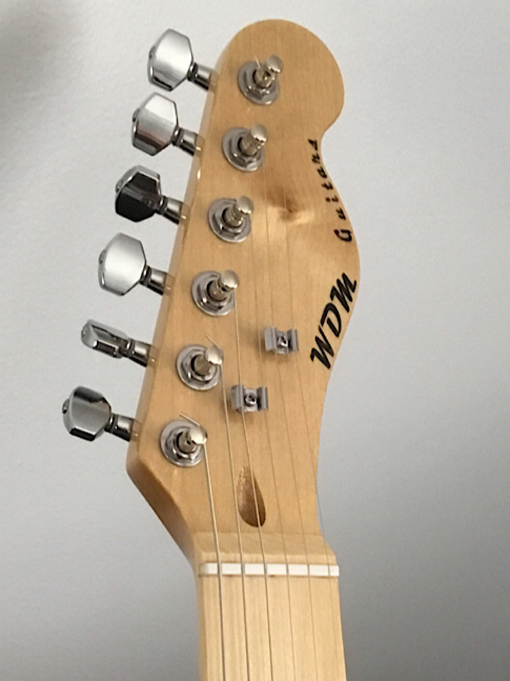

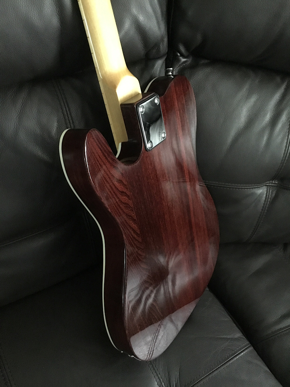

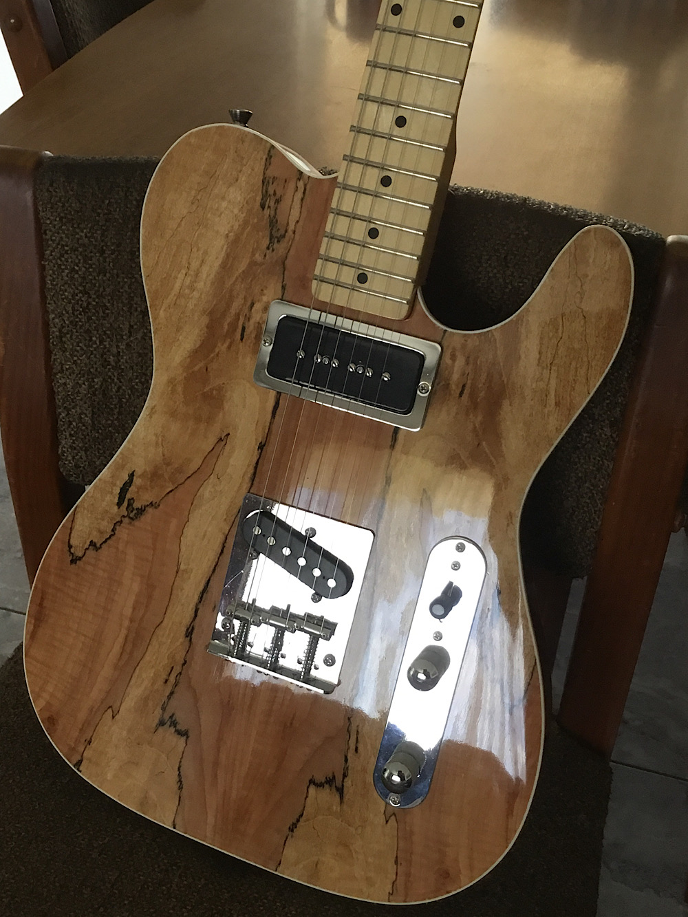

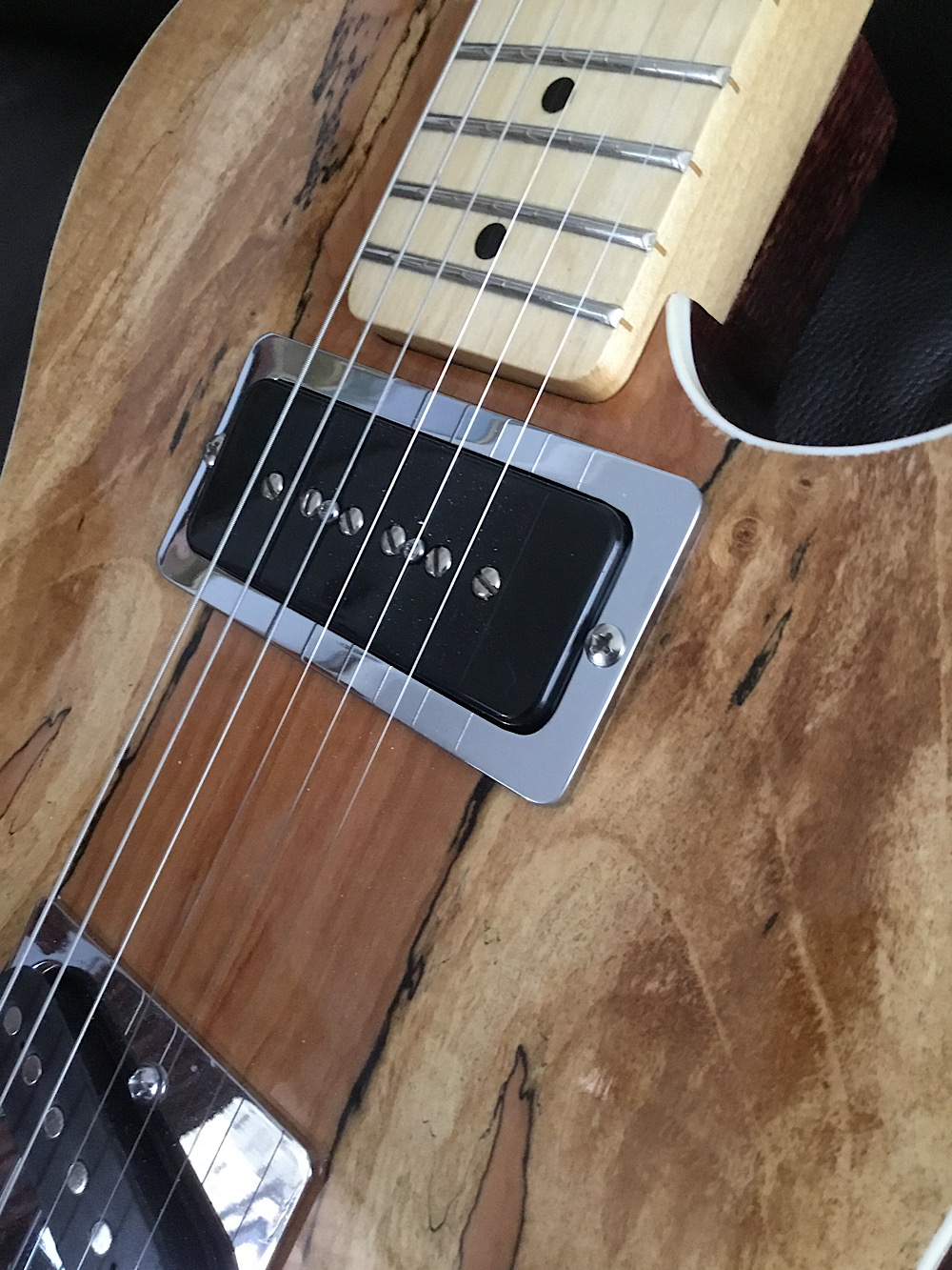

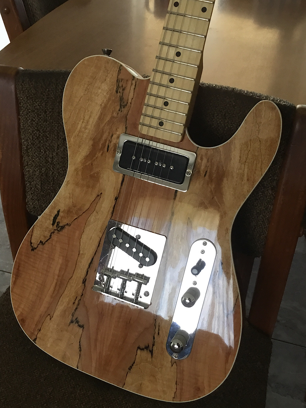

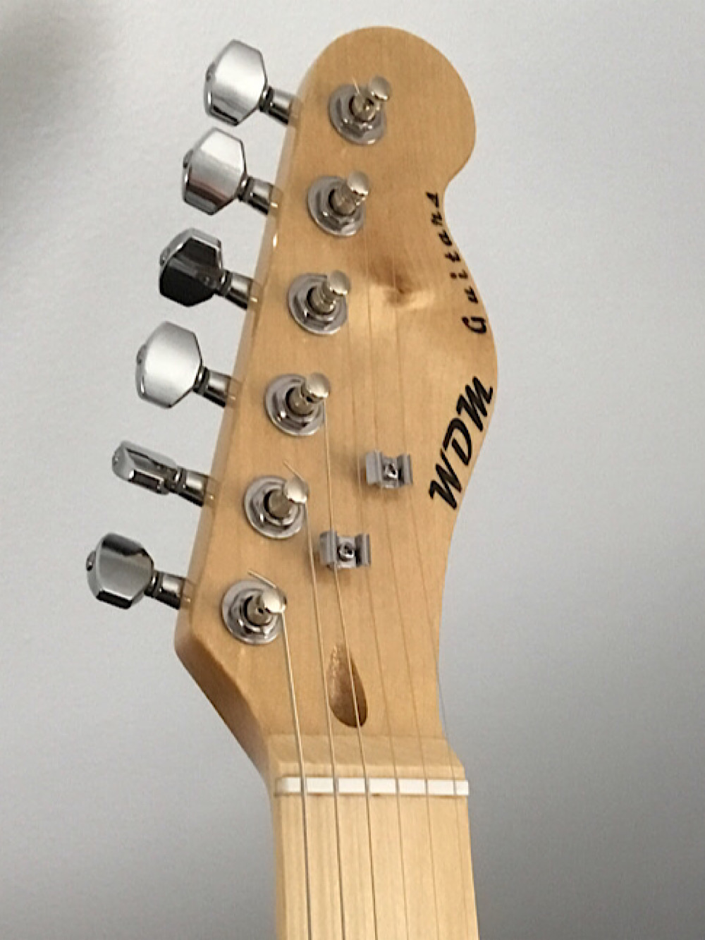

    Hi all, here’s my TL-1S, mahogany body with spalted maple top. I didn’t use the pick guard so I could see more of that spalted maple goodness. That left an opening for a bigger pick-up so I went with a Tone-rider Hot90. I didn’t like the look of the open rout with the pick-up just popping out, so I made my own pick-up ring and had it chromed. That turned out well as it matches the rest of the hardware perfectly.
    Good to know. I have a custom YB-4 hopefully getting shipped next week, *and* I have the same pickups waiting in their box here for it. I thought they were the standard size. The P bass pickups appear to me to be the standard size. <shrug> no biggie, since I have them before the build I can always make adjustments during the mock up stage. How do they sound?

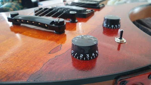

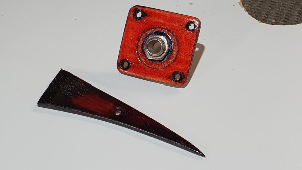

    It is an IC-1 Custom special. I originally ordered the standard model on back order but while I was waiting, the custom special came up so I upgraded. I finished it with Dingotone Karijini red on the body with about 30 coats of Tru-Oil. Dingotone colourless neck finish, again finished with Tru-Oil. Ink-jet waterslide decals on the headstock. Everything else was as standard with no upgrades.

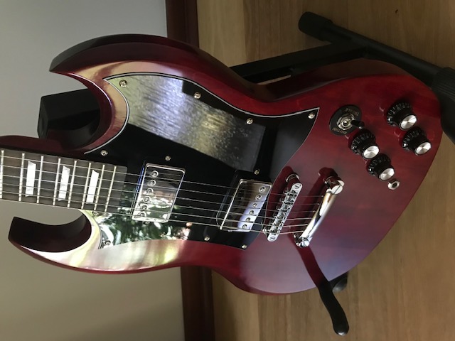

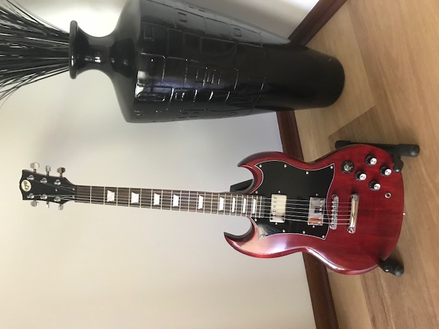

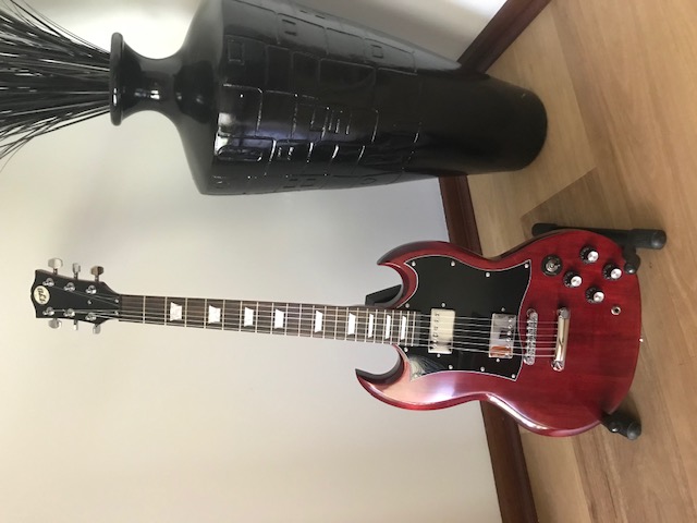

    Here is my first entry. My AG-2, stained with black and then red alcohol stain, finished with tru-oil. Stock parts except for the custom made pick guard cover, and purchased top-hat knobs and truss rod cover.

    Very nice Trevor, my brother who is 73 years old now, still has his original SG bass in cherry red stain from his early band days in the 70’s.
    Your AG-2 brings back some memories of those early days. Nice work. He also had Japanese Strat bass copy, which I am going to try and replicate and give to him for his birthday. Unfortunately I broke the original in my teen years and now feel guilty.
    Very nice work indeed.

    Great looking guitars. Love the spalted top on that Tele. Hope it sounds as good as it looks. I have head that the Tele-bridge and P-90 neck is pretty ideal.
    I have a set of Geezer Butlers on my Frankenbass. They are a fantastic PJ combo. Between the color and the sound, I am guessing that will quickly be your go-to bass.
