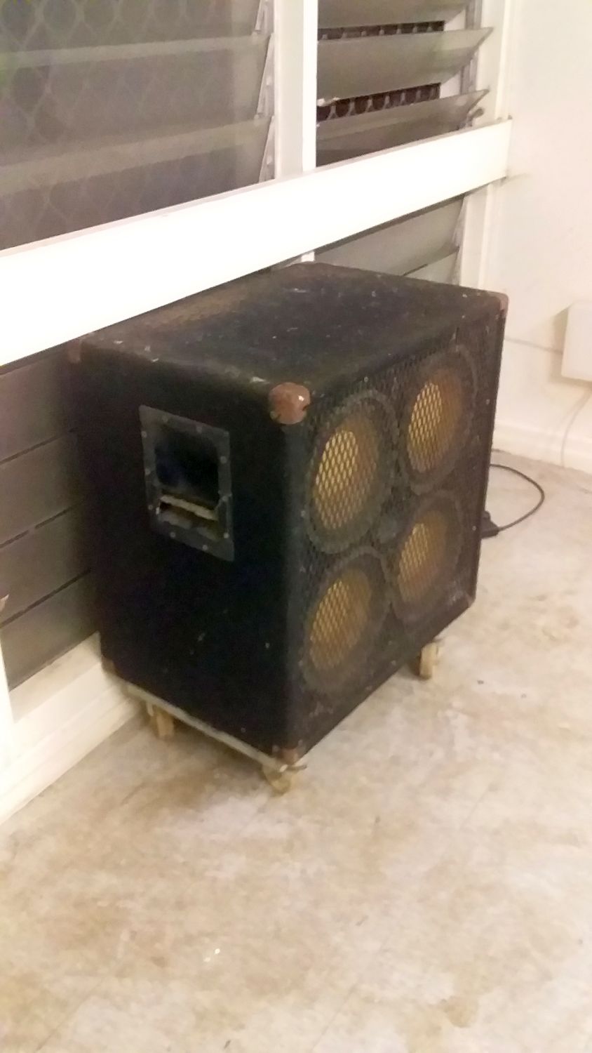

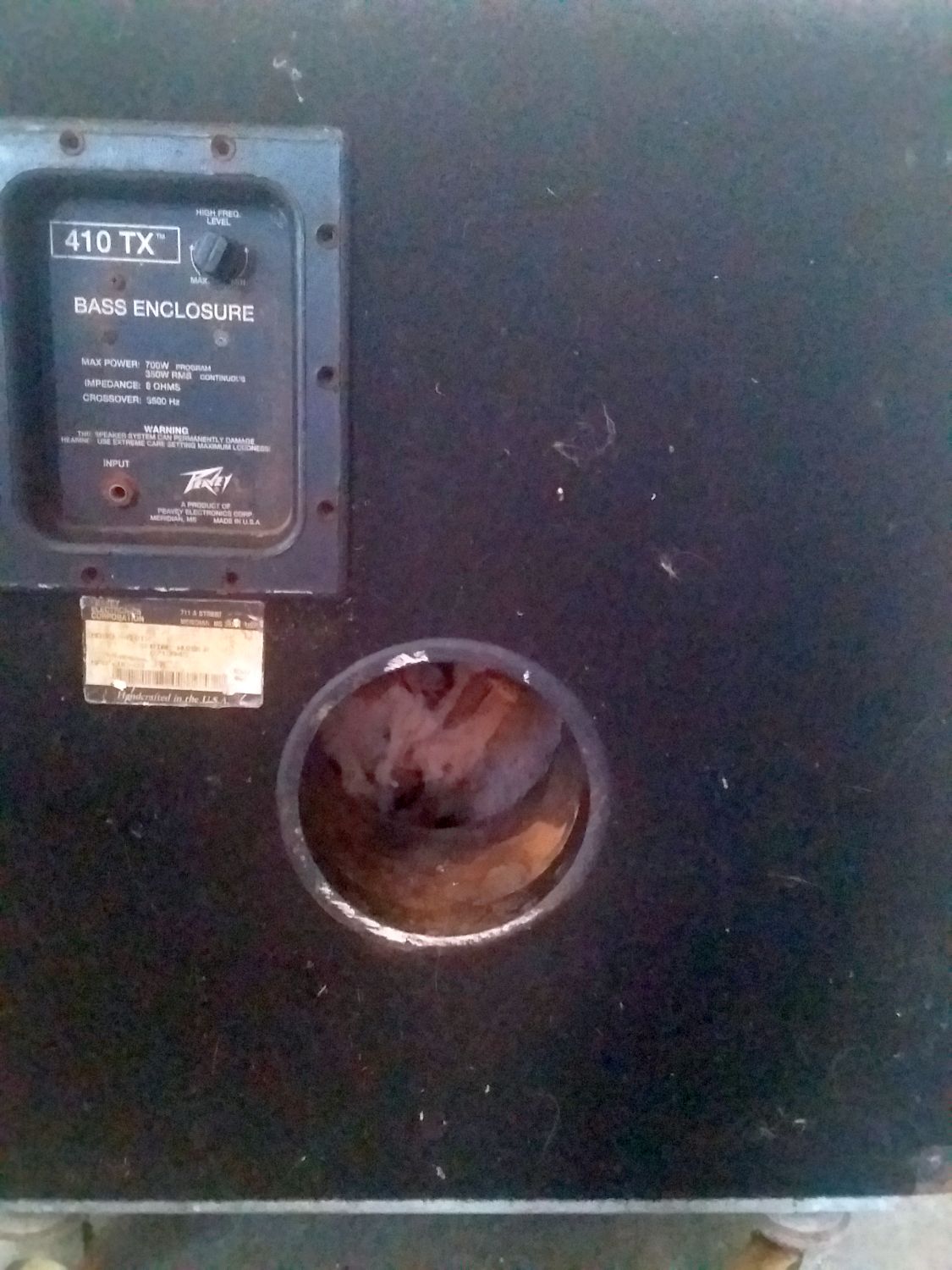

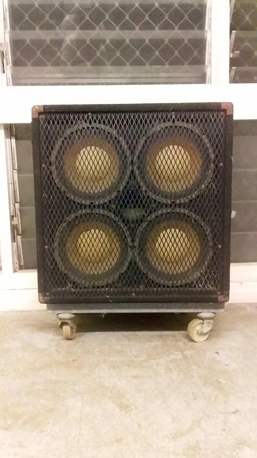

    Hey Everyone,
    Thought that I would start a thread about my Peavey 410TX Bass Cab in the amp section.

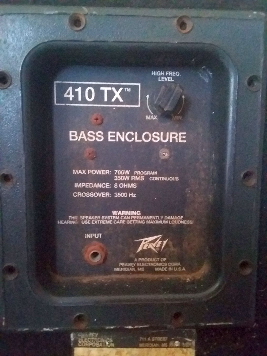

    Anyway, according to guy I bought the cab off of, he reckons I've got it fully paid-off, I've had a good look at the cab and from what I can determine only one of the original speakers is fully functional, the other three read open-circuit on my digital multimeter, so I'm going to have to buy four new replacements in order to get the cab working, and usable again, all the original acoustic dampening material needs removing and replacing cause it doesn't half pong, had to spray the insides with some air-freshener to make it bearable....but I digress...
    Ok, so the original speakers are 10 inchers, I need four new replacements, from reading the back panel, the speaker cab is designed to handle at least 350 Watts RMS if my memory is correct, I'll have to check that.
    Some pics:

    One forum member has suggested that the Eminence Legend B102 could be a good replacement speaker for the originals, I just wished that Peavey had the foresight to print the make and model-number of the original speakers on the back of them, would have been so helpful when choosing the right replacement.
    So, why am I interested in replacing all four of the original speakers?, I have a mid-70's Fender Super Twin amp which just happens to work really well as a Bass amp, the guy who sold it to me used it as a Bass amp for years and he told me that it worked great, I recently did a recording-session out at a mate's place, and the guy who sold the Super Twin to me, plugged his Fender P-Bass into it and used it for the recording session, sounded really good, I'm interested in using my Peavey 410TX Bass cab with my Super Twin amp so that I've got a good bass rig for recording or doing live gigs, I have a feeling that the Super Twin and the Peavey 410TX will sound really good together, once the cab is all sorted, so there's a good project for me to work-on in 2021, I may even look at building a solid-state Bass amp out of some bits and pieces I have in my studio room, there's a circuit board from an old Peavey TKO 80 non-eq Bass amp combo that has a good sounding preamp in it, I just need to ditch the 30 Watt power amp section and substitute a more powerful power amp circuit board, and then mount the lot, plus a power supply in a nice 19 inch rackmount case, and then I'll be in business.

    Speakers in cabs from major manufacturers are often custom models, not something available off the shelf, so may well only be available from the original vendor. Apparently the original driver in that cab was a Sheffield TVX 1035. I would doubt its available. Its not listed on the Peavey Web site.
    A cab doesn't intrinsically have a power rating, so you don't need to be concerned about that.
    It would be useful to know whether the tweeter and crossover are functional, although TBH given the hard life this cab has obviously lived it might be safer to assume that they are scrap.

    The Peavey 410TX cab I have does have a port on the back of it, as can be seen in the pics I've posted, to be honest, I haven't checked the tweeter to see if it is functional, I read in one of the Talkbass forum threads that the cab doesn't sound that great with the tweeter engaged, in the same Talkbass forum thread, the Eminence Legend was mentioned as a possible replacement (the thread starter was actually in the process of replacing speakers in their Peavey 410TX cab).
    I'll have to measure the inside dimensions of the cab, and yeah I agree, it looks like it has had a pretty hard life, I'm suspecting that at some stage it probably got some mud inside it, it definitely looks like it wasn't very well looked-after that's for sure.

    Ah, didn't realise that was a port. I thought it was just a removed connection plate. How I managed to think that with the real plate alongside in the same photo will have to remain one of life's mysteries...
    I'd take the tweeter criticism with a pinch of salt, there's a vociferous anti tweeter lobby in the bass fraternity. Equally though I wouldn't bother fitting a tweeter to a bass cab unless I actually found a need for one after running without. I saw the TB thread you mention, but I'd seek a recommendation from Eminence by preference. With a single round port it's fairly easy to alter port tuning, more especially if shorter is required [grin] but it's all hassle and measurement, so unless that sort of thing fascinates you...
