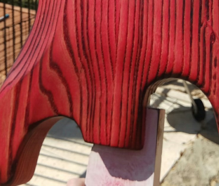

    Hi Diggy. I would be interested in seeing a before and after shot to compare them?
    This was taken just after applying a few coats of colour.

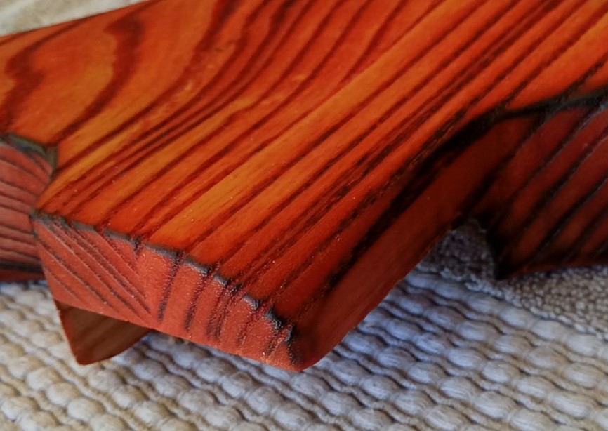

    This was taken yesterday.
    It seems to have yellowed a bit, was this from the final coat? I haven't applied anything other than the dingotone oils.
    1,981
    Wow, that is a big difference.
