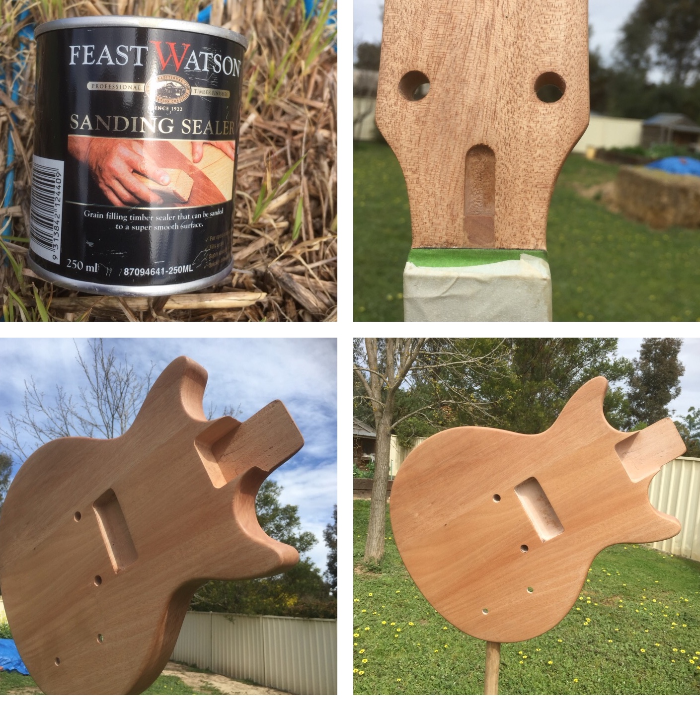

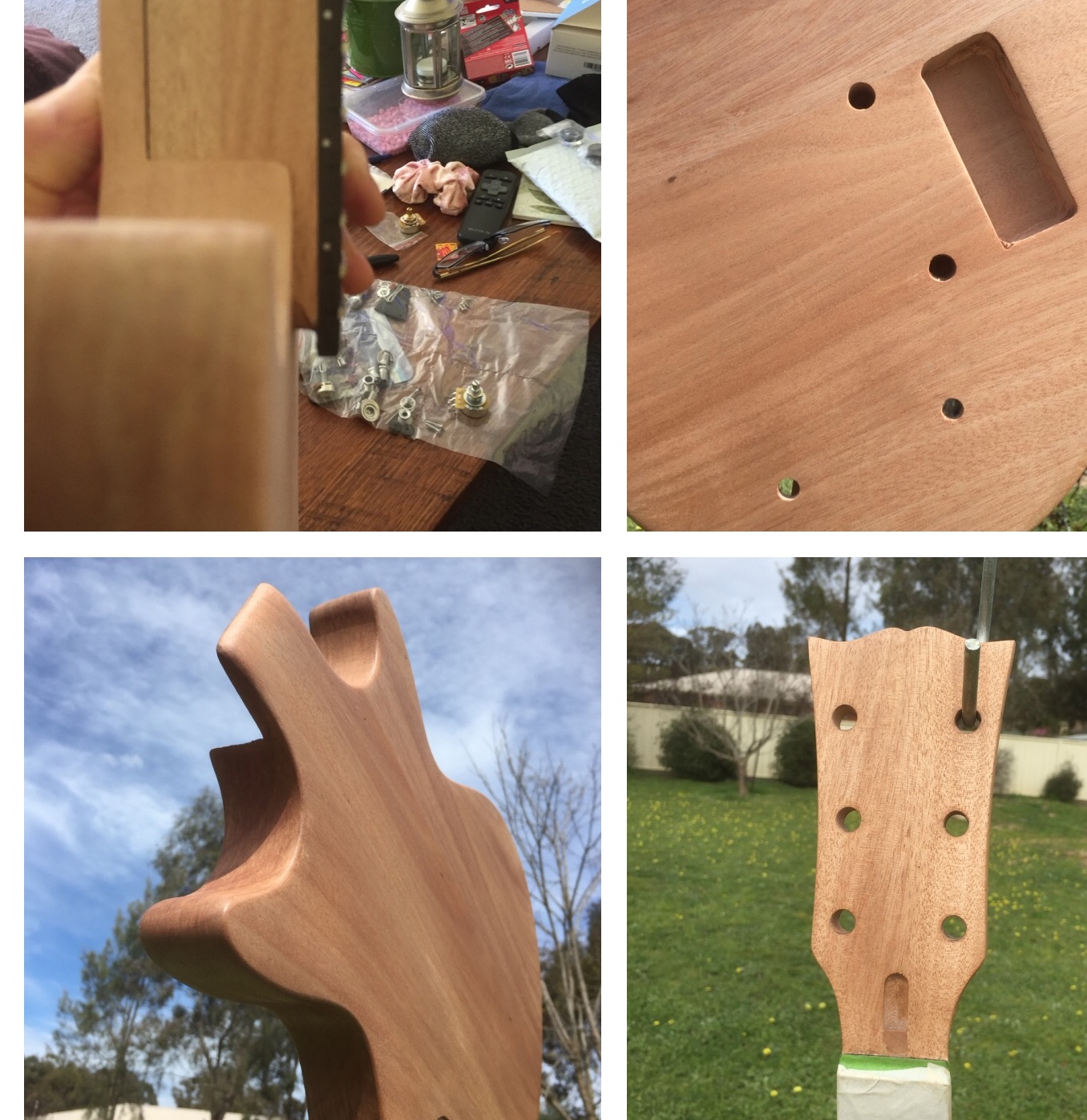

    lve shaped the headstock and glued a small bit of wood in the truss rod hole. I also made the pickup route bigger (for handwound p90) and enlarged holes for CTS pots. Sanded, painted with sanding sealer, more sanding followed by a second coat of sanding sealer.
    I’ve also reshaped the heel where the neck will be glued. It was very square and ugly.Click image for larger version.

    I took the plastic nut off, to be replaced by a Tusq nut. Not sure whether to fret dress now or after gluing the neck to the body?

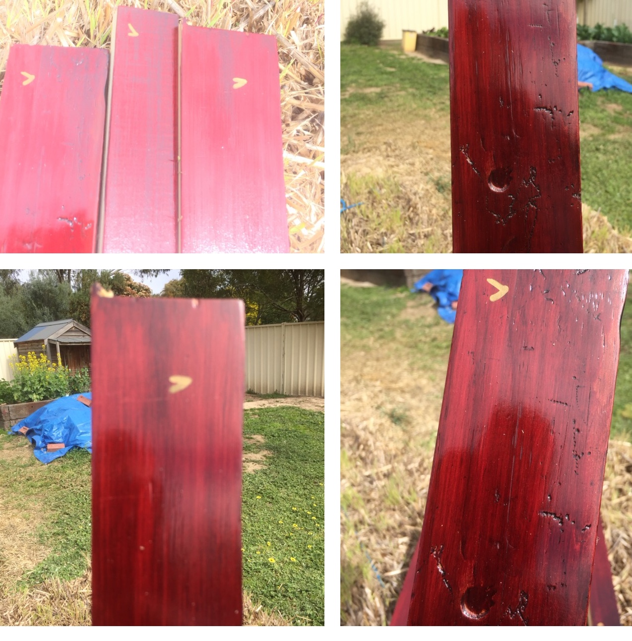

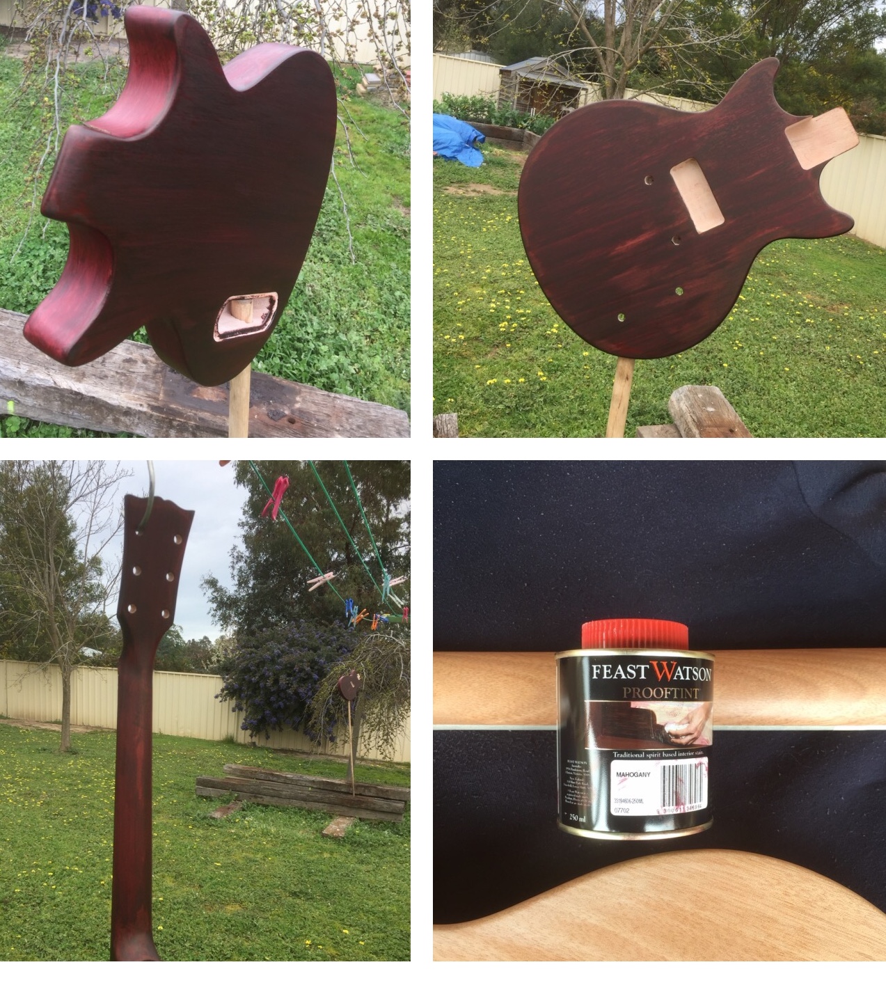

    I sanded the second coat of sealer this morning using 400, then 600 grade paper. Felt super smooth, so thought I’d give it a coat of mahogany stain. I did a few tests on some scrap wood a few days ago and it came up great. I was too heavy handed with the stain today, applying it with a soft rag. The sides of the body look OK, but the back and front look like shite..😩
    Will let it dry then sand again. Will apply the stain with makeup wipes, sparingly this time. Definitely a case of “less is best”.
    Is meant to be “cherry red”, but looks more like poop.

    Here’s my test bits with a coat of clear varnish on top. That’s how it’s meant to look..Click image for larger version.
