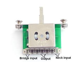

    Anyways, I saw this on the internet and keen to give it a try using an Import Box style 5 way switch that comes with 8 lugs, like this one....
Name:	3  way  switch-1.jpg
    Here is the link to what inspired me..... https://www.premierguitar.com/articl...-parallel-mods
    The only issue is this article refers to a totally different type of switch and struggling to figure how to do the same on an 8 lug import box switch? Nothing seems to identify a lug or tab that goes to ground and not sure if this is relevant or important in trying to achieve what this article suggests can be done.

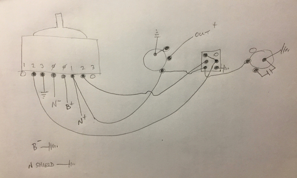

    If I was to use stock import 3 way with 8 lugs and a separate mini dpdt on-on switch to do the series instead of using a push-pull any ideas on how to wire that up?
    Cheers, Waz
    Quick sketch, but should work... if you can understand it. Needs to be an 8 lug 3-way ‘import’, an On/On DPDT mini-switch, and the Neck pup modded to have a separate shield wire. Mini-switch ‘up’ is parallel and ‘down’ is series when in position 2.
    If the sketch is too chaotic to understand I can draw it up properly in the next few days.
    Thanks mate.
    I presume -N = neck pickup wire from the metal cover?
    Might also retrace my steps on existing oak Grigsby 4 way switches to see if they can be salvage.
    Cheers, Waz
    Sent from my Lenovo TB-7104F using Tapatalk
    + and - are the positive and negative signal wires for the N(eck) and B(ridge). ‘N shield’ is the extra wire connected to the neck pup cover added with the series mod. B- and ‘N shield’ are both connected permanently to ground. B+, N- and N+ go to the indicated lugs on the switch.
    The way the layout works is the Neck hot N+ is permanently connected to the (effective) switch output, and N- is switched between no connection, ground and Bridge hot B+ (for series) as needed. In position 2 the mini-switch ‘up’ connects B+ to the out and N- to ground to give you Bridge and Neck in parallel, and when ‘down’ it connects B+ to N- to give Bridge and Neck in series.

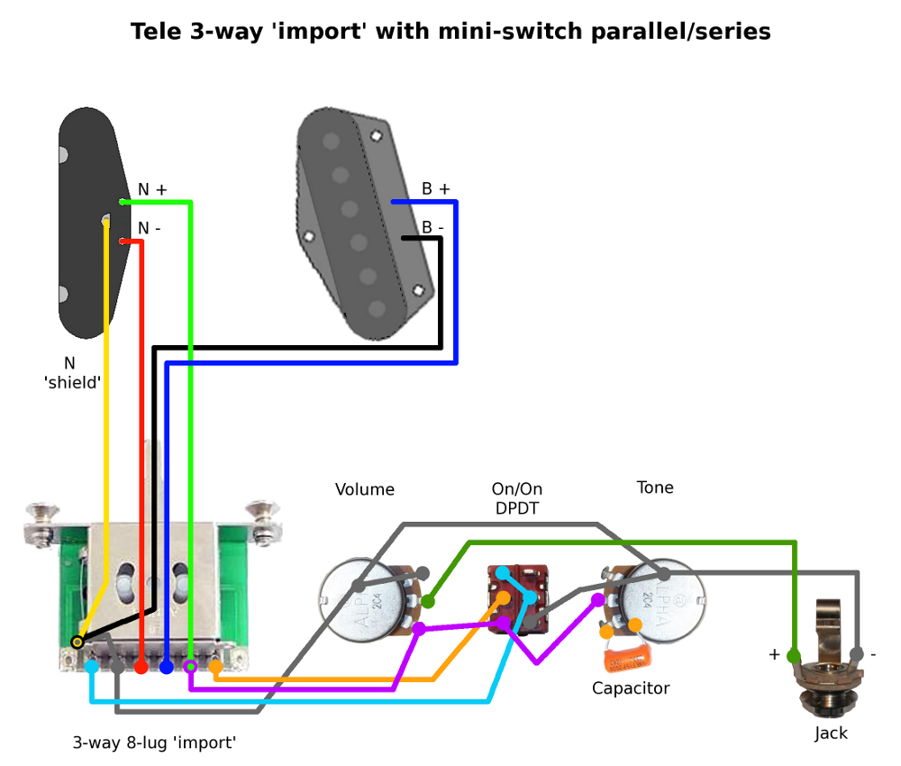

    Hopefully this is a little clearer:
    1. Bridge
    2. Bridge + Neck (mini-switch 'up' parallel, 'down' series)
    3. Neck
