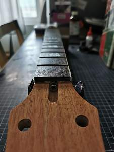

    So I got this neck for a little toy project (oil can guitar) for 23 bucks, but the fretboard does look suspiciously artificial. It's supposed to be palisander but I don't think so. I tried to sand it lightly but the "rippled look" remains, so these are not machine marks, it looks like wood fibers pressed or "printed" in layers. What do you guys think?

    Not sure if I should do anything with it? I heard it has a tendency to have fibers break out, so some people seal it.
    I thought I might just tru oil it together with the rest of the neck, can't hurt, right?
    Thanks! :-)

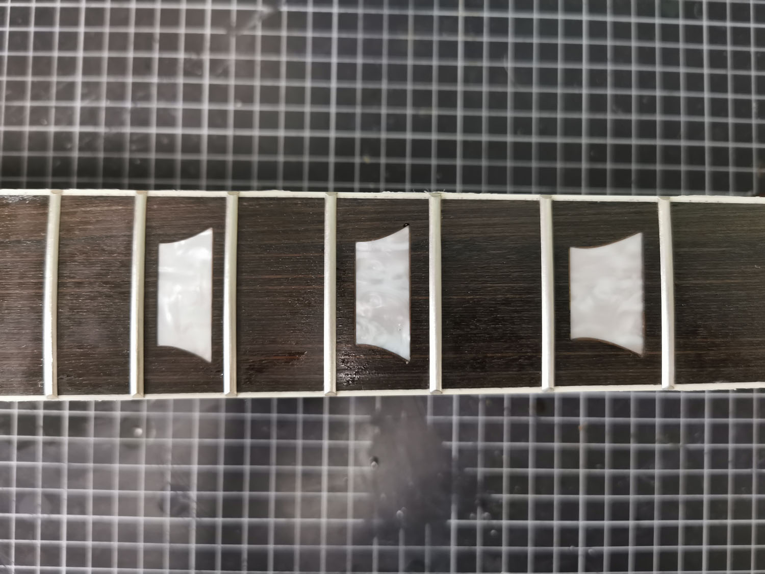

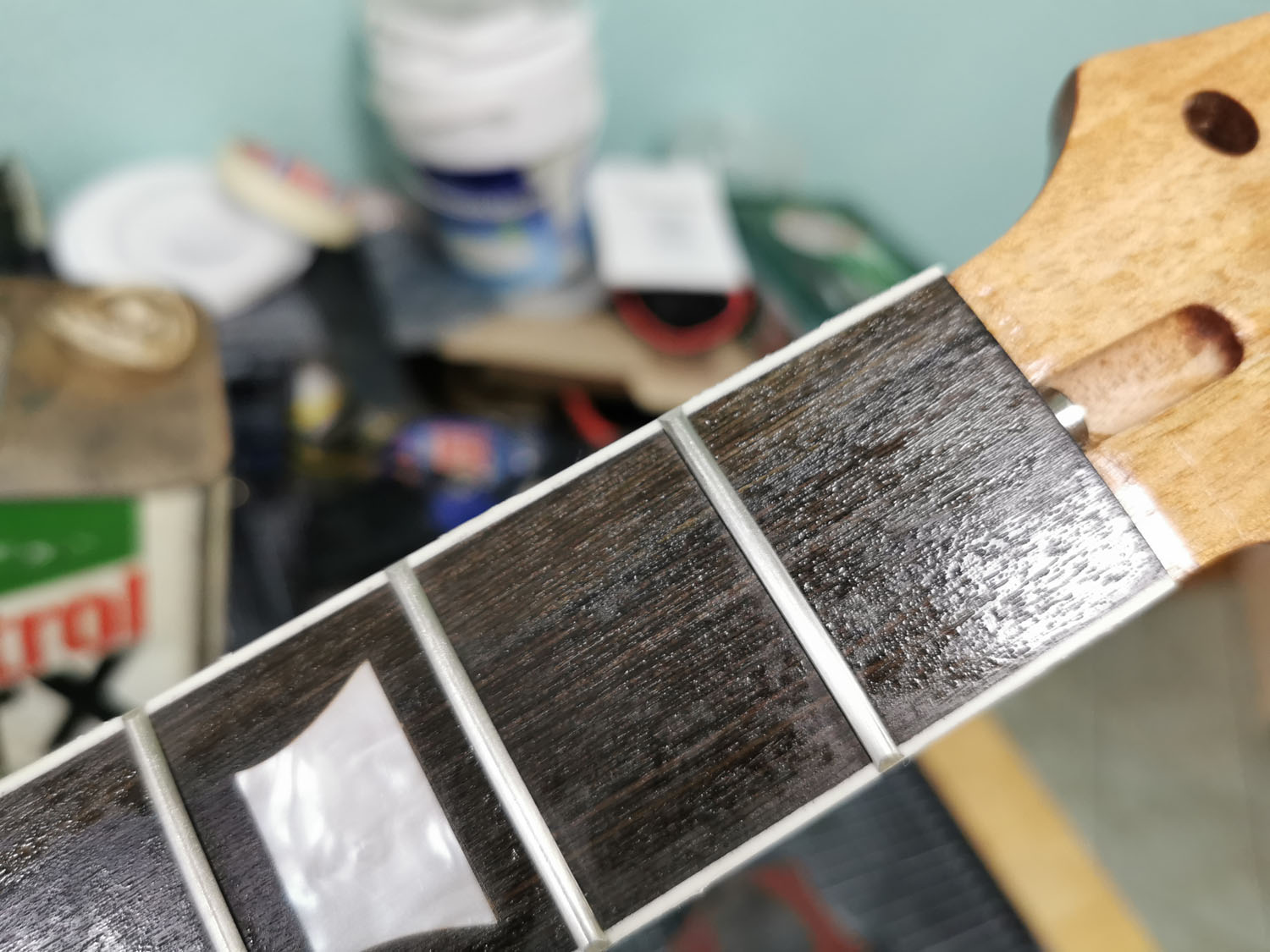

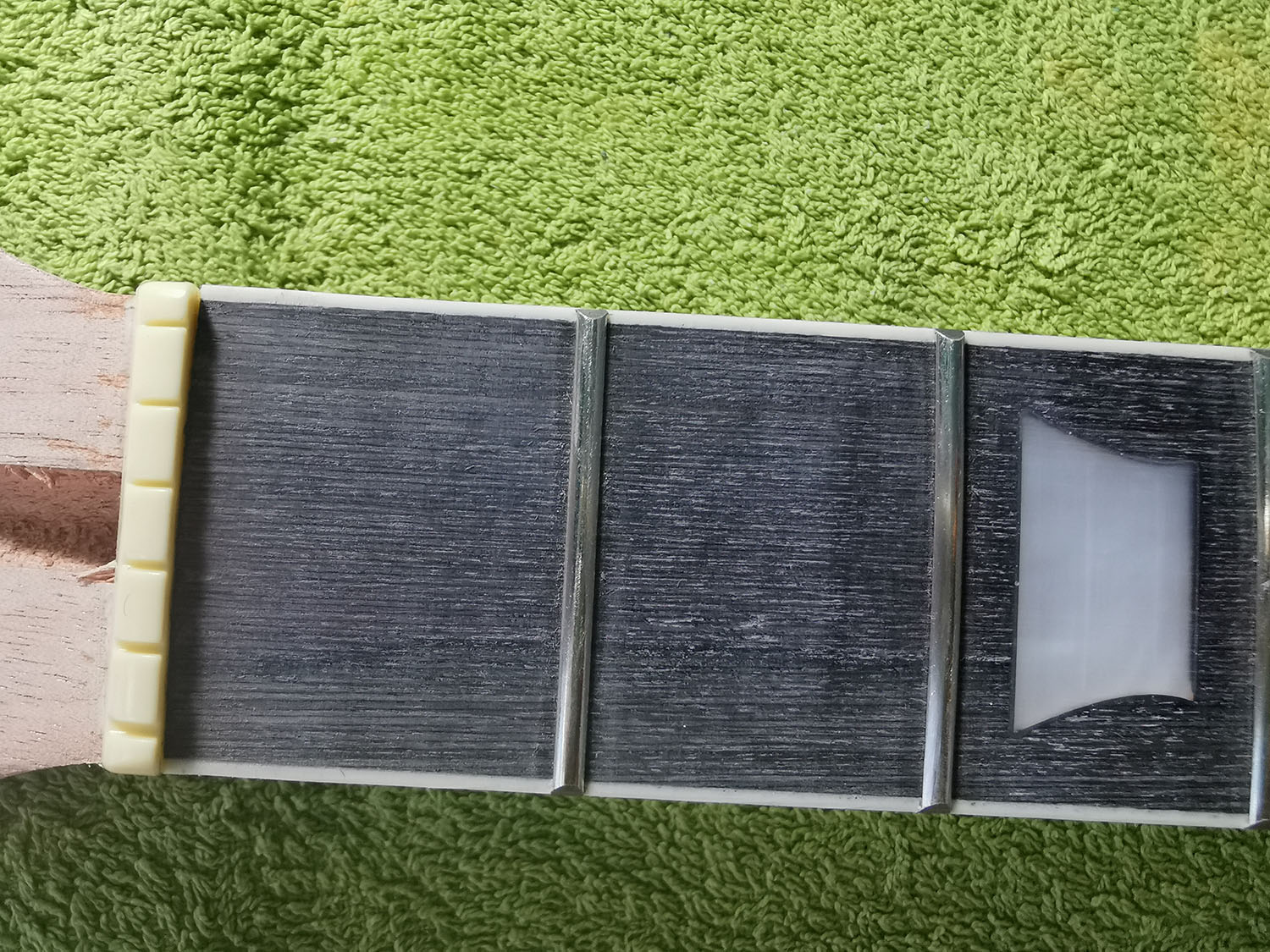

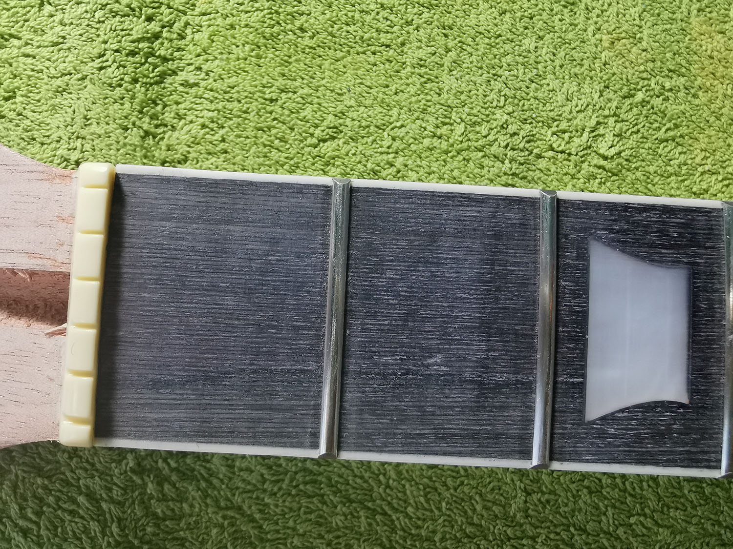

    So I started to seal the fretboard with super glue and ... It started to look quite real?!
    I had it covered with masking tape over night while the first coats of true oil dried, and no chunks came out when pulling the tape off. Probably one or two small fibers, but certainly less than from my "real" rosewood boards. So could this be some kind of real wood, or is it just very well manufactured?

    Anyway, I'm pretty confident it's gonna be a nice neck (besides the fact it's not my favorite thin form factor).

    Well manufactured by the sound. So good news.

    The first kit I made had this and I actually think its made of recycled plastic. I had to trim off some overhanging fretboard and it was most assuredly not a wood product of any form.
    The engineered boards are normally a softwood, typically spruce, in a plastic resin. it's definitely an engineered board. If it't not shedding fibres, then don't use too much CA glue. I'd be tempted to scrape it flat, using a sharp Stanley knife blade, rather than sand it, at least until you've got it almost flat. It's more controllable than sanding.
