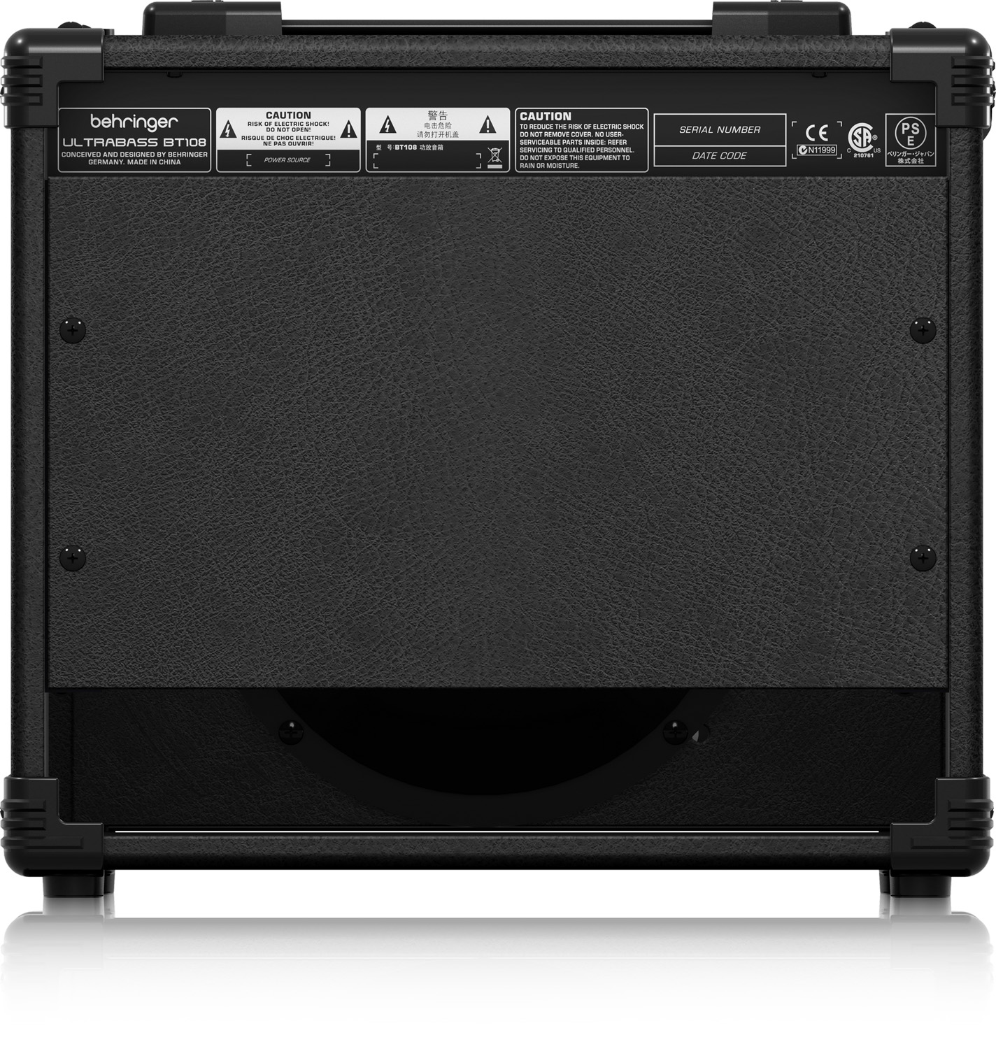

    BTW, the current Bugera BT108 has a vented back, rather than fully open one, so I'd imagine that it is acting as a basic port. The port size probably needs to be quite large to get the right response, and it looks larger because it's a small enclosure.
    If you took that back off, then you'd get much less low end from the unit and you'd probably quickly destroy the speaker if playing at loud volumes as that bit of wood will still help reduce speaker excursion..

    It's something I meant to add earlier, but I wasn't getting a good connection to the forum. Yes. Simon is right, it is possible to design a bass cab with a very short but large port on the rear that looks for all the world like an open back. It doesn't behave like one though.
