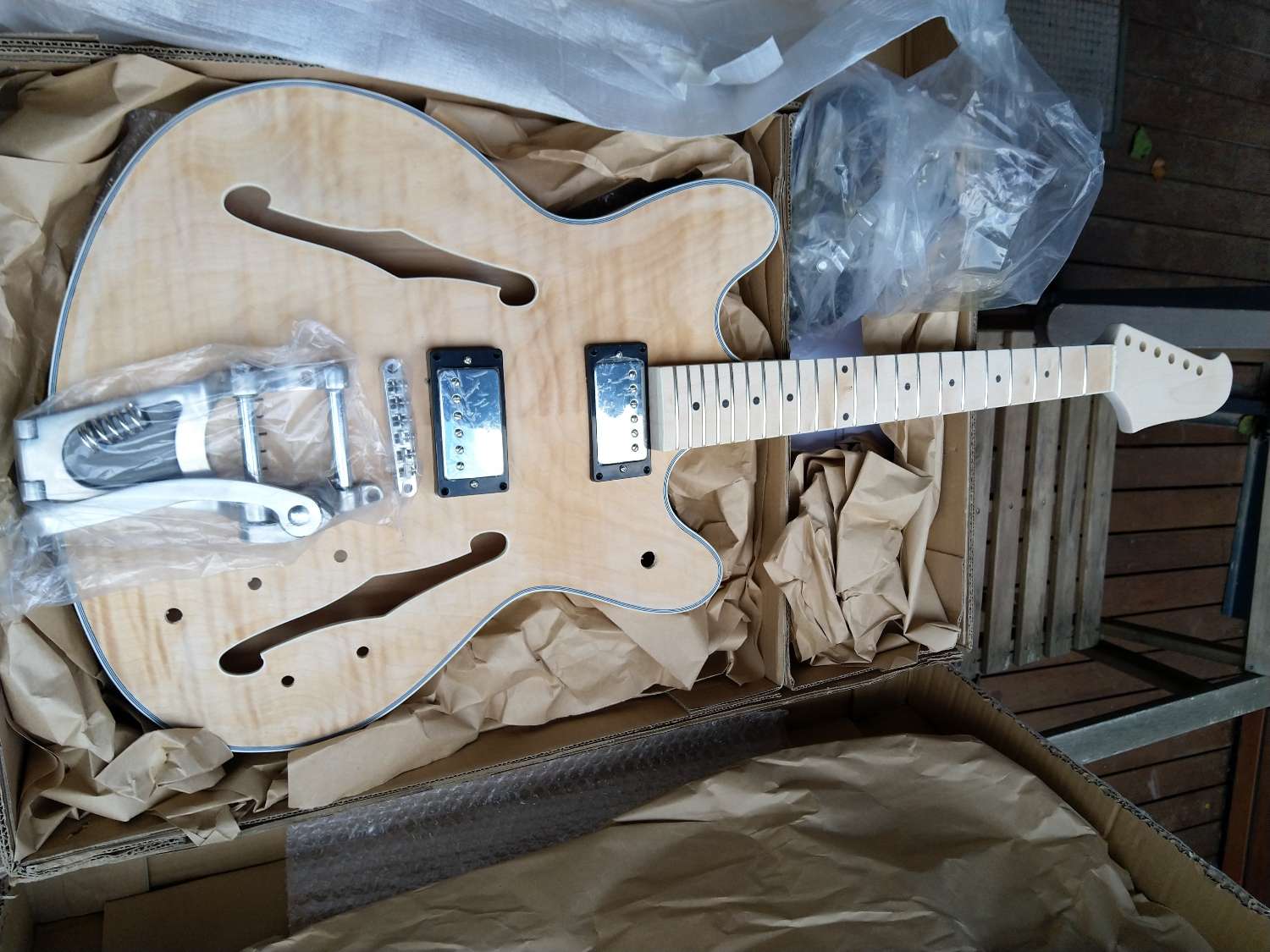

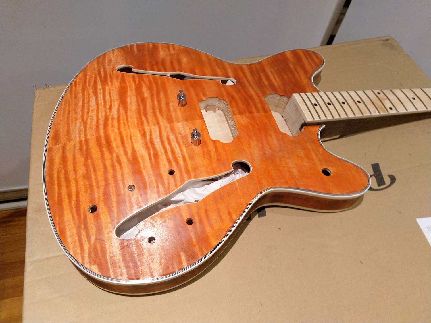

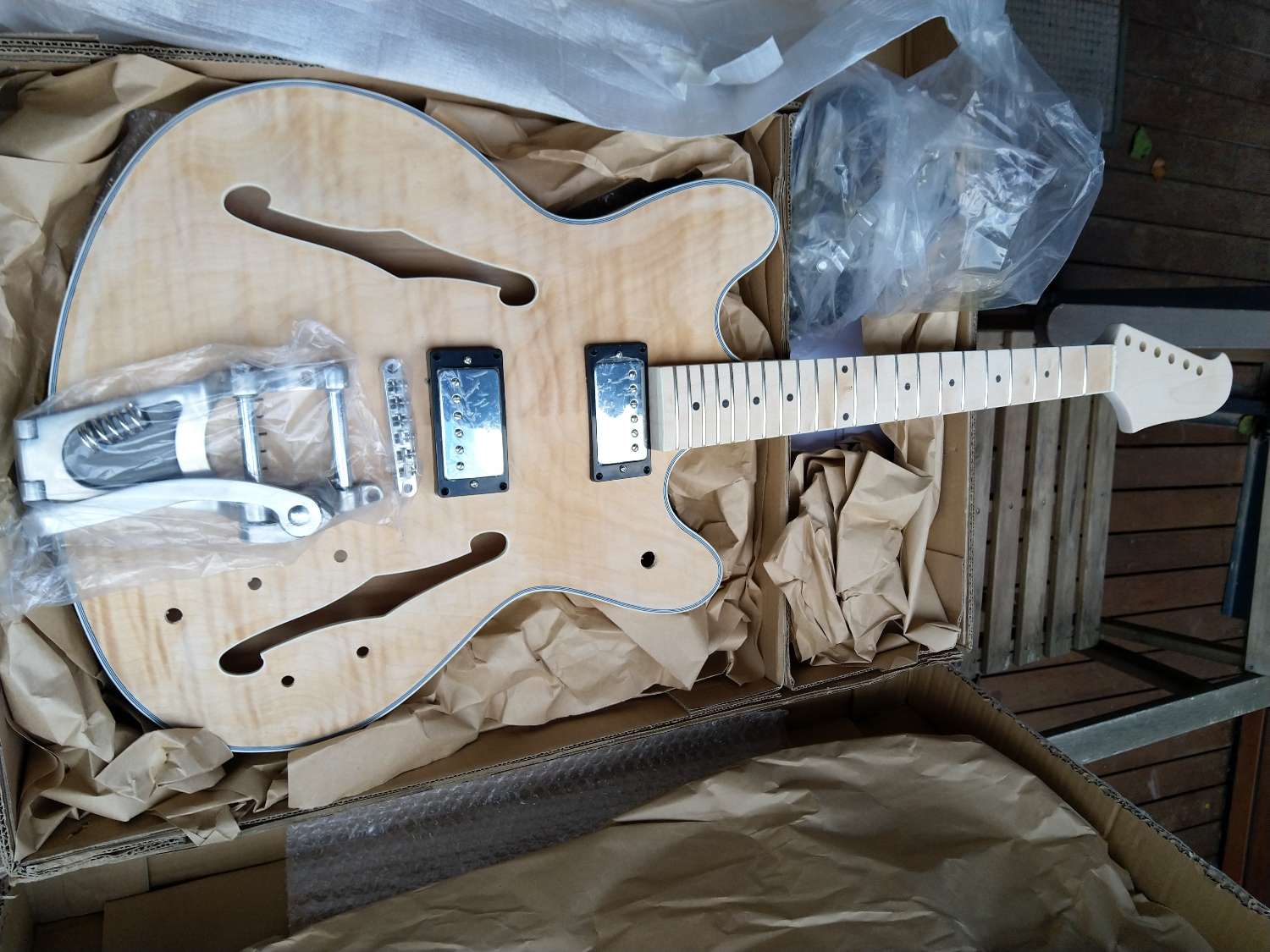

    Can't resist a bargain. $50 off for a tiny chip on the edge of neck pock. I'm juggling blue vs orange dye job. I have some Fender WRHB knockoffs to fit, which are going to get FeCrCo threaded rod magnets. I have PB-style blocks for the neck. Wanted one for ages, but too $$$ for me.

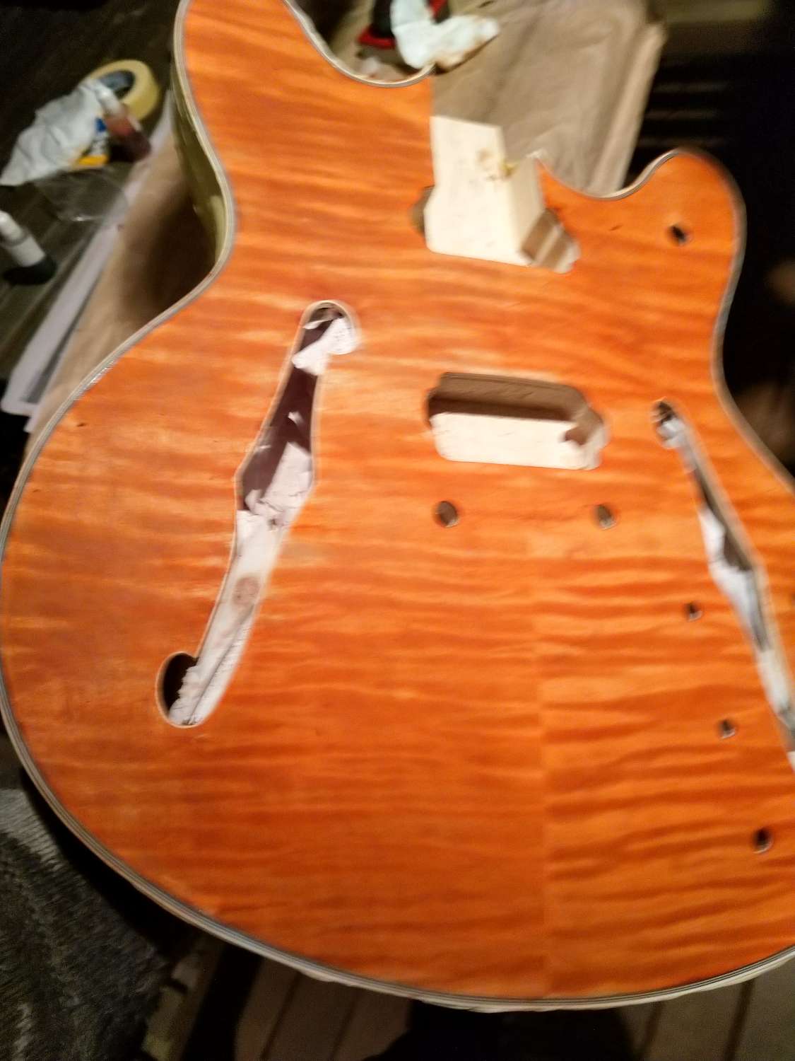

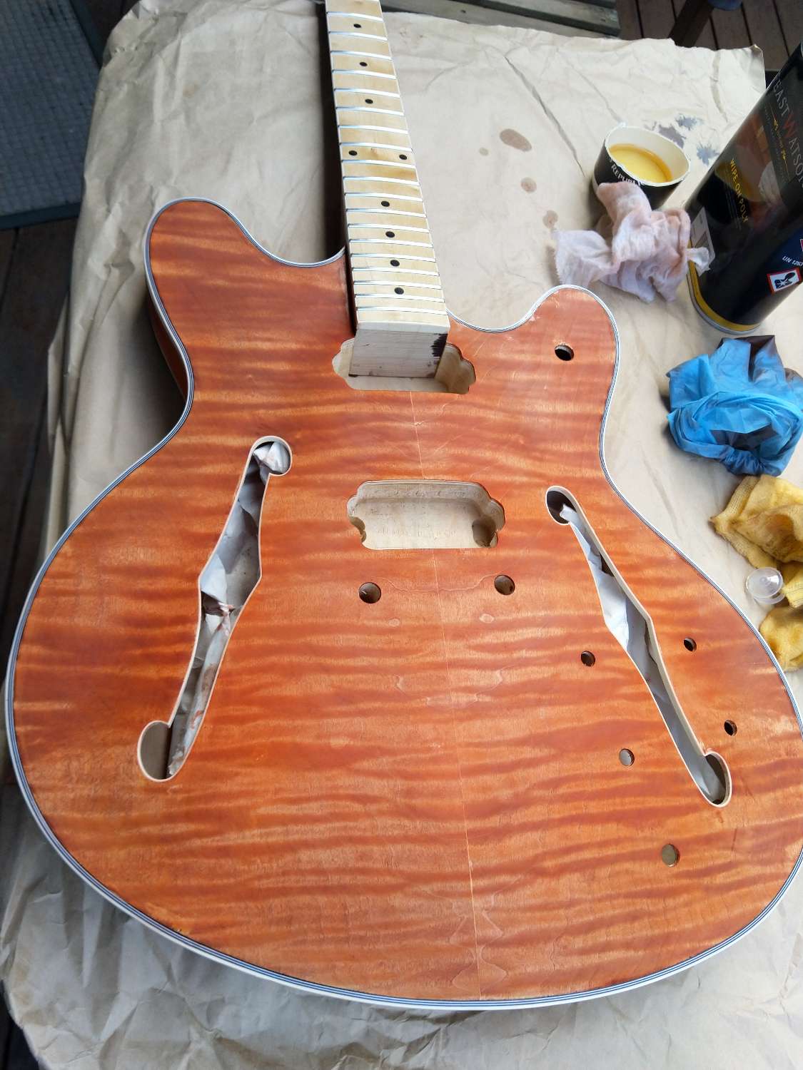

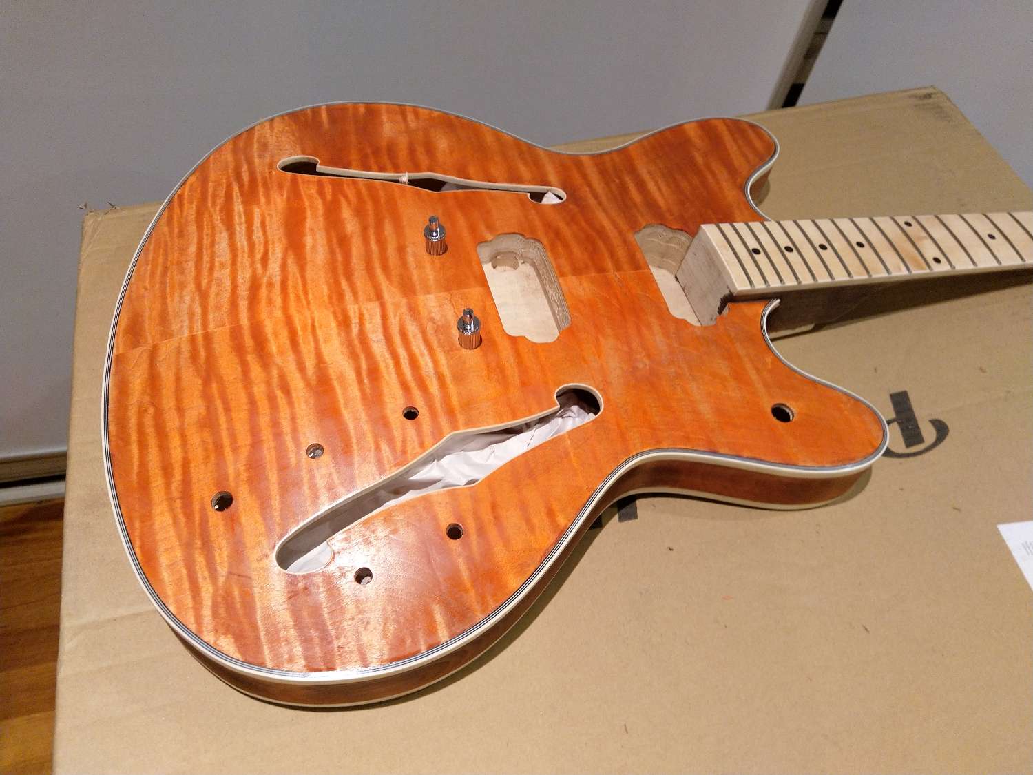

    Jul 2020
    54

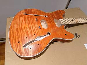

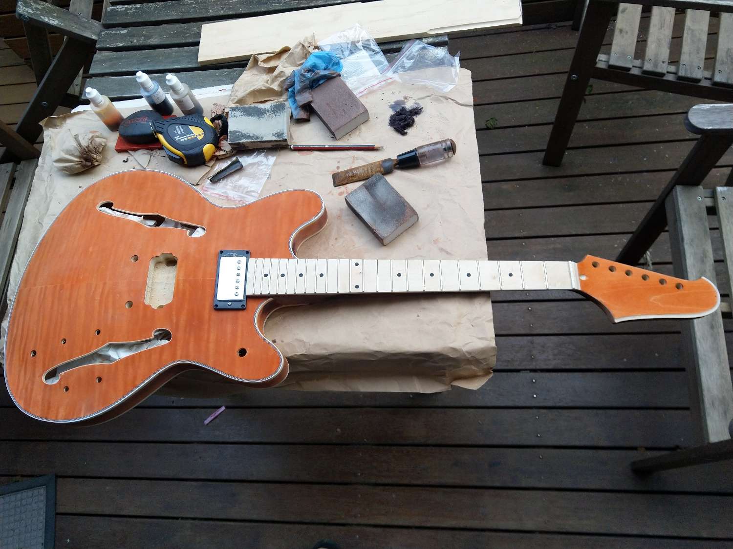

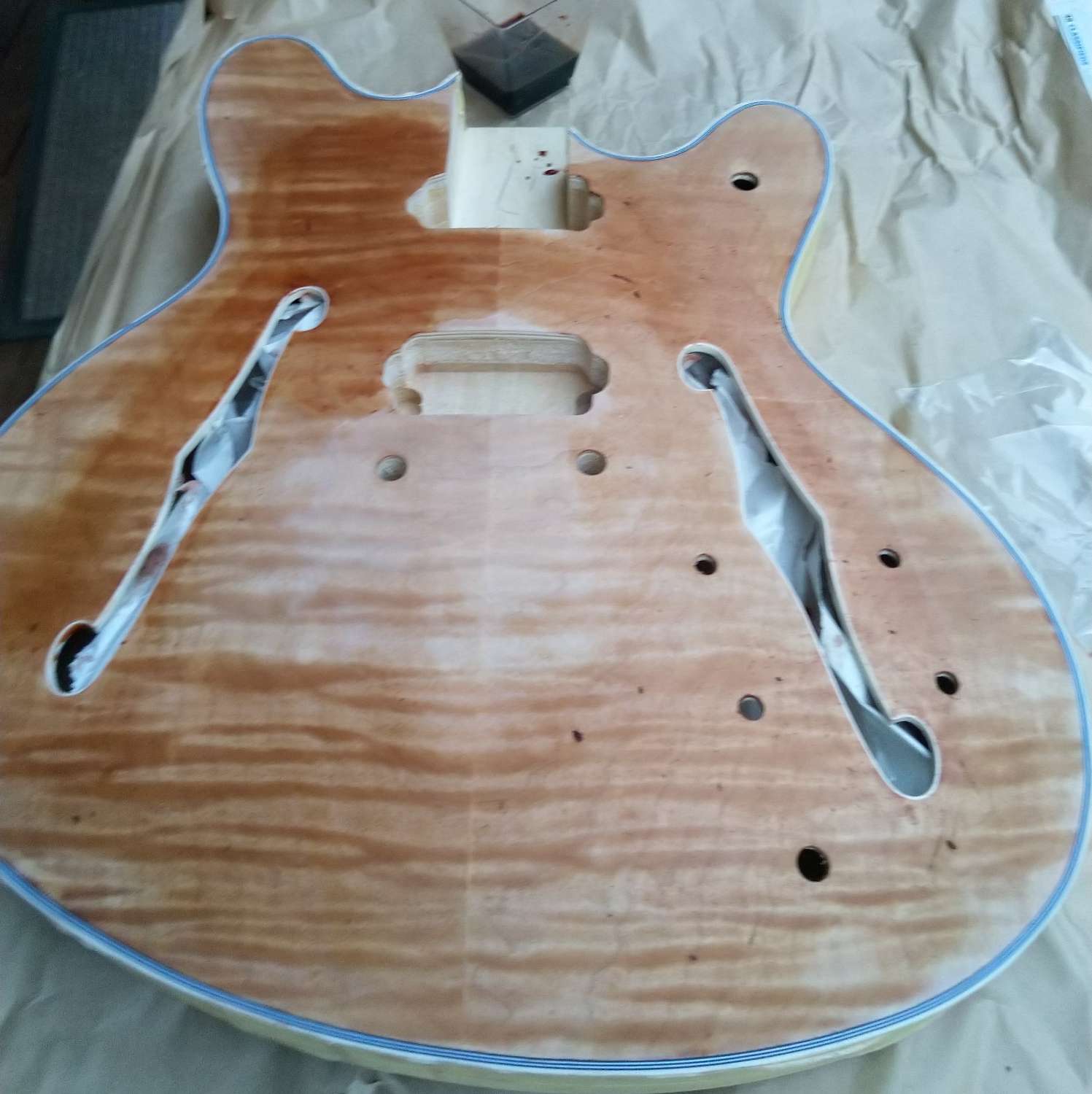

    Start of Fantaburst

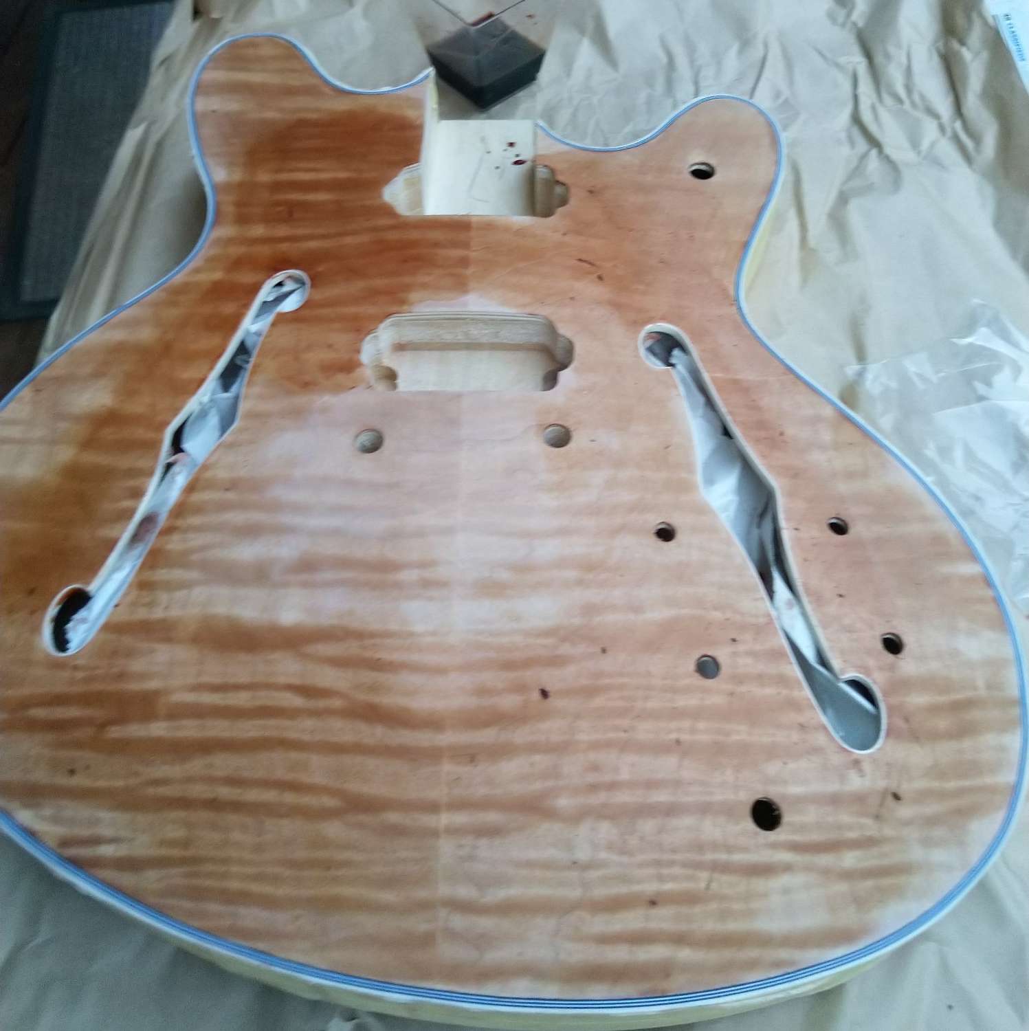

    The brown and orange-brown wash underneath pops the tigerstripe. This is just water based tint. Click image for larger version.

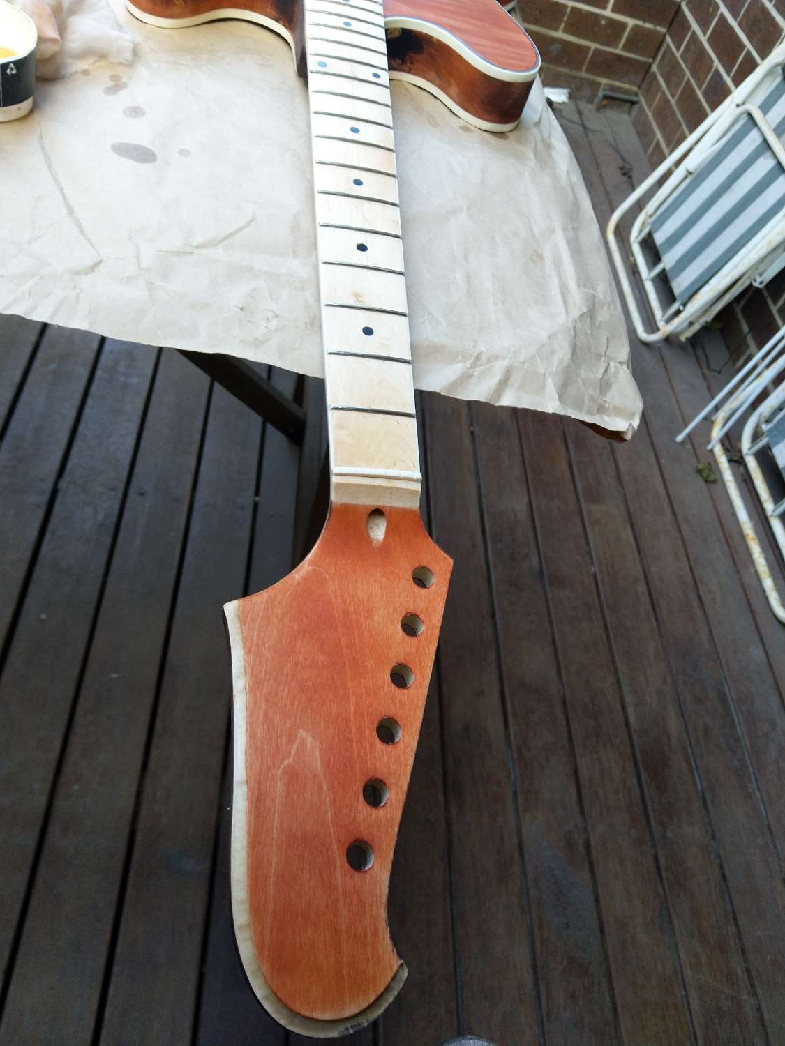

    Really lucky to just have a couple of glue spots which sanded off easily. Very impressive fit in this kit. Accurate lineup.

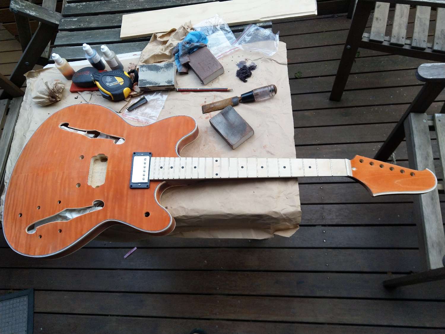

    Jul 2020
    54

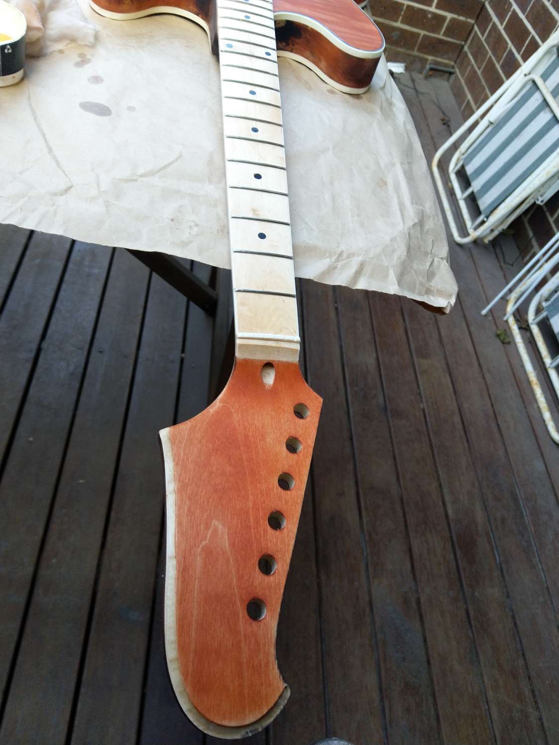

    First coat of wipe on poly
    Goes on really easy.
    Touch dry within seconds!

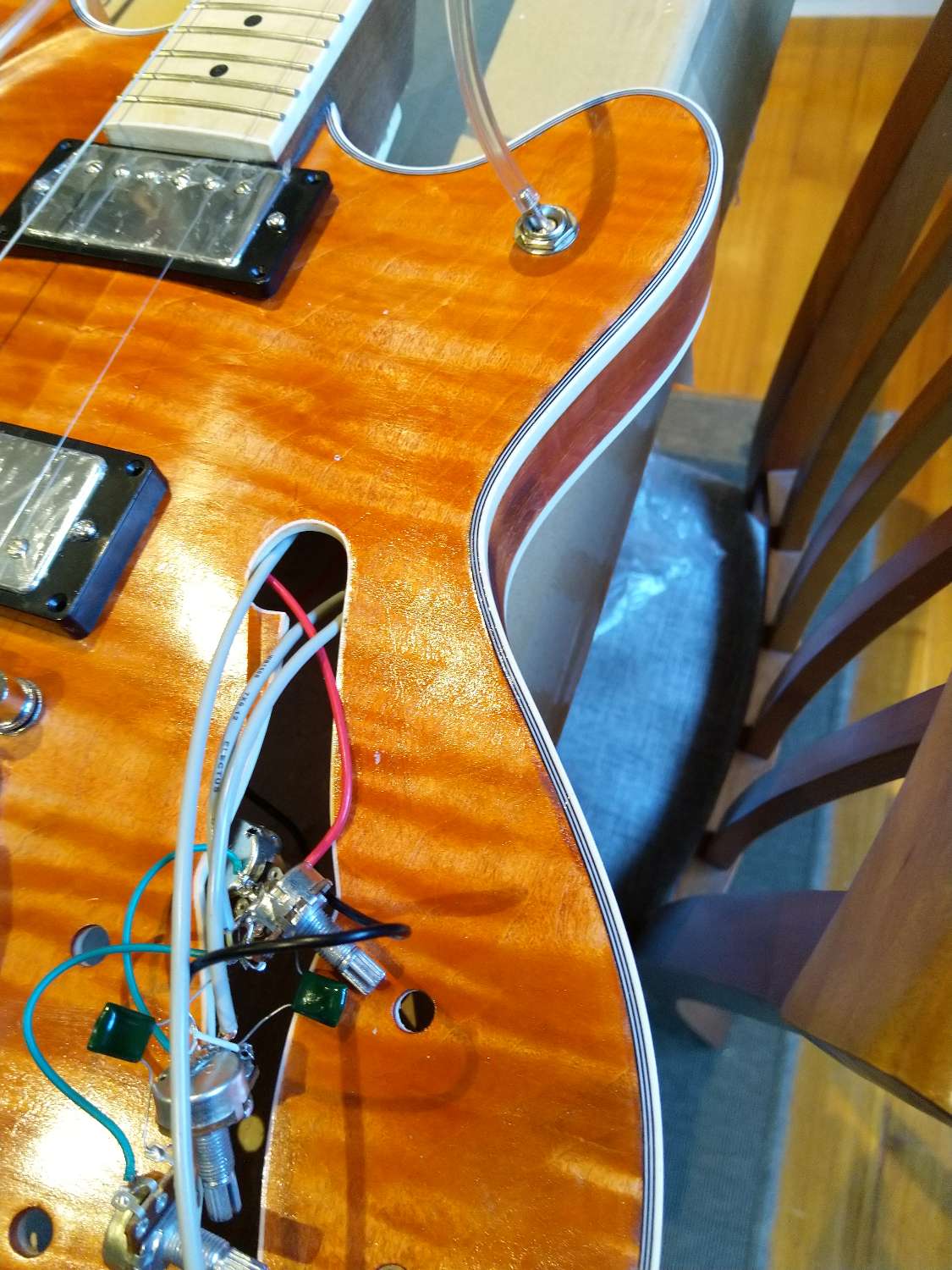

    Jul 2020
    54

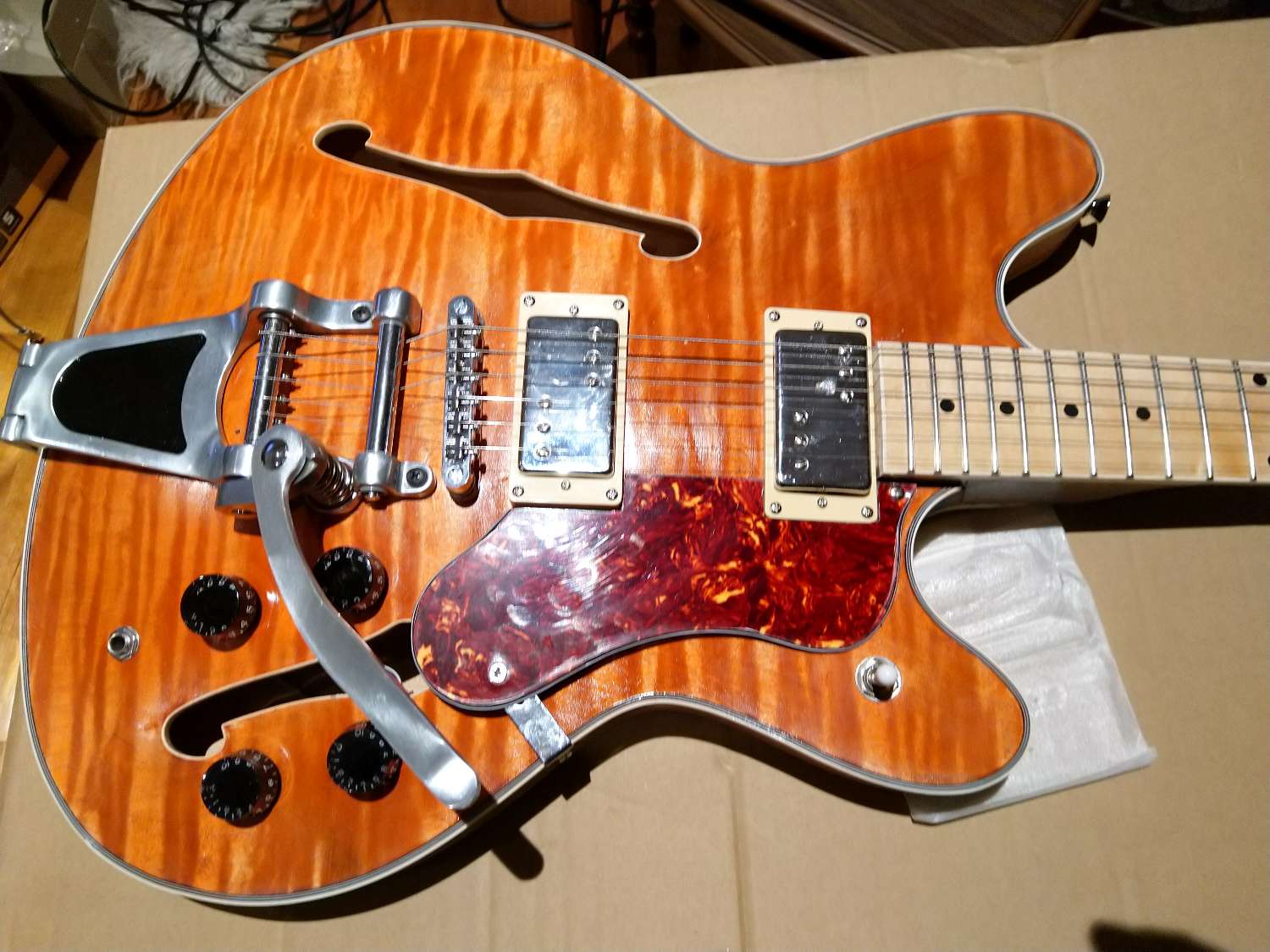

    Halfway through the finish coats. Looking nice I think.
