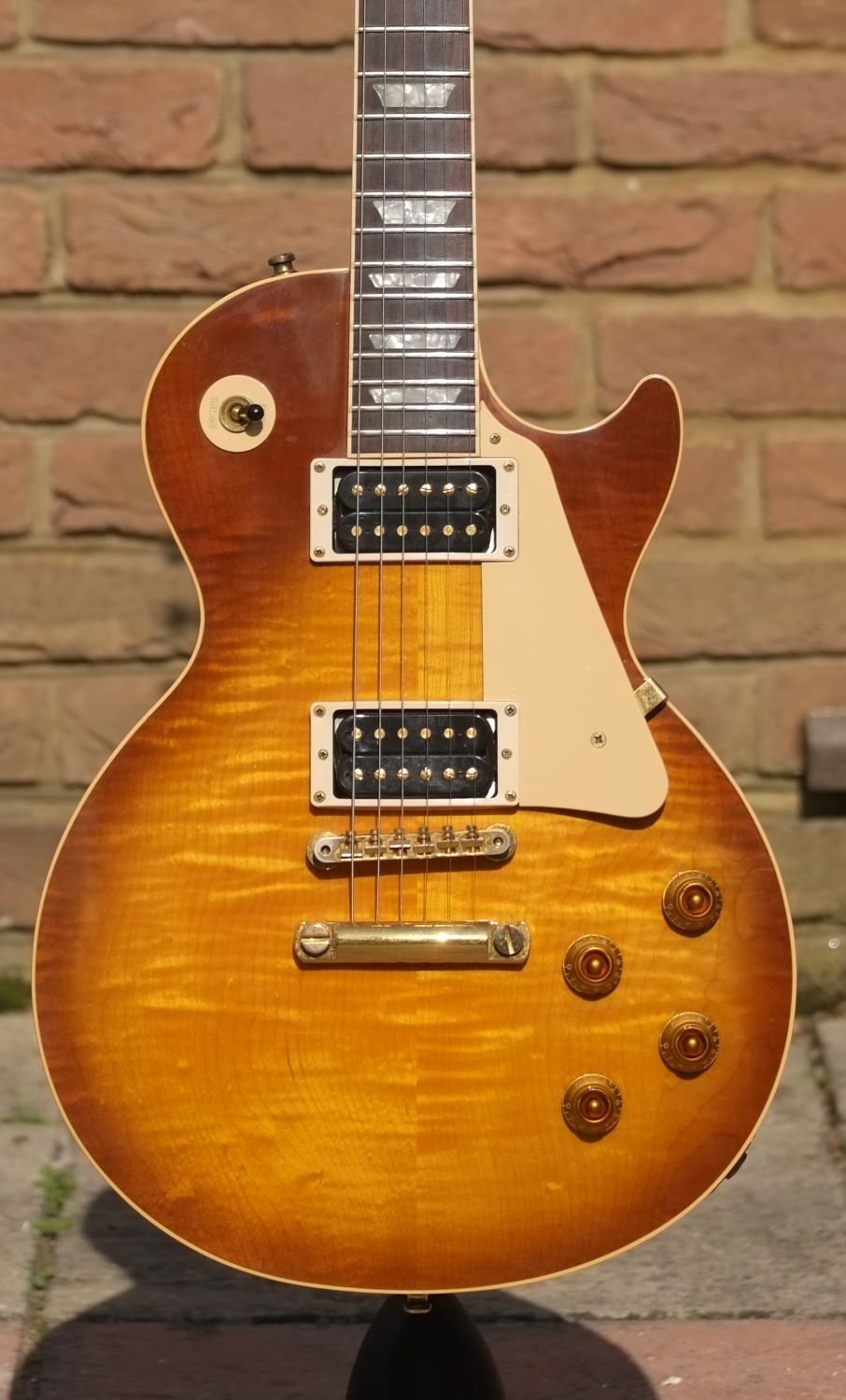

    On Tuesday I fitted some pickup covers to the Bare Knuckle Mules on my 1998 Les Paul Jimmy Page Model. This pic was taken back in 2014 when it still had the original gold hardware, but the original Gibson ceramic 496R/500T pickups had been replaced by vastly superior Bare Knuckle Mules.

    A few years ago the gold hardware got replaced with nickel hardware as I don't like gold hardware much (and I don't seem to have taken a picture of it since doing it). But the open black bobbins just didn't look right to me. Sitting on a stand, it looked more like a copy than the real thing and seemed to distort the shape. Maybe cream of zebra bobbins would have helped, but the original Gibson pickups had black bobbins, and at the time I tried to keep the look original.

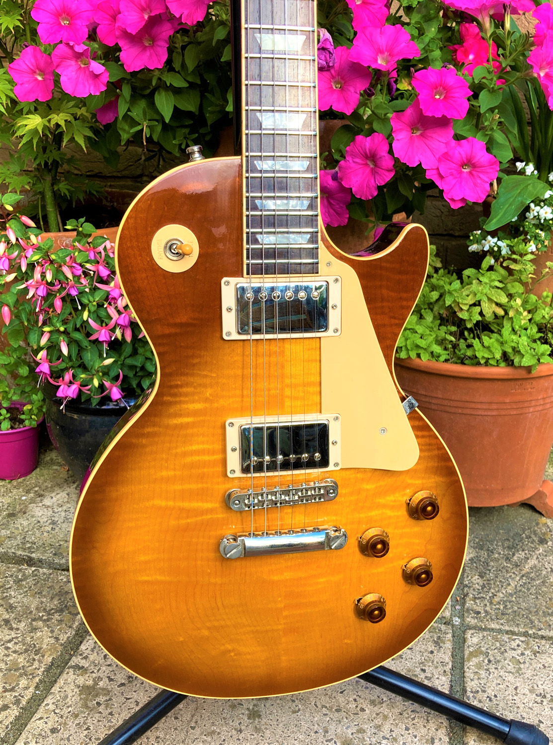

    So here it is with the nickel hardware, darker knobs, added knob pointers, and of course, the pickup covers.

    To me, it now looks like a Les Paul standard should look, and I'm really happy with the result. I know most people take the covers off, rather than put them on, but I'm awkward like that.
