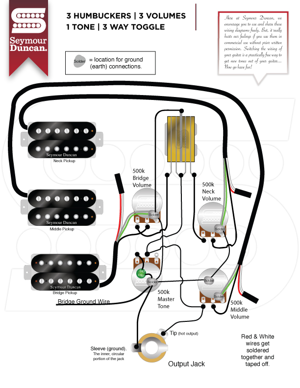

    i have looked at countless wiring diagrams for a guitar with 3 humbuckers but i am still very confused and in need of help. if someone could tell me how and where to solder the pickups to i would be very appreciative.

    Here's the SD wiring diagram for a 3 humbucker guitar. It's the only one they offer and has three volumes and one tone. The pickup lead colours will (probably) be different on the kit pickups but that's all.
    If the output lead insulation is the same on two of then and different on another, then the different one will be the bridge pickup and the other two can go in the neck and middle positions either way round. If there are different colours on all three, you are probably going to have to measure the DC resistance of each pickup, with the highest resistance pickup (probably 8-9k ohms) going in the bridge, the lowest resistance in the neck and the middle value as the mid-position pickup.
    If you look at the pots, somewhere on them there should be some white or black text saying A500 (log/audio taper) or B500 (linear taper). Hopefully you've got three A500 and one B500, or maybe all A500. The A500s will be the volume pots, the tone control can be an A or a B type. I prefer A, but B works as well.

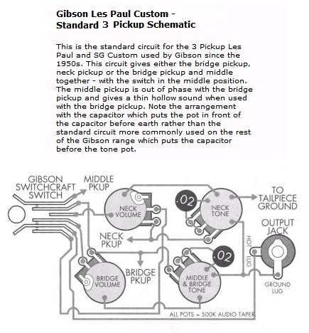

    This was the (claimed) Gibson circuit I found.
    Needs a unique switch though. Not sure I've seen one like that at all. Or even how to describe it.
    That bottom part of the switch has a N/C (normally closed) contact (top leaf) and a N/O (normally open) contact (bottom) with the middle leaf being the common.
    The switch is an Allparts EP-4369-000 or else look for a Switchcraft Switchcraft 3-Way Toggle Switch for 3-Pickup Les Paul. The Allparts switch is the Switchcraft one, but may be easier to find.
    Without that particular switch, you can't get the original wiring arrangement, so would have to go for the SD 3-volume system.
    It's up to you whether you decide to wire the middle pickup out of phase with the bridge or not. It's an option with 4-wire pickup leads, but with single wire +screen, its not possible, or not without a lot of work and taking the pickup apart and swapping the magnet over. However it's not a great sound, and whilst you may find an occasional use for it, the bridge and middle in-phase would be more useable.
